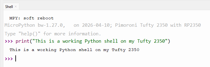

  2. Click on Stop to force Thonny to reset the connection the Badgeware device. Thonny should auto-detect your device. If not, got to Tools >> Options >> Interpreter and select Raspberry Pi Pico and for Port set it to Auto. Then, retry. Thonny with the Stop button highlighted
  3. Check the Python Shell and you should see a working shell. In the example image we have written a quick print() to prove that the shell is interactive. Thonny's Python Shell showing a test print command

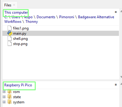

  1. Click on View and make sure Files is enabled. Thonny's View menu with Files enabled

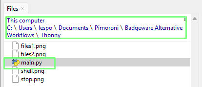

  2. Make sure that you can see the files on your computer, and the Badgeware device (Raspberry Pi Pico.) Thonny's file manager showing computer and Raspberry Pi Pico files
  3. Navigate to where your saved main.py file is located. Thonny's file manager opened to the folder containing main.py

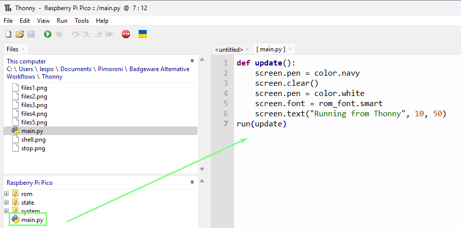

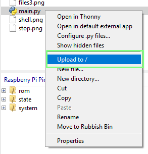

  4. Right click on main.py and select Upload to /. This will copy the file to the filesystem root of your Badgeware device. This can also be used to copy directories from your computer to Badgeware devices. Thonny's context menu with Upload to / selected
  5. You should now see the file copied to the Badgeware device. Thonny's file manager showing main.py copied to the Raspberry Pi Pico

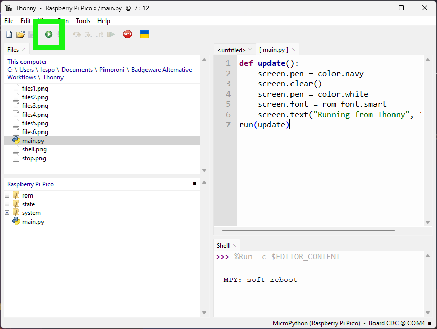

  6. Double click on the Raspberry Pi Pico copy of main.py to open the file in the editor. main.py from the Raspberry Pi Pico open in Thonny's editor
  7. Click on Run (the green play button) to run main.py on your Badgeware device. Thonny with the Run button highlighted

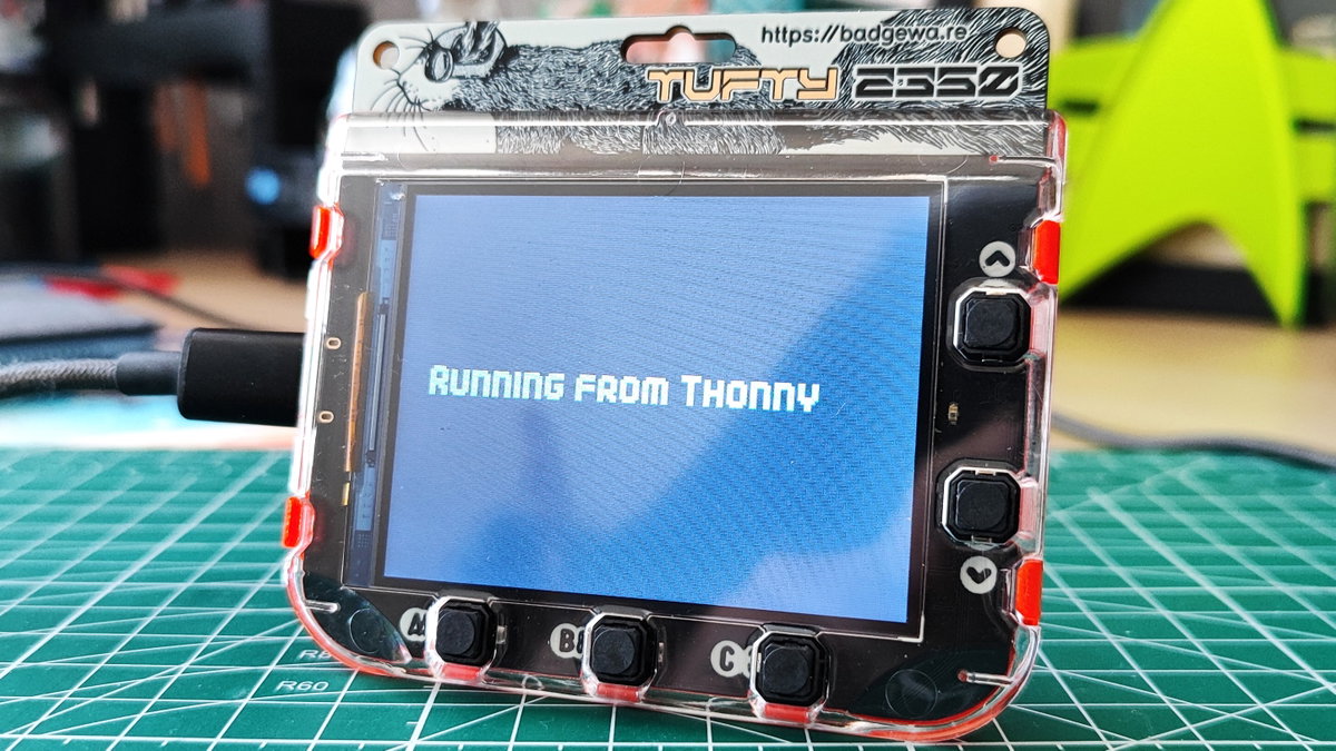

  8. The Badgeware device's screen should now show the text "RUNNING FROM THONNY". Badgeware device displaying RUNNING FROM THONNY

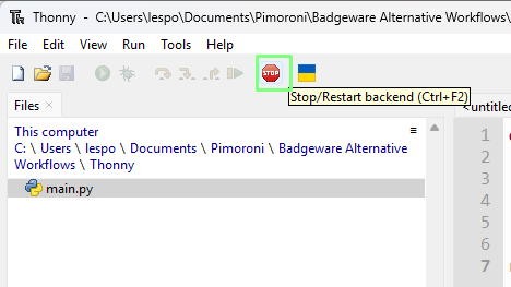

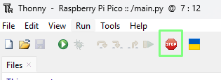

  9. Stop the code by pressing the Stop button in Thonny, or you can reset the Badgeware device. Thonny with the Stop button available to stop the running code

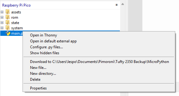

Thonny filesystem commands
Thonny's file manager context menu showing filesystem commands Right clicking on a file or in a directory inside of Thonny's file manager, will bring up a menu where we can:
  • Open a file in Thonny.
  • Open in an external application.
  • Configure Python files.
  • Show hidden files.
  • Download the file(s) / directory to your computer.
  • Create a new file.
  • Create a new directory.
  • Delete a file / directory.
  • Get the properties for a file / directory.
These options are helpful when we need to work inside the Badgeware / MicroPython devices filesystem.

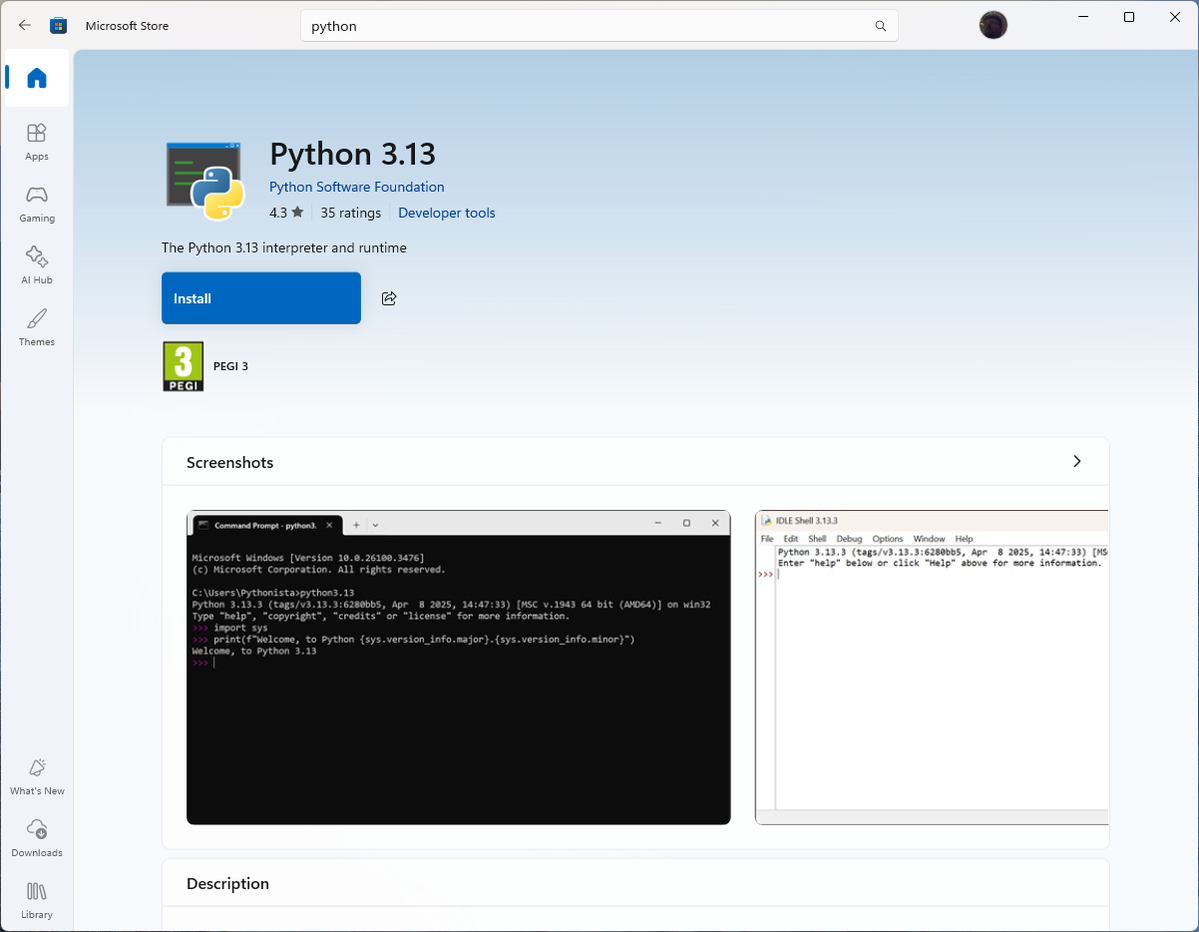

  1. Install the latest version of Python - at the time of writing this was Python 3.13. As we are using a Windows 11 PC, we are installing via the Microsoft Store as it automatically sets up the path config necessary for the upcoming steps. Linux users: Python typically comes pre-installed, but you can check by opening a terminal and typing python, you should see the Python shell appear. If not, install Python as per your distribution's instructions. Microsoft Store page for installing Python

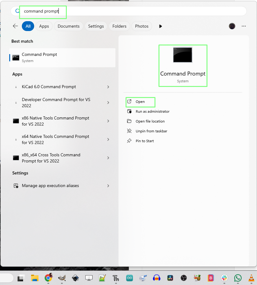

  2. Open a Command Prompt. In Windows 10 and 11 we can search for Command Prompt. Linux users, open a Terminal. Windows Command Prompt open for entering Python commands

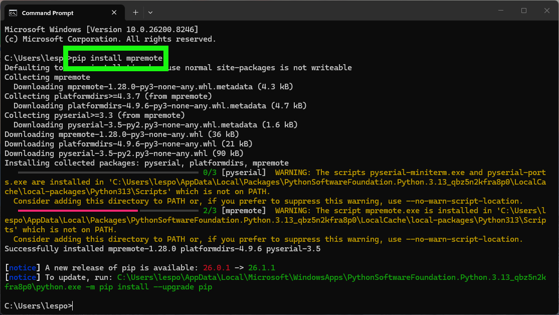

  3. Use pip to install mpremote. pip is Python's built-in package management tool. Installing mpremote via this method ensures that the tool is accessible from the Command Prompt / Terminal.
    pip install mpremote
    Command Prompt showing pip installing mpremote

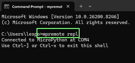

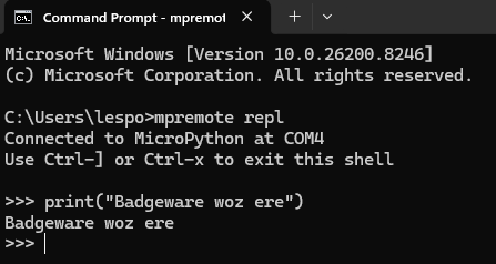

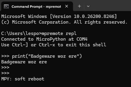

  4. In the Command Prompt / Terminal, use mpremote to check that you can communicate with the device by opening a REPL (Read, Eval, Print, Loop) Python shell.
    mpremote repl
    mpremote opening a MicroPython REPL in Command Prompt
  5. Press CTRL + C in the REPL to stop any running code and to enable input. Here you can see that we wrote a line to print "Badgeware woz ere". MicroPython REPL showing a printed Badgeware message
  6. Press CTRL+D to reboot Badgeware, then CTRL + X to exit the mpremote session. mpremote session after rebooting the Badgeware device and exiting

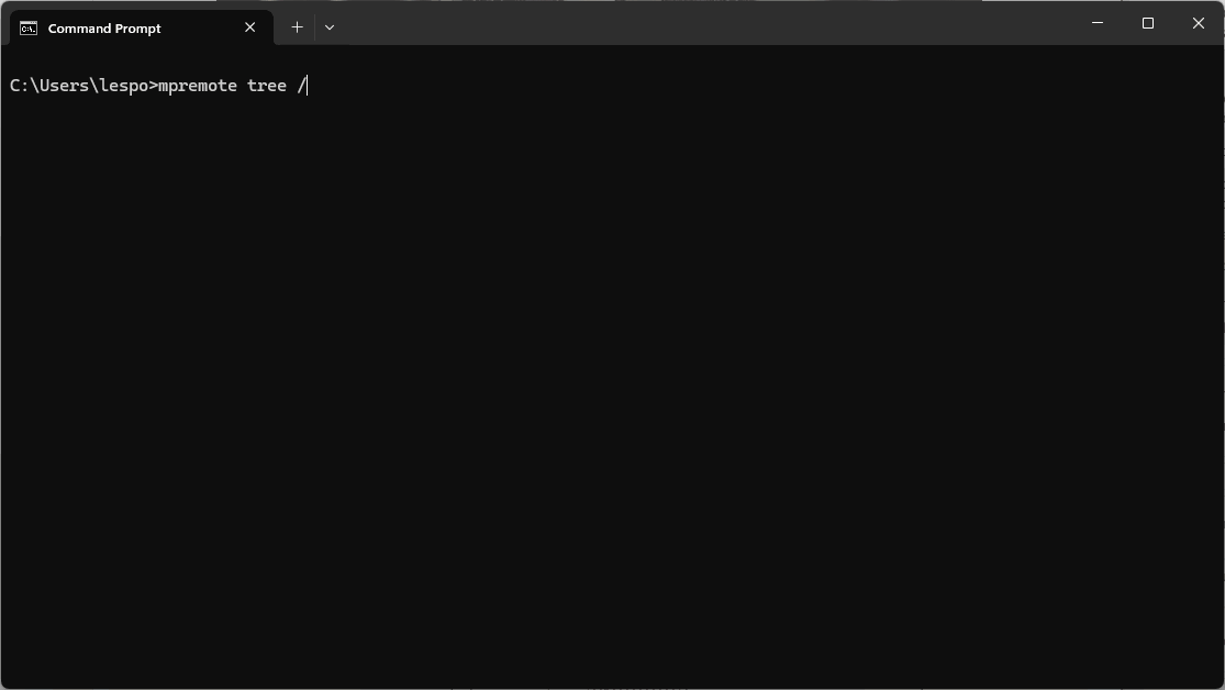

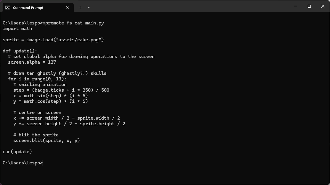

mpremote filesystem commands
mpremote fs cat command displaying a file in Command Prompt
Using mpremote we can also perform basic filesystem commands on Badgeware and other MicroPython devices.
From the Command Prompt / Terminal, use mpremote's fs command with the following subcommands.
mpremote fs <sub command>
Subcommands
To show the contents of a file(s).
cat <filename>
To list the contents of the current directory.
ls
To list the contents of the given directory.
ls <dirs>
To copy files between the source and destination.
cp [-rf] <src> <dest>
Remove files / directory on a device.
rm [-r] <src>
Create directories on a device.
mkdir <dirs>
Delete directories on a device.
rmdir <dirs>
Create blank files on a device.
touch <file>
Calculate the SHA256 sum of files.
sha256sum <file>
Print a directory tree.
tree [-vsh] <dirs>
