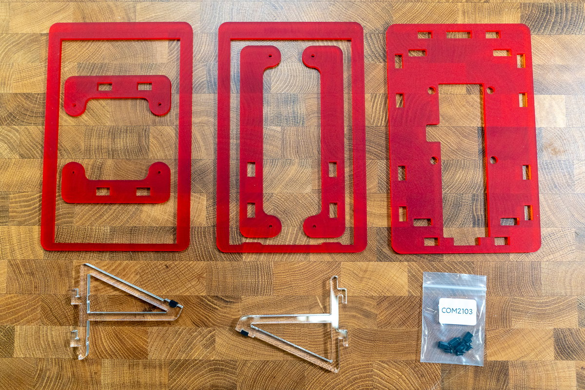

Kit Contents
Here's what you get in the kit:
  • 3x different screen sized acrylic pieces
  • 2x vertical mounting places (the long ones)
  • 2x horizontal mounting plates (the short ones)
  • 2x legs with rubber feet
  • A standoff kit containing 4x 7mm standoffs and 4x M2.5 5mm screws

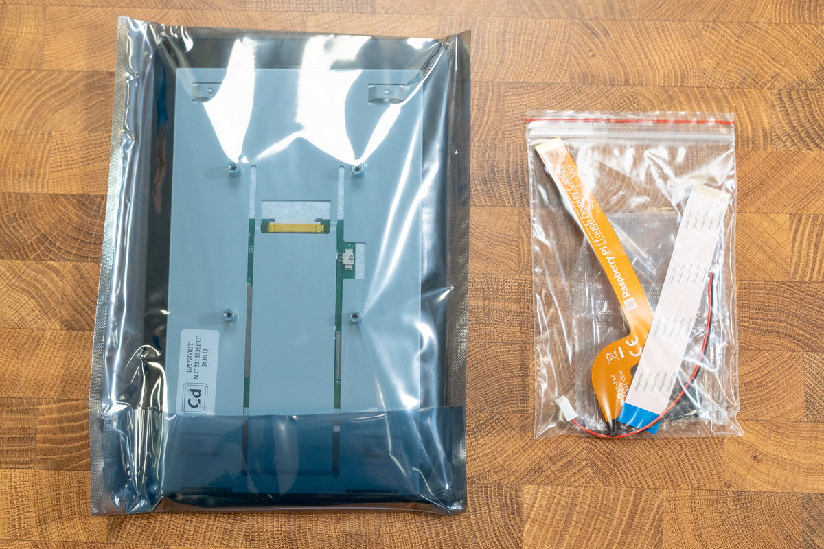

You'll then need to unpack your screen - it should come with two different ribbon cables, a red and black power cable and some M2.5 screws. Note the screws that come with the screen are slightly shorter than the ones included in our standoff kit.
Image 3

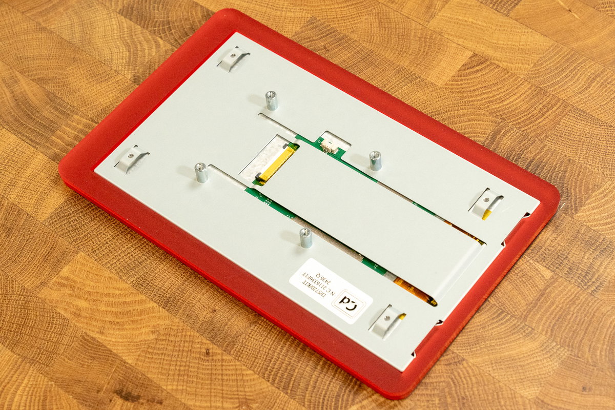

The two large acrylic pieces with a large hole in are subtly different - one has two tabs at one end of the inner cutout. You'll need the one without the tabs first - slot it over the back of the display like this:
Image 5

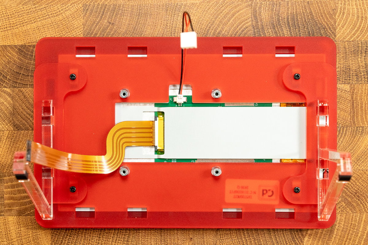

Open the ribbon connector on the display by sliding the grey tabs sideways slightly. Be gentle, these FFC connectors are quite delicate and it's possible to break the tabs if you try and open it too far.
Image 7
Insert the large end of your ribbon cable into the connector with the metal contacts facing upwards, and secure it in place by pushing the grey tabs back into place.
We've got a Pi 5, so we're using the display cable with a smaller end that will fit the Pi 5's smaller DSI connectors. If you're using a version of Pi with a large DSI connector you'll need to use the ribbon cable that's the same size at both ends.
Image 8
Plug the two-pin end of the red and black power cable into the two pin connector on the display (it will only go in one way).
Image 9
Thread the ends of the cables through the large hole in the third large acrylic piece and fit it in place over the back of the display.

Place the mounting plate on the back of the frame. The small holes in the mounting plate should match up with the holes on the frame.
Image 14 Image 15
To fix the mounting plates in place, use the four screws that come in the standoff set (they're a little bit longer than the ones that come with the screen, so will pass comfortably through the acrylic and into the screen mounting supports).
Image 16 Image 17

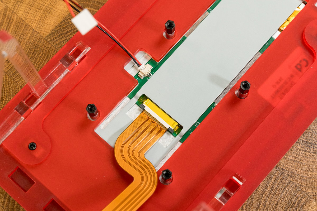

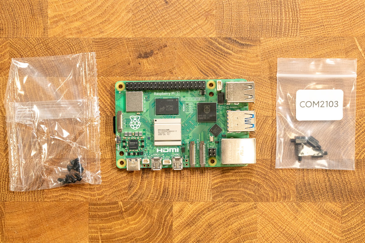

Adding the Pi
Next we're adding the Pi - for this we'll need the screws that come with the display and the M2.5 standoffs.
Image 18
Screw the 4 M2.5 standoffs into the display's built-in standoffs.
Using these standoffs is optional, but we found having a bit of a gap between the display and the Pi made it much easier to plug cables into the Pi, especially in portrait orientations when the legs tend to get in the way.
Image 30 Image 33
Pop your Pi on top of the display's built in standoffs, and use the M2.5 screws to fix it in place.
Image 20

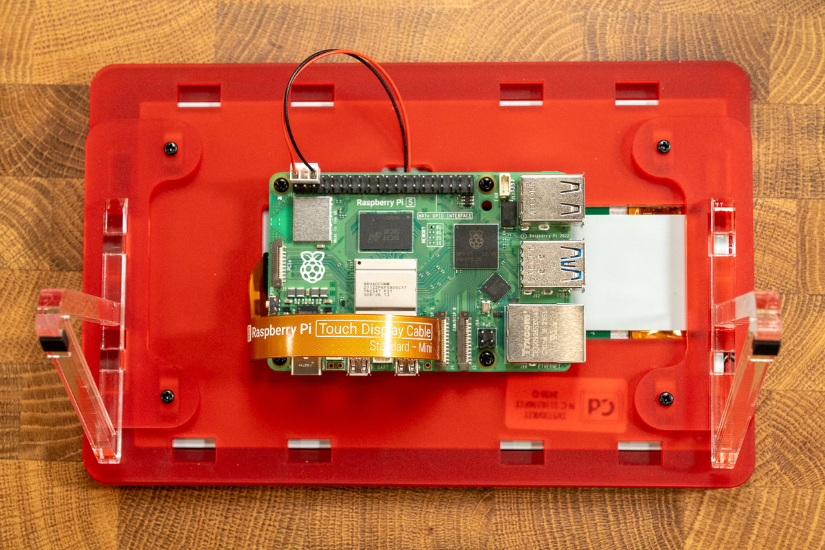

Plug the power cable into the first three pins on the Raspberry Pi's GPIO header as shown. Make sure the red wire is going to pin 2, which is the first pin on the top row (check Raspberry Pi's helpful diagram if you're unsure!)
Connect the end of the ribbon cable to the display connector on your Raspberry Pi. This connector works in a similar way to the one on the display, but you need to slide the tab towards you rather than sideways to open it.
Image 22
Tada, you're done!

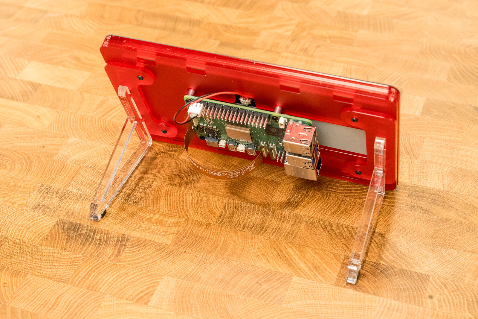

Image 23 Image 25
Variations!
Mount the Pi the other way up
If you'd prefer to have your USB-C and display ports pointing upwards, you could attach the mounting plates to the frame the other way up:
Image 27

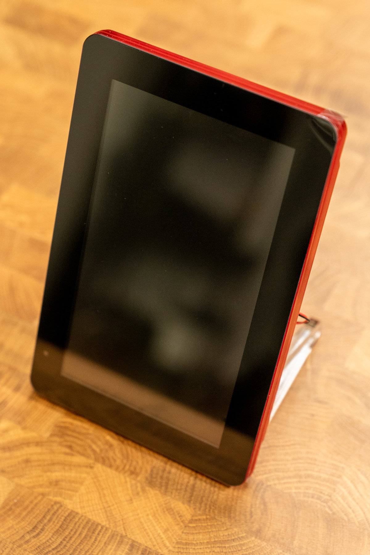

Portrait
If you want to use the display in portrait orientation, you'll need to use the two longer mounting plates, as so:
Image 29

Don't forget to remove the protective plastic from the display when you're done!
