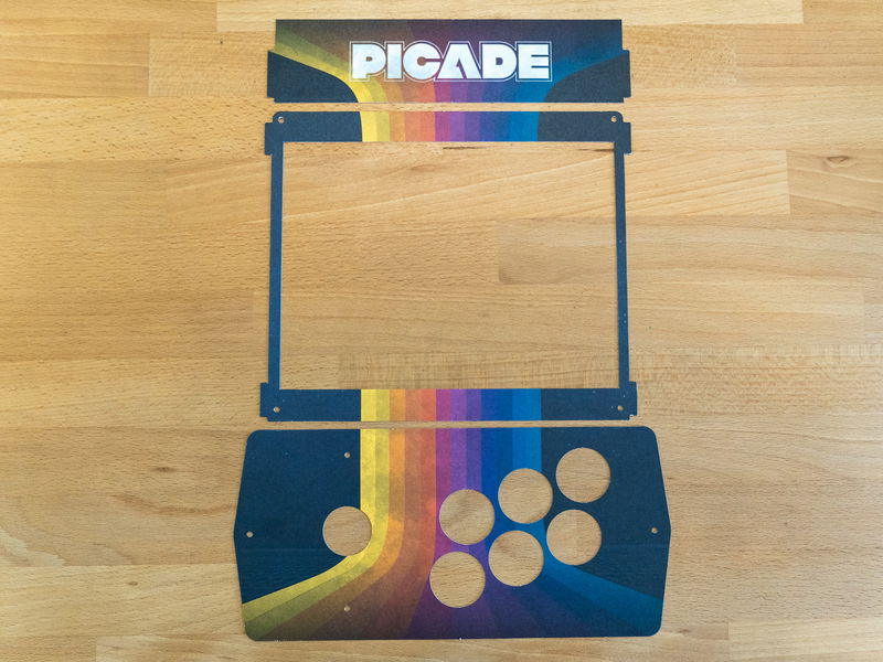

  • Marquee assembly (comprising of two long acrylic pieces, and a 'Picade' printed cardboard insert)
  • Console assembly (comprising of a wooden panel with holes for buttons, a matching acrylic piece and a printed cardboard insert)

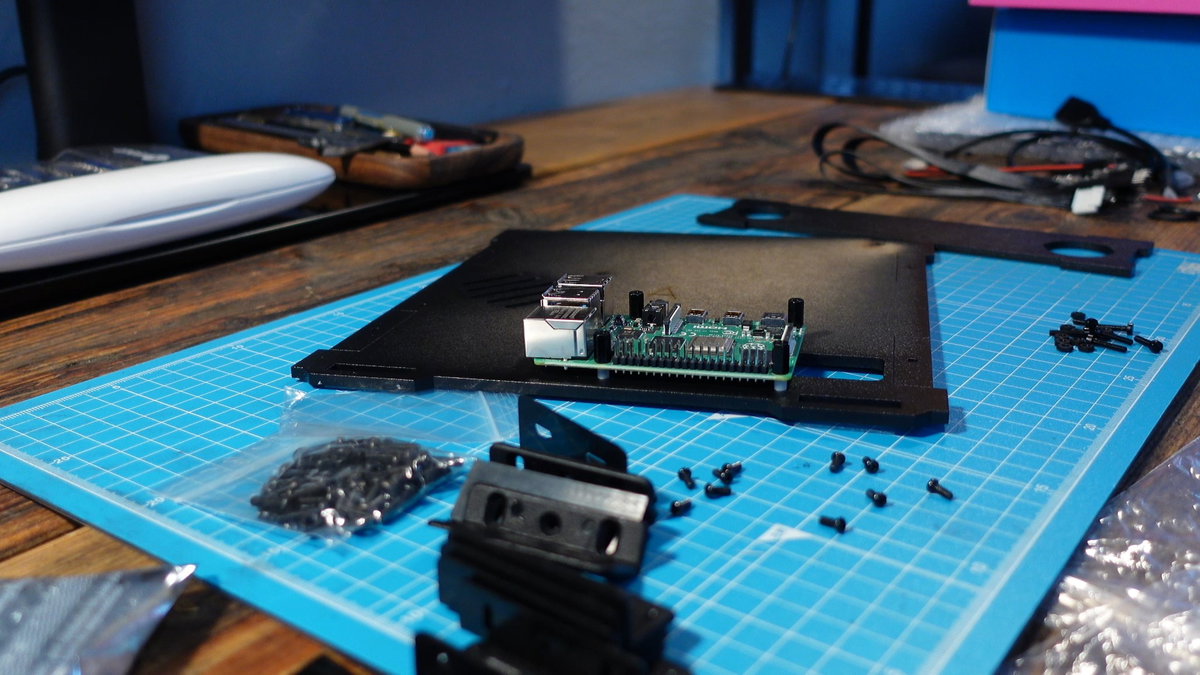

To start, you'll need to find the square black wooden panel marked A in the CABINET box - this will become the base of your Picade. You'll also need your Raspberry Pi, and the M2.5 bolts, nuts, spacers and standoffs from the FIXINGS box. The nuts and bolts are the ones that look like this:
The wooden panels are laser cut by us and then powder coated by a friendly, local Sheffield company. This process can result in some textural variation on the back of the panels and you might also notice some holes on the back that don't go all the way through - these holes are where the panels are hung up to be powder coated. There should be an obvious good side and a 'label' side with markings and text on. The label side will always be on the inside of your Picade, so any patchiness on this side won't show once your Picade is assembled.

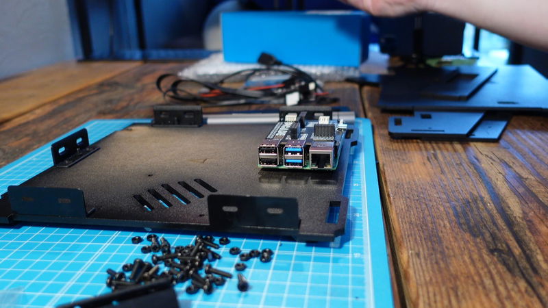

To mount the Pi to the base, turn the base panel label side up, and push four nylon M2.5 bolts through the four holes near the rectangular cutout, from the bottom. The threads of the bolts should be pointing towards you.
Holes near the rectangular cutout
Place the white plastic spacers on top of each bolt, then place your Pi onto the bolts, with the Pi's SD card slot over the rectangular cutout. Screw the four metal standoffs onto the bolts, securing your Pi to the base. If you're having trouble with the bolts falling out of the holes before you have the chance to tighten them up, a piece of Blu-Tack over the head of each bolt can help to keep them in place while you fit the spacers, Pi, and standoffs, and can simply be removed afterwards.
Raspberry Pi secured to the base

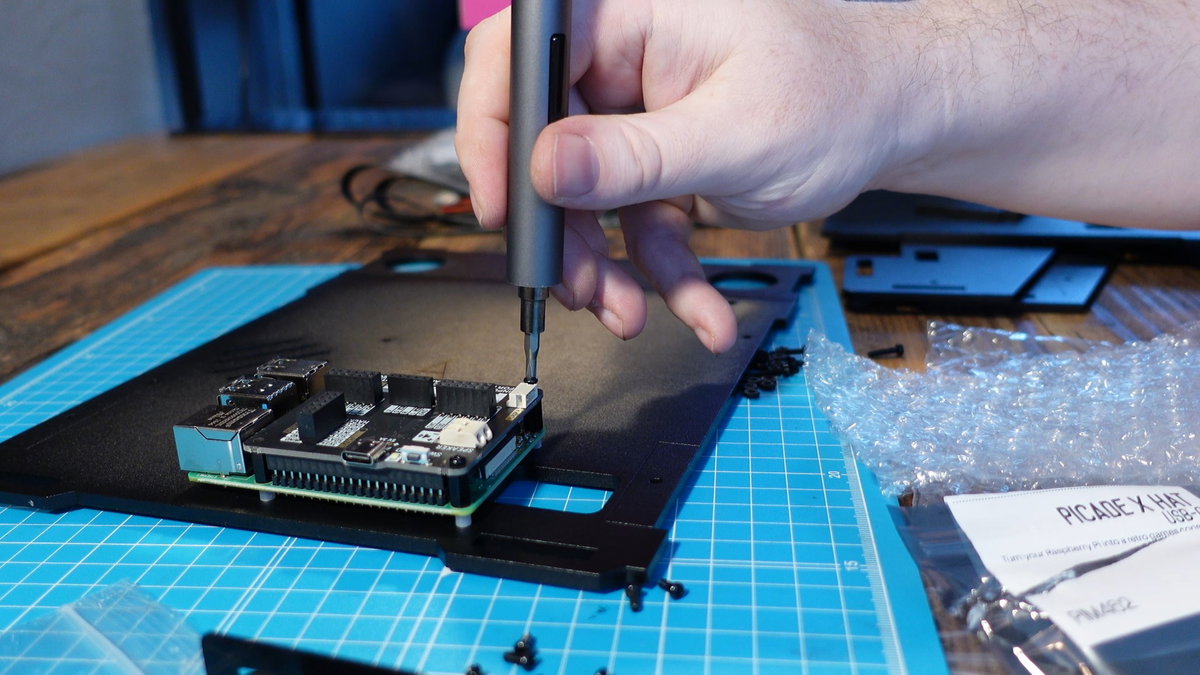

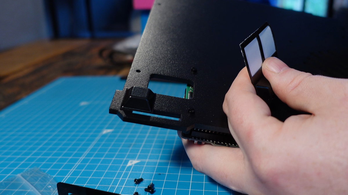

Mounting the Picade X HAT

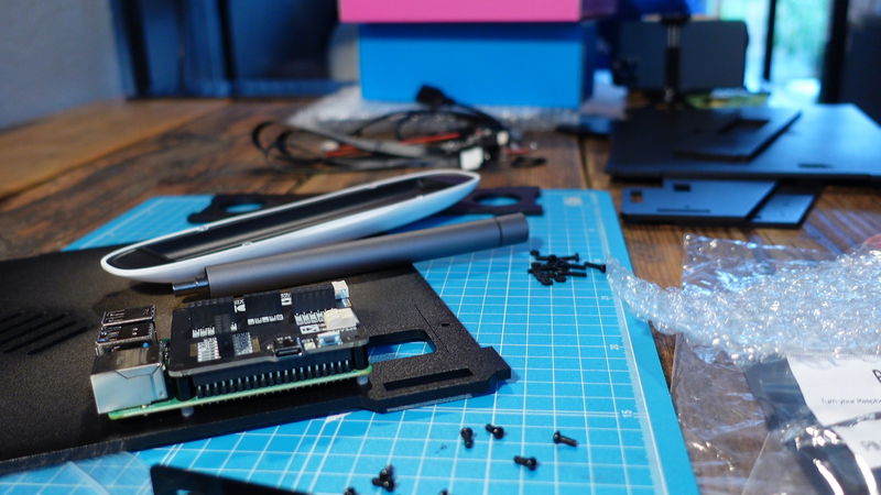

Next, find the Picade X HAT and remove it from its bag. Push the Picade X HAT onto the Pi's GPIO pins, ensuring that the pins are correctly lined up and the holes line up with the standoffs.
Picade X HAT fitted to the Pi
Use four of the smaller metal M2.5 screws to secure the HAT to the standoffs.
Picade X HAT secured to the standoffs with M2.5 screws

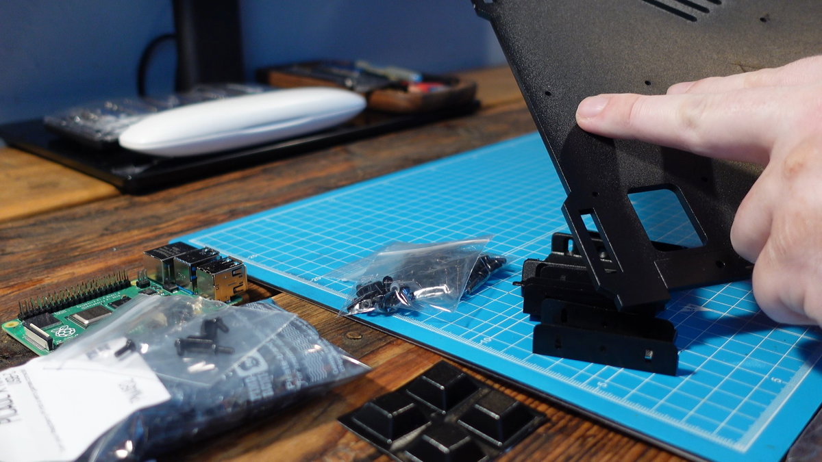

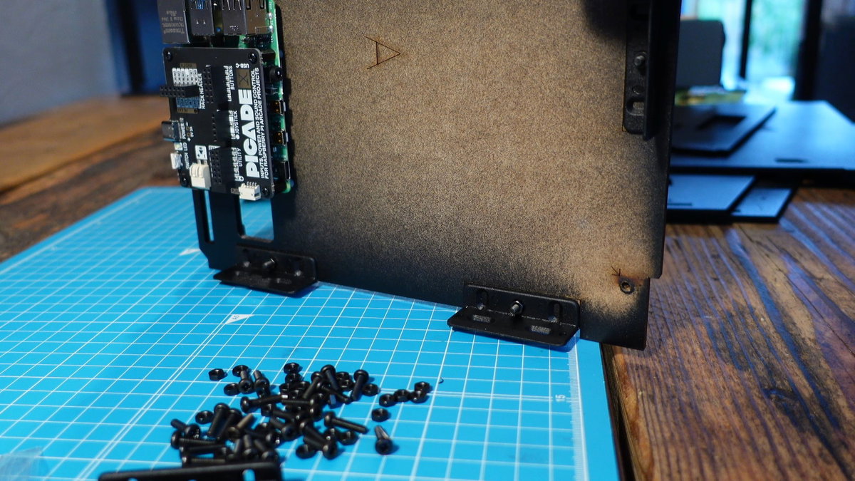

Attaching the brackets to the base

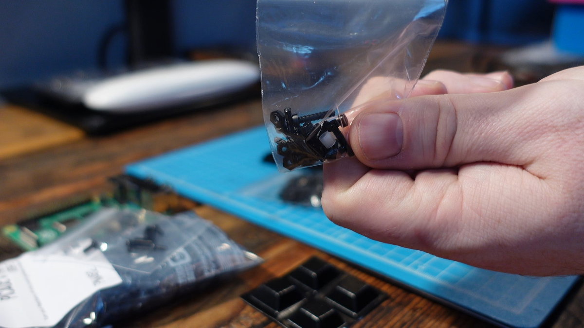

Now you'll need the big bag of M3 nuts and bolts, and the black plastic brackets from the FIXINGS box. You'll use lots of these nuts and bolts for fixing the cabinet together, and you'll want to always have them so that the heads of the bolts are on the outside and the nuts are on the inside of the cabinet (the side with the text labels on).
Attach five plastic corner brackets to the rectangles marked on the base (panel A), using five M3 bolts and nuts. You'll want to put the bolt through the round, centre hole on the bracket - the round holes in the brackets can be a bit tight so you might need to apply a bit of pressure to get the screw thread to first engage.
Five plastic corner brackets fitted to Picade panel A
Close view of corner brackets attached to Picade panel A

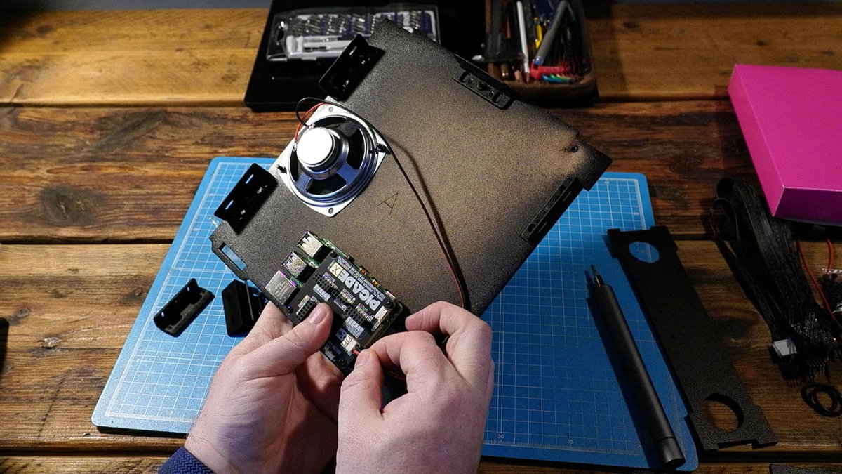

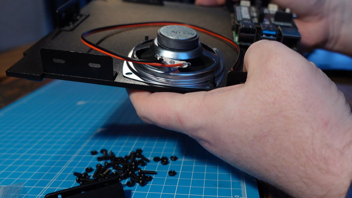

Attaching the speaker
Place the speaker on the label side of panel A, with the paper cone against the cutouts and the wire pointing towards the edge of the Picade. Secure it with M3 screws, pushed through from the good side, and M3 nuts. The paper cone of the speaker is delicate, so take care not to accidentally damage it.
Speaker positioned on the label side of Picade panel A
Speaker secured to Picade panel A

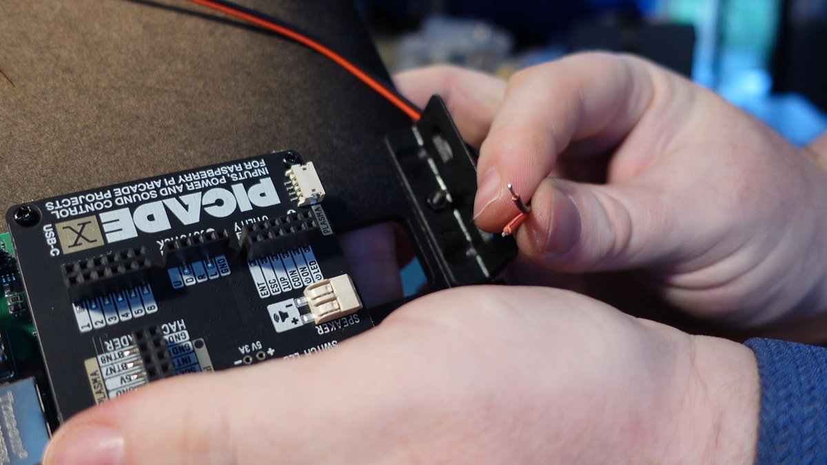

The speaker wires connect to the push fit connector on Picade X HAT, marked SPEAKER, red to + and black to -. This is a bit of a fiddly connector, so if you've not come across one before it's worth taking a look at how it works before you begin attaching the wires. Look down the barrel of the connector whilst using a small screwdriver to gently press on the round indentation on each connector - you'll see the little iris open up inside the connector, this is the part that grips on to the cable.
Attach the wires, one at a time, by gently pressing on one of the indentations to open up the connector whilst at the same time pushing the speaker wire in from the side. It might help to separate the wires a little first. Don't press down too hard - it's possible to break the clips if you do. If the wire won't go in, release the pressure and check that you're inserting the wire straight (it might be helpful to grip the wires with tweezers or pliers as you feed them in). Once it's attached correctly, the wires should be gripped tightly in the speaker terminals.
Speaker wires connected to the Picade X HAT

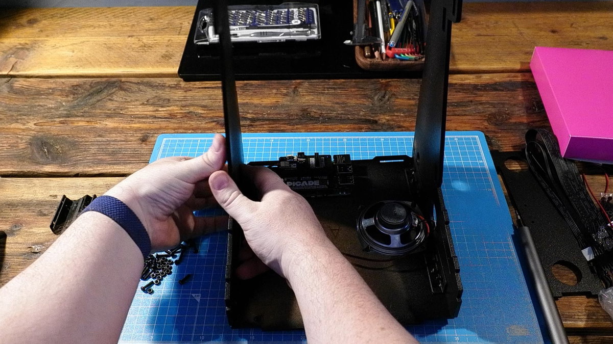

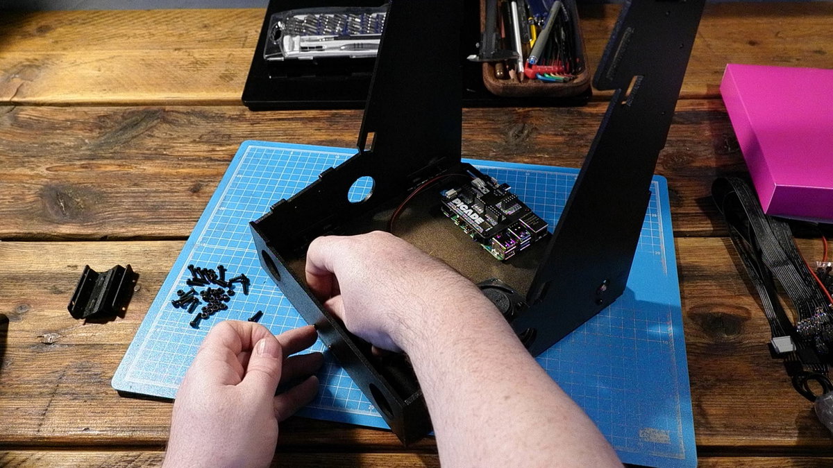

Attaching the sides and front

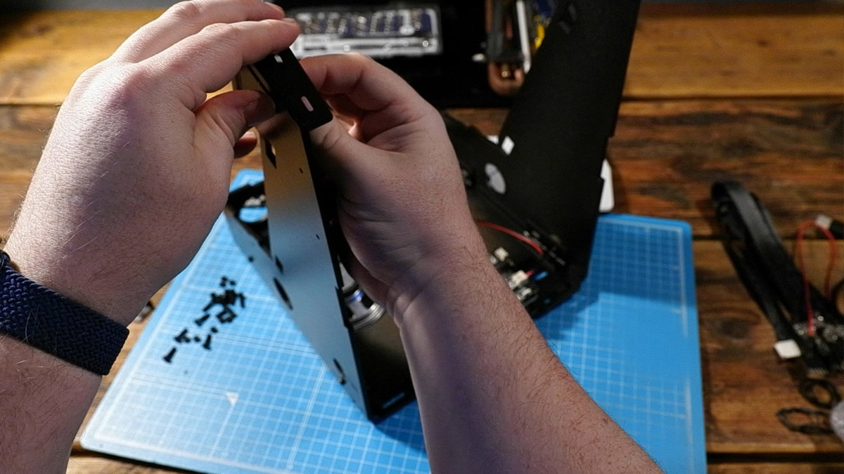

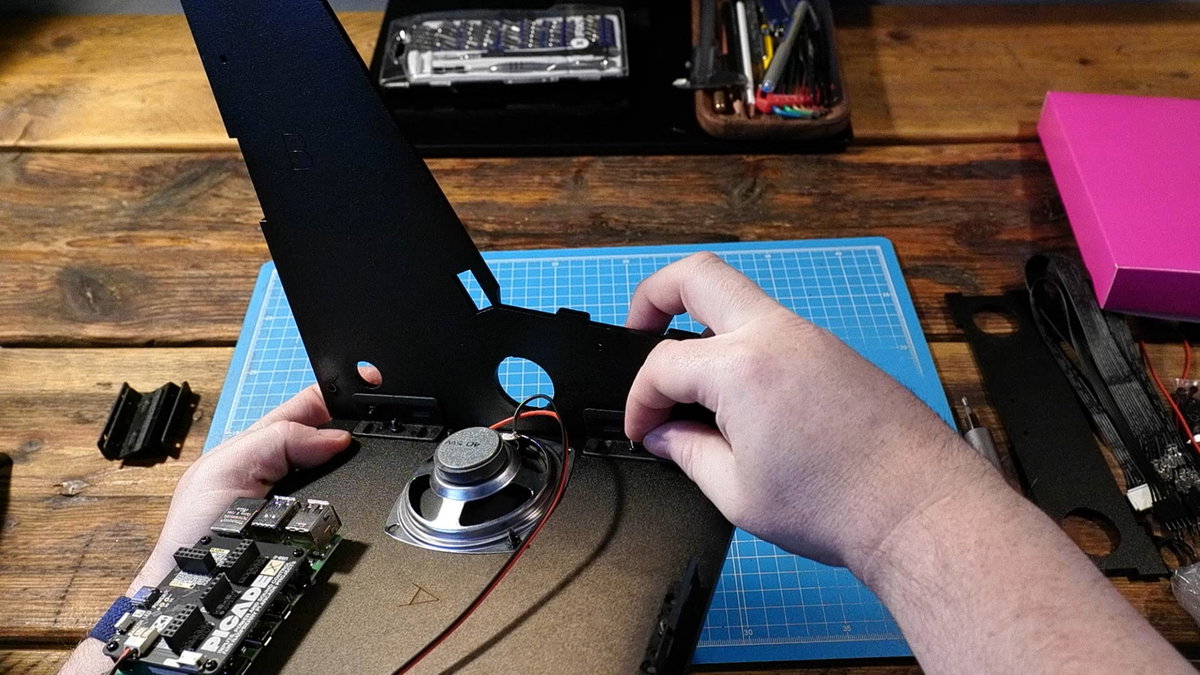

Locate side wooden cabinet panel B and attach it to the two brackets on the side of the base closest to the speaker grill with the labels inside, using two more M3 nuts and bolts pushed through from the outside. Attach the other side panel, panel D to the opposite side of the base in the same way.
Attaching side panel B
Side panel B attached to the Picade cabinet

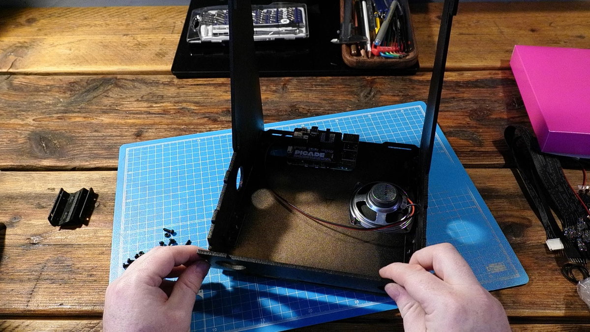

The front panel is cabinet panel E, and it slots between the short edges of the side panels (the tabs should fit neatly into the slots). Make sure the two little holes are at the bottom edge of this piece, next to the base.
Wooden front panel E positioned between the Picade sides
Secure the front in place with two M3 bolts.
Front panel E secured with M3 bolts

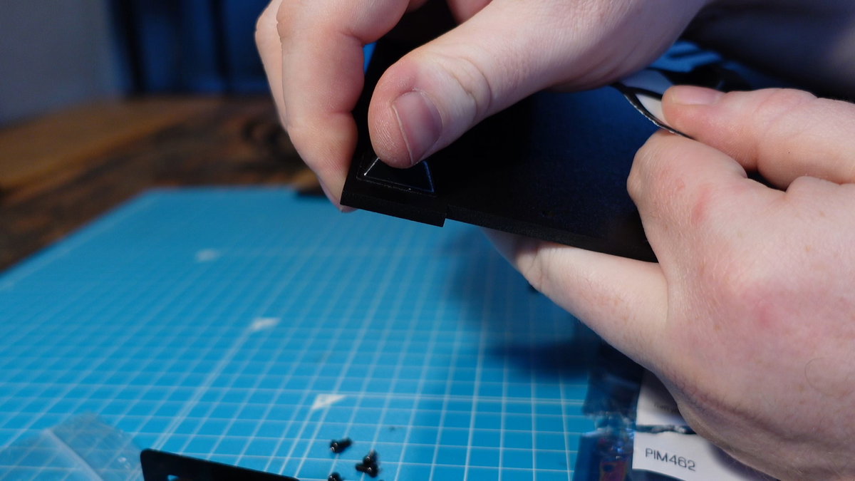

Building the screen assembly

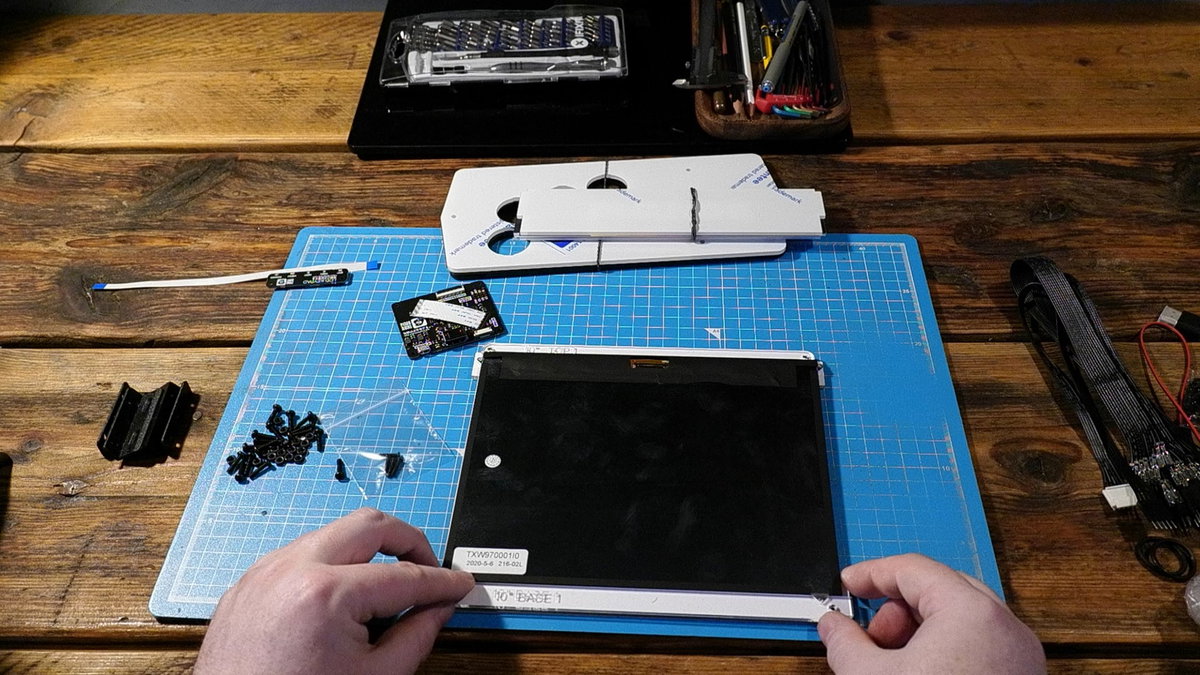

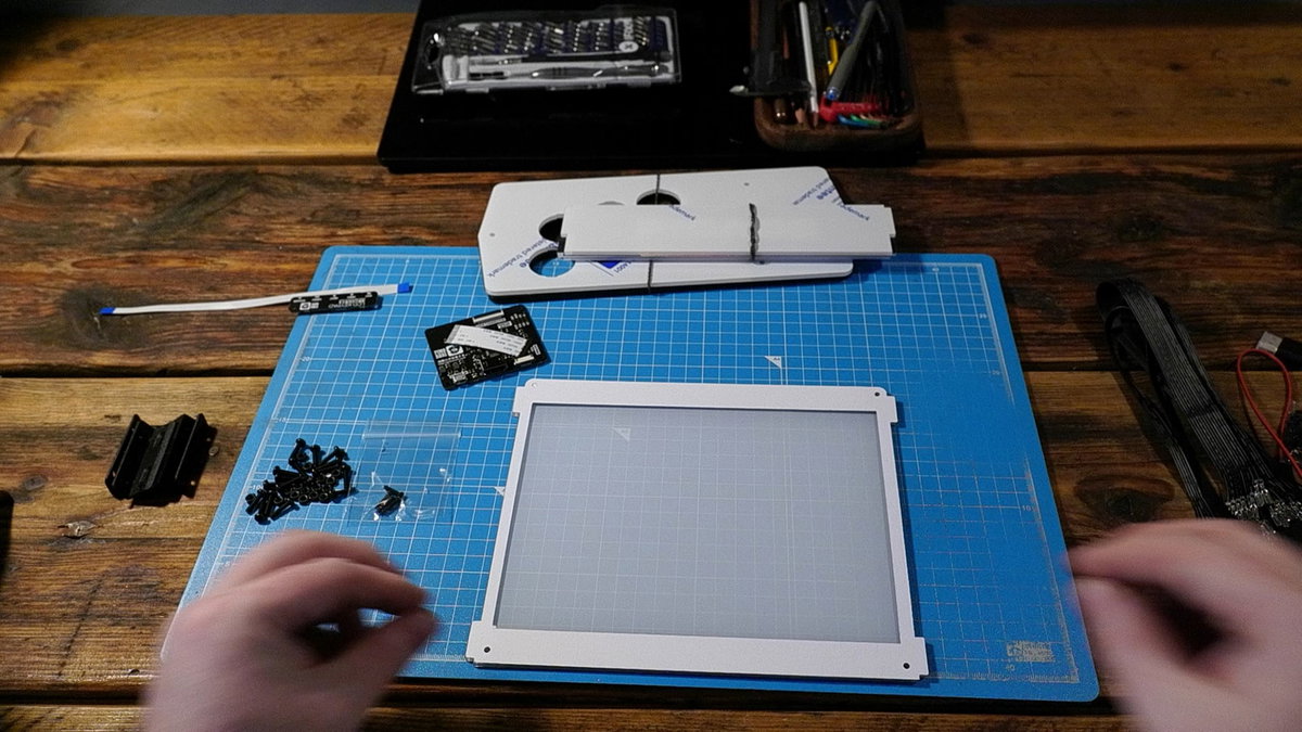

While we've still got some flexibility in the cabinet, now is a good time to build and fit the screen assembly. Set aside the cabinet for now. For making the screen assembly you'll need the printed cardboard screen surround and the large square acrylic screen panel from the CABINET BOX and the LCD screen itself, the four curiously shaped screen mount acrylic pieces labelled with TOP and BASE, the baggie of 4 M2.5 metal flange bolts and the screen driver board, keypad, and associated ribbon cables from the SCREEN box.
All of the acrylic pieces, including the screen acrylic, will have white protective film on. Peel this off each of the pieces as you use them (you can leave on the layer on the outside of the large screen piece until the end of the build to protect it, if you wish). Once you've removed the protective film from the inside of the large screen piece (and from the screen itself) you'll want to try your best not to get any dust, fingerprints, crumbs or pet hair on these inside surfaces, as it will be difficult to get rid of once these pieces are sandwiched together.
The 8" and 10" screen assemblies work slightly differently, make sure to follow the correct set of instructions for your screen size!

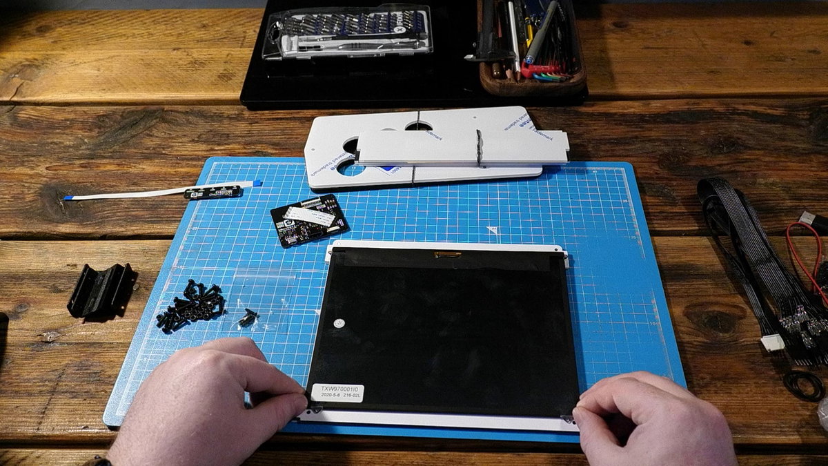

8" screen assembly

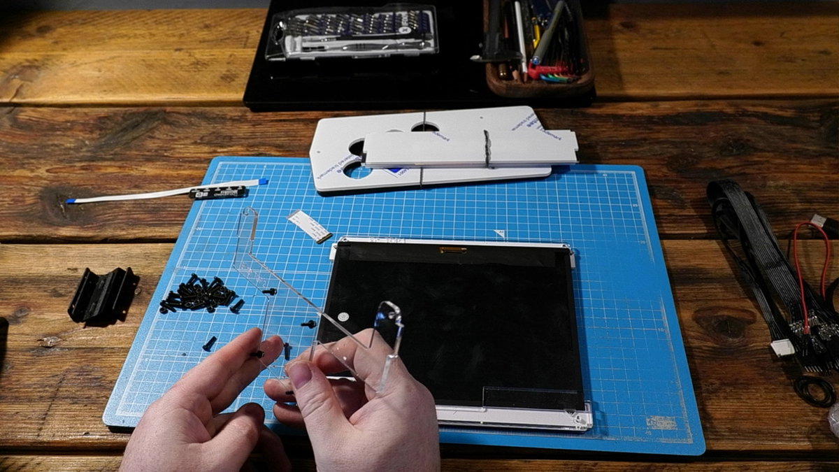

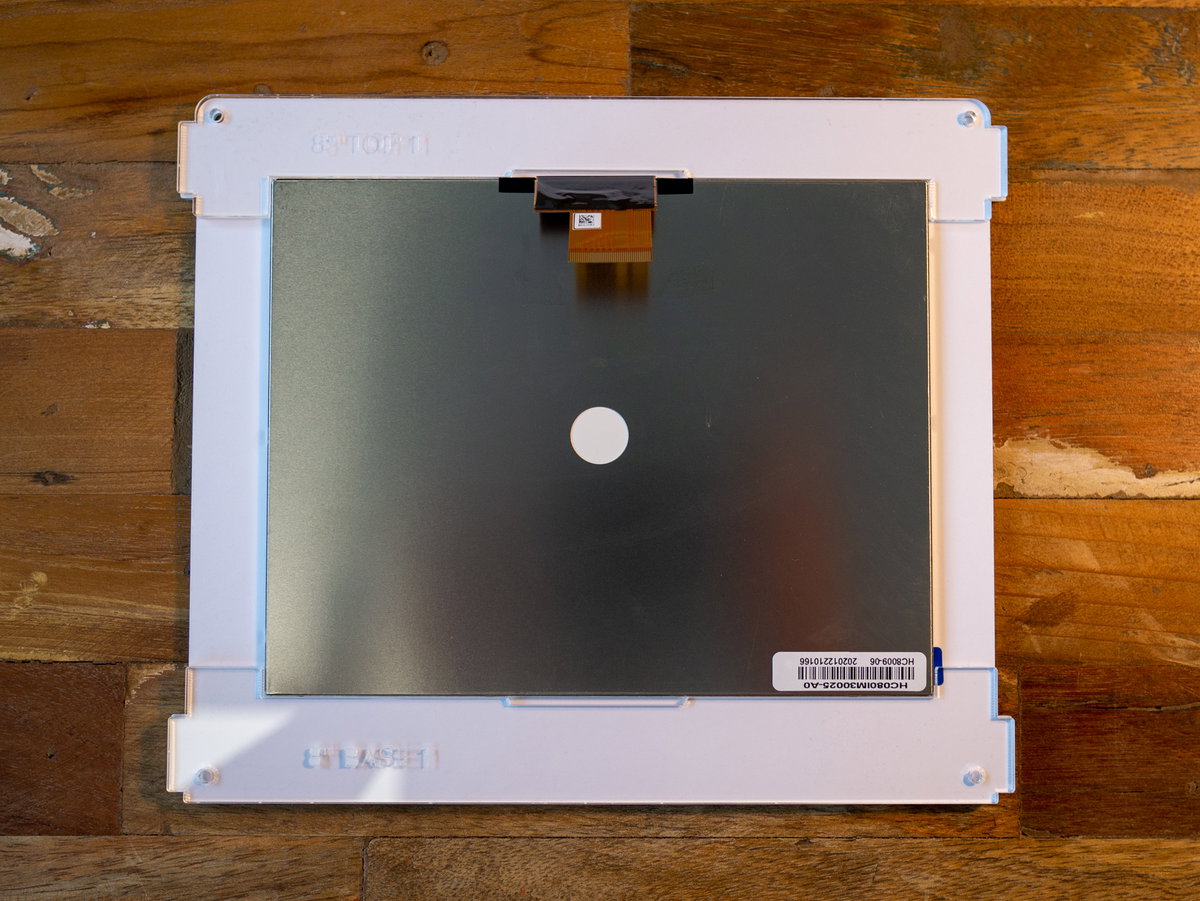

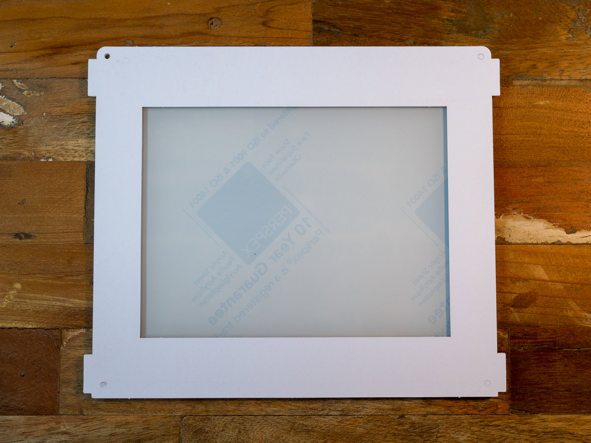

Take the large square acrylic screen panel and lay it down with the tabs on either side, and the curved edge at the top. Place the screen surround artwork face down onto it, also with the curved edge at the top.
Large square acrylic panel with artwork

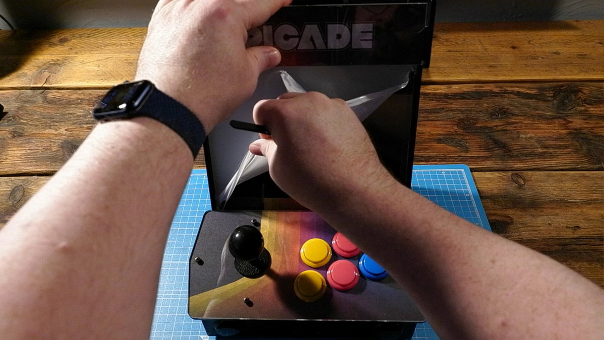

Peel the protective film off the screen using the tab at the side (being careful to avoid fingerprints), and place the screen facedown on top of the cardboard, with the display cable towards the top edge.
8 inch screen facedown on the screen assembly
The two narrow, clear acrylic pieces marked 8" TOP 1 and 8" BASE 1, go at the top and base of the screen and hold it in place. The curved edge of 8" TOP 1 will align with the curved edge at the top of the screen acrylic, and the tabs at the sides should line up with the tabs on the large acrylic screen piece underneath. With all these screen mount pieces, the text should be the right way up and facing you.
Screen assembly with TOP 1 and BASE 1 added

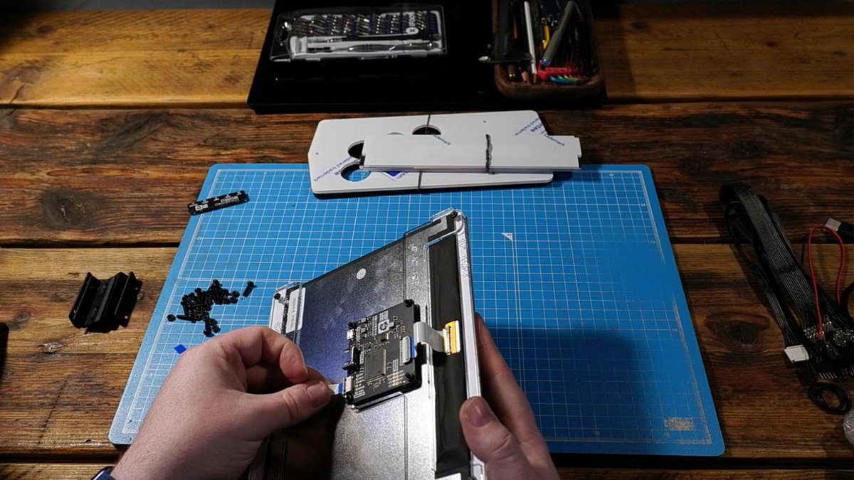

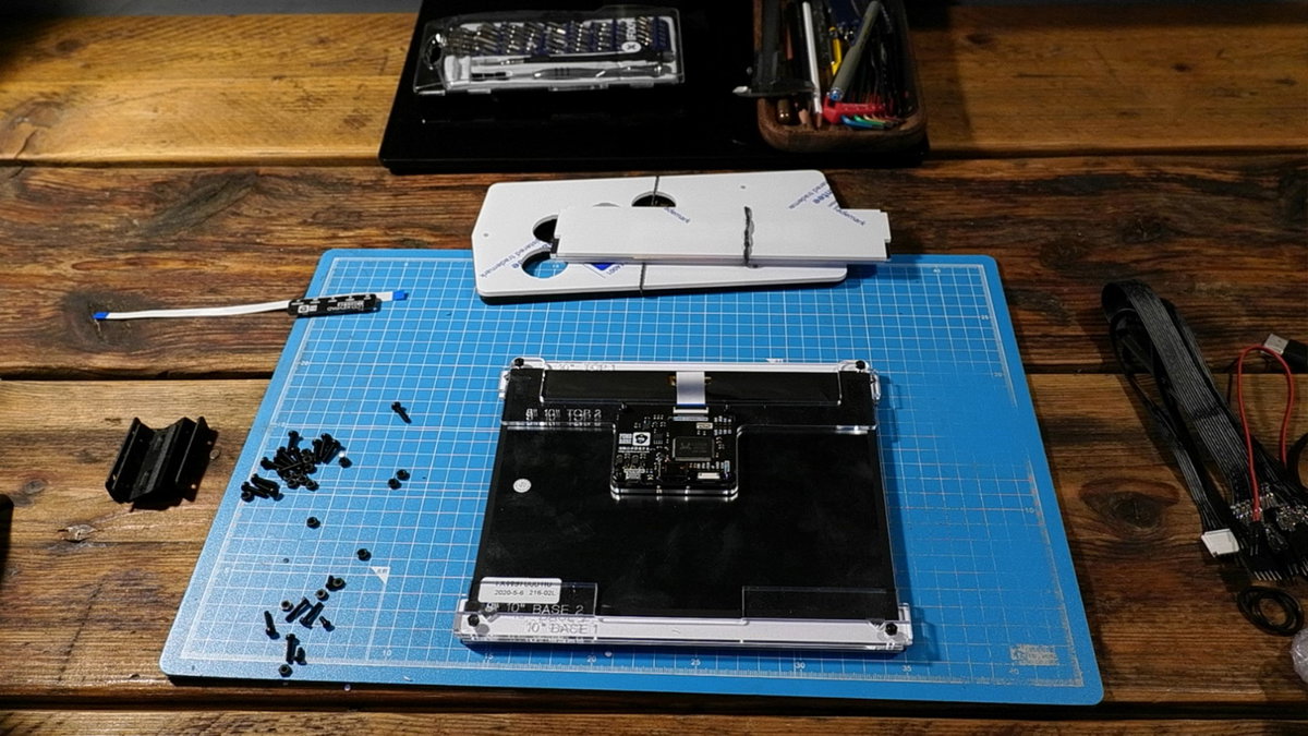

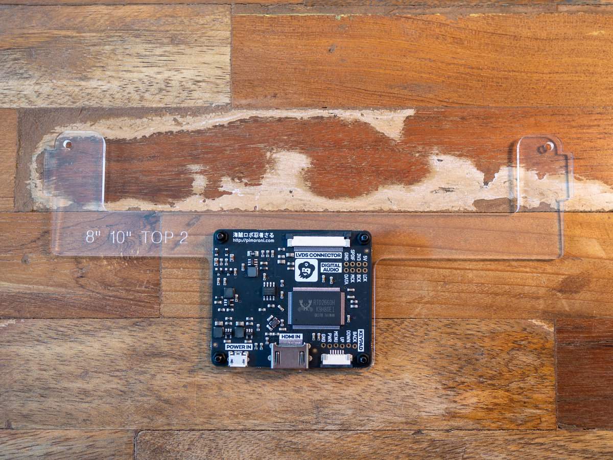

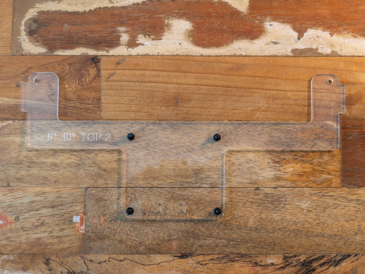

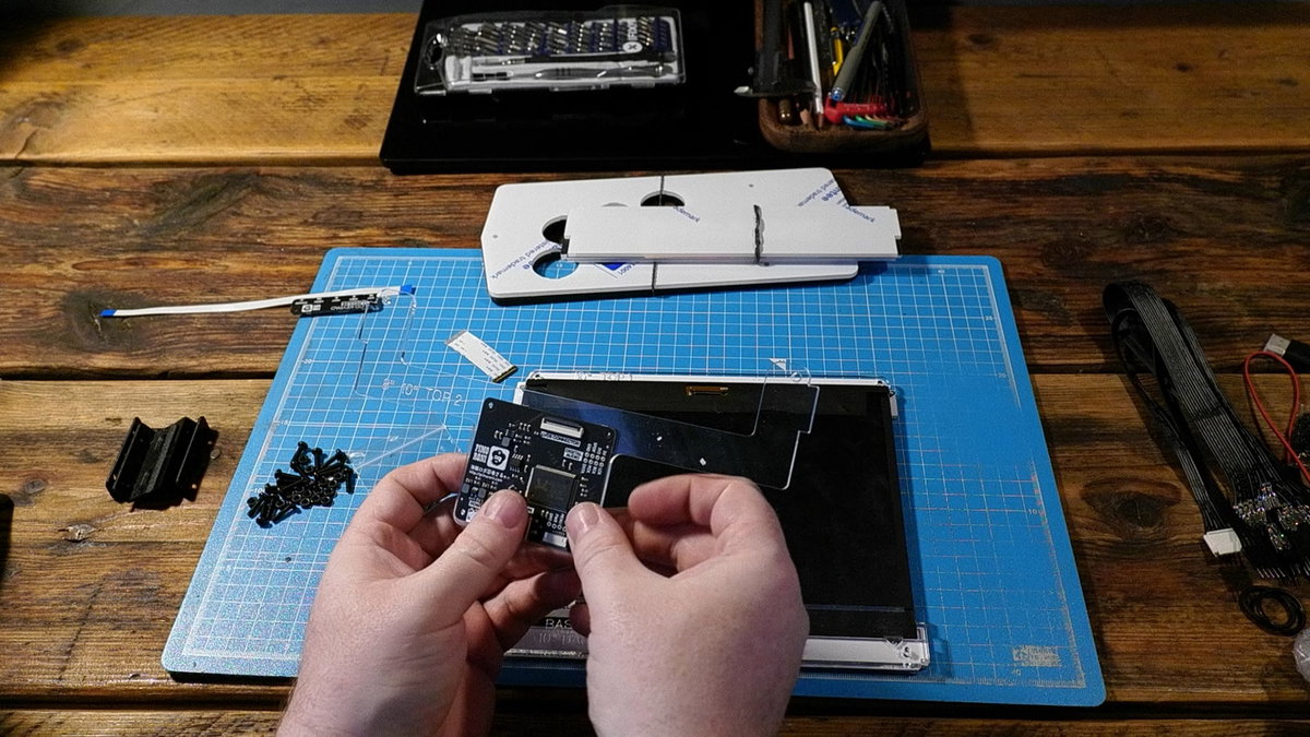

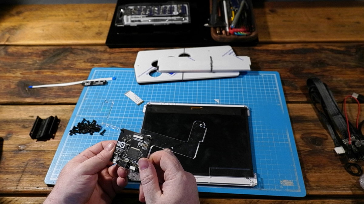

Before adding the final parts of the screen assembly, attach the display driver board to its acrylic bracket. Take the acrylic piece (marked 8" 10" TOP 2), and place it with the protruding part pointing downwards and the text facing you. The bolts used to attach the display driver board to its bracket are the four black metal M2.5 flange bolts in a separate bag. These have low-profile heads, with no slot on top, and prevent the acrylic bracket for the driver board from bending out too far. Use four of the black plastic M2.5 nuts to attach the flange screws.
TOP 2 with bolts and nuts attached
Place the driver board on top of the screws and secure it in place with four more M2.5 nylon nuts, making sure that the HDMI and micro-USB ports are towards the base, and the ribbon cable connector is at the top.
Display driver board positioned on its acrylic bracket

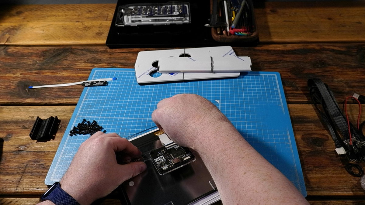

We found it easier to connect the screen to its driver board now, before adding the BASE 2 and TOP 2 screen mounting pieces. The screen cable is built into the 8" screen, which makes this step a little more straightforward. Open the LVDS connector on the driver board by carefully sliding the grey part away from the white part a little bit, towards the top of the driver board. You can then poke the screen ribbon cable down into the slot in the connector. Once it's pushed in as far as it can go, slide the connector back into position - if it's plugged in correctly, the cable should be locked in place.
Screen ribbon cable connected to the display driver board
Place the acrylic piece marked 8" 10" BASE 2 at the base of the screen assembly. Place the 8" 10" TOP 2 bracket with the driver board towards the centre of the screen. You might need to gently encourage the screen cable to flex upwards so that you can line up this acrylic piece. Use four M3 screws, pushed through from the front side of the assembly (with the clear acrylic), to hold the whole screen assembly together, and secure it with four M3 nuts. Be careful not to over-tighten these nuts and bolts or you’ll risk cracking the acrylic.
Acrylic piece marked 8 10 BASE 2 fitted to the screen assembly
You can plug the long narrow keypad cable into the driver board now (though we won't be attaching the keypad until later). The keypad connector is the same type as the one you used to secure the screen cable in place. The blue side of the keypad cable should be facing towards you, away from the board. Note that the ribbon cable for the keypad should go underneath the grey plastic clips on the connectors on both the keypad and display driver board. If you insert the cable on top of the grey plastic clip then you might still get it to fit but it won't work!
Keypad ribbon cable connected to the display driver board
Lay the keypad aside for later. Your screen assembly is done! That's probably the fiddliest bit, so reward yourself with a cup of tea or something nice.

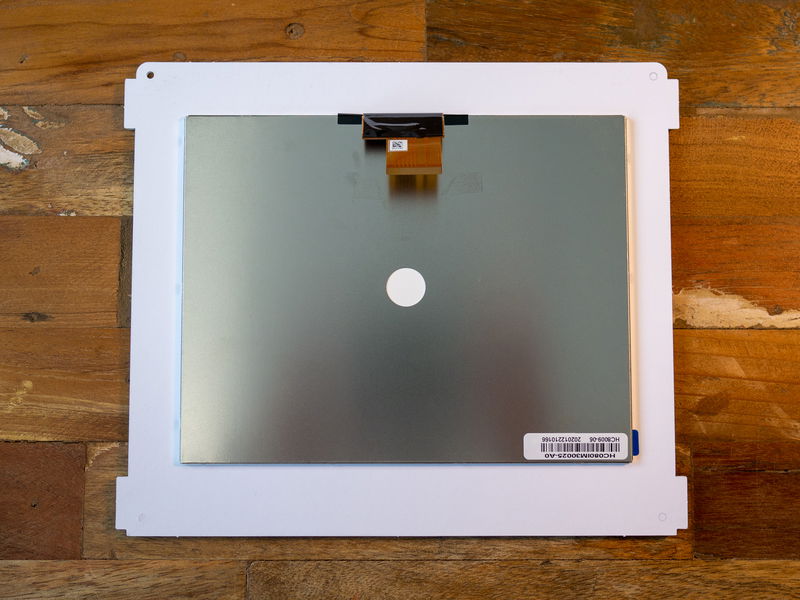

Large square acrylic panel and artwork
Peel the protective film off the screen using the tab at the side (being careful to avoid fingerprints), and place the screen facedown on top of the cardboard, with the display connector towards the top edge.
10 inch screen facedown on the screen assembly

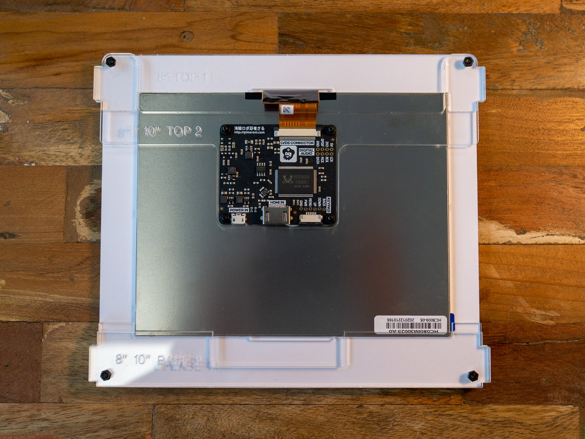

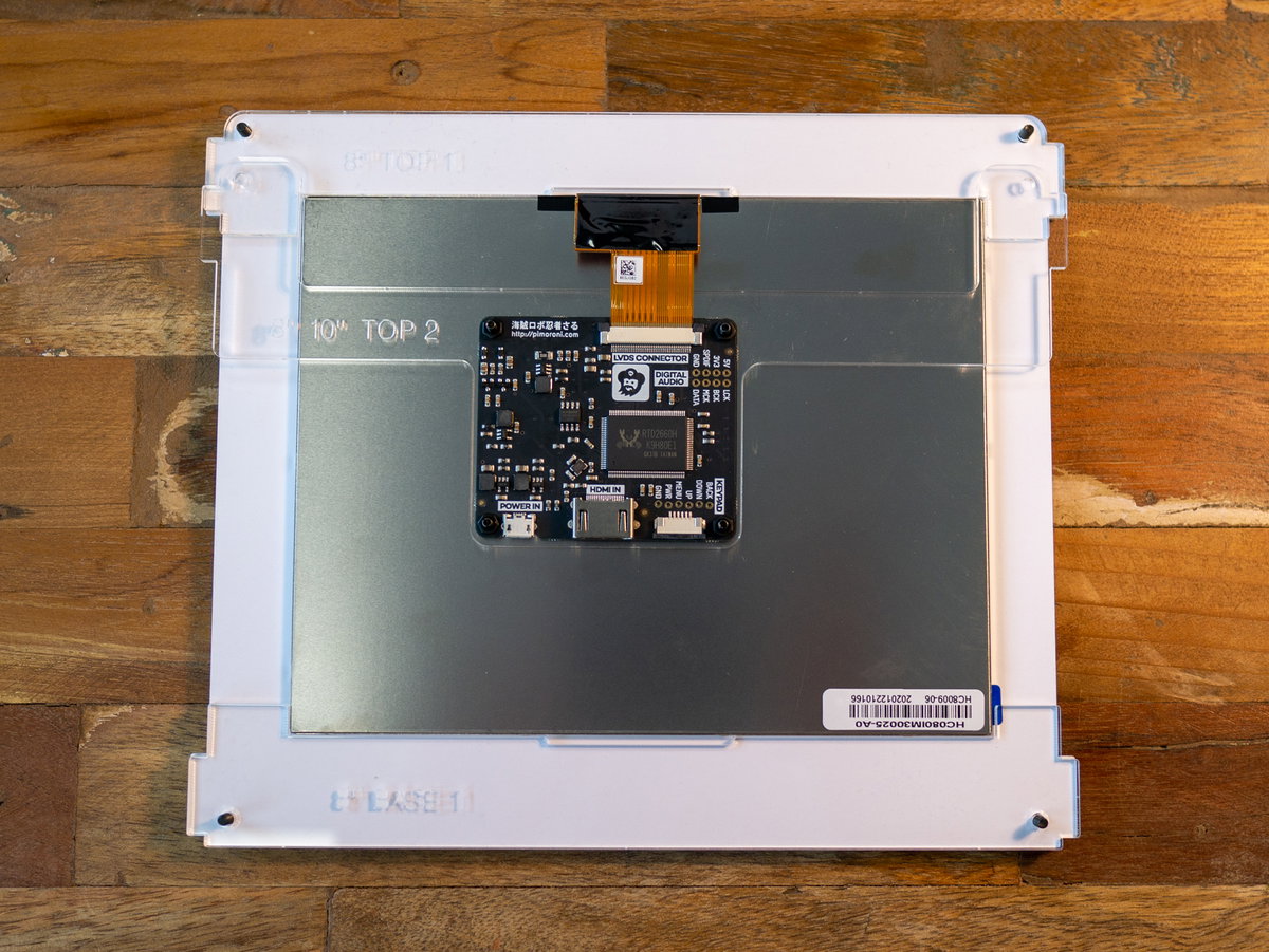

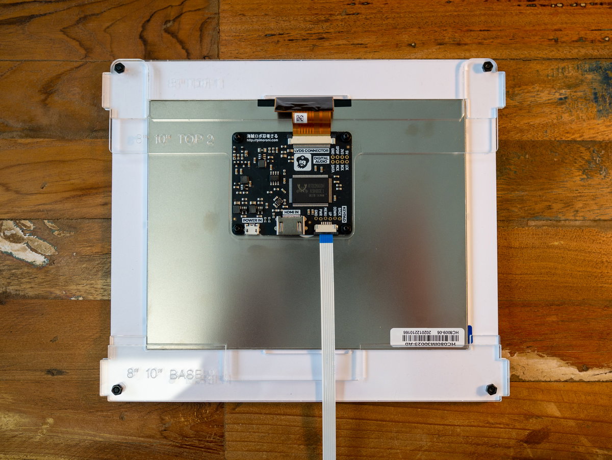

Display driver board in front of the 8" 10" TOP 2 bracket
Black flange bolts and nuts attached to  8" 10" TOP 2 bracket
Push the four M2.5 flange bolts through from the back of the acrylic, and then attach the driver board with four more M2.5 nylon nuts, making sure that the HDMI and micro-USB ports are towards the base, and the ribbon cable connector is at the top.
Display driver board attached to the 10 inch acrylic bracket
We found it easier to connect the screen to its driver board now, before adding the BASE 2 and TOP 2 screen mounting pieces. Locate the small, wide ribbon cable with one gold end and one blue end. Carefully flip up the grey tab of the LVDS connector on the driver board so it's pointing towards you. You should then be able to slot the blue end of the short, wide ribbon cable (with the blue side facing up) into the open LVDS connector, and flip the grey tab back down to secure it. If you have trouble inserting this end of the cable into the connector, check that the grey tab is fully open - take care not to bend it back too far though, as the clips are reasonably delicate.
The gold end of the cable plugs into the screen - the connector should just slide into the gold connector sideways, and once you've got it lined up you should be able to push in gently in using your thumbnail (don't force it). This end doesn't really lock in place, so be careful not to dislodge it when you're repositioning the TOP 2 acrylic piece.
Wide ribbon cable connected between the screen and driver board

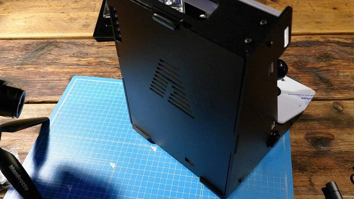

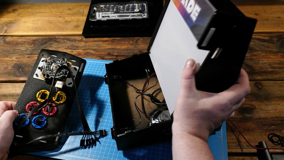

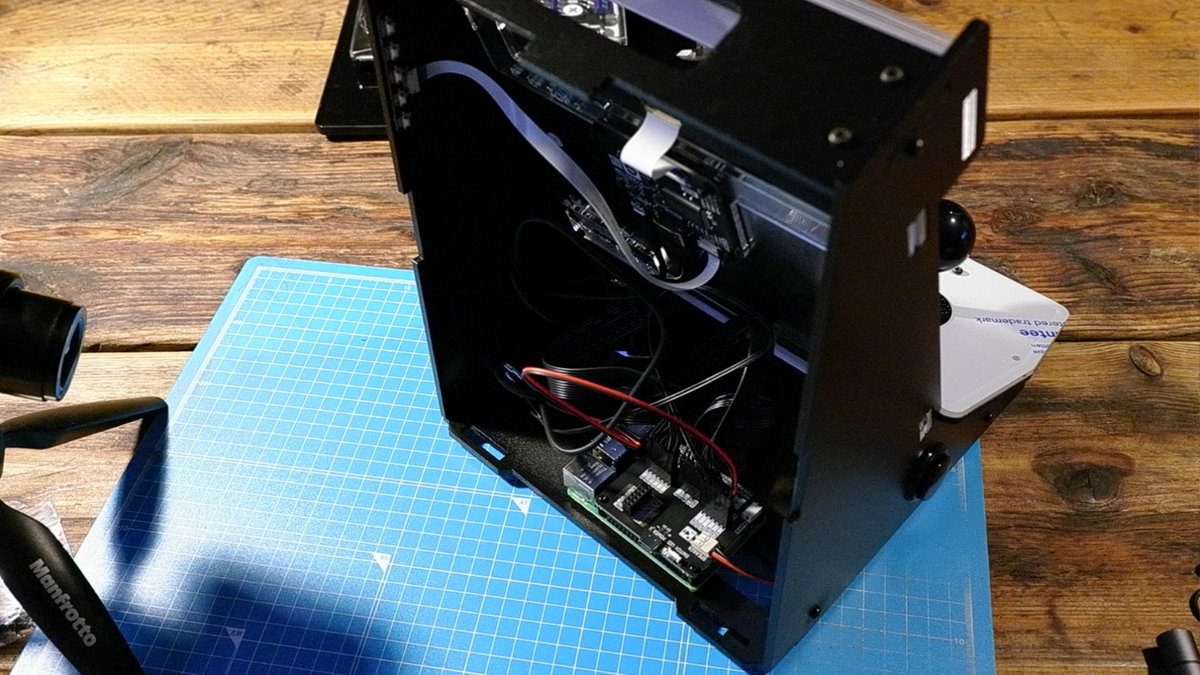

Finishing cabinet assembly
For the rest of the build, the 8" and 10" versions of the Picade go together in exactly the same way. We're about to add the screen assembly to the cabinet, but before you do, you'll want to add two more plastic brackets at the top. Use M3 nuts and bolts to secure them in place through the centre hole as before, they should line up with the slots in the top of the side pieces with the flat surface with two slots facing upwards.

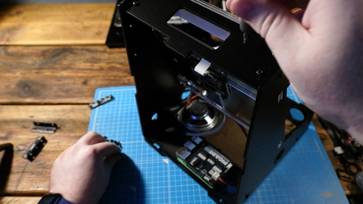

Attaching brackets to the top of the cabinet

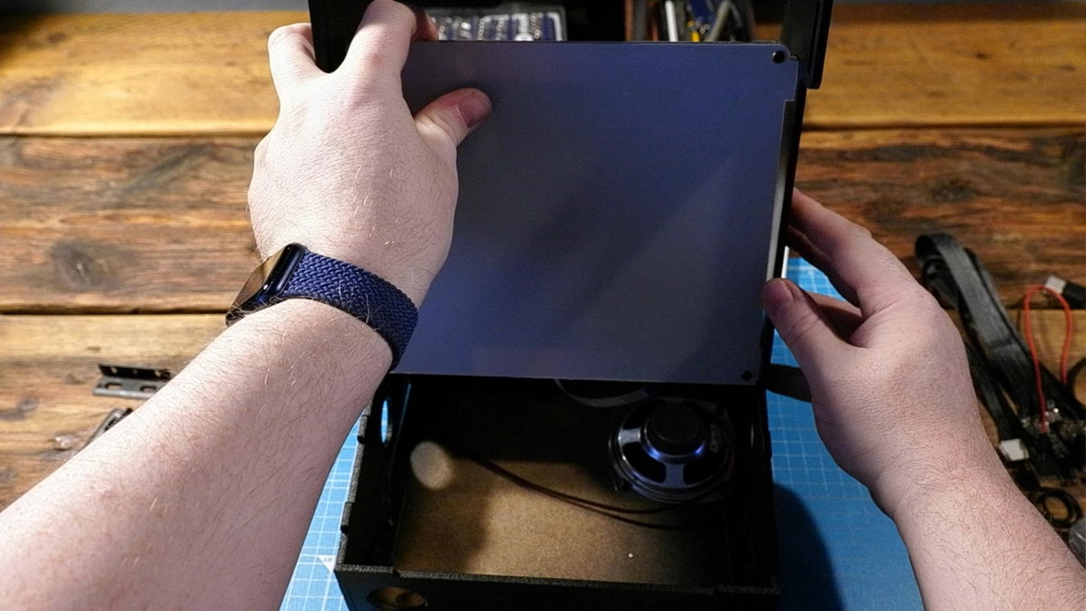

You might find it helpful to turn the Picade onto one of its sides for this next bit, as you'll be wrestling a lot of things into slots at the same time and it's easier to get them lined up if they're supported at one end. You'll need to slot the whole screen assembly into the cabinet (making sure the curved edge of the screen assembly is at the top of the cabinet). The tabs on the sides of the screen assembly should fit neatly into the slots in the side panels, and there should still be enough flex in the cabinet to wiggle them in.
Fitting the screen assembly into the cabinet

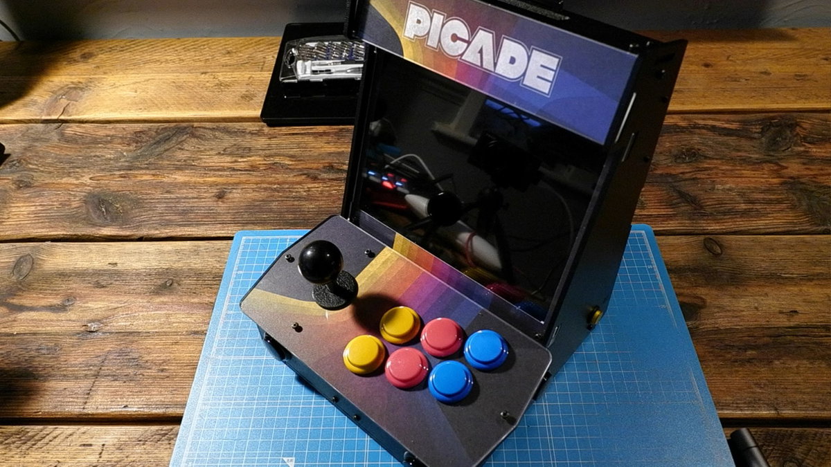

Locate the marquee assembly - that's the bit that sits above the screen with the Picade logo on, and is a long, thin sandwich of two acrylic layers and one paper layer that was originally in the CABINET box (but is now probably in a big pile of leftover bits). Remove all the protective plastic, and re-sandwich the layers back together with the cardboard layer in the middle.
A little masking tape or a rubber band can help to hold the marquee sandwich together (you’ll be able to peel it off easily later). Slot this piece into place into the slots at the top and front of the cabinet, with the Picade text facing forward. Make sure to keep an eye on the screen assembly while you do this as it might fall out of its slots - another pair of hands might be useful for this bit.
Adding the marquee to the front of the Picade cabinet

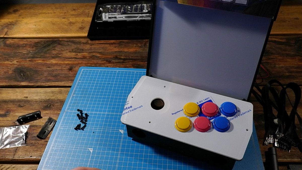

To complete the body of the cabinet, locate wooden panel C (if you haven't attached it already) and slot it into place at the top of the cabinet, with the protuberance for the door closure (or the 'nobble' as we're apparently calling it) pointing backwards, away from the screen - as with the previous step, you might need to hold the screen assembly and the marquee assembly in place while you get everything slotted in. Once everything's in place, you can use four M3 nuts and bolts to attach top panel C to the brackets, which should secure everything. You can now let go of all the things you were holding on to, phew!
Attaching top panel C

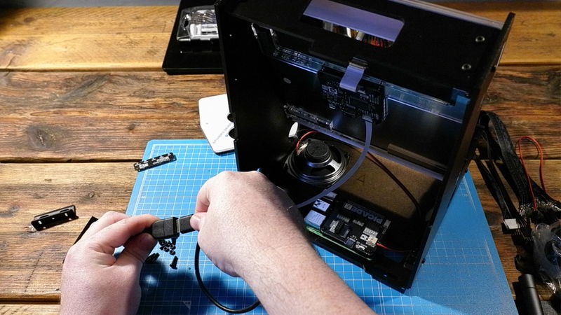

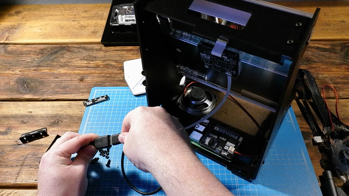

Plugging in the HDMI cable
Now is a good time to plug in your HDMI cable. The big end goes to the HDMI port on the screen driver board, and the smaller end goes to the micro-HDMI port on your Pi.
⚠ Note that a Raspberry Pi 4 has two micro-HDMI display ports - make sure you're plugging your cable into the default one (HDMI-0). It's the one next to the Pi's USB-C connector!

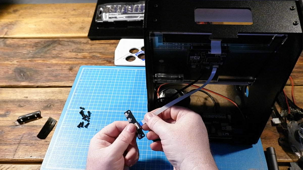

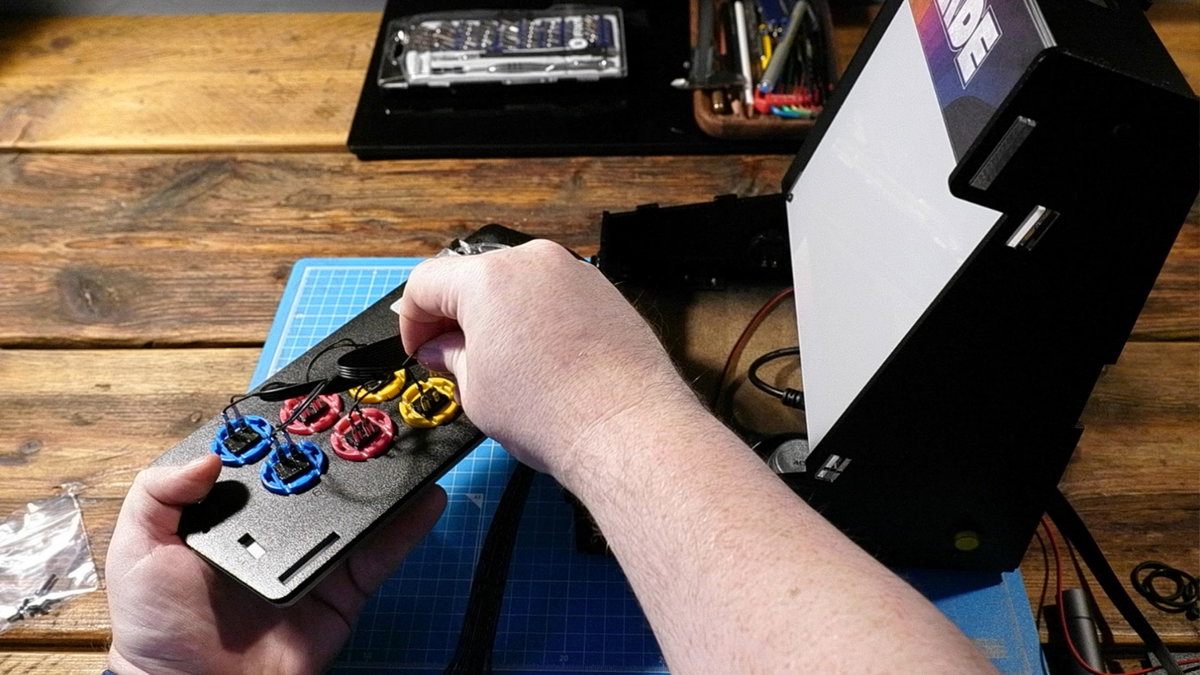

Attaching the keypad
You can now attach the keypad (the small, black board with five buttons) to the end of the narrow ribbon cable. The connector on the keypad is the same as the one on the other end of this cable, and you'll need to plug it in with the blue side of the cable on the same side as the keypad buttons.
Connecting the keypad to the screen driver board
Turn the cabinet round so you're looking at it from the back. There are two holes on the left hand side near the top of panel B for attaching the keypad to the cabinet, line it up with the holes with the ribbon cable pointing towards the screen, and secure it in place with nylon M2.5 bolts and nuts, with the nuts on the inside.

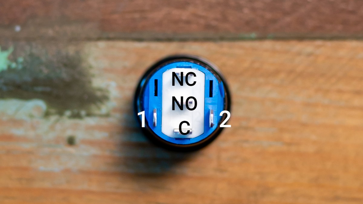

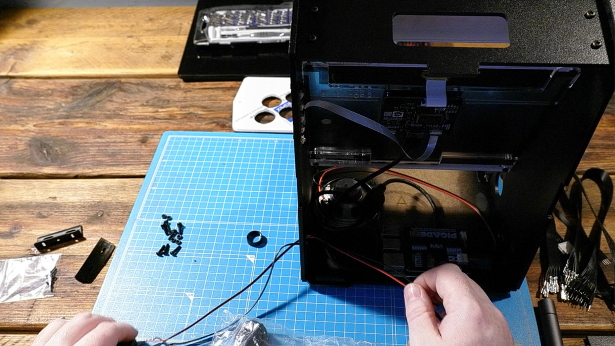

Attaching the power button

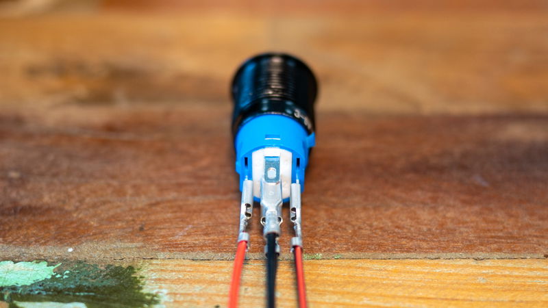

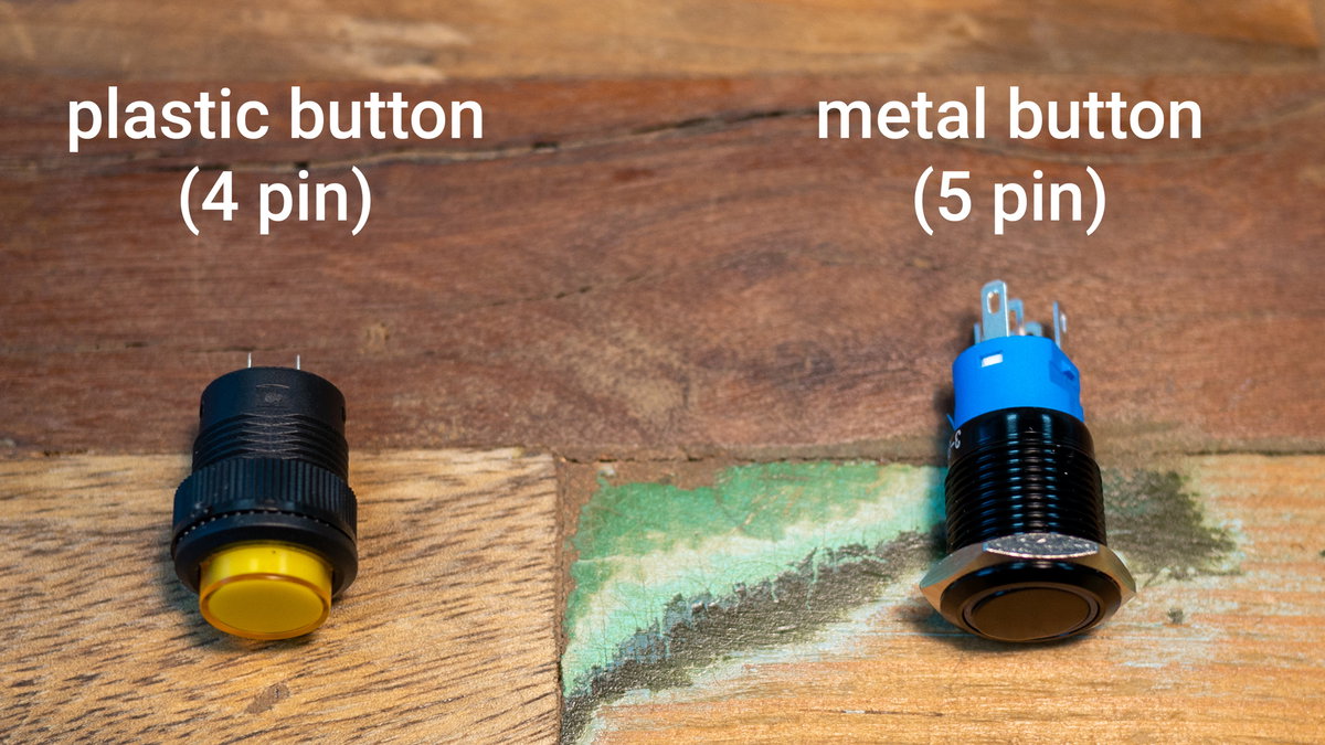

Locate the power button from the bag with the buttons and examine it - you'll either have a black metal button with a yellow ring and five pins, or a translucent yellow plastic button with four pins. You'll also need the red and black power button cable.
Two kinds of illuminated power buttons

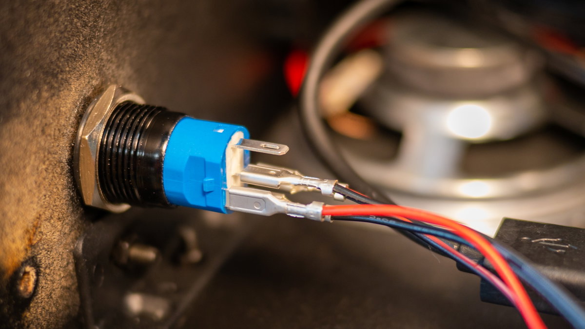

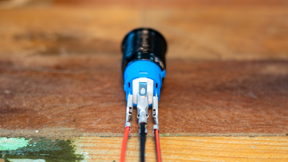

If you have a metal 5 pin power button..
Unscrew and remove the hexagonal metal ring from the button, this will be used to secure it to the cabinet once you've wired it up. You should also have a small rubber o ring that goes with the button, keep this handy.
Metal power button contacts labelled 1, 2, C, NO and NC
There are five contacts on the bottom of this button, labelled 1, 2, C, NO and NC. First we'll connect up the LED part of the button. Push the spade connectors on the red and black wires onto contacts 1 and 2 (the ones sticking out of the blue bit), either way round.
From one of the black wiring looms, tear off a pair of two wires from one end. Plug these spade connectors onto the contacts labelled C and NO (they're the two contacts between the wires that you just plugged in). You'll want to check that none of the metal connectors plugged into the back of the button are touching each other, you can gently bend the contacts slightly to separate them if they are.
Wires connected to the power button
You can then thread both sets of wires through the hole in panel B from the outside, followed by the button, and then secure it in place using the hexagonal metal ring. We put the o ring on the inside of the Picade (in between panel B and the metal ring) to help stop the button from spinning round, but you could put it on the outside or leave it out completely if you prefer.
Power button secured in place
We'll wire up the Picade X HAT end of these cables later on. Now is another good time for a break, before we get started on the final stretch!
If you have a plastic 4 pin power button...
Unscrew and remove the black collar on the button, this will be used to secure it to the cabinet once you've wired it up. The two contacts at the centre of the button are marked with a + and -.
The contacts on the illuminated power button can be a little fragile and the spade connectors on the wires a little tight which means it's possible to make the contacts disappear into the body of the button if you push on them too hard. If the contacts on the button don't slot into the spade connectors easily we'd suggest loosening the connectors on the wires slightly by prying them open with a flat-headed screwdriver, you can then crimp them gently with pliers once attached. With this in mind, gently push the spade connectors on the cable onto the contacts, red to + and black to -.
From one of the black wiring looms, tear off a pair of two wires from one end. Plug the spade connectors onto the other two contacts on the power button, it doesn't matter which way round these ones go. You'll want to check that none of the metal connectors plugged into the back of the button are touching each other, you can gently bend the contacts slightly to separate them if they are. You can then thread both sets of wires through the hole in panel B from the outside, followed by the button, and then secure it in place using the black collar.
Connecting the plastic power button
Building the console assembly
The last bit to assemble is the console assembly, where the buttons and joystick live. Locate the sandwich of wood, cardboard and acrylic with lots of holes in. Line the three pieces up so the button holes match and the printed cardboard is facing the acrylic. Remove the inner protective layer on the acrylic - you can leave the outer protective layer on until the end of the build if you wish.
Poke the yellow, pink and blue buttons through the six holes in the console sandwich from the outside. The canon arrangement is yellow on the left, pink in the middle and blue on the right to match the artwork, but feel free to arrange them however you wish!
Slot the console assembly on the tabs on the front of the Picade. The buttons should be on the right, and the stripes on the screen assembly and console assembly artwork should match up.
Console assembly with coloured buttons in place

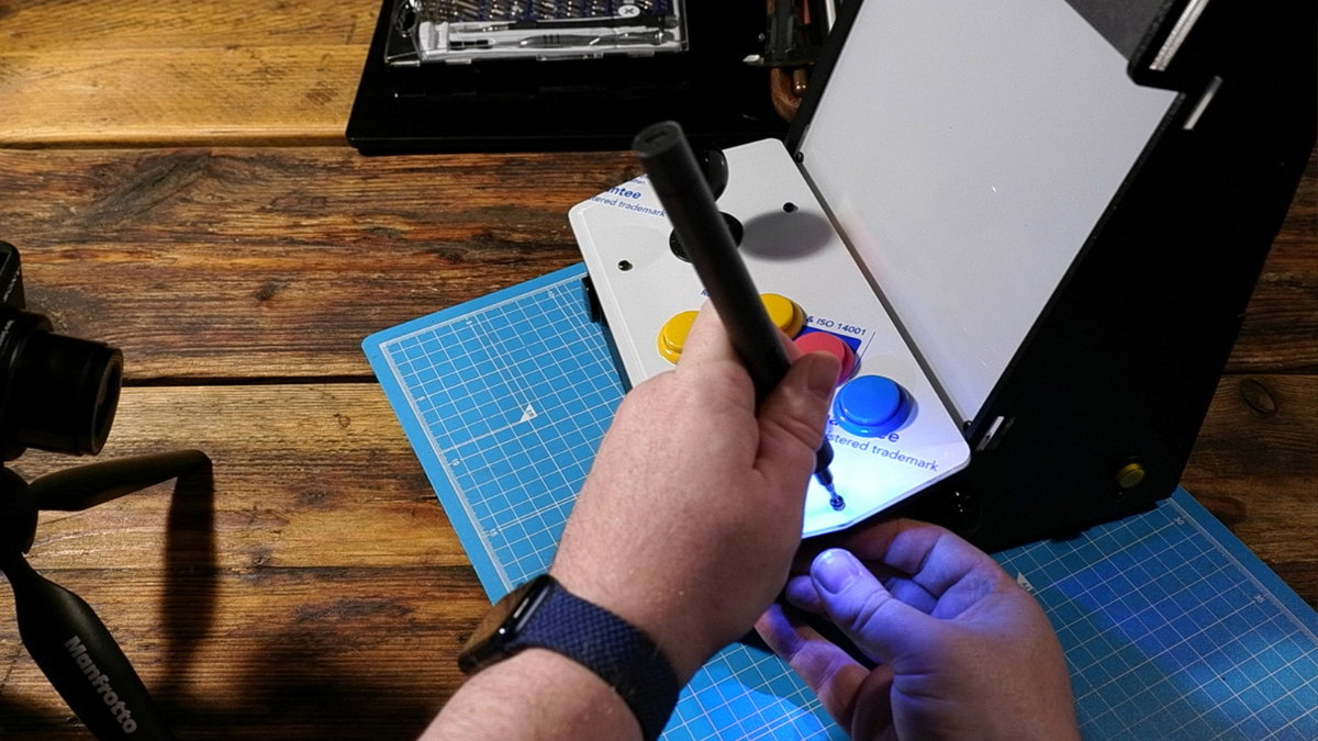

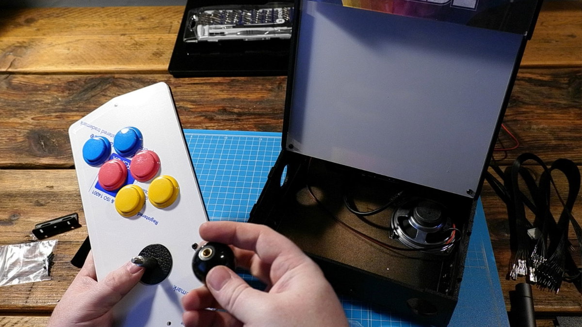

We're now going to attach the joystick! Peel off the protective plastic on top of the joystick, and then locate the set of five pins - these are what you'll plug the joystick connector cable into. They sometimes get a bit bent in transit, but you should be able to straighten them out with your fingers. Poke the joystick through from the bottom of the console assembly, and orient it so the pins are pointing towards the buttons. Fasten it in place with M3 bolts through the holes at the top and bottom of the joystick, and nuts on the inside - take care not to over-tighten these nuts and bolts or you’ll risk cracking the acrylic.
Pop the dust cover collar over the joystick, and attach the ball on top. You can use a flat-head screwdriver to hold the shaft of the joystick from below while you tighten up the ball, if necessary.
Fitting the joystick to the console
Note that the bolts used to attach the joystick are only slightly larger than the holes on the metal joystick plate, however the holes in the plastic and MDF console pieces are spaced slightly further apart than the holes on the metal joystick plate so that the nuts grip over the edge of the holes when tightened. This is an intentional feature of the design, and your joystick will still be firmly attached.

Wiring the buttons and joystick
Back to the black wiring looms with spade connectors on one end! You're going to need one set of twelve wires (for the coloured buttons on top), and one with eight wires for the side and front buttons, so remove another pair of wires from the one that you stole a pair from earlier and set it aside.
Take the set of twelve wires, and separate the strands a bit into six pairs at the end with the spades. This will help when connecting them up. Flip the console assembly upside down so you can access the buttons easily, and working from one side of the cable, connect each pair of spades to each button from 1 to 6 (marked on the underside of the console).
Wiring up the front buttons

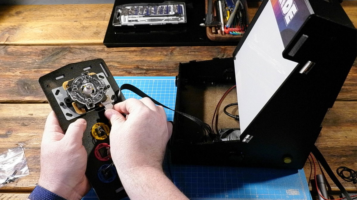

While you're looking at the underside of the console, take the opportunity to plug in the joystick cable (that's the one with five wires and a white plastic clip on the end) The white plastic clip pushes onto the five pins on the joystick, with the locking clip facing you (and the exposed metal on the connector pointing towards the wooden layer of the console assembly).
Underside of the Picade console showing button wiring
Before you put the console assembly back on the cabinet, take the other wiring loom (with eight wires) and separate the strands a little into four pairs at the end with the spades. Taking each pair in turn, connect them to the ENT, ESC, 1UP, and COIN buttons.
Console assembly with buttons and wires attached
Poke all three sets of wires through the cabinet towards the Picade X HAT and place the console assembly back in place on the cabinet (best to not fasten it on yet, in case you need to adjust any of the wiring).
Wiring everything into the Picade X HAT
You should now have five sets of wires at the back of the cabinet ready to be connected to the Picade X HAT (six pairs from the coloured buttons, four pairs from the side and front buttons, one black pair from the power button, one black and red pair from the power button, and five wires from the joystick, all ending in Dupont connectors (that's the ones with the pins)).
Before things get too busy with the wiring, we'd suggest plugging in the micro-USB cable that provides power to the screen. The small micro-USB end goes into POWER IN on the screen driver board, and the big USB-A end goes into one of the USB ports on the Pi.
Before plugging in the joystick cable to the Picade X HAT, take a peek at the underside of the console assembly again. The GND wire is marked 1 on the white joystick connector. Follow this wire to the other end (the wires all have different markings, so this should be straightforward) and plug the pins into the JOYSTICK header on Picade X HAT, making sure that the GND wire goes to the appropriately marked header.
If your joystick only has one direction that works later when it comes to mapping the controls, then the wires have been connected back-to-front. Simply remove the pin connectors from the JOYSTICK header on the Picade X HAT, flip them 180 degrees, and plug them in again.
To connect the coloured buttons, take the six pairs of pins at the other end of the cable and connect them to the header marked BUTTONS from 1 to 6 (the orientation of the pairs of pins doesn’t matter, as long as each pair of pins corresponds to one button). If you've plugged them in order, it should be easy to figure out what pair of wires is associated with each button, although it doesn't matter a huge amount which button is connected to which position, as you'll be configuring the buttons in software later on.
Connect the front and side buttons in the same way, to the ENT, ESC, 1UP and COIN headers.
The pair of black wires from the power button should go into the header labelled ON, and the red and black wire goes into the header labelled LED. If you have a 4 pin power button, make sure the red wire goes into the header labelled + (that's the one furthest away from you) and the black wire goes in to the one marked -.
Picade X HAT with buttons plugged in

All that's left to do now is to put the back of the cabinet on - with the good side facing outwards, slot the two tabs at the bottom of panel F into the slots at the base of the cabinet, and the protrusion on panel C into the slot at the top - you might have to flex the top of the cabinet slightly to get it in. Pop one of the o-rings over the nobble to keep everything in place.
Picade rear panel fitted with its good side facing outwards
Peel off the protective layer on the front of the screen acrylic and console acrylic if you haven't already, and you're done!
Protective film being removed from the front of the screen
Completed Picade with the screen protective film removed

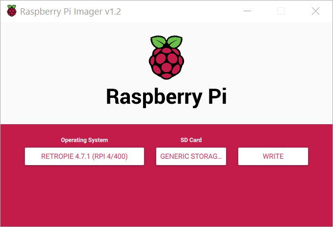

How to write RetroPie to your SD card

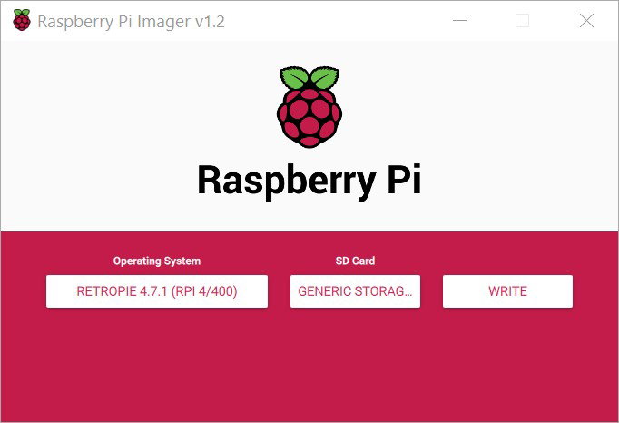

We recommend the RetroPie operating system for your Picade! You can write it to your SD card with Raspberry Pi Imager, available for Windows, Mac and Linux. Once you've downloaded it, plug your micro-SD card into your computer, open up Raspberry Pi Imager, and click on the first box to select RetroPie - you can find it under the 'Emulation and Game OS' category. Make sure to select the correct version for the kind of Raspberry Pi you're using! In the second box, select your SD card then click on the write button!
Raspberry Pi Imager with the RetroPie operating system selected
We'd recommend only using official RetroPie images with your Picade, as we've found that third party images often have custom configurations and default button mappings which can interfere with our install script.
Once Raspberry Pi Imager has finished, pop your freshly burned micro-SD into the slot on the underside of your Pi. You'll need to plug a USB keyboard into your Pi the first time you boot it to allow you to configure the Wi-Fi.

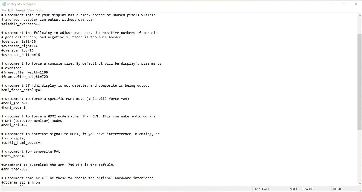

If you get a 'No Signal' message on your screen when it's booting up, you'll need to do little jiggery-pokery to get it working. Raspberry Pi OS (which RetroPie is based on) initialises its display before it initialises its USB ports, so because we're powering the screen from the Pi's USB ports it's not being detected on boot. We'll need to add a line to the Pi's config.txt file to get it to do things in the right order! There's a couple of ways you can do this:

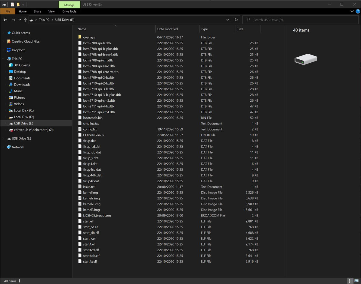

If you've got a computer with a microSD card reader you can plug the SD card back into your computer (unplug the Pi before you take out the SD card), and navigate to the SD card in Windows Explorer (or equivalent file manager). Because the SD card is now formatted for Linux, a Windows computer might give you a message about there being a problem with the drive, don't let it try and fix it :)
Windows file manager showing the Picade SD card
Open up config.txt in a text editor such as Notepad, and scroll down until you find the hdmi_force_hotplug=1 line.
config.txt open in Notepad with the hdmi_force_hotplug setting visibleDelete the # from the beginning of this line, save the file, put the SD card back into your Pi and try powering it up again!
Alternatively, you can edit config.txt from your Pi. To do this you'll need to unplug the USB cable connecting the Pi to the screen and power the screen from an external power source (such as a microUSB power supply or phone charger), so you can see what you're editing! Once you've got an image on screen and RetroPie has loaded, press F4 to exit the RetroPie GUI. Type sudo nano /boot/config.txt to open up config.txt in a text editor, and delete the # from the beginning of the hdmi_force_hotplug=1 line as above. It's ctrl-x and then y and then enter to save the file when you're done.
