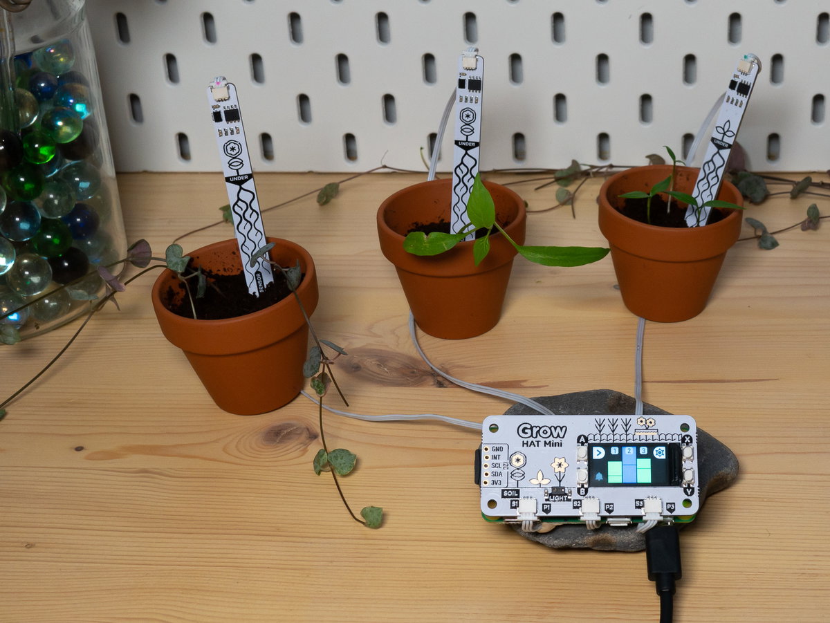

Grow monitoring setup
Please excuse the droopy chilli, it perks up by the end of the tutorial.

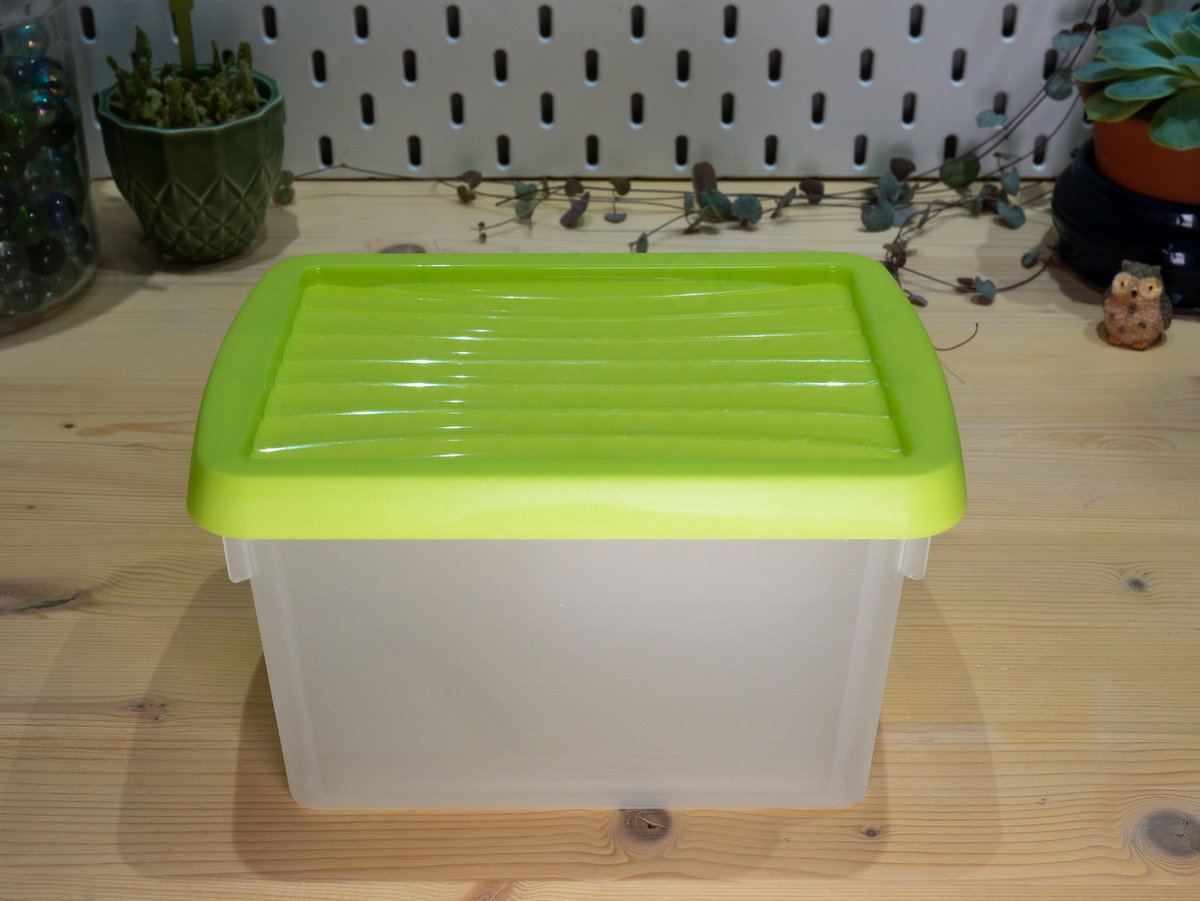

Selecting a water reservoir
The plastic box we
We've selected this 1.5L Whambox as our water reservoir as we had it lying around from back when we were allowed to go to shops, but we'd encourage you to use whatever suitably sized plastic box you have to hand. Ice cream boxes, the tall plastic boxes laundry pods and dishwasher tabs come in, or Really Useful Boxes (Reight Useful Boxes if you're from Yorkshire) would all be good candidates - you'll want something big enough for all your pots to stand comfortably on top of, and at least 3 inches deep. In a pinch (or while you're prototyping) mugs would also work as your water reservoir though you might need more than one to make room for all your pumps.

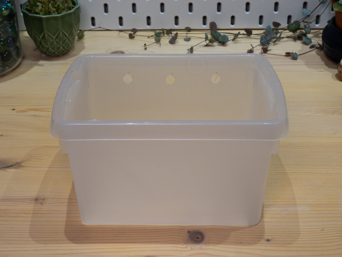

Making holes in your reservoir
After peeling off (or covering up) any unsightly labels, you're ready to make some holes for your tubes. An 8mm drill bit (or a step drill bit) is probably the neatest way of doing this, but you can also use a dremel to make the holes, or a soldering iron or hot skewer to melt them (if you choose the last option, make sure to do it in a well ventilated area).
Assuming you've got three pots and three pumps, you'll need three holes - we made ours about an inch down from the lid and spaced out them out so they'd line up with the pots once we sat them on top, and we drew on the hole placements with marker pen before we started drilling in case we forgot what we were doing halfway through.
Plastic box with holes drilled for tubes

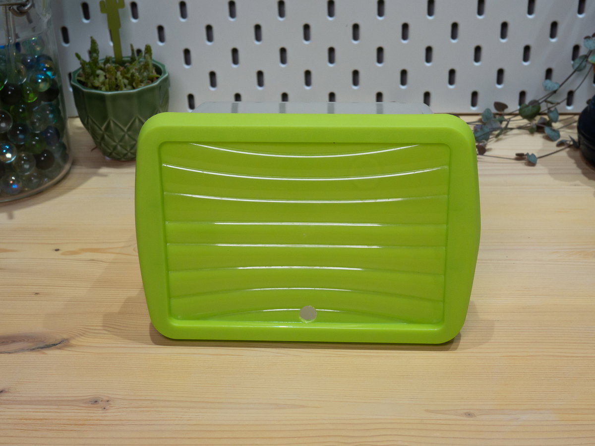

You'll also need a hole for the wires that connect the pumps to Grow HAT Mini to go through. We're planning on putting our Pi in front of our pots, so we made another 8mm hole near the front of the lid.
Hole drilled in lid for pump wires
If you've got room, you could also make another larger hole in the lid so you could fill up the reservoir without taking the lid off.

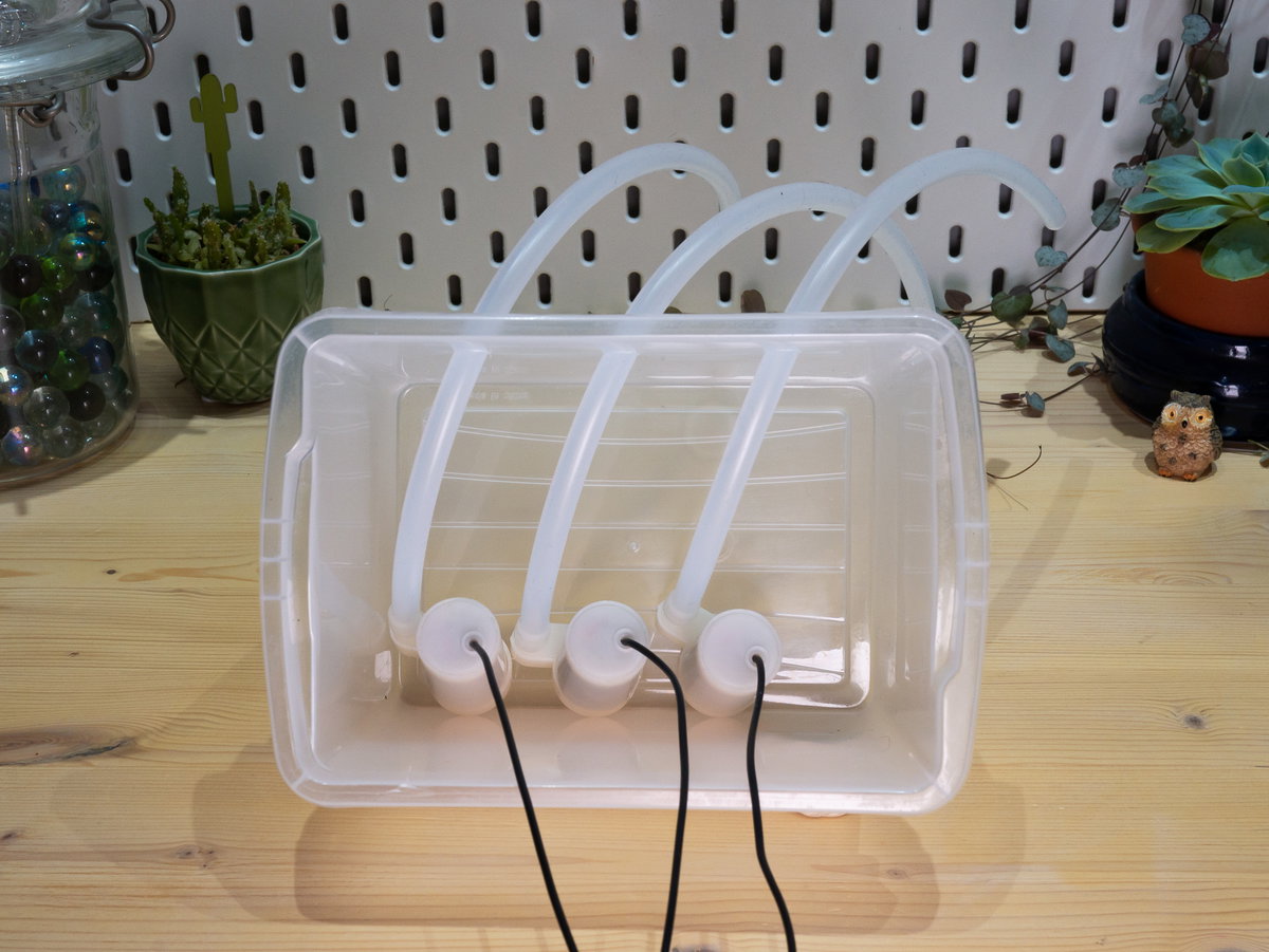

Locate your tube and chop it into three equal lengths. Depending on how you're positioning things, the tubes might end up being a bit long, but you can always adjust them later. Poke the three lengths of tube through the holes in the back of your water reservoir, and then plug the ends of the tube into the outlets on the pumps.
All three pumps in the box with tubes attached
We then threaded the pump wires through the hole in the top, and popped the lid on. You could fill up the water reservoir here if you wanted to avoid having to backtrack later on.

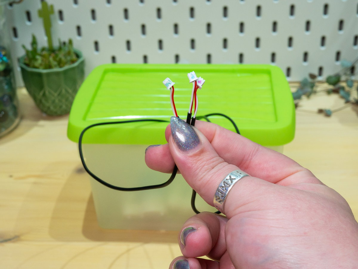

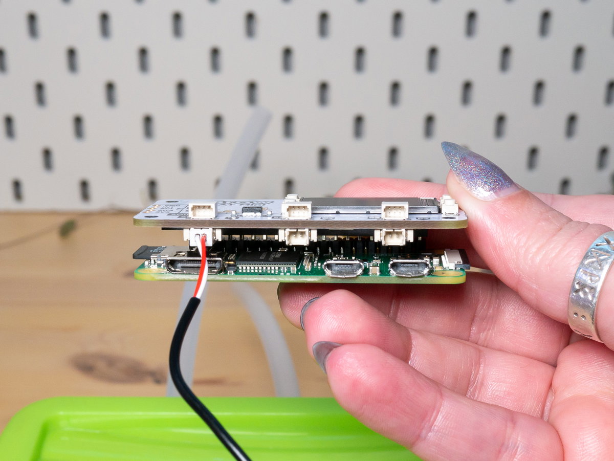

The pumps connect to Grow HAT Mini via two pin Picoblade compatible connectors. These plug into the back row of ports which are slightly squarer than the ones for the moisture sensor wires. You'll want to make sure the pumps are plugged in to the HAT so that they match with the correct moisture sensor for the pot they'll be watering (so the pot containing the sensor attached to S1 should be watered by the pump connected to P1) . It could be helpful to draw coloured dots on the connectors and the sensors themselves so you can keep track of which one is which and match them up correctly.
The connectors on the pumps
The connectors will only go in one way round, so if they don't fit, try rotating them. If you need to remove them, make sure to pull on the plug rather than the wires so you don't detach the wires from the connector.Plugging the pump connectors into Grow HAT Mini
Once you've plugged them all in, you can poke the pump wires back down into the water reservoir so they're out of the way.

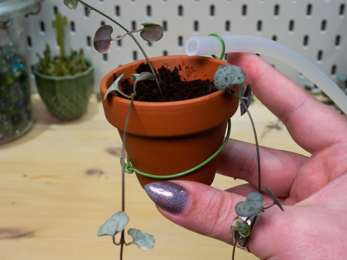

Firstly, you should make sure the tube end is securely fastened in place over the pot - if it comes adrift, water is likely to go places it shouldn't. Secondly, you should aim to have the tube end positioned well away from the surface of the soil to avoid soil being sucked back down the tube at the end of a watering 'pulse' - if soil gets inside the pump it could jam or damage it.

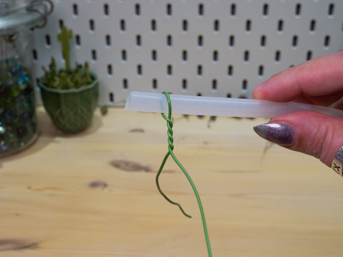

We're making a loop out of gardening wire to hold the end of the tube in place, you could also use craft wire or even electrical wire if it's the kind that holds its shape. Something galvanised or plastic coated is better so that it doesn't rust. Cut a length of wire about 10" long, find the middle and twist it into a loop around the tube.
Twisting the wire round the tubeTwist the 'stem' a few more times, then wrap the ends around the pot and twist to secure.
Using the wire to attach the tube to the plant pot

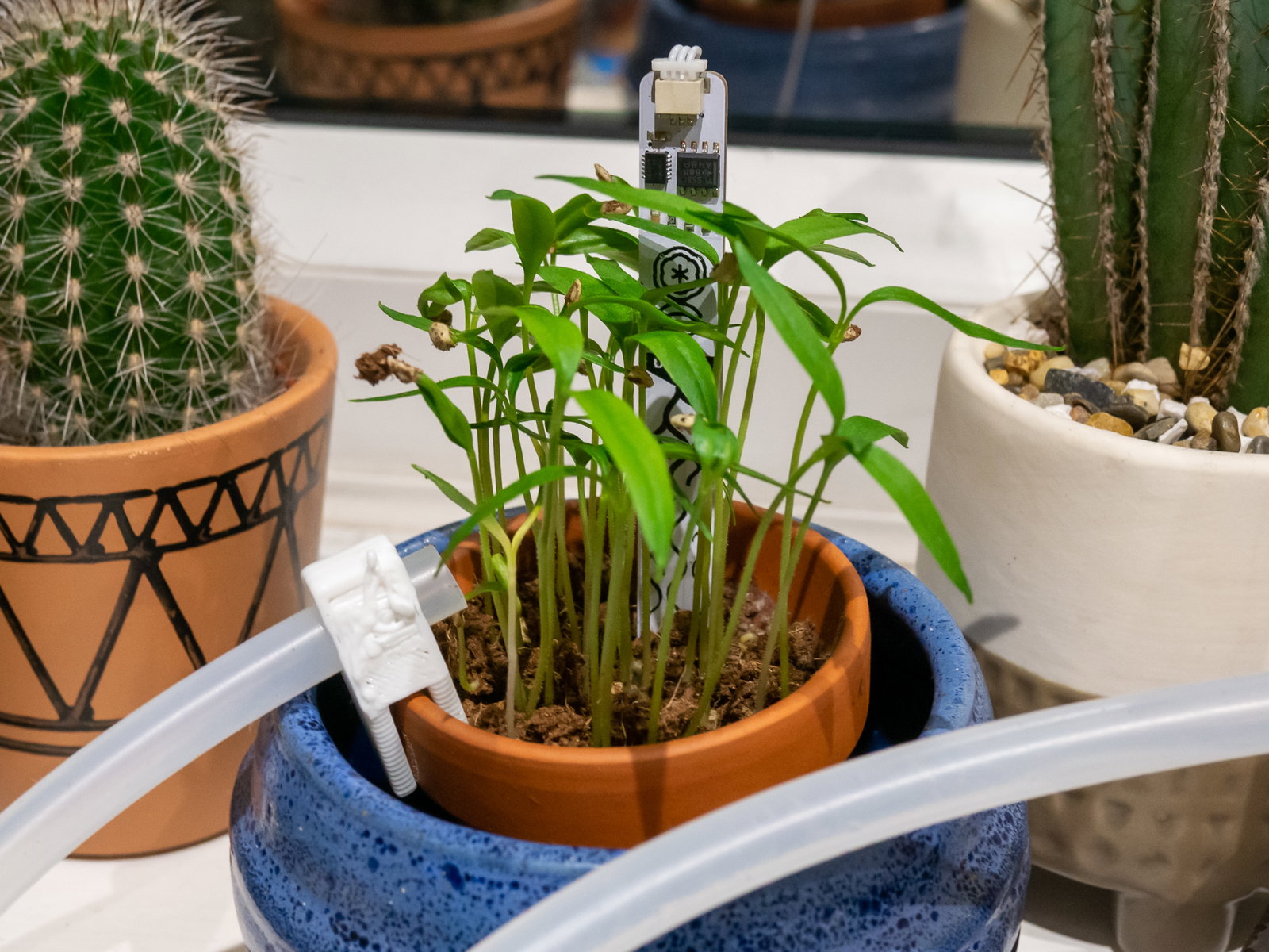

Alternatively, if you've got access to a 3D printer you could give these little custom widgets a go!

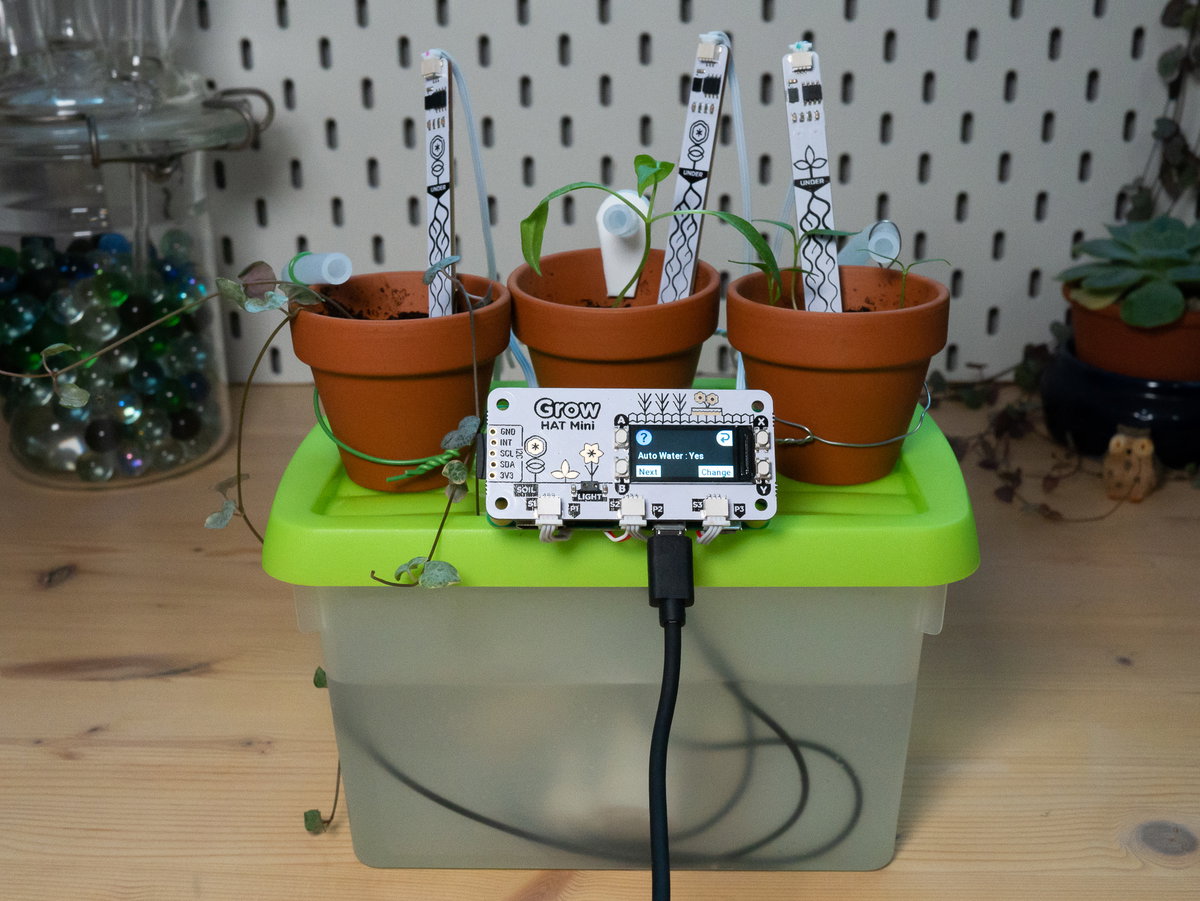

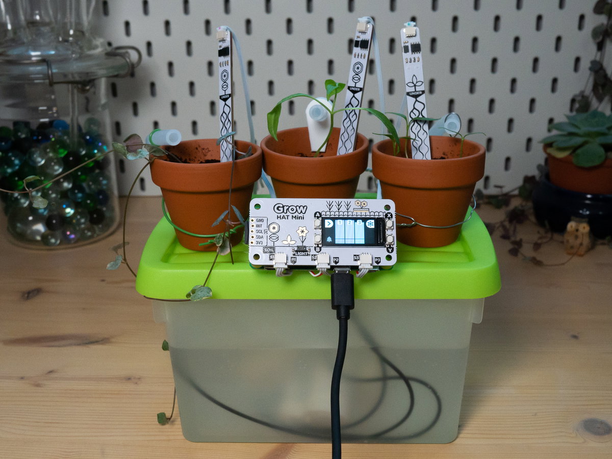

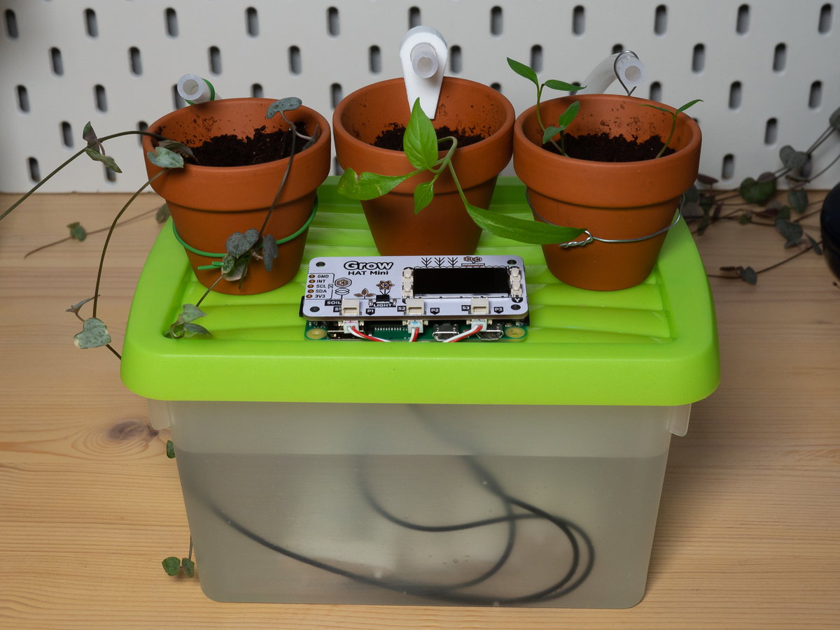

Once everything's securely attached and suitably positioned, you should have something like this:
Finished setup with all the pumps and moisture sensors plugged in

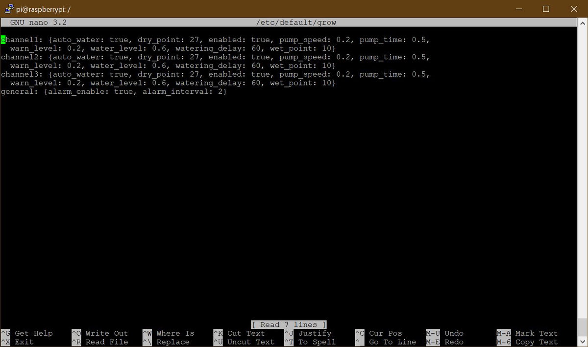

As well as changing these values from Grow HAT Mini's menus, you can also edit the settings file directly from your Pi's terminal (or over SSH, if your Pi is set up headlessly) with
sudo nano /etc/default/grow
Screenshot showing how to edit the settings file directly
It's Ctrl-X to exit Nano when you're done, and if you're editing the settings file directly you'll need to restart the service afterwards for it to use the updated settings:
sudo service grow-monitor restart

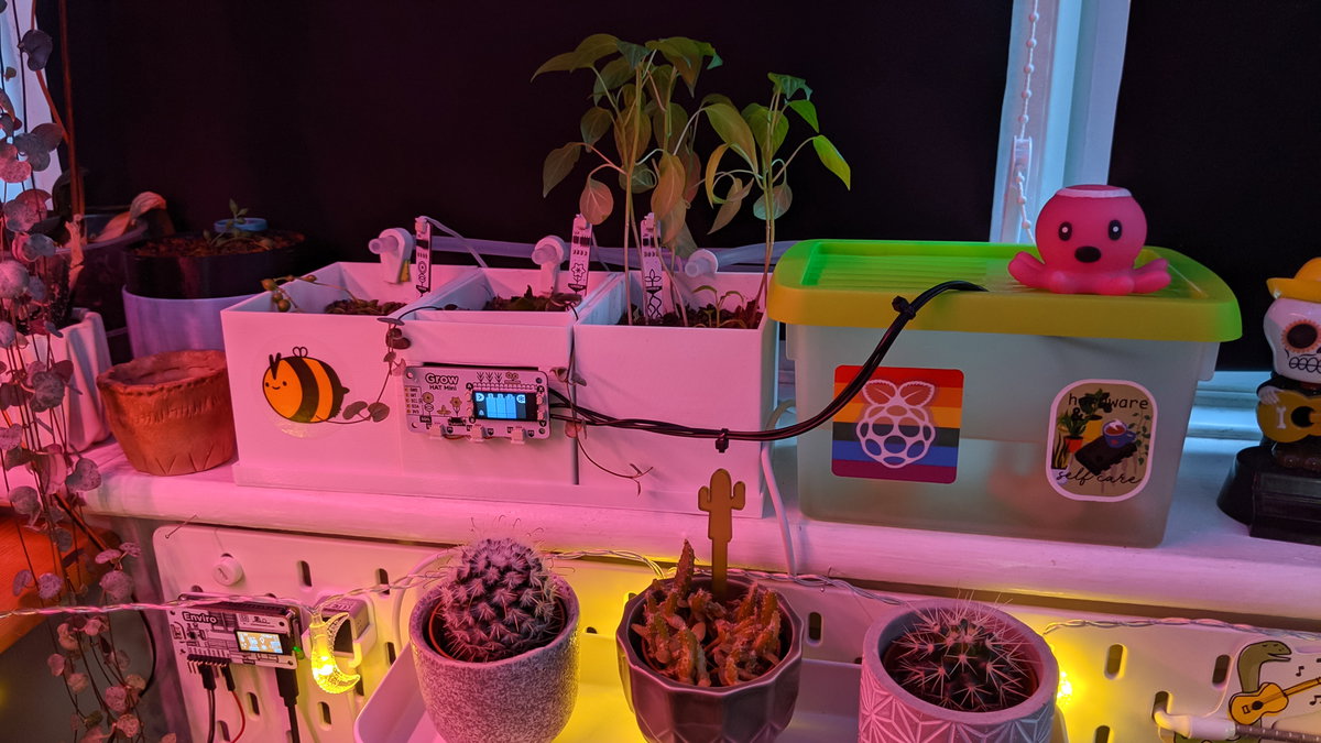

Here's what our little Grow setup eventually morphed into - we told you the chilli perked up :)
A custom Grow setup with 3D printed pots
