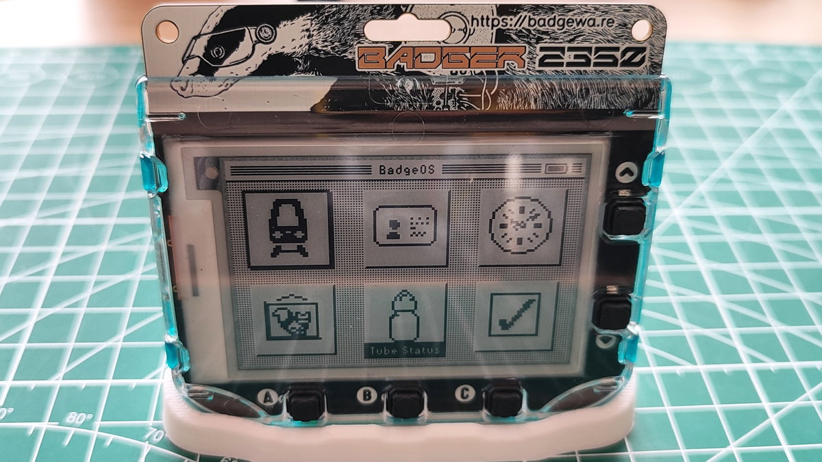

  4. Open the apps folder and inside, create a new folder called tube_status.
  5. Open Tube_Status and inside create a folder called assets. We won't be using this folder in this tutorial, but it is good practice to include one should we wish to add images to an app.
  6. Copy this icon to Tube_Status. The file should be called icon.png and it is a 24 x 24 PNG that will be the app icon.

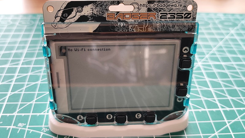

        screen.text("No Wi-Fi connection", title)
  1. Update the screen and then set the case lights on for one second.
        badge.update()
        badge.caselights(1)
        time.sleep(1)
  1. Outside of the function, use run() to execute the update function.
run(update)
  1. Save the code to Badger 2350 and press the RESET button to restart the board.

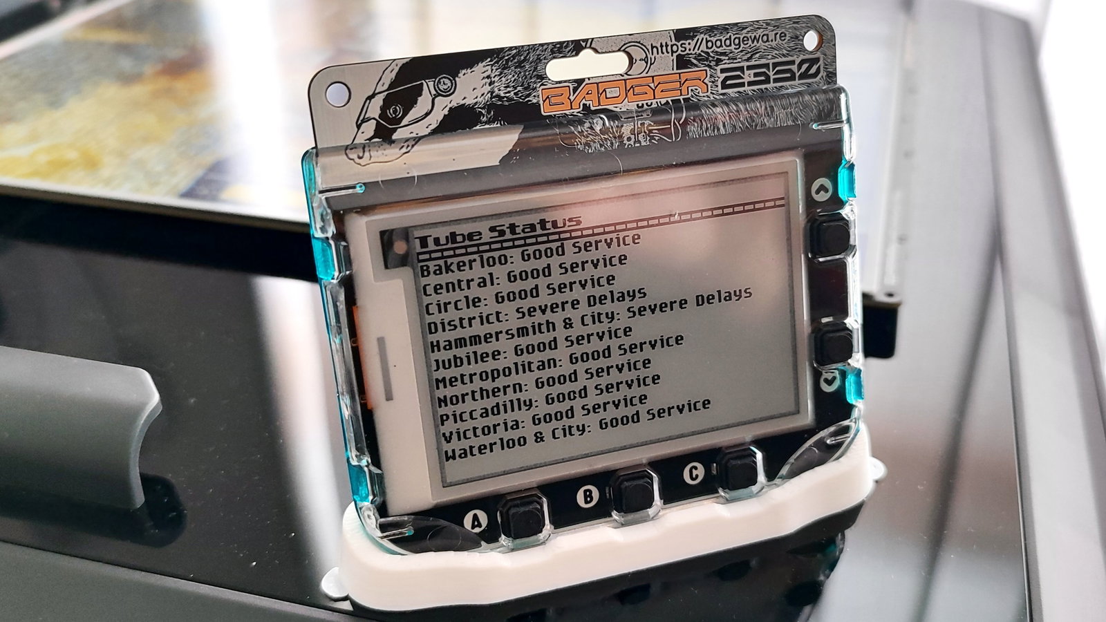

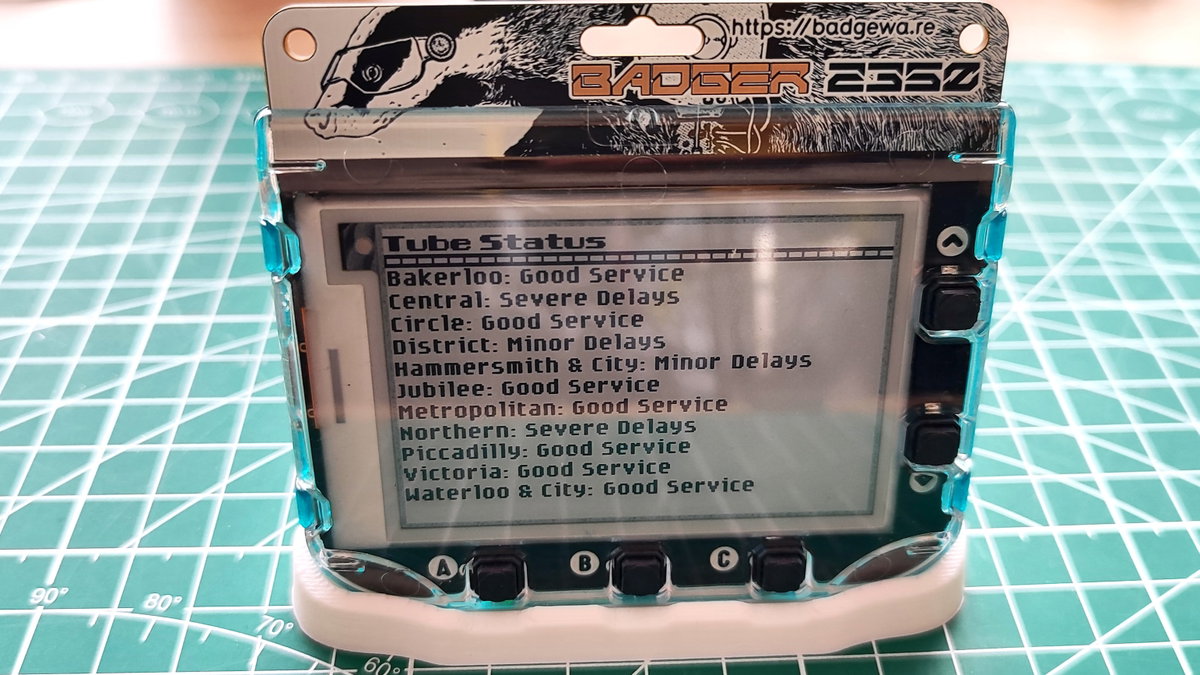

  2. Navigate to and select your app. The app should show the "No Wi-Fi connection" screen but it will connect and the case lights will flash to confirm. A few seconds later you will have the latest status of all the London Underground tube lines.
