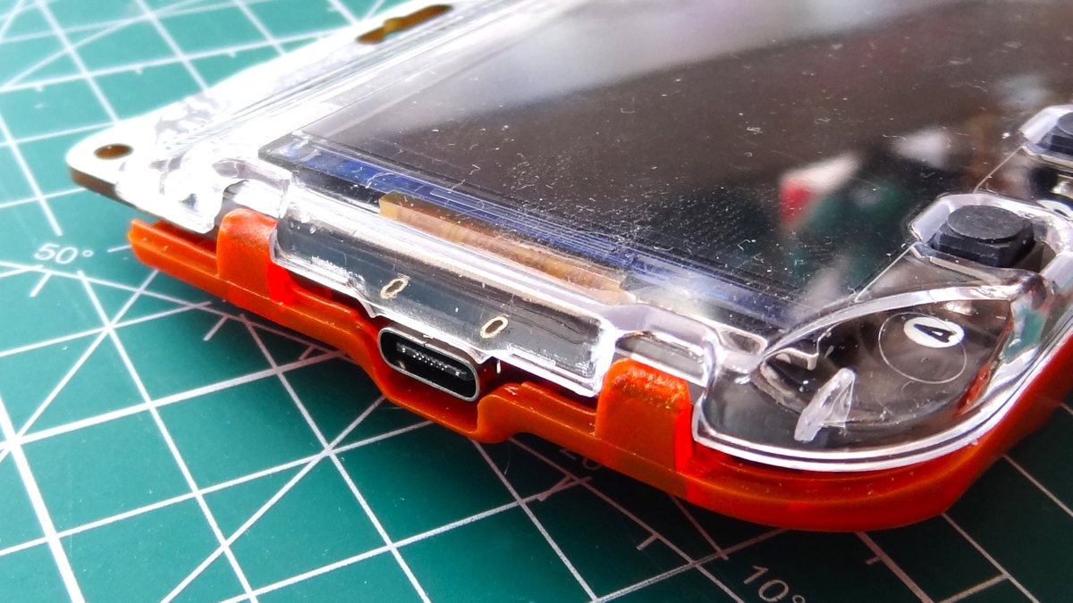

Tufty 2350 and the MLX90640 are connected using a Qw/ST connector which requires no soldering. Simply push the connector into place on each component and you are good to go.

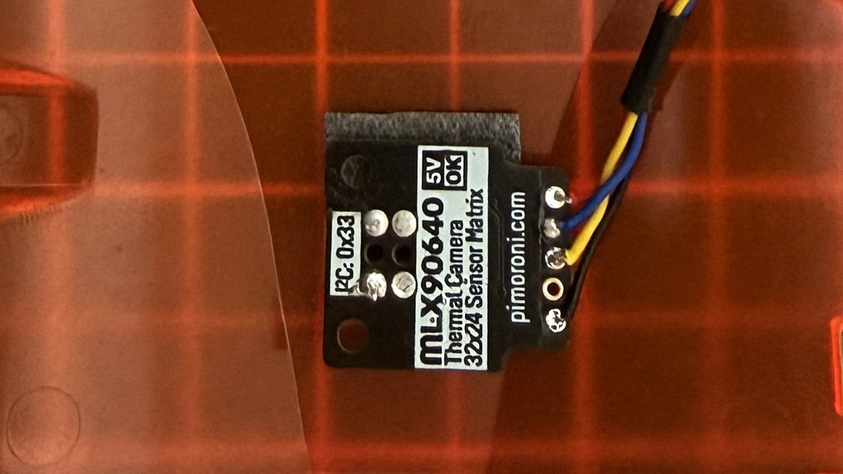

If you wish to embed the MLX90640 inside Tufty 2350's case, you will need to do the following.

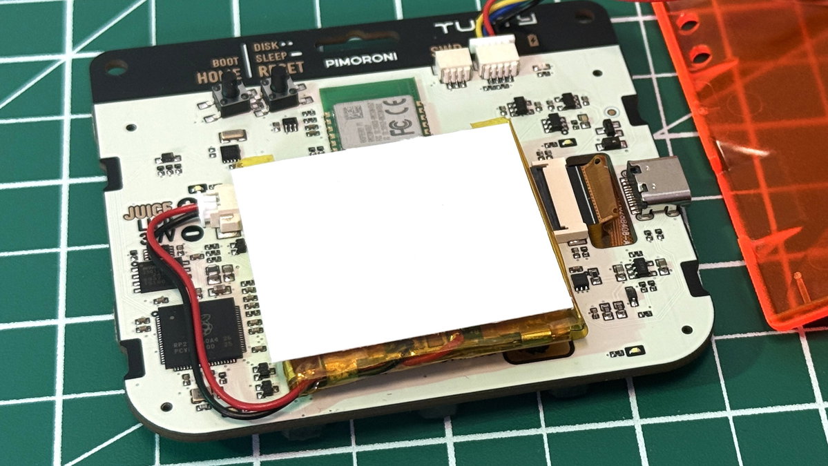

  1. Using a plastic spudger or pry tool, remove the back case from Tufty 2350. Take care with the plastic clips and work your way slowly around the case until it "pops" off.
  2. Cut a piece of plastic or card to match the dimensions of the battery. The MLX90640 has four sharp pins on its rear and we don't want them to pierce the battery.
  3. Stick the piece of card in place with some double sided tape.

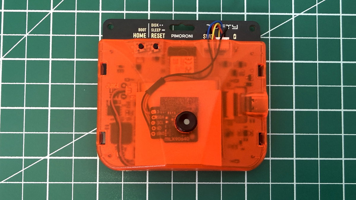

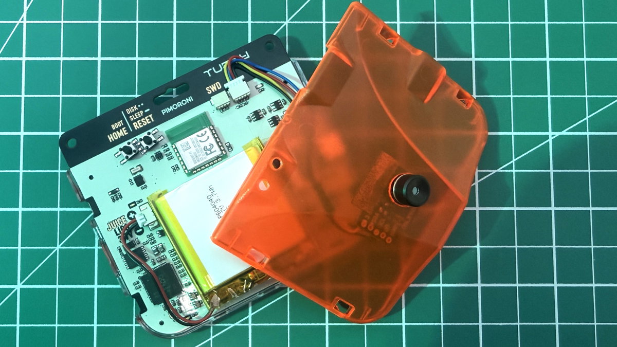

  4. Gently put the back cover on top of the MLX90640's lens and see where the case needs to be cut. Use a pen to make a mark on the case.
  5. Put Tufty 2350 to one side and with the case held firmly in place, make a hole big enough for the lens to go through. A rotary tool or drill can be used to do this. Just start with a small drill bit and work up until you get to the lens diameter. Use a needle file to remove any sharp edges or burrs.
  6. Dry fit that the MLX90640 fits inside Tufty 2350's shell with the case closed. If so, use a little double sided tape to hold the camera in place. If not, file away the plastic until it fits.

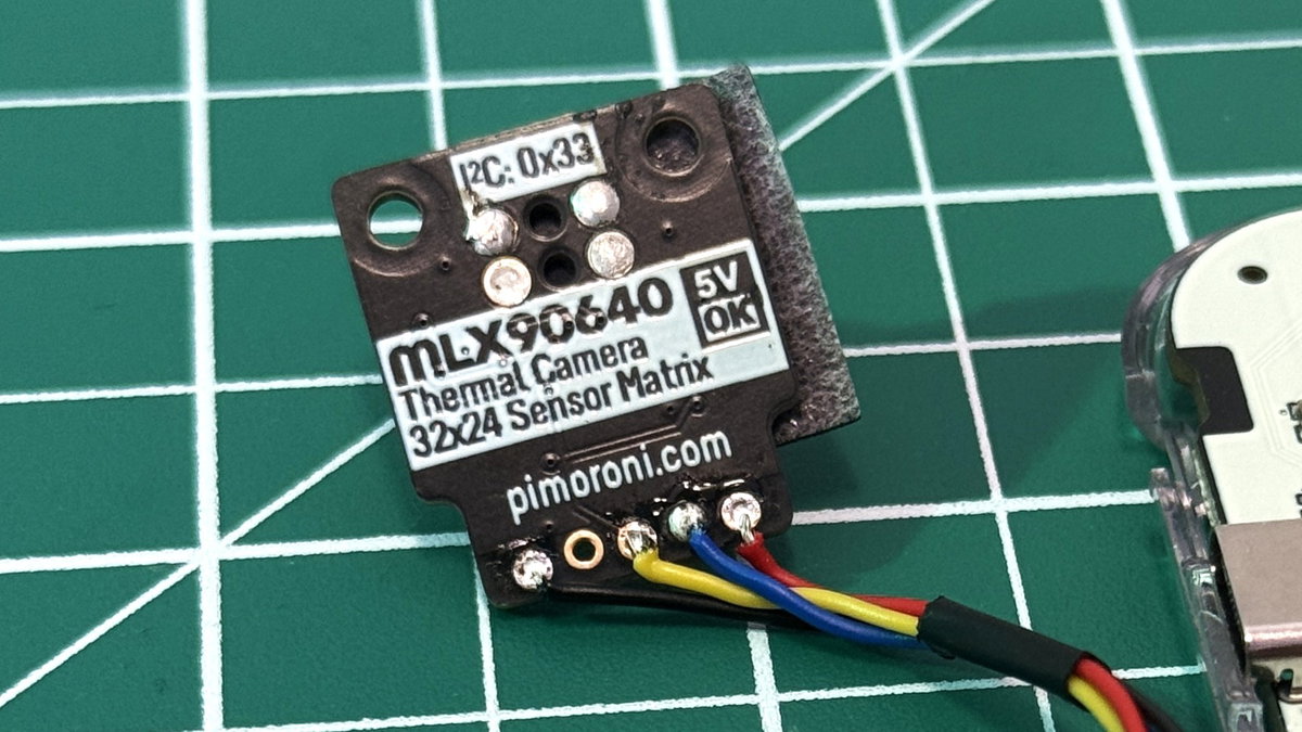

  7. Optional step: For a little extra space you may want to desolder the QW/ST connector and use the I2C pins on the MLX90640. Remember that the Qw/ST port is plastic, so take care when desoldering.
  8. Close up the case. You are now ready to move on to coding the project.

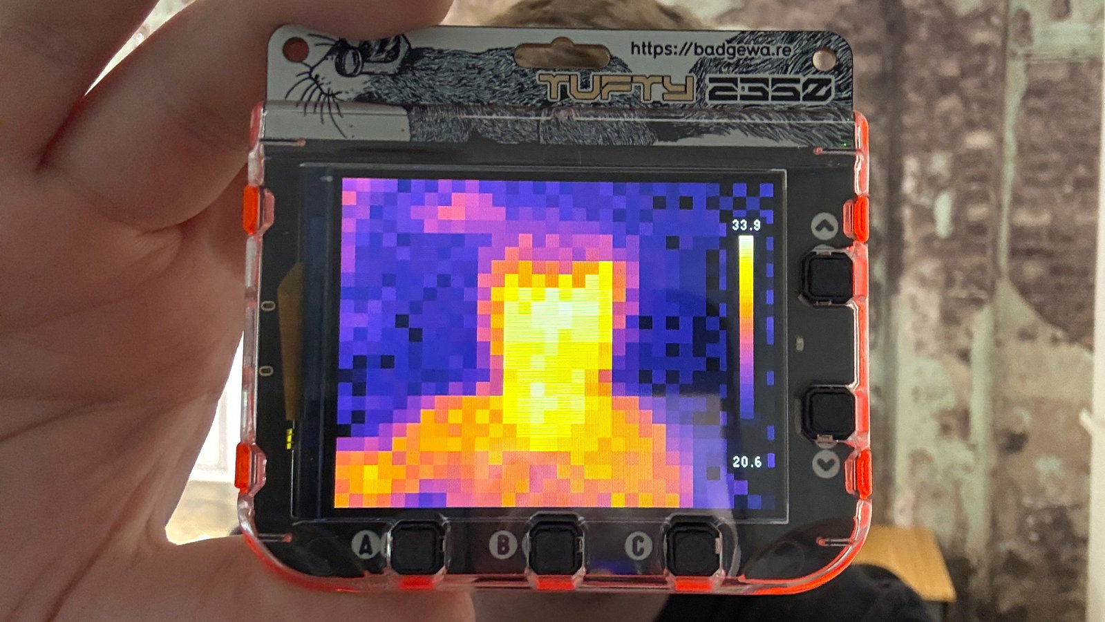

  4. Point the camera at something hot / cold and watch as it reacts. Try waving your hand or pointing it towards a radiator / hot drink to see the colour temperature change.
