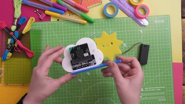

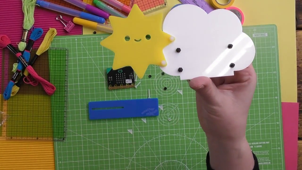

The acrylic pieces come with a protective plastic film on them that you'll have to peel off before you assemble the kit. You'll need to do this for the sunshine, cloud, and the blue stand.
peel the acrylic pieces
Bolting the pieces together and assembling the stand

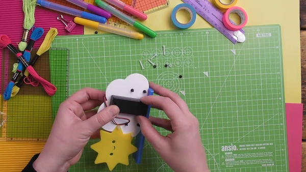

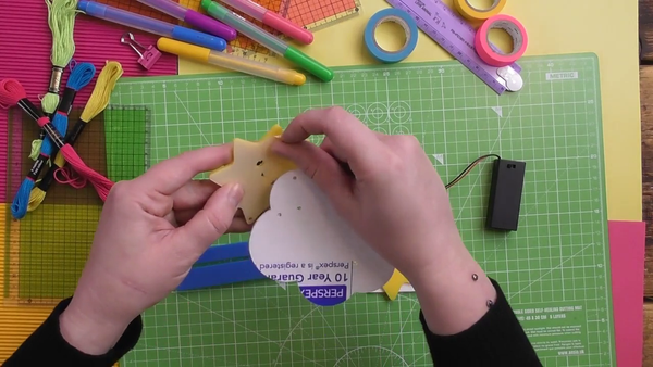

First, bolt the sunshine to the cloud. The sun sits behind the cloud, and the two white bolts go through from the front. Keep them in place with the white hexagonal nuts.
Once you've done this, you'll need four black bolts and four black hexagonal nuts. Place the enviro:bit on the cloud, over the four holes, and push the black bolts through from the front, attaching a black hexagonal nut to the back of each one. The next photo shows the view from the back.
bolting the pieces

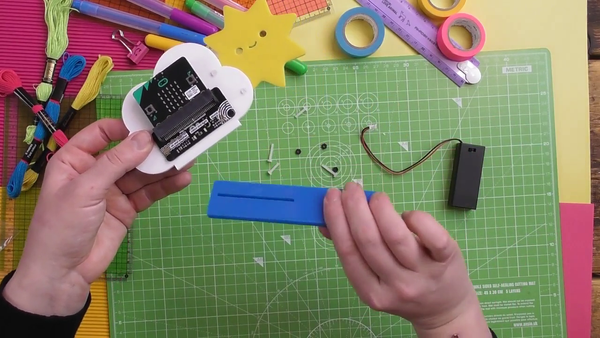

The sunshine/cloud/enviro:bit combination slots into the blue stand. It's designed to be a little tight, so that it grips firmly.
slot in stand

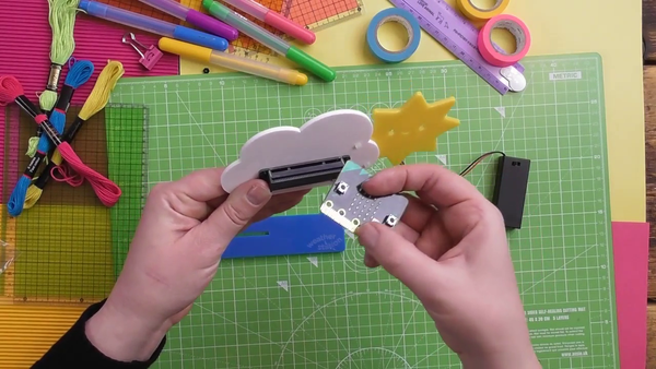

To attach the micro:bit, look down at the weather station and you'll see a slot at the front of the enviro:bit. Push the micro:bit firmly into the slot, as shown in the photo below (gold contacts down, buttons and LED matrix at the front).
