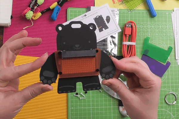

The arms can be placed either way up, giving your bear an arms-up "yay!" effect, or an arms-down bodybuilder bear. The choice is yours!
Whichever way you decide the arms should go, make sure the holes on the arms line up with the four holes on the bear's body. Just lie the arms down on top for now.
The next thing you'll need is the scroll:bit, which you'll find in the silver anti-static bag. It has four holes that line up with the ones on the body and the arms. Add the scroll:bit to the stack, and then choose a coloured t-shirt.
Again, line up the four holes in the t-shirt with the holes on the stack of pieces. This completes the stack, and now we just need to bolt it together.
