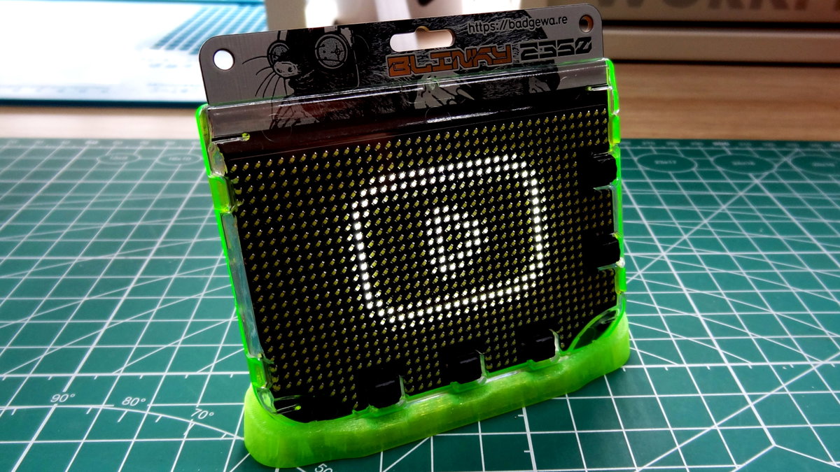

Centring Images And Text
For the first part of this guide we'll be using the code from the previous tutorial as our base. If you are following on from that guide, then the code should already be on your Blinky.
The goal of this first section is to simply centre the YouTube logo and subscriber value on the screen. If you don't want flashy animations and text, then this is for you.

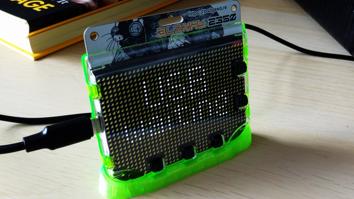

LesCrew Member

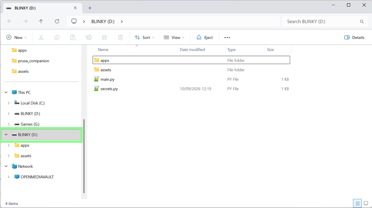

  1. Connect Blinky to your PC and press RESET twice to enter USB drive mode. Your PC will treat Blinky just like a typical USB flash drive. Image of Blinky 2350, the device is connected via USB to a PC.
  2. Open your operating system's file manager and navigate to a drive called BLINKY. Screenshot of Windows 11 file manager open at the BLINKY drive.
  3. In your preferred text editor, open the __init__.py file inside \apps\youtube_subs.

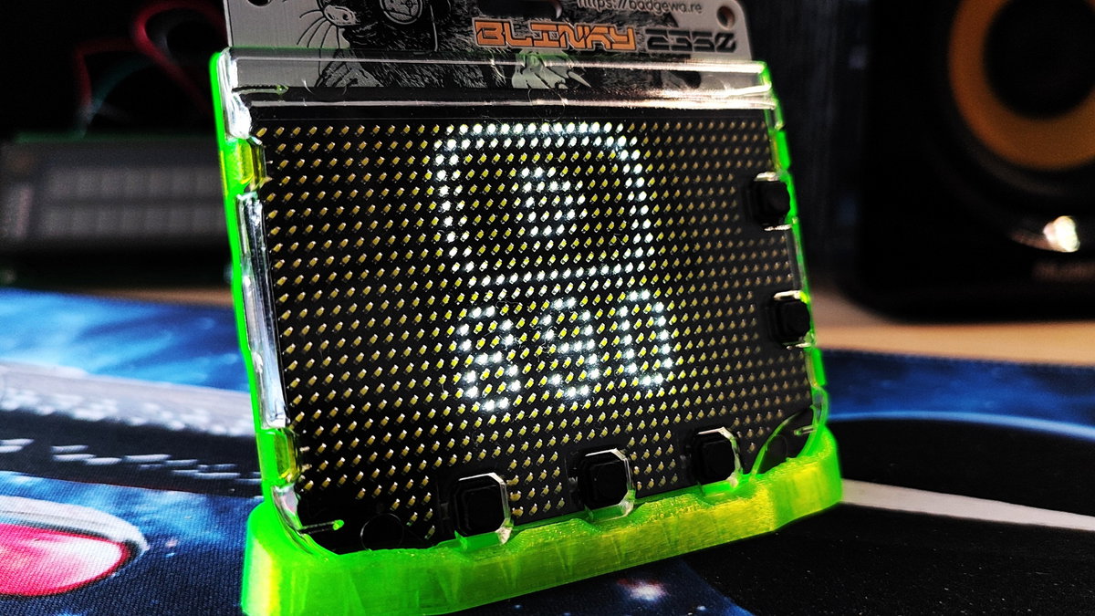

  4. Scroll down to def draw_subscribers(count):.
  5. Underneath value = format_count(count) add a new line to measure the width and height of the subscriber number text.
        w, h = screen.measure_text(value)
  6. Create a variable x to store the exact centre of the display. By deducting the width of the text from the width of the screen, then using floor division (dividing one number by another, rounding the result down to the nearest whole integer) we halve the values.
        x = (screen.width - w) // 2
  7. Look for screen.blit and screen.text and change their values to match these. The x value denotes the vertical centre line of the display.
        screen.blit(sprite, x,0)
        screen.text(value,x,9)

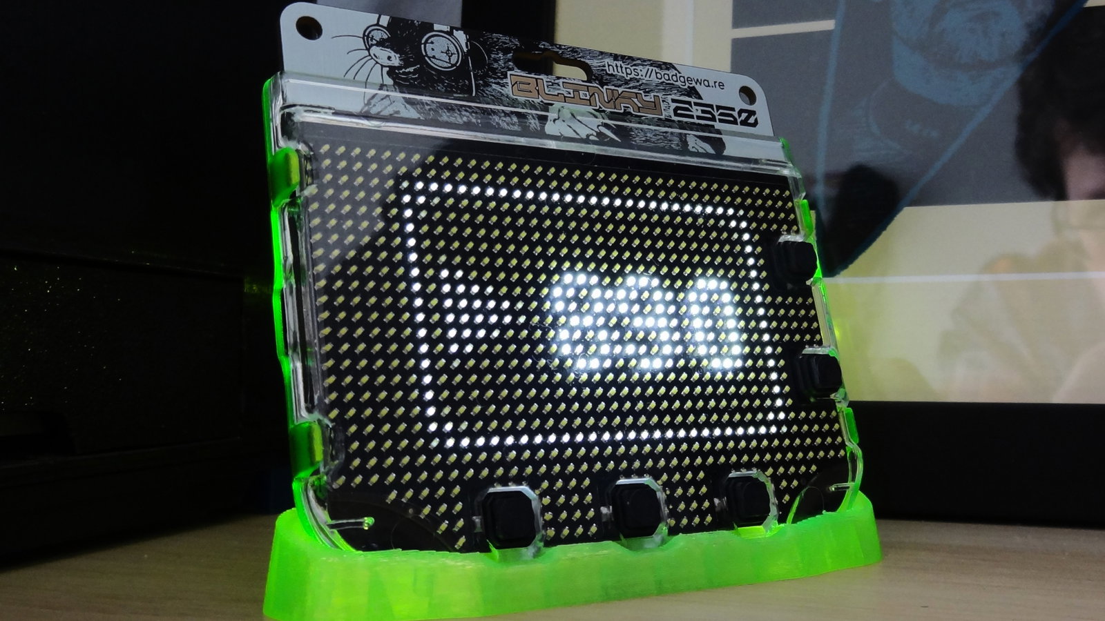

  8. Save the code and press RESET on Blinky to restart in badge mode.
  9. Scroll to the app, you should see the YouTube logo bounce on the screen. The YouTube logo, rendered in pixels on Blinky 2350.
  10. Press B to start the app. The case lights will flash until a solid Wi-Fi connection is made. Once connected, an API call is made and after a few seconds we will see the details on Blinky's display. The final app, showing 890 subscribers and the YouTube logo in the centre of the screen.

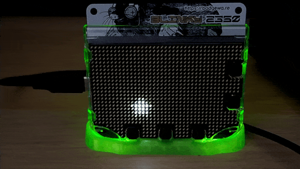

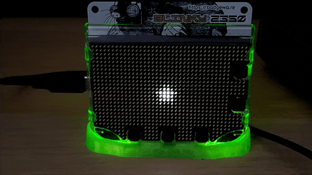

  11. Using a while not loop, check that we are not connected to Wi-Fi. In essence this loop will try to connect to Wi-Fi. Each time it isn't connected, it will animate a triangle unit_triangle to spin while blinking Blinky's case lights to show that it is doing something.
    while not wifi.connect():
        for i in range(12):
            unit_triangle.transform = mat3().translate(screen.width//2, screen.height//2).scale(4).rotate(i*30)
            badge.caselights(1)
            time.sleep(0.1)
            screen.shape(unit_triangle)
            badge.update()
            badge.caselights(0)
            time.sleep(0.1)
  12. Print the connection details to the Python Shell, and then keep the case lights permanently on. The print to the Python Shell is a debug step used to confirm Blinky's IP address. The case lights staying on is there to visually identify that we have a Wi-Fi connection.
    print("Connected! IP address:", wifi.ip())
    badge.caselights(1)

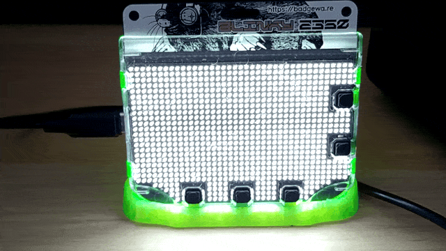

  26. Using a for loop that iterates 50 times, set the pen colour to white, then write ONE THOUSAND !! inside a rectangle that starts in the top left of the display (0,0) and draw a 40 pixel box. The text is set to 8 pixels in height. Update the screen so that the text is displayed. Animated GIF showing a shrinking star, followed by flashing text and then the scrolling subscriber count.
            for i in range(50):
                screen.pen = color.white
                screen.text("ONE THOUSAND !!", rect(0, 0, 40, 40),8)
                badge.update()
  27. Add a short delay, then set the pen colour to grey and repeat the same text, in the same position. This produces a flashing text effect, very similar to late 20th century movie theatre signage.
                time.sleep(0.1)
                screen.pen = color.grey
                badge.update()
                time.sleep(0.1)

  36. Scroll to the app, you should see the YouTube logo bounce on the screen. The YouTube logo, rendered in pixels on Blinky 2350.
  37. Press B to start the app. The case lights will flash and the triangle progress indicator will spin until a solid Wi-Fi connection is made. Once connected, an API call is made and after a few seconds we will see either an animation or our current subscriber details on Blinky's display.
Your YouTube subscriber badge is now complete and you can now wear it proudly in a video or hide it on the set for eagle-eyed viewers to find.
