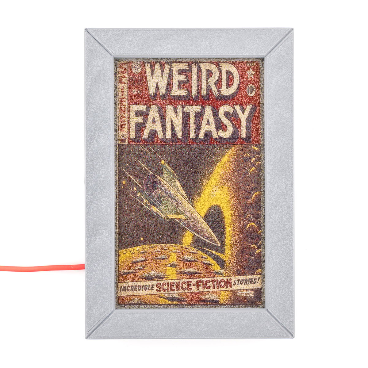

Bold images with a limited colour palette look great on our Inky Impression colour E Ink® displays. We've been enjoying displaying old 1950s and 1960s comic book art - the art style and the printing methods available at the time mean that they're ideally suited for viewing on Impression.
This quick guide will show you how to display comic covers from Comic Vine on your Inky Impression, both manually and using the API. The files we used for 3D printing the bezel shown in these photos are linked to at the bottom of this guide.

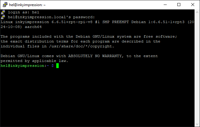

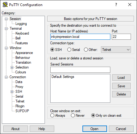

First we'll need to find a cover to display (we enjoyed this one, but you do you). Right click the image and copy the URL. Then, fire up your SSH client (we're using Putty) so you can run commands in your Pi's terminal:
Once you're connected to your Pi, run the following command to download the image to your Pi, substituting a different image URL if you wish:
wget https://comicvine.gamespot.com/a/uploads/scale_large/0/229/163489-18944-112530-1-weird-science.jpg -O comic.jpg

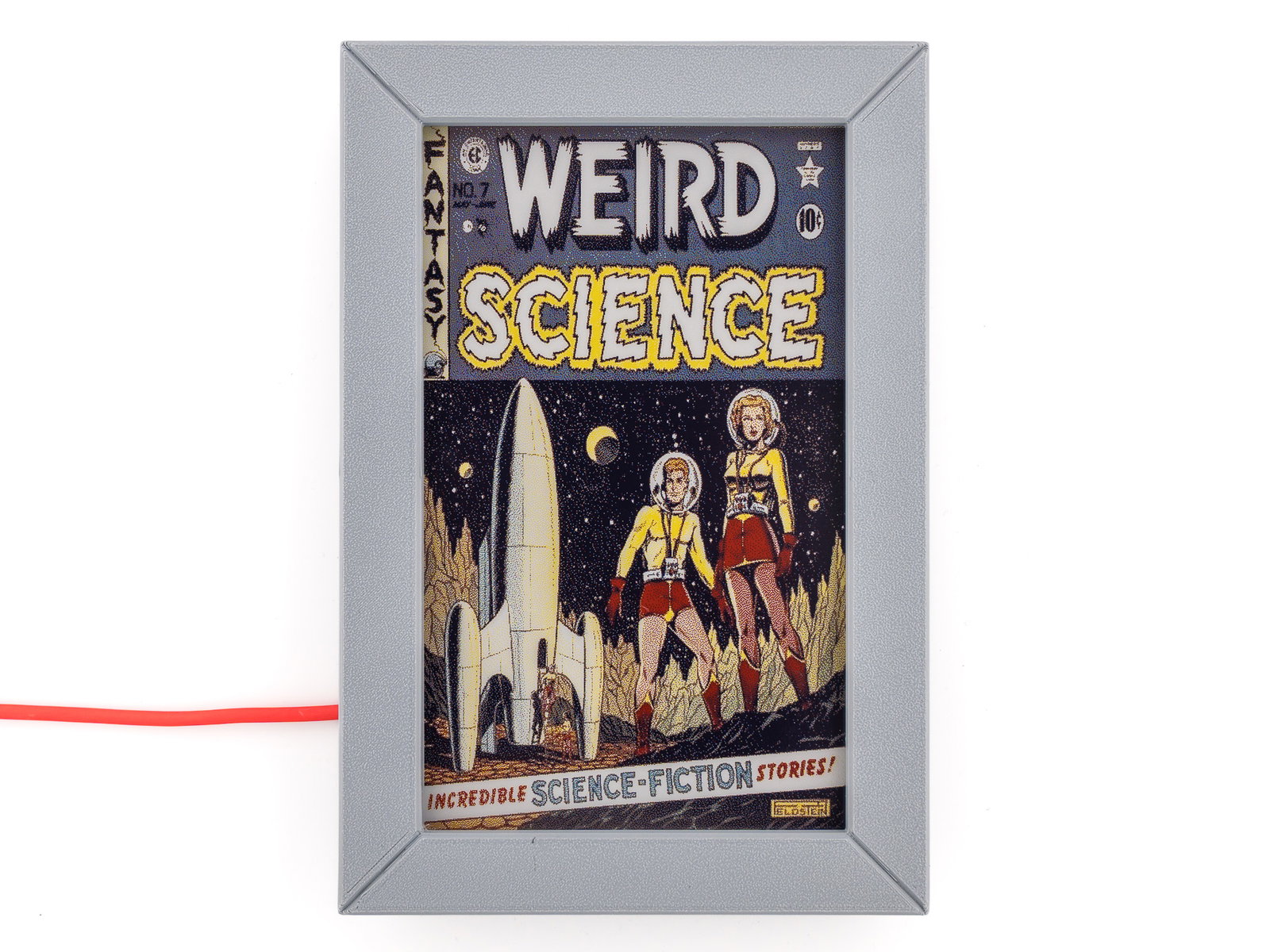

Here's the code above running on a 7 colour 7.3" Impression, and a dinky 7 colour 4" Impression.

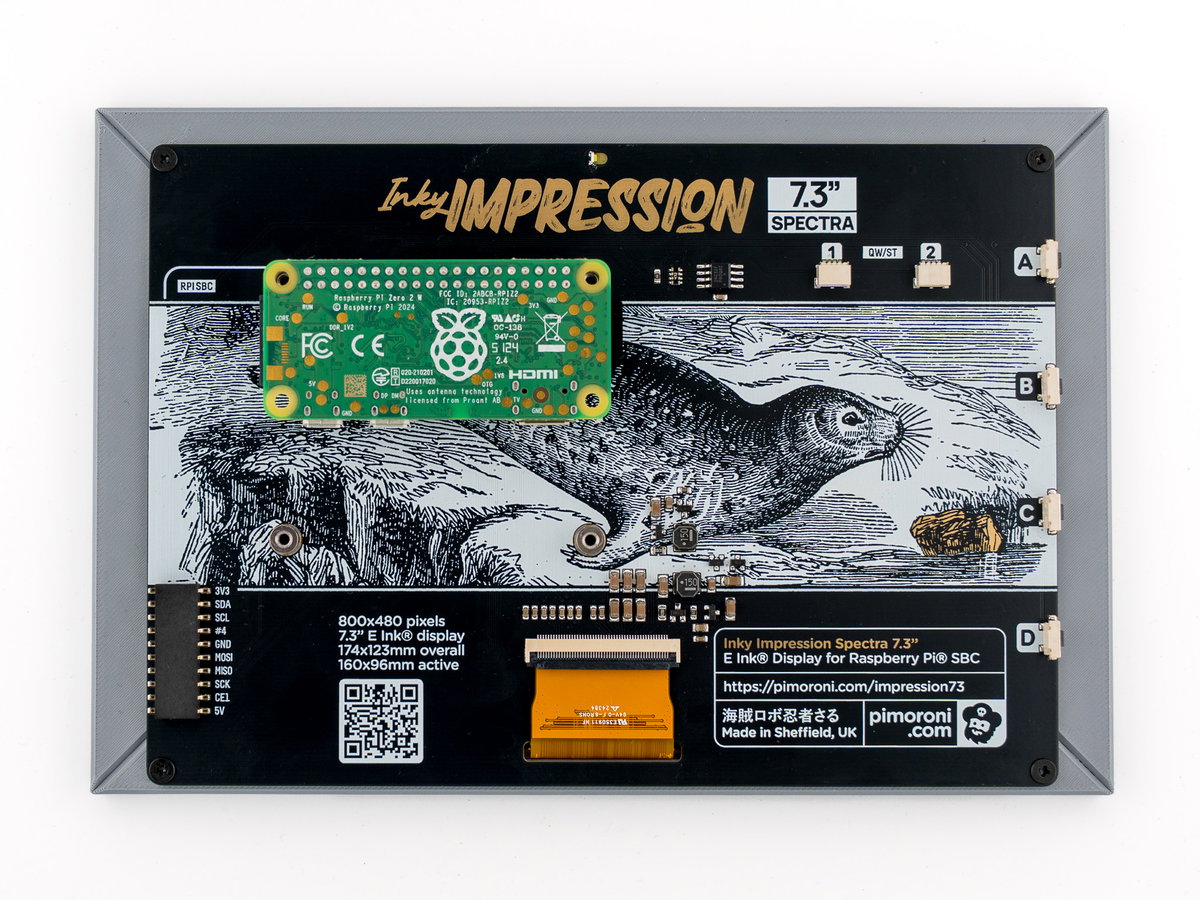

To make our Inky Impression look a bit more like a picture frame, we 3D printed a simple frame to make the bezel the same distance around the screen on all sides. If you'd like to do the same, you can find our 3D printing files at the link below:
We used M2 3mm bolts to fix it in place. The holes in the frame aren't threaded, but PLA is soft enough for the bolt threads to grab in place. This method might not hold up to multiple unscrewings though.
Once the bezel was attached, we used a Folding Tablet Stand to prop up our bezelled Inky.
