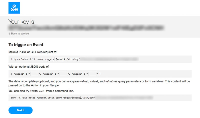

Now, you'll need to get the webhooks that will be included in our pi-lluminate.py example. To find these, go to your IFTTT account and select "Services" from the menu and search for webhooks, or click here. You'll' see a button called "Documentation" - click that and you'll see a screen similar to this:
In the example above, we've blurred out our key, as anybody who knows this could control your lights! The part to make note of is the URL that looks like: https://maker.ifttt.com/trigger/{event}/with/key/YOURKEYISHERE as we'll need to substitute the {event} with our "Event Name", i.e. dark and light, so your webhooks will look like https://maker.ifttt.com/trigger/dark/with/key/YOURKEYISHERE and https://maker.ifttt.com/trigger/light/with/key/YOURKEYISHERE.
Make note of your key and the two "Event Names" (dark and light) as we'll need them later. If you wanted to, you could test that they worked by running the example shown at the bottom, via the command line on your Raspberry Pi:
curl -X POST https://maker.ifttt.com/trigger/dark/with/key/YOURKEYISHERE
Hopefully, your Philips Hue lights just turned on! If not, double check that you've connected your account correctly and check the applets are configured properly.

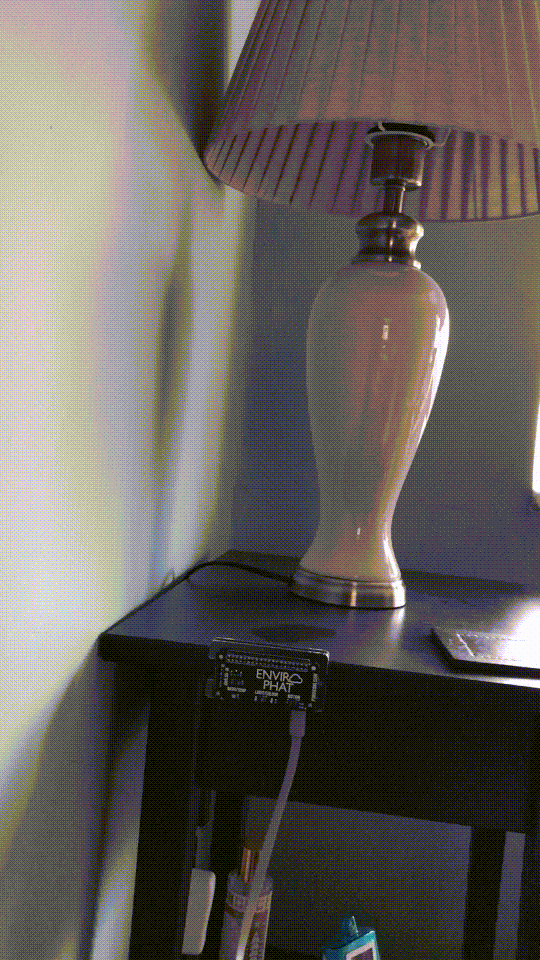

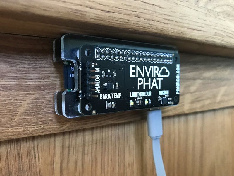

The easiest way to test this out is either to block the light sensor on the Enviro pHAT with your hand, or to use a torch to shine more light on the Enviro pHAT and see if your Philips Hue lights react by turning on or off. To test, run the following command in your Raspberry Pi's terminal:
python /home/pi/Pimoroni/enviro-phat/examples/advanced/pi-lluminate.py
You should see a printout that says Calculating average light level... followed shortly by Average over 60 seconds is: 255 Lux. Last checked at 13:43, but your values may vary depending on what the Lux level is and what time it was recorded.
In theory, when the Enviro pHAT is covered with your hand, the lights should come on in about a minute, and then should turn off again if you shine a torch on the Enviro pHAT for about a minute. We found that without taking an average reading, our lights were being triggered quite frequently, especially on days where it was sunny then cloudy, then sunny again (i.e. typical British weather!)
