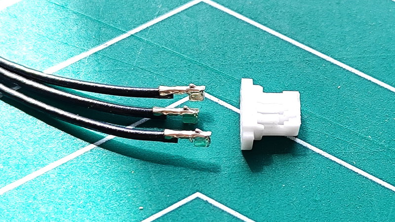

We need to remove one connector from both the three and four pin cables. This isn’t difficult, but there is a knack to it. Carefully follow these steps.
- Flip the four pin connector over so that the small metal tabs are clearly visible.
- Insert the sharp tip of the tweezers into the first metal tab and gently, yet firmly, slide the tip of tweezers under the plastic. The goal is to gently lift the plastic so that the retaining catch is lifted free of the metal. The plastic around the tabs is brittle, so take care not to damage it. A blob of modelling clay or blutack is useful to hold the connector.
- Gently pull the wire from the connector, it should slowly ease out. If there is resistance, move the tweezers a little and try step 2 again.
- Remove all of the wires, so that you are left with a plastic connector.
- Repeat this process for the three pin connector.

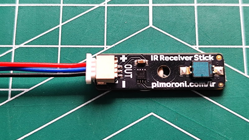

- Connect the three pin connector to the Infrared Receiver Stick.
- Connect the four pin connector to Plasma 2350 W’s Qw/ST port.
