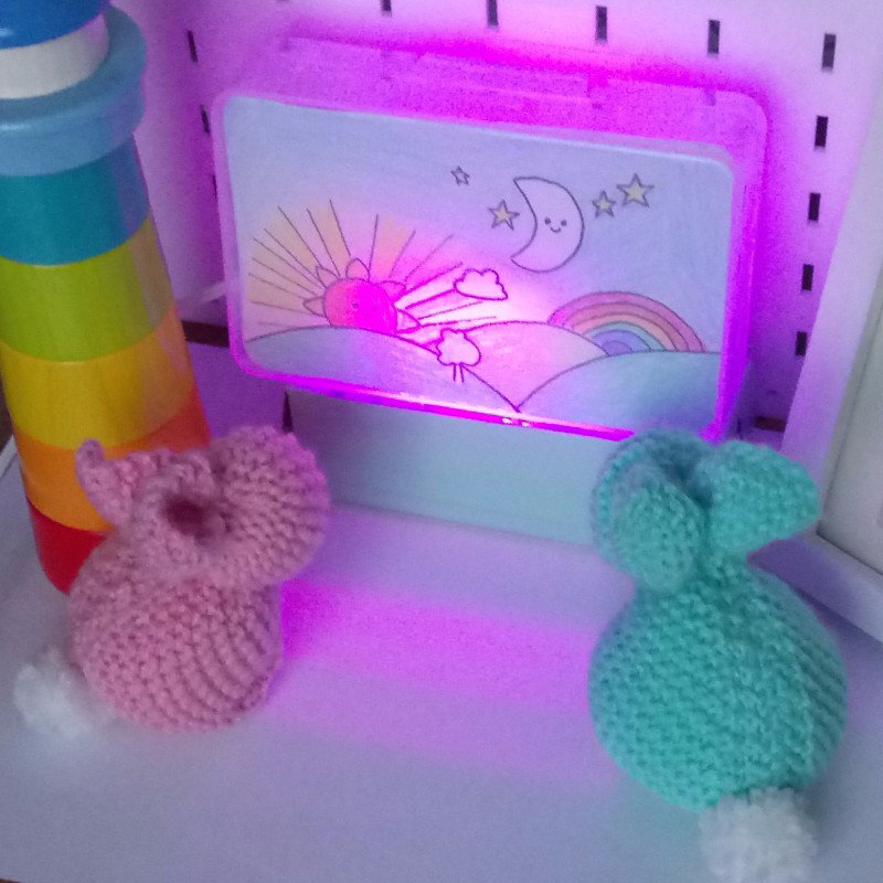

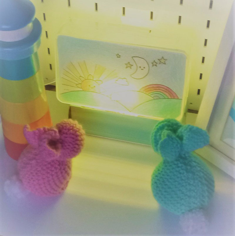

Yellow is (255, 255, 0) in the red, green, blue colour system. Indigo is approximately (51, 0, 51).
bunnies looking at indigo
If we want all of the pixels to light up the same colour, we just use the command set_all and the colour we want. As a precaution, I've added in two more lines to make sure it clears the display before changing it to the new colour. If you wanted the yellow to be brighter than the indigo, you could change it here.

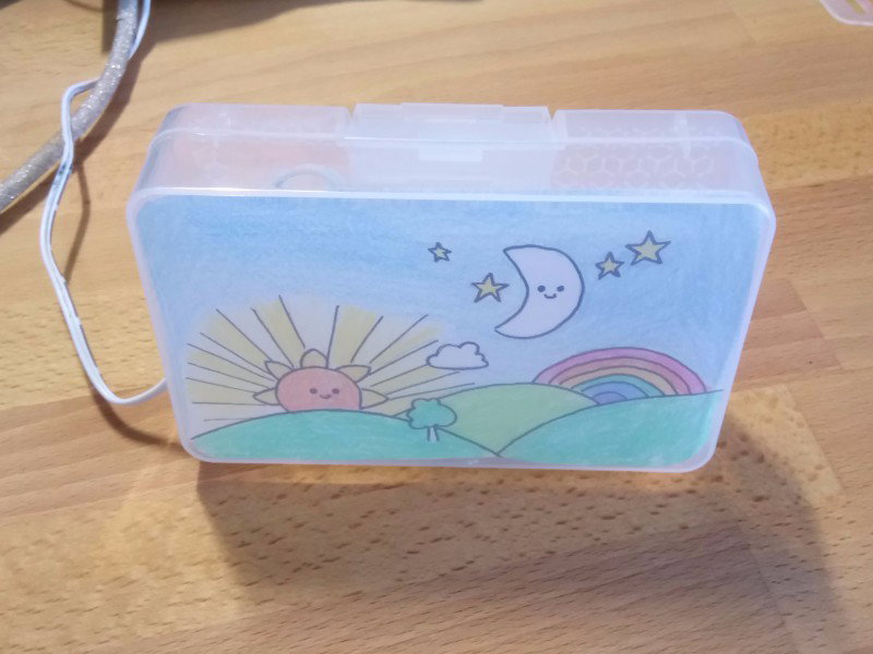

Why is yours in a cute box?

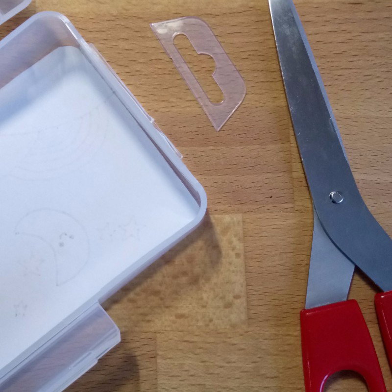

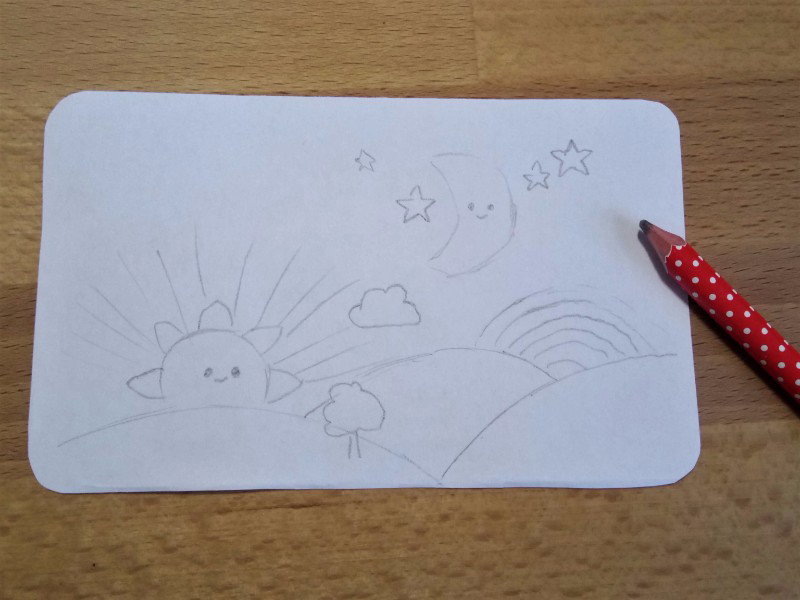

I re-used the box the Mood Light Kit comes in - it's sold separately as a Pirate-Brand Loot Box as well. I cut a small hole in one side for the power cable to go in, and drew a little picture on some plain paper to go in the front and diffuse the light.

I cut the hanging tab off the box with scissors.
tab be gone

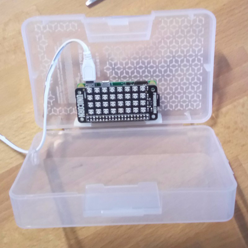

Here is the inside of the box, without the picture in.
plain box with unicorns in
