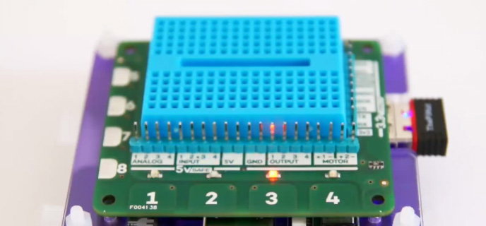

Explorer HAT Pro is a little breakout board with a mini breadboard in the middle, 4 capacitive touch buttons along the bottom edge, 4 metal capacitive touch pads along the left hand edge and a bunch of IO pins, including analog inputs and motor outputs.

Here's a sneak peak of what you'll be making (click the picture to play video):
