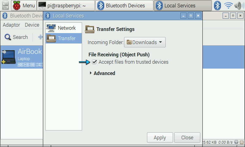

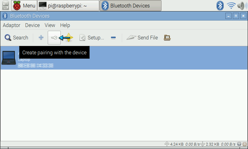

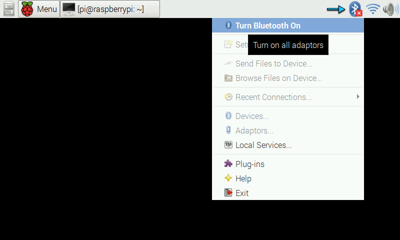

You'll be asked whether you wish to install an updated version of Bluez - say 'y' when prompted. Reboot your Pi at the end of the process, before going any further.
