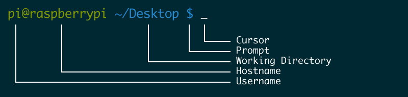

A shell is a command processor which lets you manipulate your computer by typing in commands. Commands are typed after the "prompt" which is a brief snippet of text informing you who and where you are on the system:
Bash Prompt

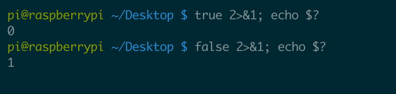

Bash doesn't deal with trueness or falseness as you might understand it, everything in Bash returns an "exit status." On success the exit status is always 0, and on failure it should be >0. Because of this, true actually exits with a status of 0 and false exits with a status of 1, you can see this for yourself:
pi@raspberrypi ~ $ true 2>&1; echo $?
0
pi@raspberrypi ~ $ false 2>&1; echo $?
1

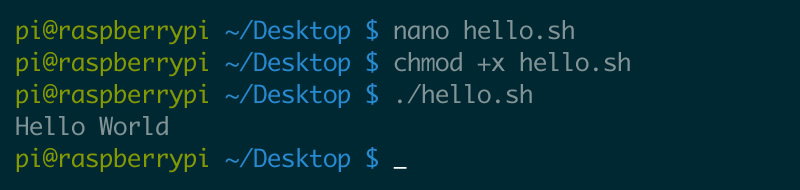

Once it's created you should make it executable, you can use another Bash command to do that but you'll type this one right into your command line:
chmod +x hello.sh
chmod is a very useful utility, you can use it to change the permissions of a file or directory.
Finally, you can run your script. To run an executable file in the current directory you must use:
./hello.sh
Bash Hello World
In Bash the single dot is a shortcut for the current directory, also useful is the double dot .. which is a shortcut for the directory above the current directory.
