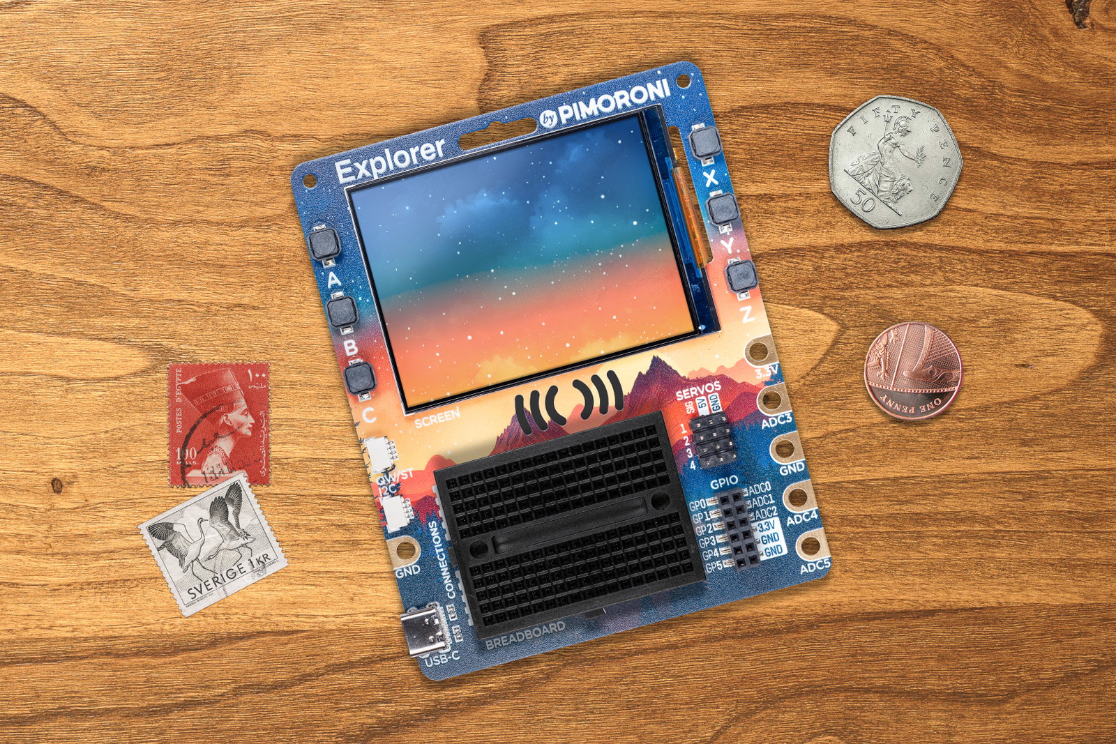

Board overview

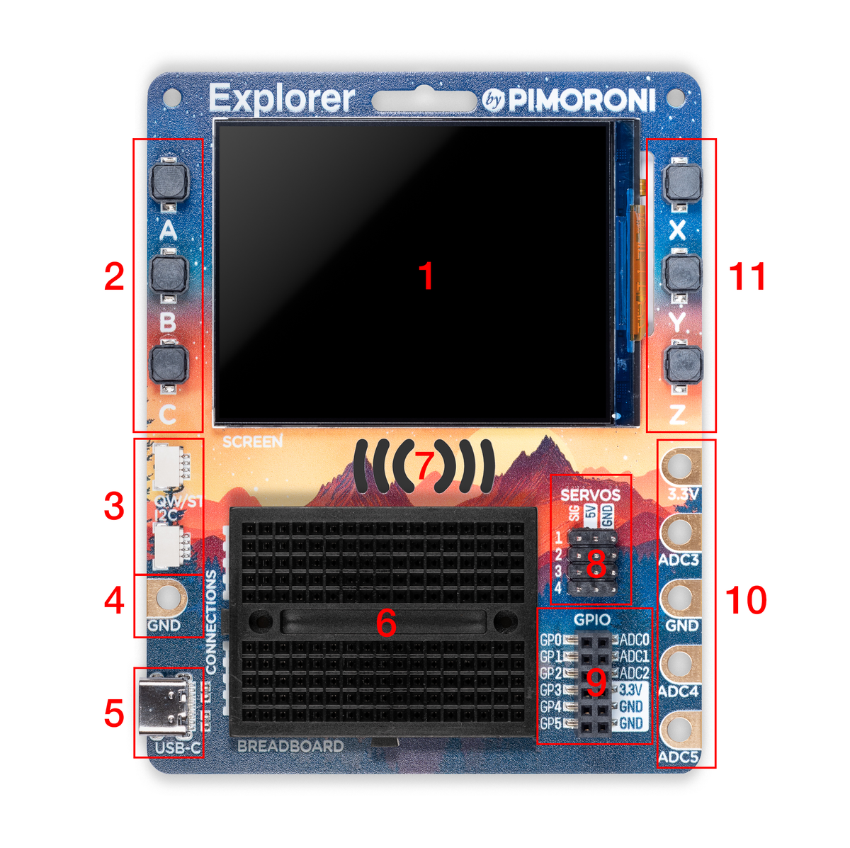

Here's the front of the Explorer:
Front of Pimoroni Explorer
  1. LCD screen to monitor what your project is doing
  2. (and 11.) Six chunky buttons to control what your project is doing
  3. Two 'Qw/ST' connectors for attaching I2C breakouts
  4. (and 10.) Connectors for attaching crocodile leads (sold separately)
  5. A USB-C connector for connecting the Explorer to your computer
  6. A mini breadboard for wiring up components
  7. Speaker output (the speaker is on the back)
  8. Pin headers for attaching 3 wire hobby servos
  9. Plenty of general purpose inputs/outputs and analogue inputs

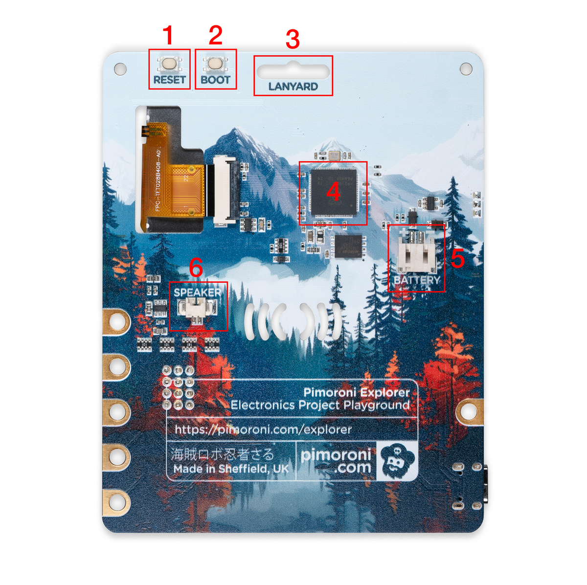

Here's the back:
Back of Pimoroni Explorer
  1. Reset button
  2. Boot button (used for updating the MicroPython firmware on the board)
  3. Lanyard hole for wearing your Explorer, or hanging it up
  4. The RP2350 microcontroller chip - the brains of the operation!
  5. Connector for plugging in the battery holder
  6. Connector for attaching the speaker (yours will come with the speaker pre-attached)

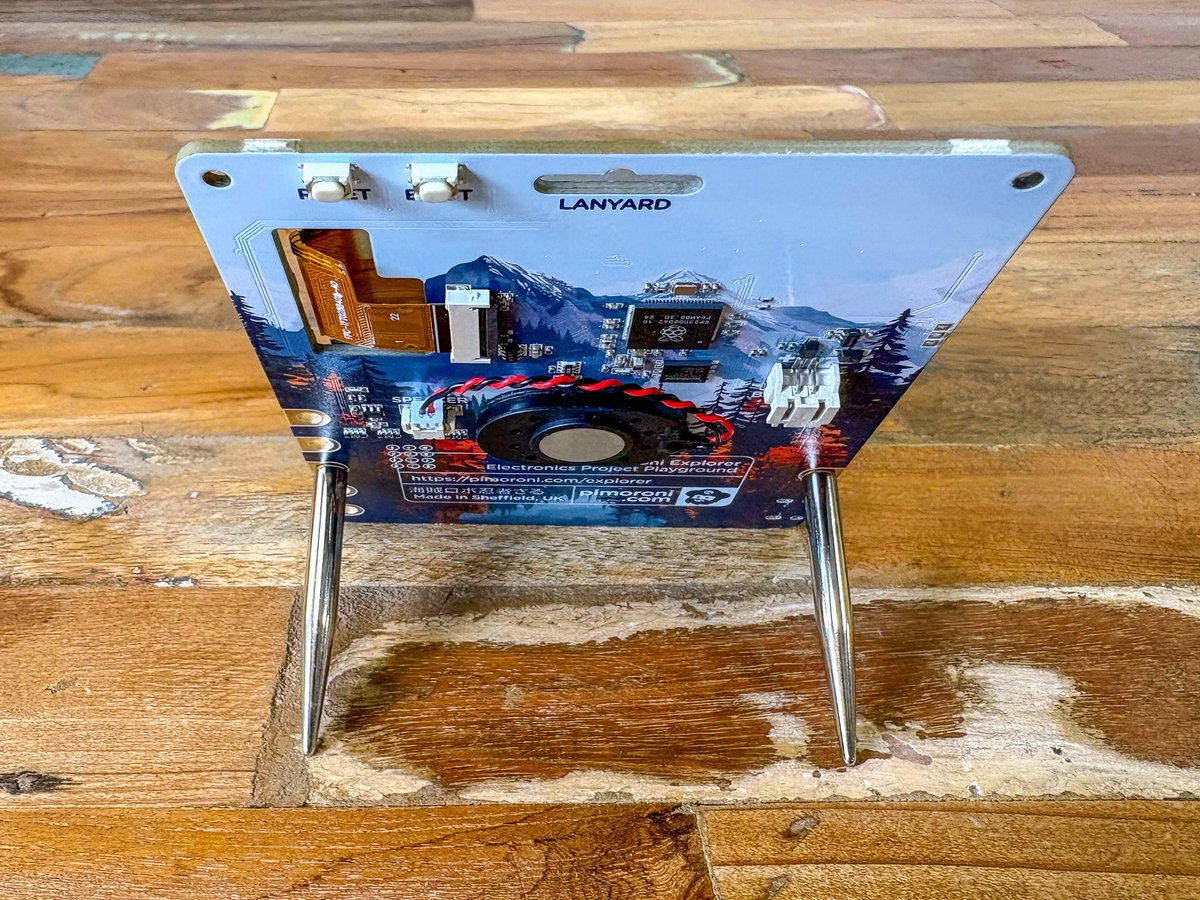

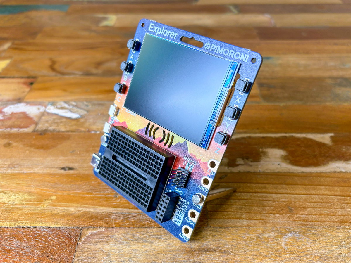

Attaching the legs
Explorer comes with some little legs, so you can prop it up at an angle. They can be attached to the 'GND' holes. It's best to avoid letting the Explorer lie flat, as pushing one of the buttons on the front can press the Explorer down and depress the reset button at the back!
Board with legs Board with legs from the back

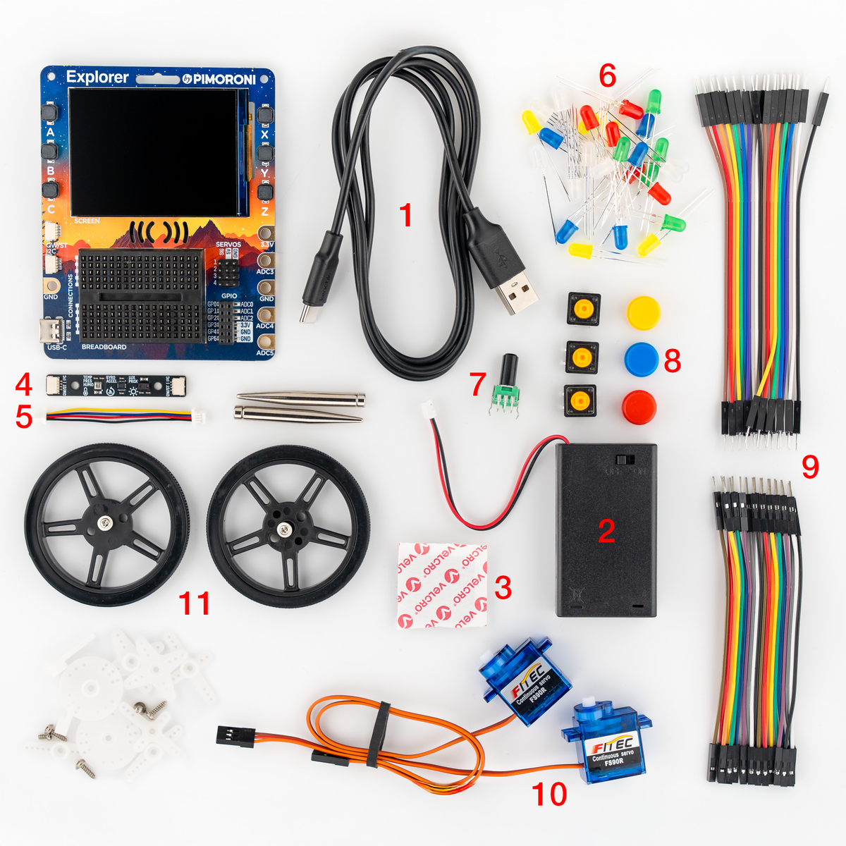

Extra components
The Starter Kit includes some extra components:
Kit contents
  1. A USB-C cable
  2. an AAA battery holder (you'll need to supply your own batteries)
  3. Velcro to stick the battery holder to the back of Explorer
  4. A Multi-Sensor Stick - a three-in-one I2C sensor suite for environmental, light and movement sensing
  5. Qw/ST cable to plug in the Multi-Sensor Stick
  6. A selection of different coloured LEDs to get blinky with (including red, yellow, green, blue, white and RGB)
  7. A potentiometer
  8. 3x 12 mm switches (buttons) with different coloured caps
  9. 20x pin to pin and 20x pin to socket jumper wires for making connections on your breadboard
  10. 2x continuous rotation servos (this type of servo will rotate all the way round, so you can use them like motors)
  11. 2x 60 mm wheels you can attach to your servos
You won't need to do any soldering to use these components, but some of them come with leads (wires) that are longer than you need, so you might find it useful to get a pair of wire cutters if you don't already have one.

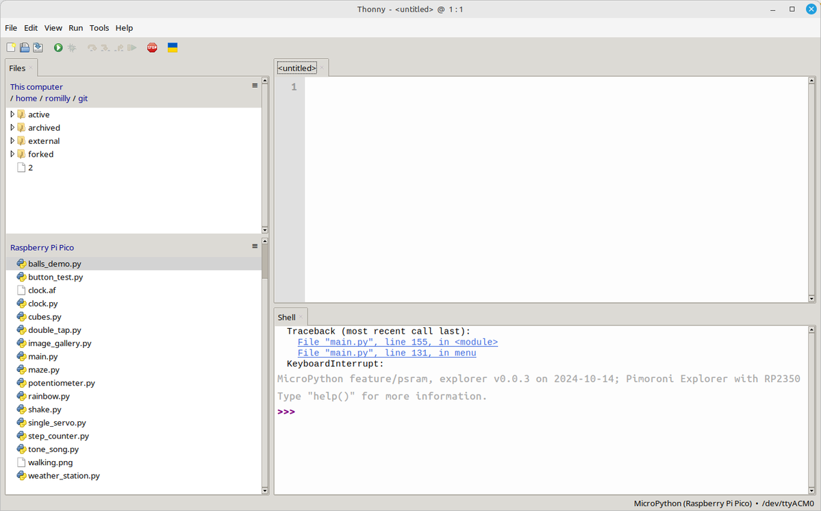

Using Thonny
Once Thonny is installed, start it up and connect your Explorer to your computer using the supplied USB cable. Make sure you have 'Raspberry Pi Pico' selected as your interpreter, at the bottom right.
You should see a screen like this:
Thonny start-up
In the top left window, you can see a list of files on your computer.
In the bottom left window, you can see a list of files on your Explorer.
❗ If you don't see the Files window, you can make it them visible using 'View > Files`
The top right window allows you to write, see and edit your code.

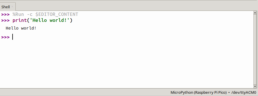

The bottom window is a REPL (Read-Eval-Print Loop) where you can type Python code and run it on the Explorer, line by line.
❗ If you don't see the >>> prompt then Explorer might be busy running some other code - press the red STOP button in Thonny's toolbar to interrupt it.
Let's see how the REPL works now! Type print("Hello World") and press Enter. You should see the text "Hello World" appear in the bottom window.
Hello World!

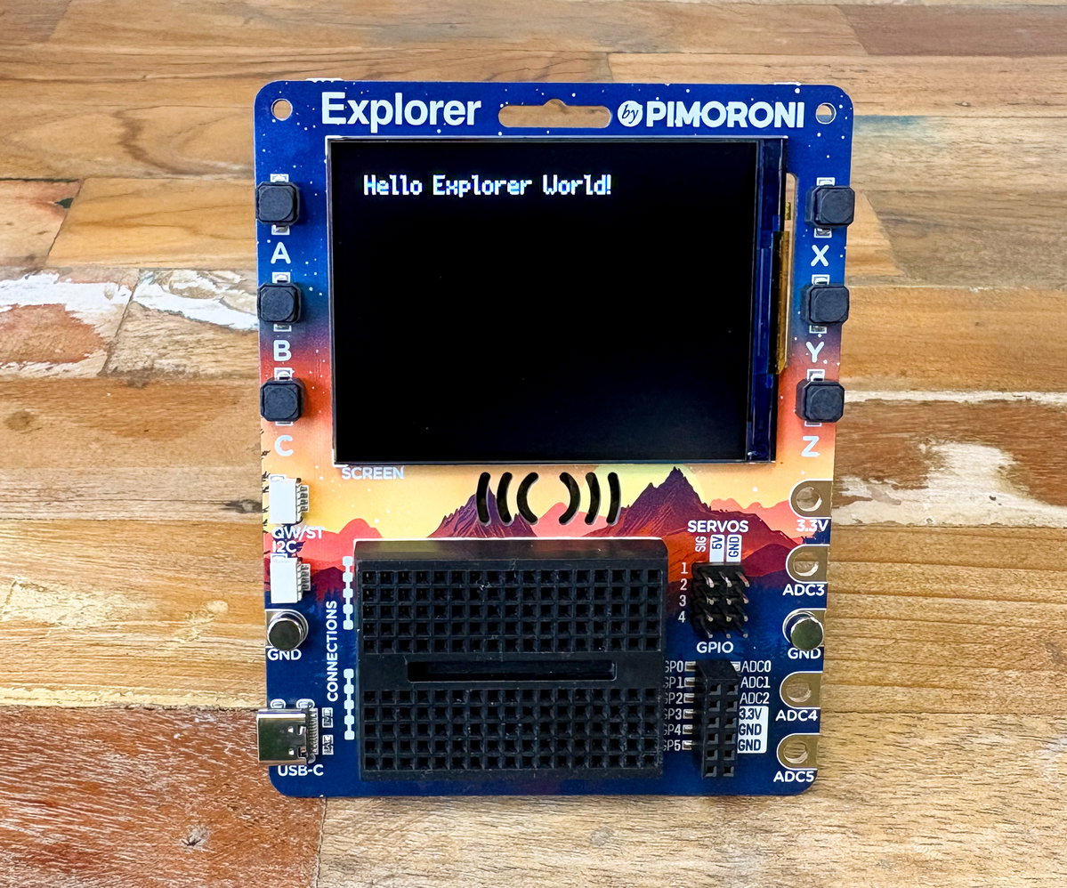

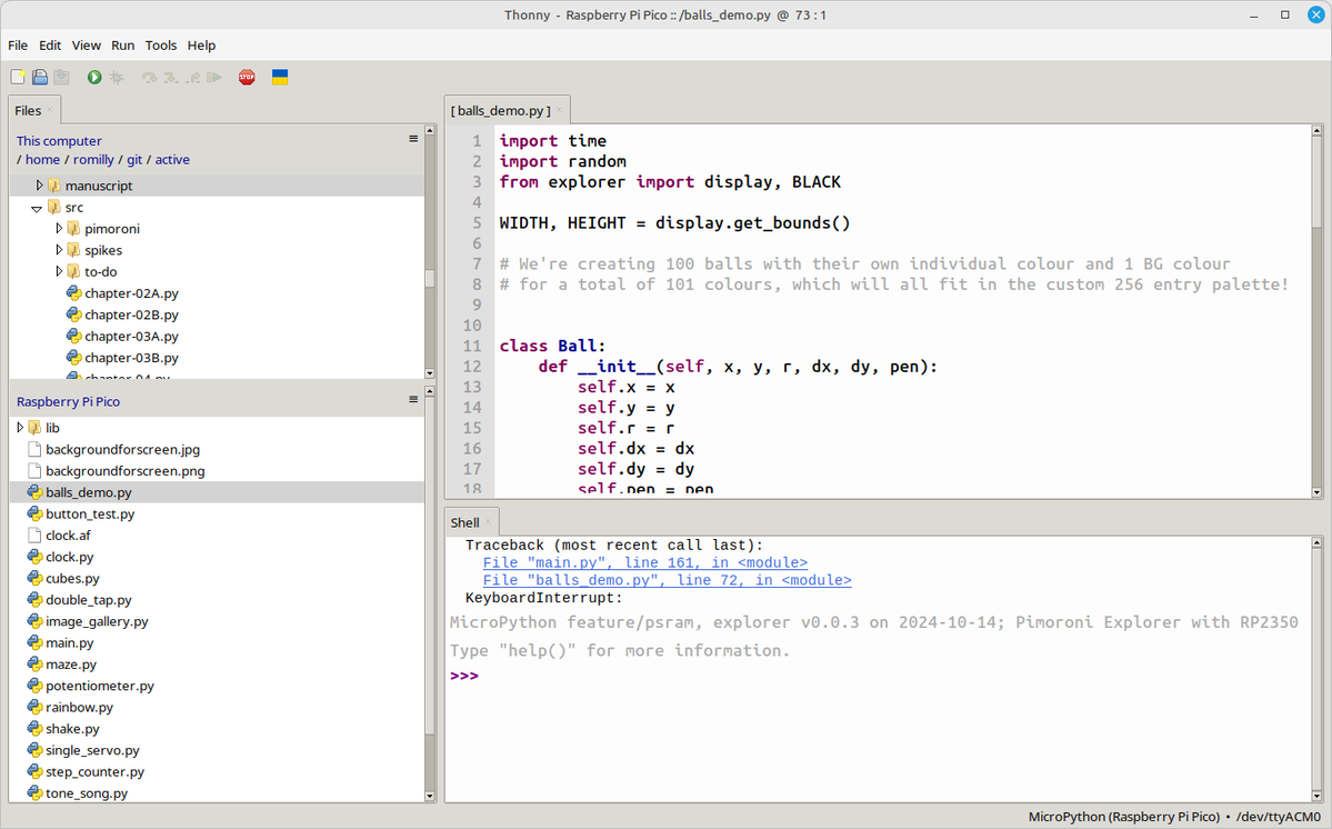

In the first experiment, you’ll use the explorer module to display text on the LCD screen of the Explorer.
Browse to the directory containing the unzipped examples in the top left Files window, locate hew.py and double-click on it.
The code should appear in Thonny's top right-hand pane. You can click the green run button in the toolbar to run it.
The explorer module provides a preconfigured display object which you'll use to control the screen display.
from explorer import display, BLACK, WHITE
The remaining code clears the screen, sets the font and pen colour, and writes 'Hello Explorer World!' on the display.
# Clear the display to black
display.set_pen(BLACK)
display.clear()
# Set pen to white for text
display.set_pen(WHITE)
# specify the font
display.set_font("bitmap8")
# Display the text (x=20, y=20, scale=2)
display.text("Hello Explorer World!", 20, 20, scale=2)
# Update the display to show the changes
display.update()
Here's what you should see:

The next experiment is based on one of the examples provided with the Explorer.
If you press reset at the back of your Explorer, the demo menu will appear.
Use the X button to select the BALLS DEMO and press Y to run it (alternatively you can find the example in the bottom Files window, double click on it and run the code using Thonny).
Lots of balls
How the code works
You don't need to type this code in as it's one of the demos that come with the Explorer. Let's see how it works.

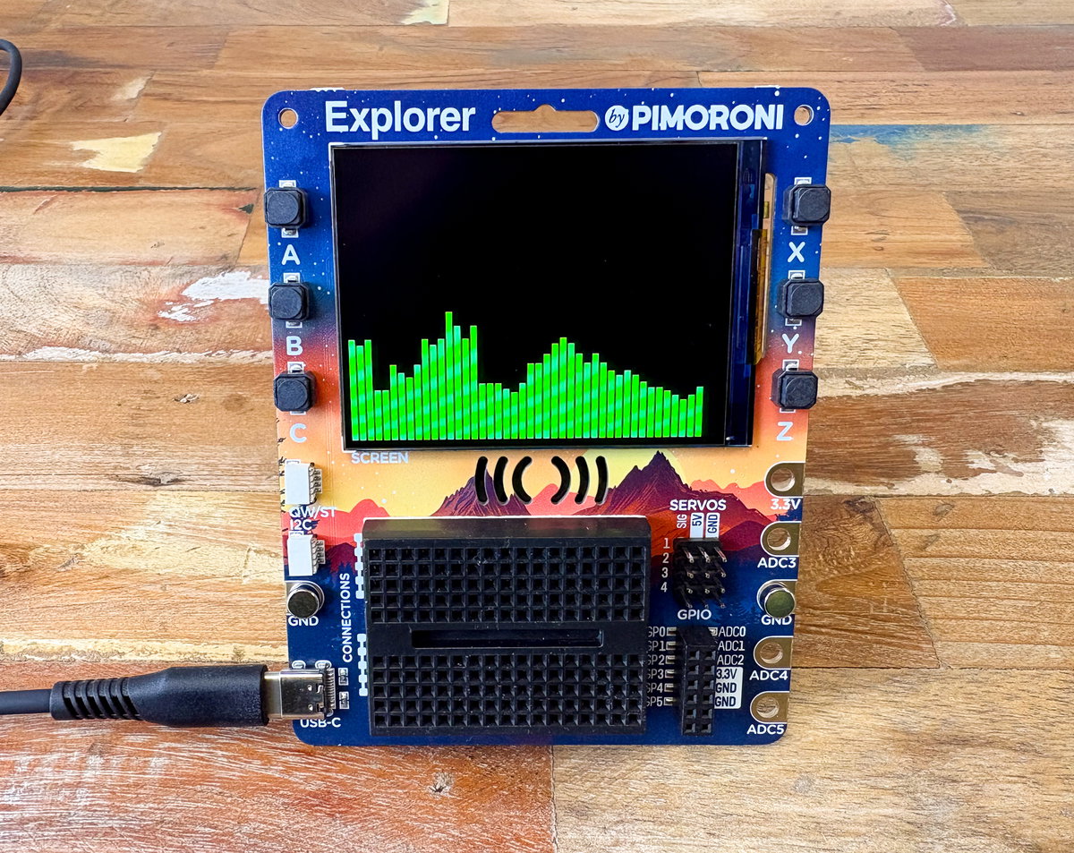

4. Tuning up
This example shows you how you can use play a tune by sounding different notes on the Explorer's speaker.
At the same time, you'll use the display to show how the pitch of the notes go up and down as the tune is played.
When you want to run this, you'll need to take an extra step, because the code is split over two files. The main program is called playful.py, and it uses another module (or Python file) called chromatic.py. You'll first need to upload chromatic.py to your Explorer, by navigating to it in the top Files box, right clicking on it and selecting 'Upload to Pico'.

Here's a picture of the Explorer in mid-song:
