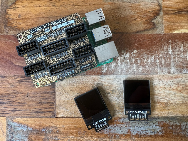

We'll cover how to use both the I2C and SPI versions of the breakout in this guide.

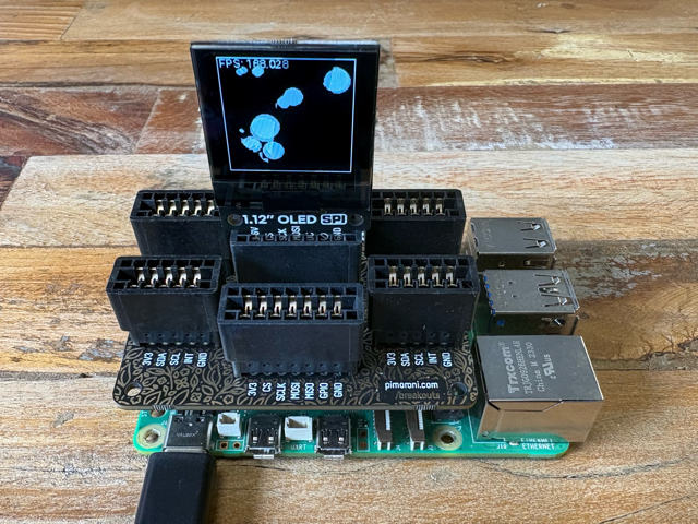

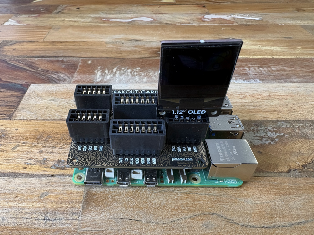

Here's what the I2C breakout looks like plugged in:

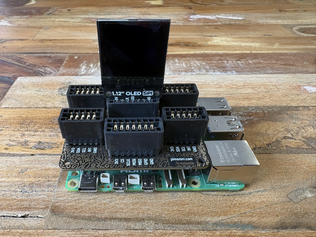

And here's the SPI version:

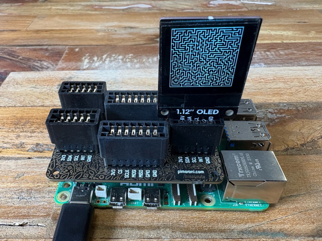

If you have an I2C breakout, you can run an example like this:
~/luma-env/bin/python maze.py --display sh1106 --height 128 --rotate 2 --interface i2c
