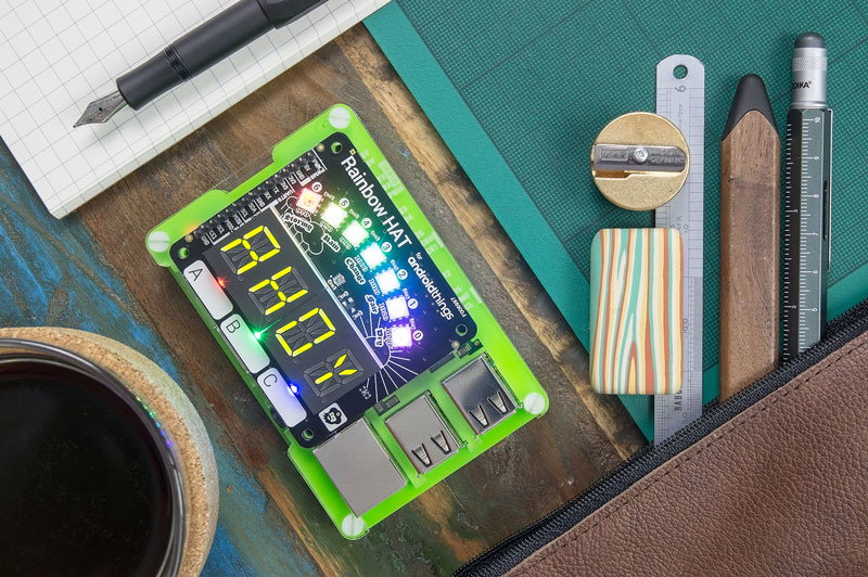

We're going to print the string AHOY to the displays. Similar to the rainbow
pixels, the displays have a show method, so after you've used print_str you
also have call show to update the displays with your string.
Type the following:
rh.display.print_str('AHOY')
rh.display.show()
