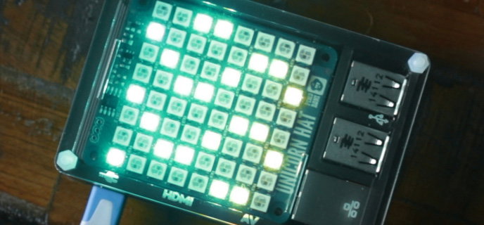

sudo python ./simple.py
If everything is working, you should see the UnicornHat fill with pinky-purple pixels. If so, hurrah! You're ready to move on to the next tutorial.
