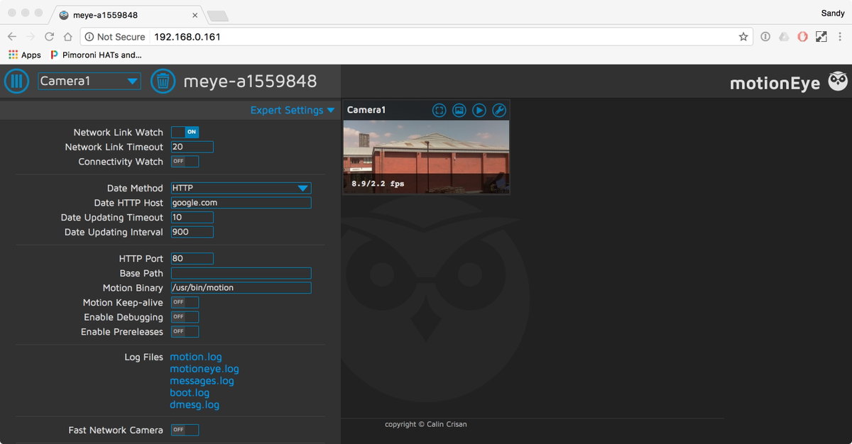

Because we provided the credentials for the Wi-Fi network, your Pi should have connected to it. You can use an app like Fing to check that it is connected and to find its IP address. Open a browser on your computer (or tablet, or phone), and type http://192.168.0.161, for example, replacing that IP address with the IP address of your OctoCam, into the address bar.
All being well, you should see a page like the one above, showing the view from your OctoCam! We'll log in as the administrator so that we can tweak the settings. Click on the icon that looks like a little person at the top left corner of the menubar to log in. The username is admin and the password is blank by default. Click Login.
To take the camera full screen at any time, click on the camera image and then on the square icon to go full screen. Press Esc to exit full screen again.
The photograph and play symbol icons let you access any captured images and video respectively, and the spanner lets you change the settings for your camera.

We'll go through some of the more important/relevant settings now. Click on the hamburger menu at the top left corner to pop out the settings menu.
The first thing that you should do is to change the Admin Password and Surveillance Password, i.e. add them! Also click the toggle switch next to Advanced Settings to get access to all of the advanced settings.
Once you've changed any settings, click the orange Apply button at the top, but note that it may need to reboot to apply the changes, so if you have a bunch of settings that you need to change then wait until you've done them all before clicking Apply.
You may want to change the video settings from the default, which is fairly low resolution. In our testing, 1280x720 at about 10 frames per second gives you a decent balance between quality and performance.
If you just want to set your OctoCam up as a streaming video camera, without any of the motion-activated capture of images and video, then you can enable the Fast Network Camera option. This will stream video at a surprisingly high frame rate and barely any lag, but disables all of the motion-activated capture features. We found that 1280x720 at 20 frames per second, and 25% image quality gave really good performance, but your mileage may vary depending on your network speed and load.
If you are using motion detection, then there are a bunch of settings you can change to alter the sensitivity, etc, but we found that the default settings worked well in an indoor setting, capturing movement of people.
The last relevant settings section is the Working Schedule. This allows you to schedule when the video and image capture triggered by motion is active. For instance, you might want it only to be active during the day, while you're out of the house at work. Or, if you're using the IR version of our Zero camera, then you might want it only to be active during the night.
You'll also find Software Update, Shut Down, and Reboot options in the General Settings section.
