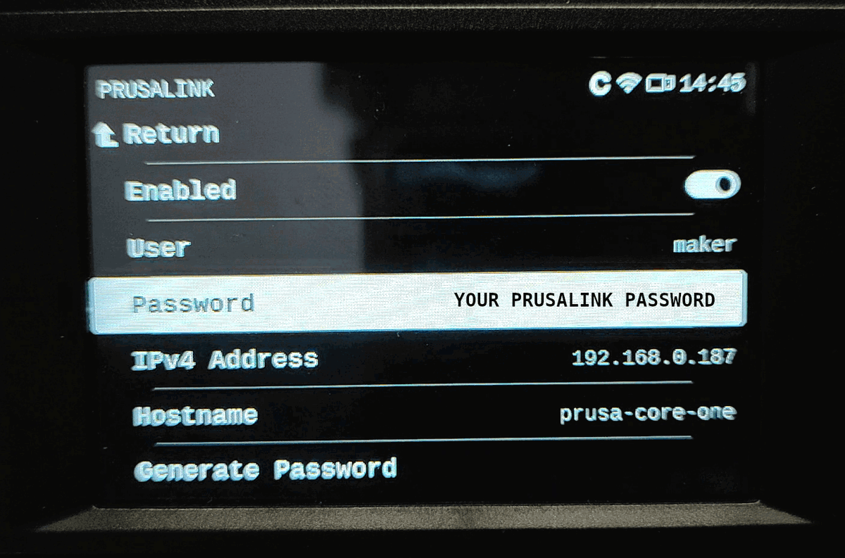

To use the API, we need access to the printer. That means we need a password. Luckily, this is easy to find on the printer.
There are two ways to get your PrusaLink password. Via the printer's user interface, or via PrusaSlicer.

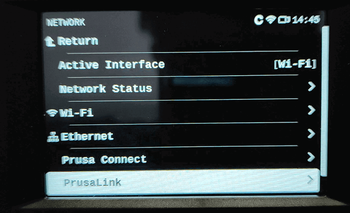

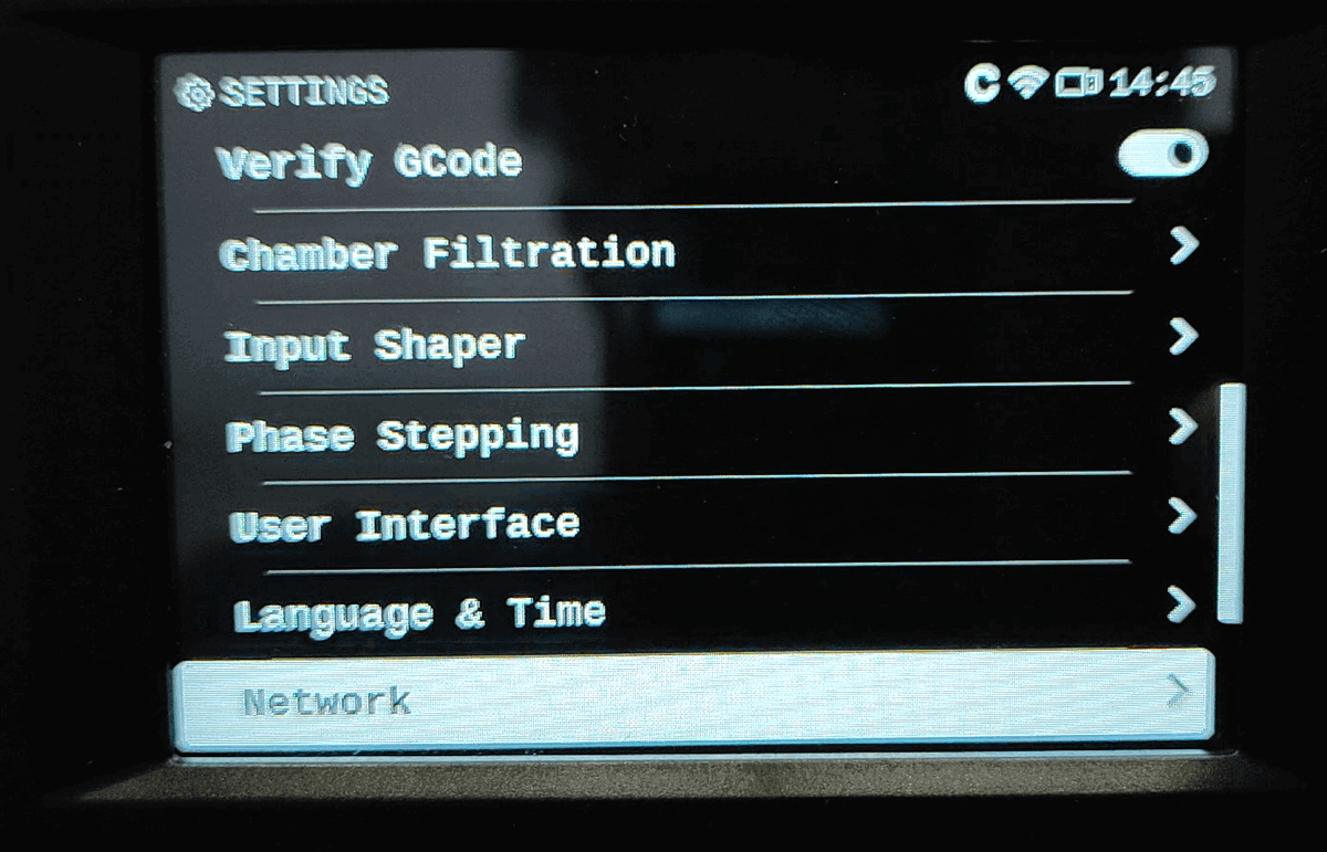

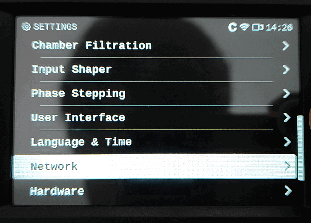

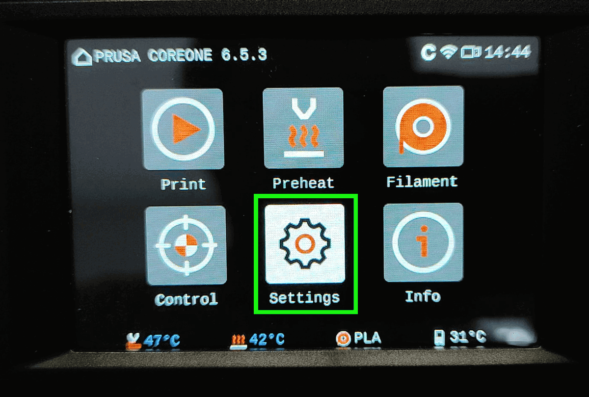

Via The Printer

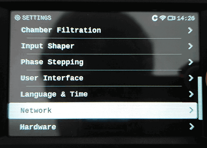

  1. From the user interface, navigate to and select Settings. You can use the touchscreen or use the dial. Pressing the dial in will activate the selected icon.

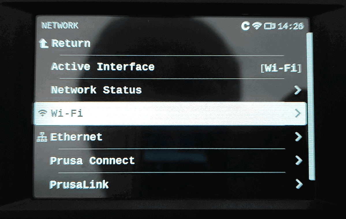

  2. Scroll down to Network and select.
  3. Scroll down to PrusaLink and select.
  4. Scroll down to Password and make a note of the password.

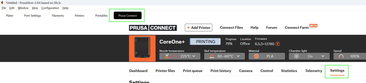

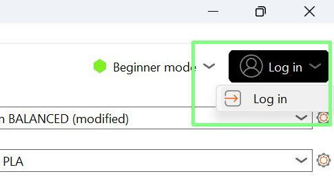

Via PrusaSlicer

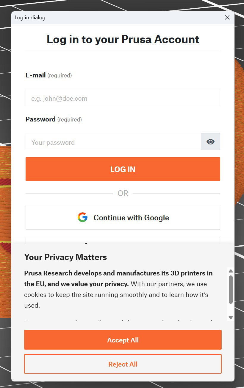

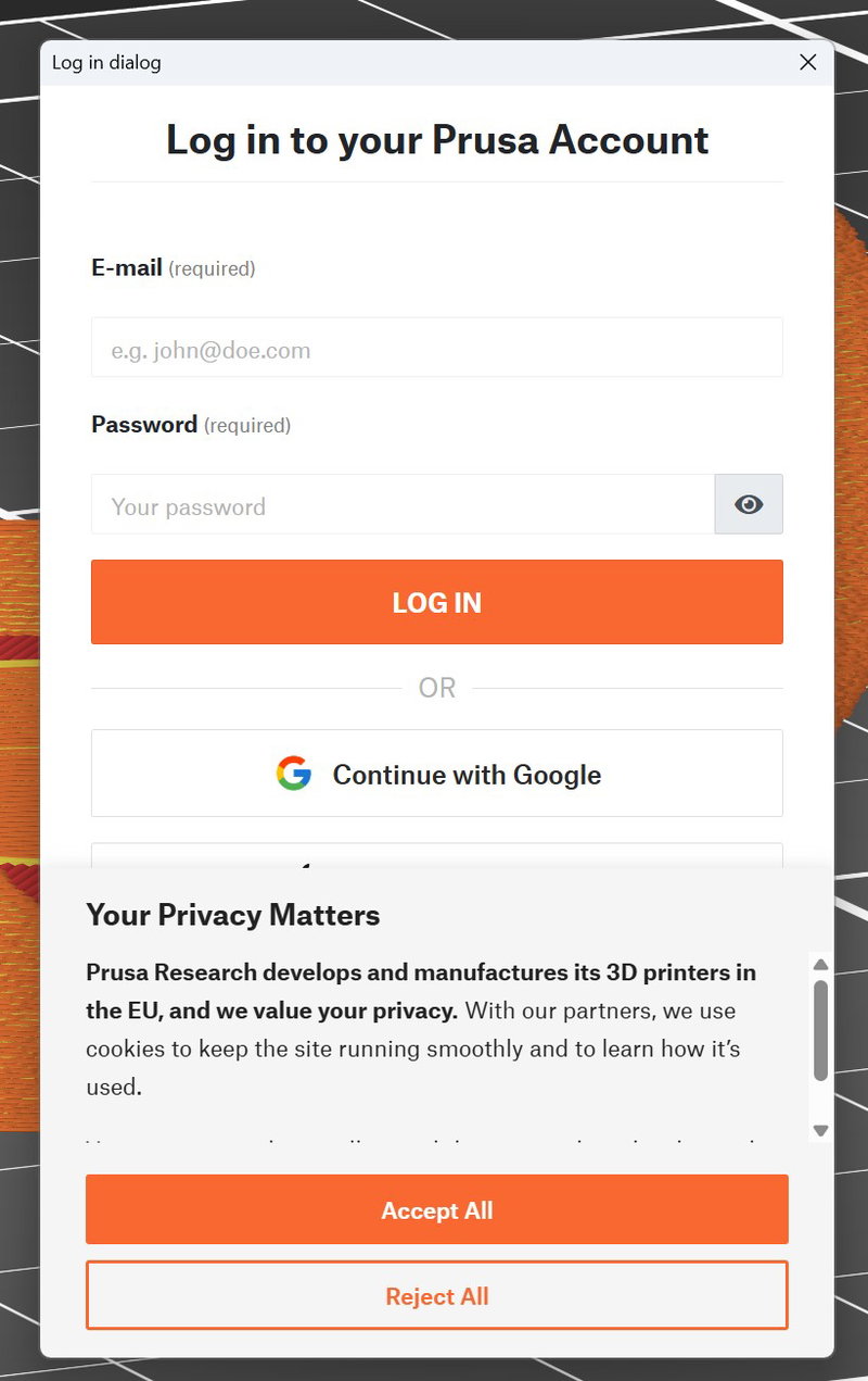

  1. Open PrusaSlicer and in the top right, click on Login.
  2. Login with your Prusa details. If you do not have an account, sign up for one now.

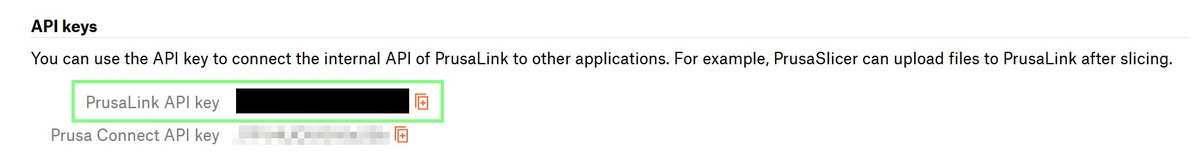

  3. In PrusaSlicer, click on Prusa Connect and then Settings.
  4. Look for your PrusaLink API key and click on the orange icon to copy the key. Put this key in a text file for now.

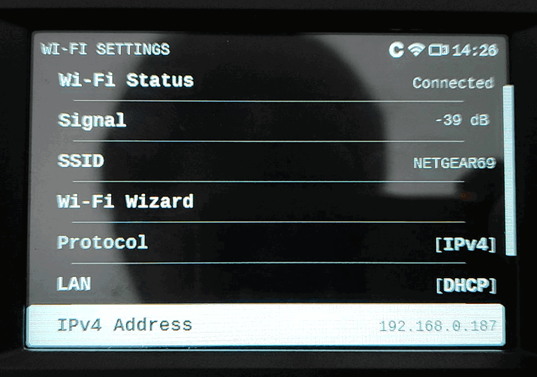

Finding Your 3D Printer's IP Address

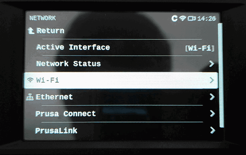

  3. Scroll down to WiFi and select.
  4. Scroll down to IPv4 Address and make a note of the IP.

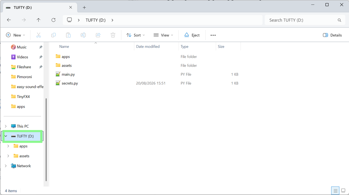

We'll be using the typical Badgeware workflow to create an app. First we create a folder inside the apps folder, then we add image assets and then write code that will run when the app is started.

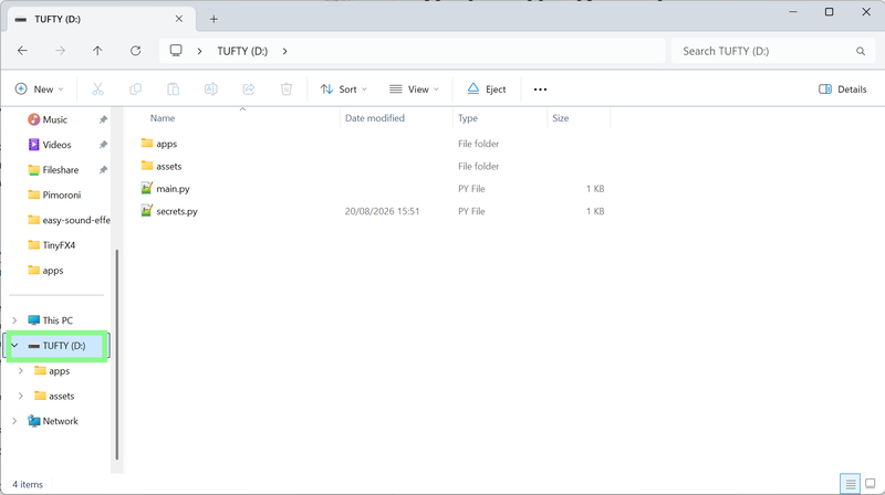

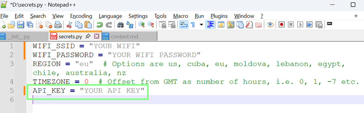

  1. Connect Tufty 2350 to your PC and press RESET twice to enter USB drive mode. Your PC will treat Tufty 2350 just like a typical USB flash drive.
  2. Open your operating system's file manager and navigate to a drive called TUFTY.

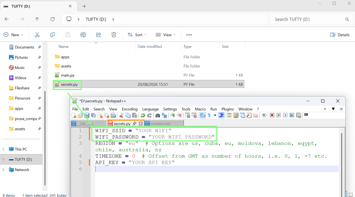

  3. Open secrets.py in a text editor and enter your Wi-Fi SSID and password.
  4. Create a new line at the end of the file and enter your PrusaLink API key then save and close the file.
    API_KEY = "YOUR PRUSALINK API KEY HERE"

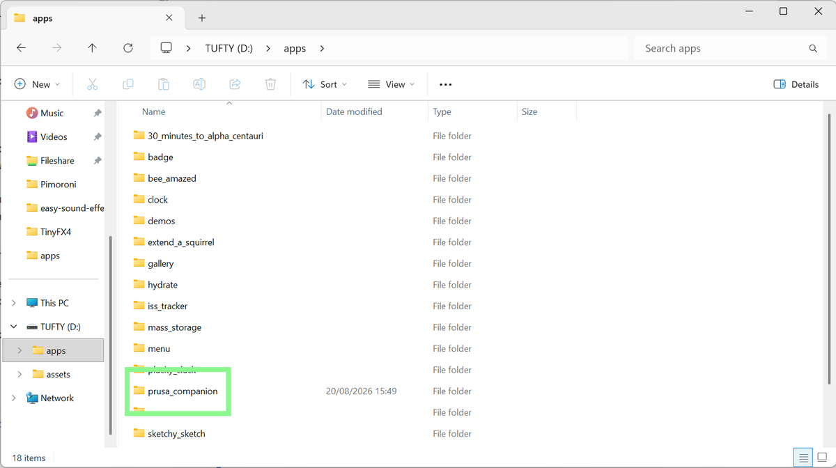

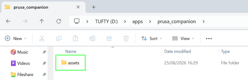

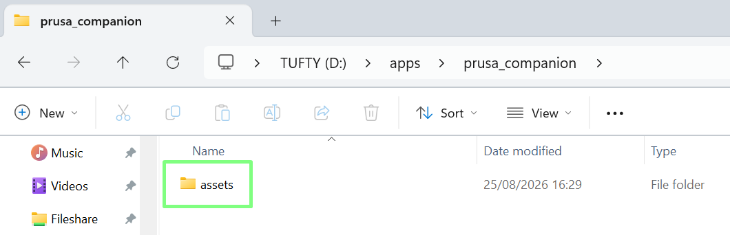

  5. Inside TUFTY drive, open apps and create a new folder called prusa_companion to contain our app.
  6. Open the prusa_companion folder and create a new folder called assets. In here is where we will store our images. Here are the images for you to download.

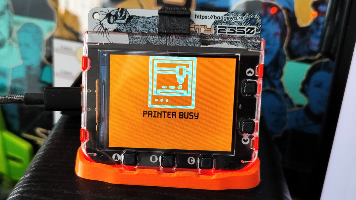

    2. busy.png: Printer Busy. Used when the printer is auto-homing or moving the print head / bed.

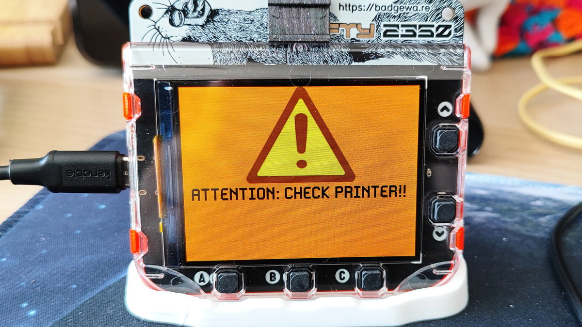

    "ATTENTION": {
        "asset": "assets/atten.png",
        "rect": (85, 0, 150, 131),
        "msg": "ATTENTION: CHECK PRINTER!!",
        "pen": BLACK,

    "BUSY": {
        "asset": "assets/busy.png",
        "msg": "PRINTER BUSY",
        "pen": BLACK,

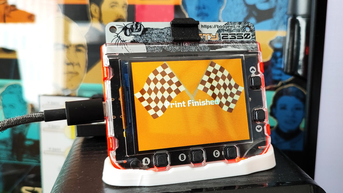

Testing The Code

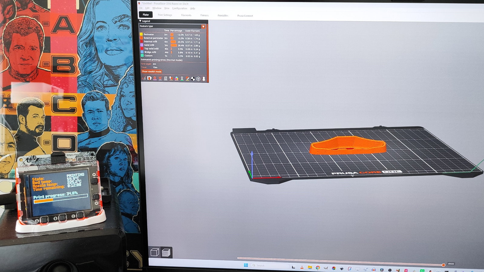

To test the code, we need a Prusa 3D printer, and something to print. We're printing one of our Badgeware stands in an orange PLA filament (not Prusa orange, sadly).

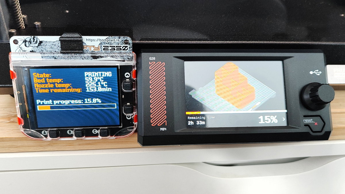

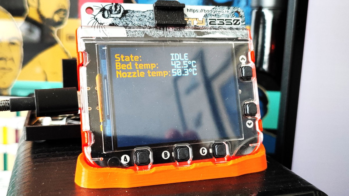

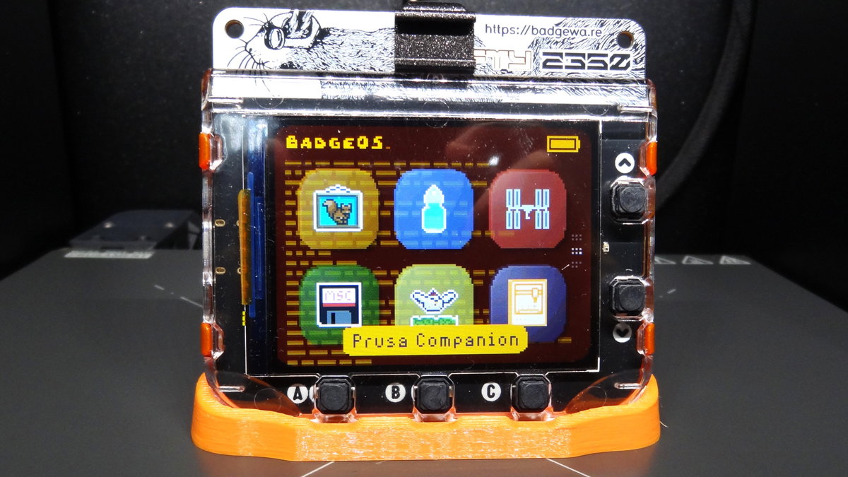

  1. On Tufty 2350, start the Prusa Companion app. The app will connect to your Wi-Fi and then show the idle screen. We can see the current printer status, bed and nozzle temperatures.
  2. Using PrusaSlicer, send the print to your Prusa 3D printer so that it is ready to print. PrusaSlicer will ask you to confirm that the print area is clear of debris, clean and everything is ready to print.
  3. The Printing status screen will appear as the 3D printer goes through a series of steps before printing.
    1. You may see an `Attention`` screen advising of a firmware upgrade. This will trigger Tufty 2350 to direct the user to the printer.
    2. The printer will heat up the print bed, and we can see the temperature climb on Tufty 2350.
    3. The nozzle will heat up and this is visible in the app.
    4. The Printing screen will appear and show the progress of the print. The progress bar will update as the print continues.
  4. When the print is finished, the Finished screen will appear. To exit this screen we need to press the dial in, and then press HOME.
  5. The Prusa Companion app will now revert to the idle status display.

PRINTER_IP = "192.168.0.187"
status = fetch.url(
    f"http://{PRINTER_IP}/api/v1/status",
    every=1,
    headers={"X-Api-Key": secrets.API_KEY},

STATE_SCREENS = {
    "FINISHED": {
        "asset": "/assets/finish.png",
        "rect": (0, 0, 320, 158),
        "msg": "Print Finished",
        "pen": WHITE,
        "alpha": 127,
    "ATTENTION": {
        "pen": BLACK,
    "STOPPED": {
        "asset": "assets/stop.png",
        "msg": "PRINT STOPPED",
        "pen": BLACK,
    "PAUSED": {
        "asset": "assets/pause.png",
        "msg": "PRINT PAUSED",
        "pen": BLACK,
    "BUSY": {
        "pen": BLACK,

def draw_idle_screen(printer_state, temp_bed, temp_nozzle):
    screen.pen = ORANGE
    screen.text("State:", 10, 10)
    screen.text("Bed temp:", 10, 30)
    screen.text("Nozzle temp:", 10, 50)
    screen.pen = WHITE
    screen.text(printer_state, 150, 10)
    screen.text(f"{temp_bed}°C", 150, 30)
    screen.text(f"{temp_nozzle}°C", 150, 50)

def draw_status_screen(cfg):
    screen.pen = ORANGE
    screen.clear()
    sprite = image.load(cfg["asset"])
    has_alpha = "alpha" in cfg
    if has_alpha:
        screen.alpha = cfg["alpha"]
    screen.blit(sprite, rect(*cfg["rect"]))
    if has_alpha:
        screen.alpha = 255
    screen.pen = cfg["pen"]
    w, h = screen.measure_text(cfg["msg"])
    x = (screen.width - w) // 2
    y = (screen.height - h) // 2 if has_alpha else (screen.height + h) // 2
    screen.text(cfg["msg"], x, y)
def printer(data):
    try:
        screen.font = font.ignore
        print(data)
        printer_state = data['printer']['state']
        temp_bed = data['printer']['temp_bed']
        temp_nozzle = data['printer']['temp_nozzle']
        screen.pen = BLACK
        badge.clear()
        if printer_state in ("IDLE", "READY"):
        elif printer_state == "PRINTING":
            draw_printing_screen(printer_state, temp_bed, temp_nozzle, data.get('job', {}))
        elif printer_state in STATE_SCREENS:
            draw_status_screen(STATE_SCREENS[printer_state])
        badge.update()
    finally:
        pass
while True:
    if status:
        printer(status.json())
    time.sleep(1)
