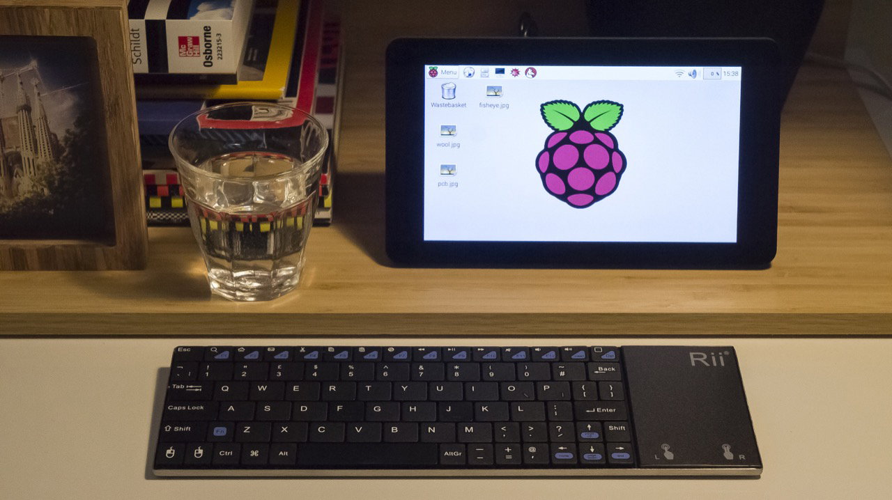

This guide will show you how to set up the Rii wireless keyboards with your Raspberry Pi. There are two different versions - a 2.4 GHz wireless keyboard with trackpad, and a Bluetooth wireless keyboard - which both require slightly different setups.
Wireless keyboard with trackpad
The wireless keyboard with trackpad is insanely easy to set up. You'll need to charge it for a good couple of hours before use, with the included USB to micro-USB cable, or use it while plugged in.
Make sure that you've switched it on with the little toggle switch on the top edge of the keyboard and then take out the wireless USB dongle that's stashed on the back of the keyboard and plug it into a spare slot on your Raspberry Pi.
And that's it. It should just work.
