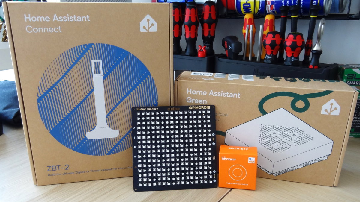

Sonoff Zigbee Wireless Switch Home Assistant Green or a Raspberry Pi 5 running Home Assistant Home Assistant Connect ZBT-2 for Zigbee / Matter / Thread connectivity Stellar Unicorn, Galactic Unicorn or Cosmic Unicorn

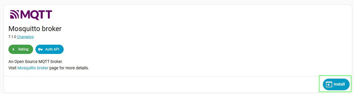

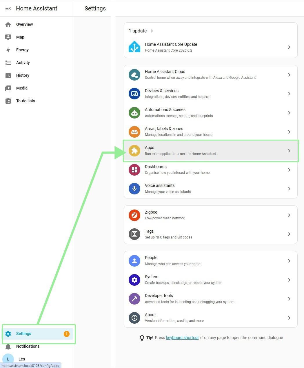

  1. Open Home Assistant in a browser and go to Settings >> Apps.
  2. Click on Install App.

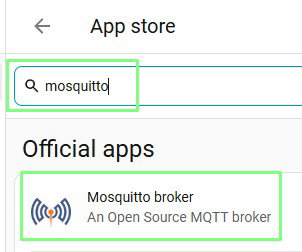

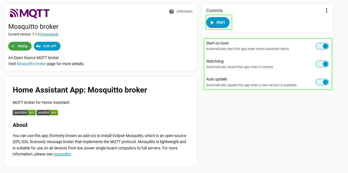

  3. Search for Mosquitto and click to open the app page.
  4. Click on Install.
  5. Set Mosquitto to start on boot, run a watchdog (to restart if it crashes) and to auto-update. Then click on Start to activate the Mosquitto MQTT broker.

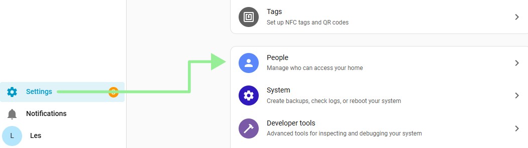

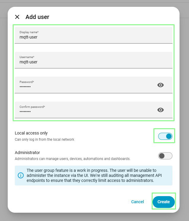

  6. Now go to Settings >> People.

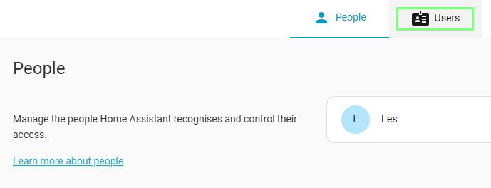

  7. Click on Users.
  8. Click on Add User
  9. Create a new mqtt-user and give the account a strong password. Set the user to have local access. Click Create when done.

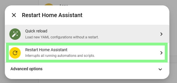

  10. Click on Settings and in the top right of the screen are the dots. Click on that and Restart Home Assistant. Doing this ensures that our changes are freshly updated and ready for use.
  11. Select a full restart of Home Assistant. Wait for the restart to finish before moving on. This can take a couple of minutes

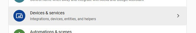

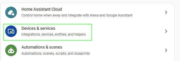

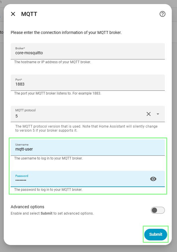

  12. Click on Settings >> Devices & Services.

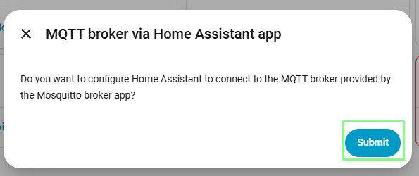

  13. MQTT should automatically be discovered, click on Add.
  14. Click on Submit to automatically configure the MQTT broker. Click Finish when prompted.

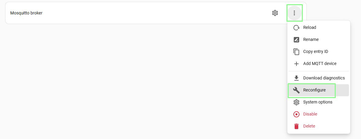

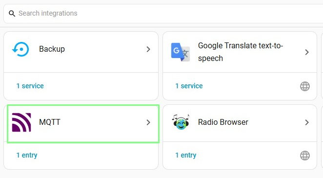

  15. Click on Settings >> Devices & Services and then MQTT.
  16. Click on the three dots and select Reconfigure.
  17. Change the MQTT username and password to the user account that we created earlier and then click Submit.

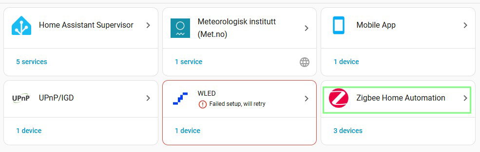

  18. Click on Settings >> Devices & Services.

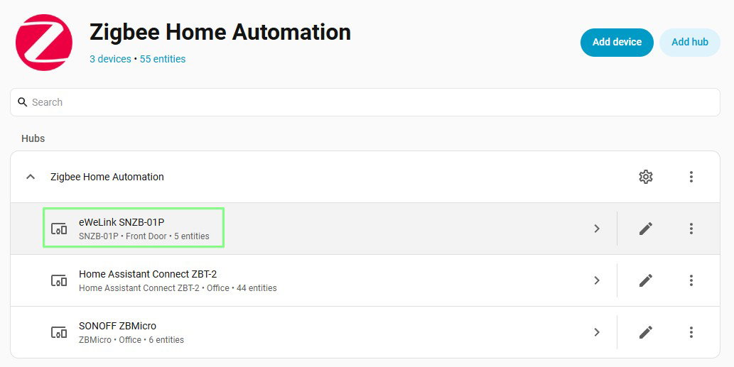

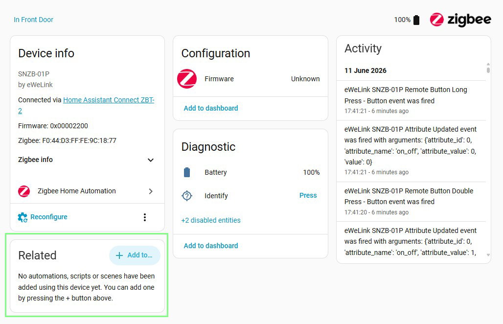

  19. Select Zigbee Home Automation.
  20. Select the eWeLink SNZB-01P (Sonoff SNZB-01P) button.

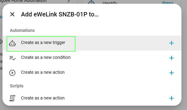

  21. Under Related, click on Add to.

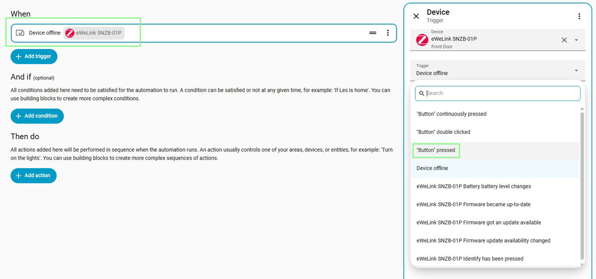

  22. Click on Create a New Trigger. In Home Assistant parlance, this is called an Automation.
  23. Set "When" the button is pressed.

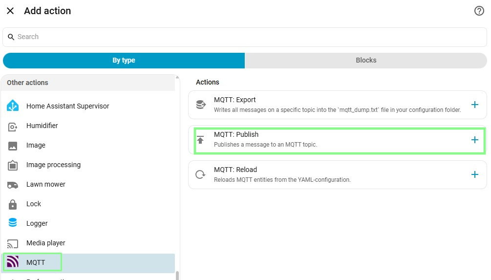

  24. Click on Add Action which is under "Then Do".

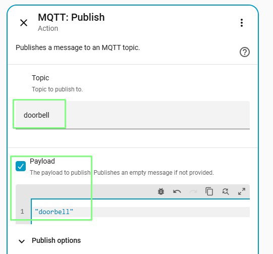

  25. Scroll down the list to MQTT and select MQTT Publish
  26. Set the topic to doorbell and the payload to doorbell. Click on Save.

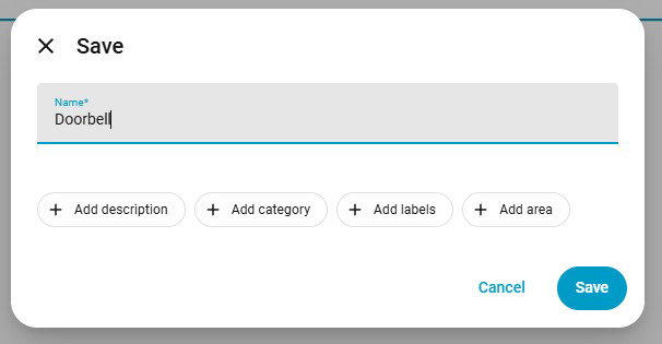

  27. Name the automation "Doorbell" and click Save.

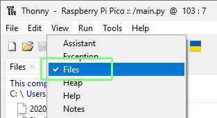

  2. Open Thonny and connect to your Stellar Unicorn.
  3. Click on View >> Files to see the files on Stellar Unicorn and your computer. We will be moving files from our PC to Stellar Unicorn and Thonny's file manager is the easiest way to do so.
  4. Download audio.py and doorbell.wav from this GitHub repository.
  5. Using Thonny's file manager, copy the downloaded files to Stellar Unicorn by right clicking on the file and selecting "Upload to /".

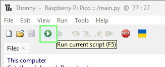

  2. Click on the green run icon (it looks like a play button) to run the code. Doing it from Thonny enables us to see any errors or issues.

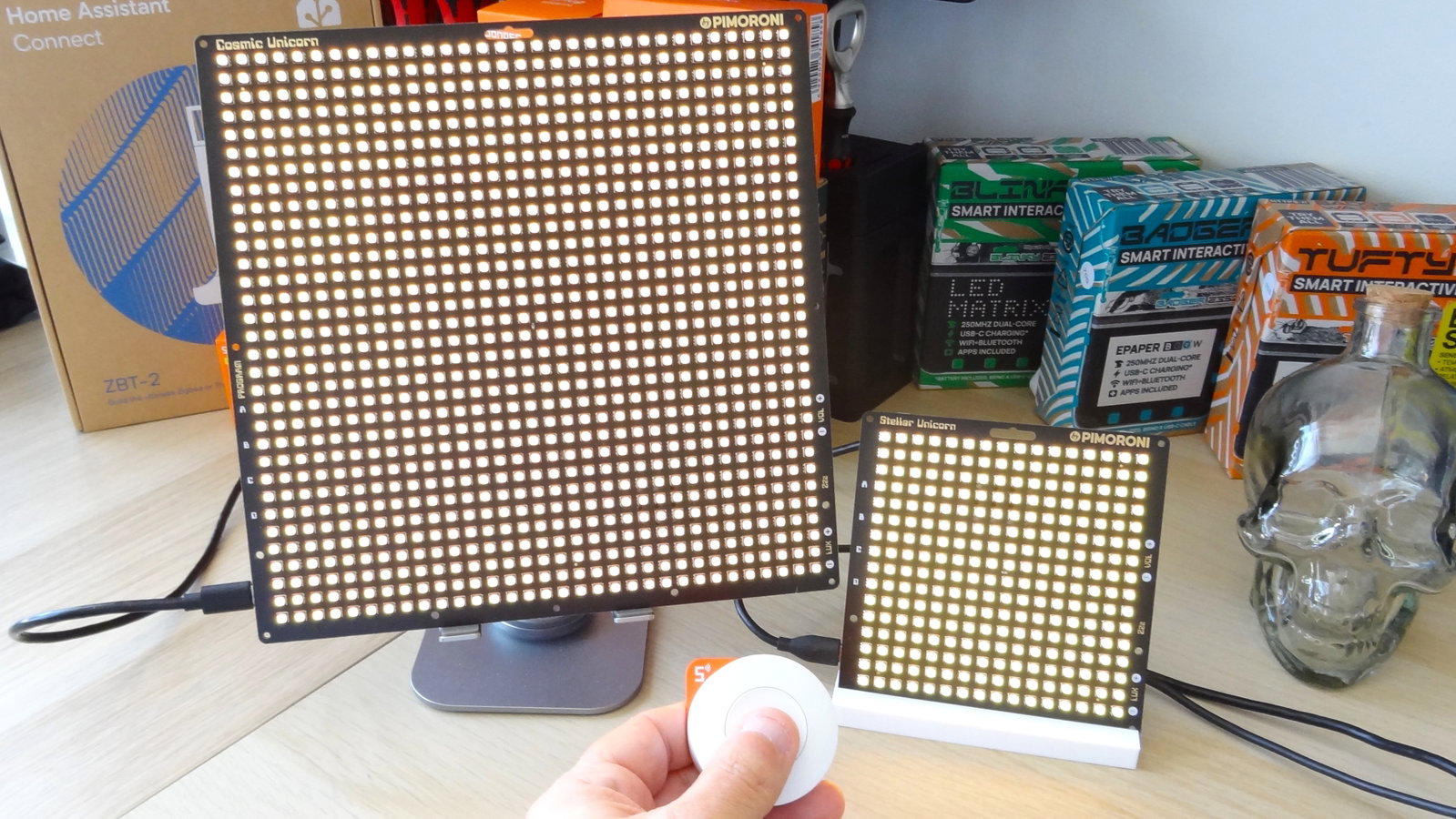

  3. You should see the RGB LED matrix flash green, wait a couple of seconds and then grab your Zigbee button and press it to trigger the doorbell. You should hear a "ding dong" and see the matrix light up yellow.
