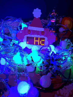

The code is finished now, so time to print the beard and hat, or other accessories for your Scroll Bot.
verily and lo it was festive
I held mine on with Blu Tack, but you could innovate.
