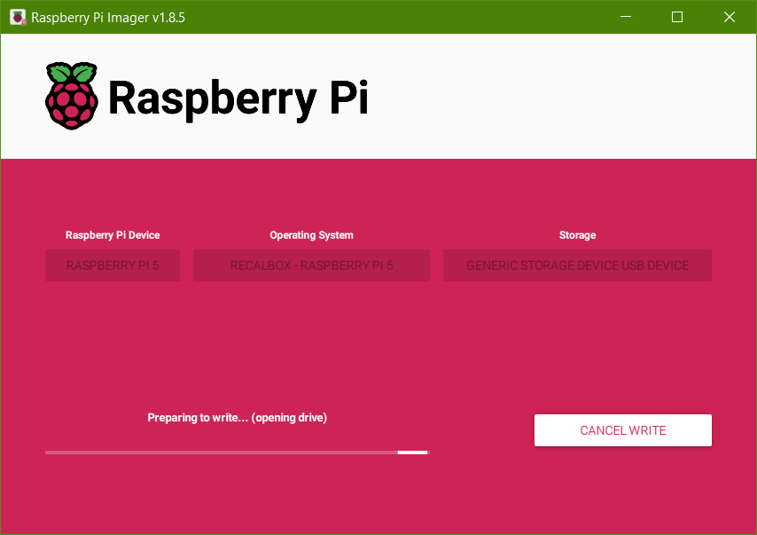

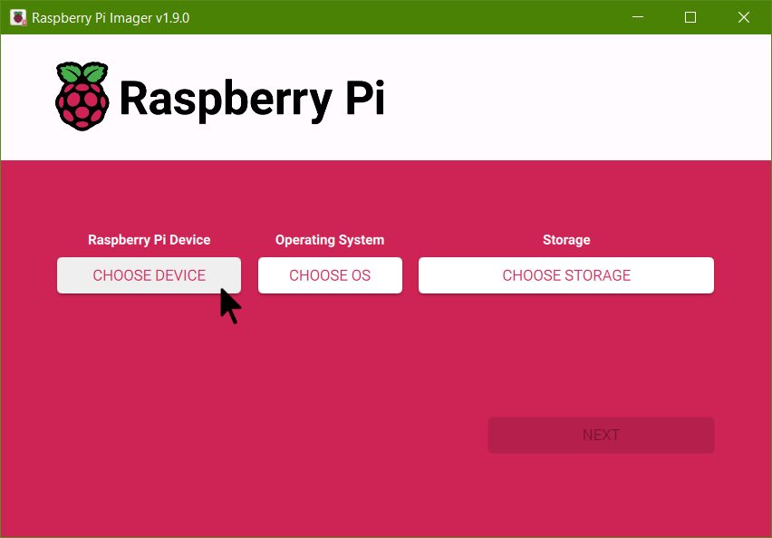

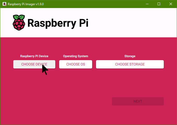

Start Raspberry Pi Imager on your computer.

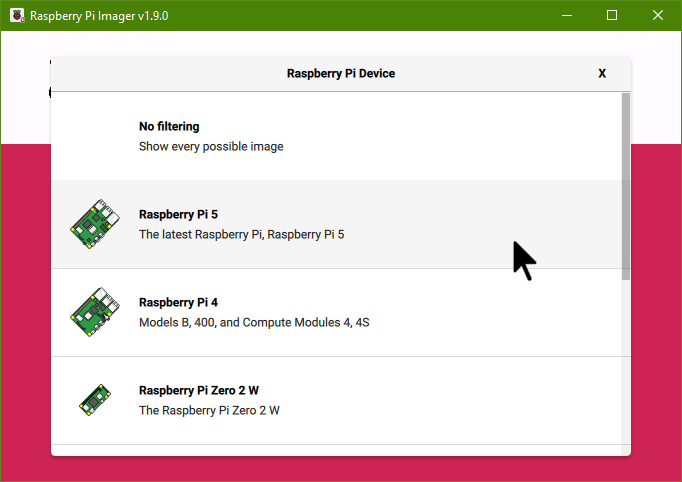

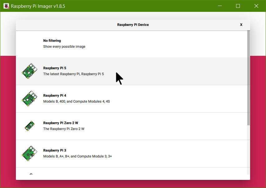

Click on Choose Device and then pick Raspberry Pi 5.

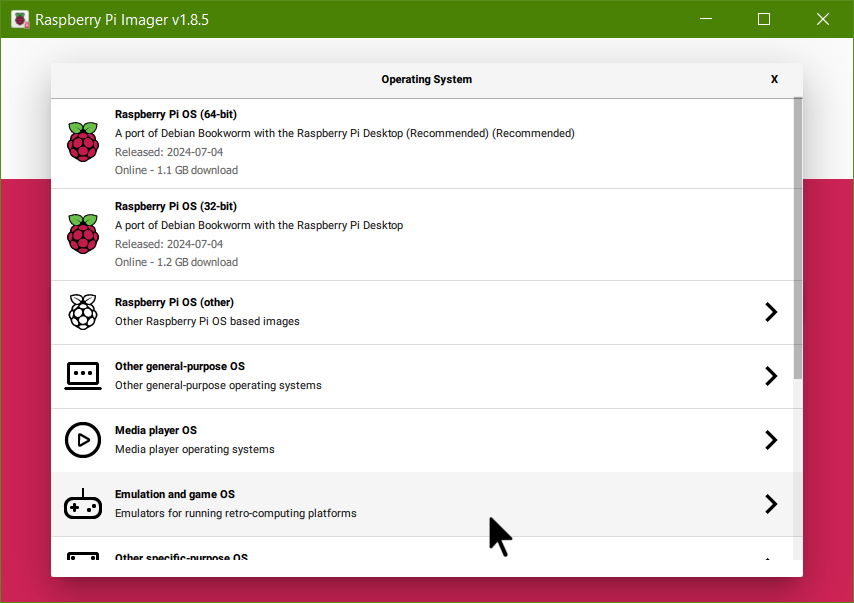

Next, click on Choose OS and then scroll down to find Emulation and Game OS.
Here, you’ll find the options for the emulator. Right now, the only one available for the Raspberry Pi 5 is Recalbox.

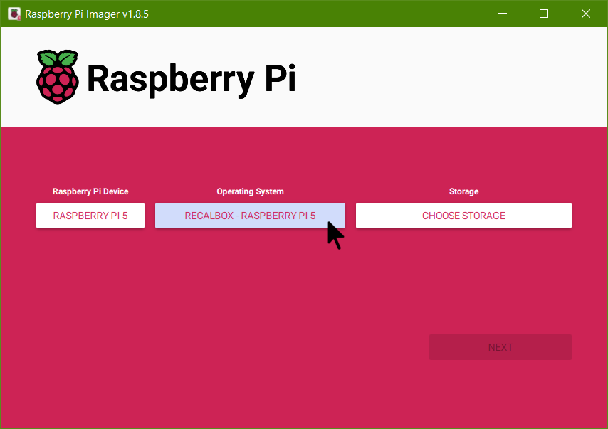

Choosing Recalbox will bring you back to the main Imager screen.

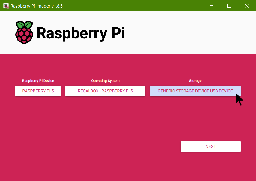

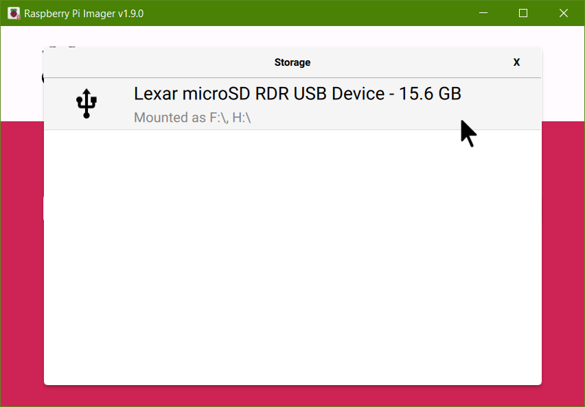

Insert an SD card into your card reader, then click on Choose Storage. You will see a list of storage devices. Select your SD card.

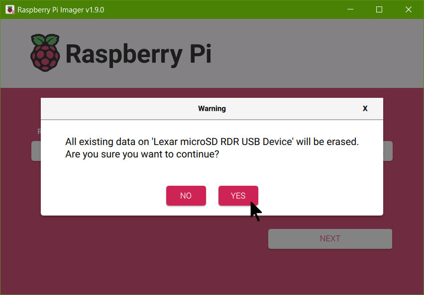

By clicking Next, you’ll be notified that all data on your SD card will be deleted. Click Yes to confirm that you want to install Recalbox on the SD card.

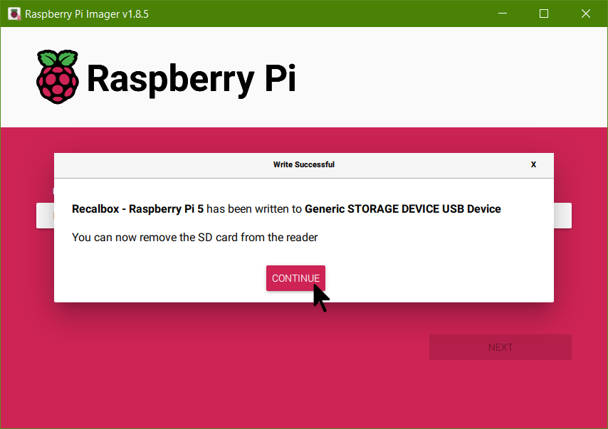

Wait for the card to finish writing. Once it's done, take the card out of your card reader and put it into the Raspberry Pi 5 inside the Picade Max.

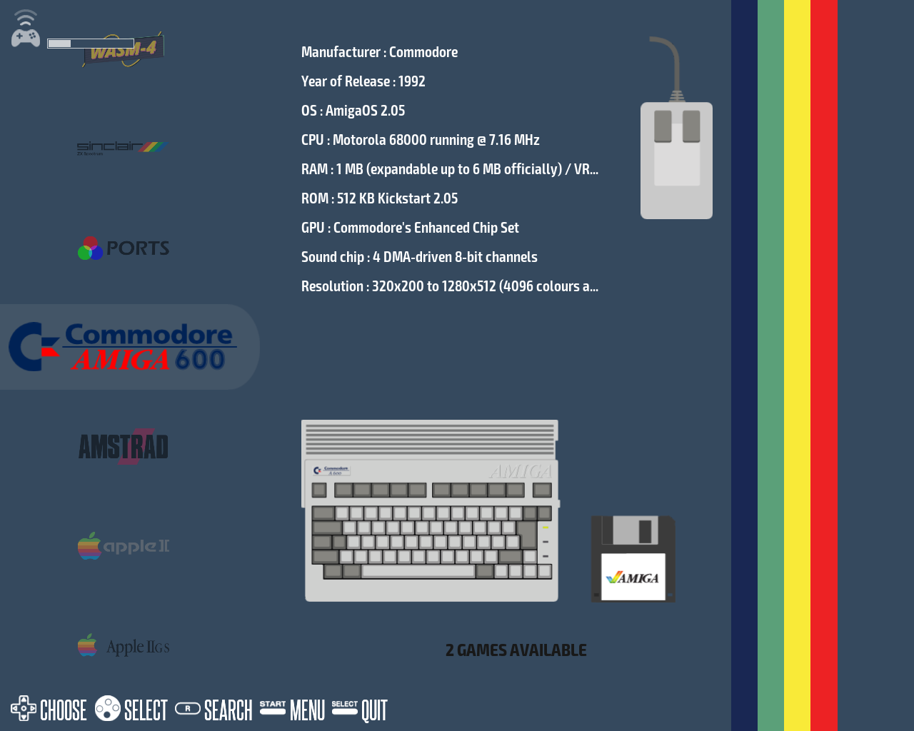

When you boot Recalbox this is a typical image of what you will see:
Move the joystick up and down to choose between different emulators. Press the ‘A [Select]’ button to pick the one you want to use. Once the list of games is shown, use the same actions to navigate the list and start a game.

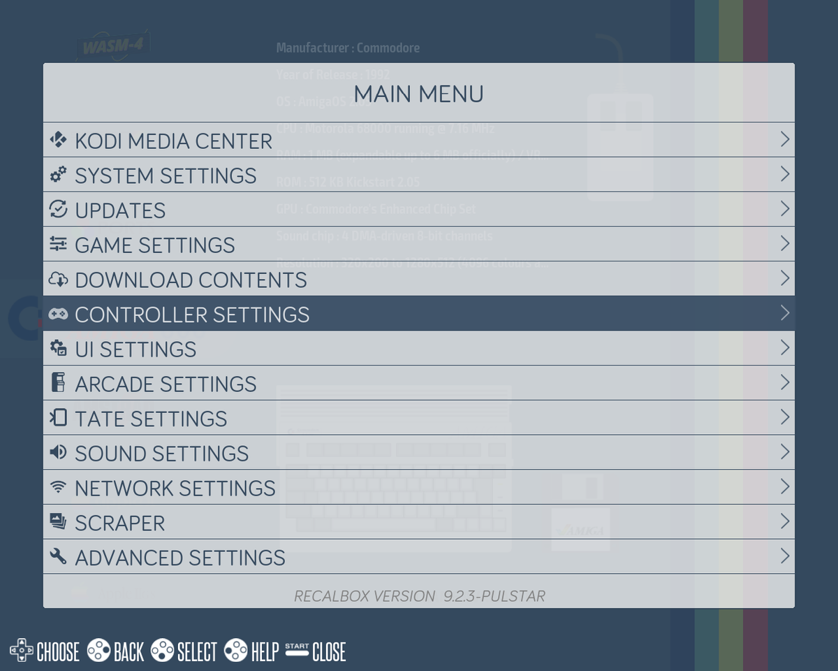

Change Recalbox Settings

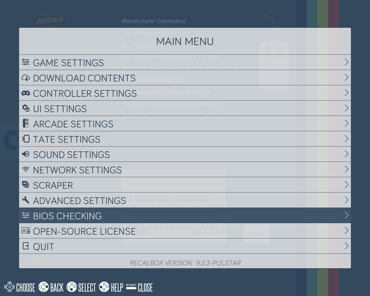

Recalbox has a lot of different settings. We’re not going to take you through them all because that would take a long time! However, here are some of the most important ones. You can change Recalbox settings from the Main Menu, accessed by pressing the ‘R3 [Main]’ button.
Use the joystick to navigate through the options, and press 'A [Select]' to open a sub-menu or choose an option. To return to the previous menu, just hit the 'B [Back]' button. To find a specific game, just click the 'R1 [Search]' button. Use the onscreen keyboard to spell out the name of the game, using the 'Y [Backspace]' to delete a character if you made a mistake.
You can shutdown or restart Recalbox using the Quit menu by pressing the ‘L3 [Quit]’ button.

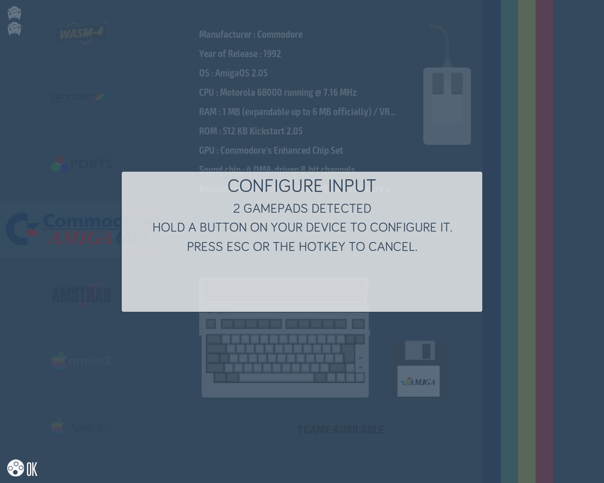

Recalbox will see that you have two controllers connected, even if you are only using the one player layout, and will ask you to choose one to set up. To do this, press and hold the chosen controller’s ‘A [Select]’ button until the setup menu shows up.
You can now change the buttons for each action by pressing the one you want for each action. Just keep in mind that this will also affect how you move around the Recalbox menus. It might be best to wait until you have everything set up the way you want before making these changes.

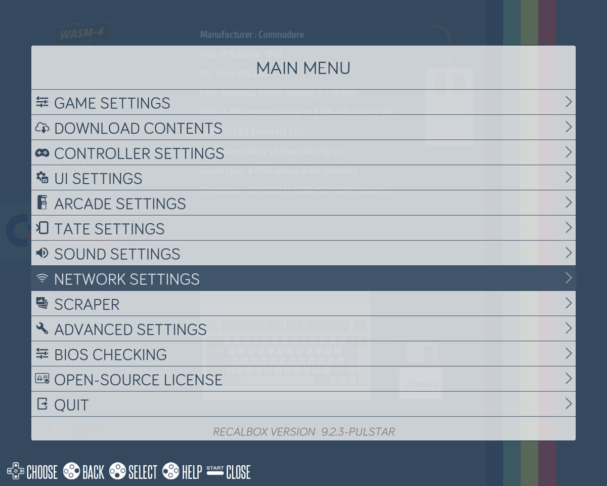

Scroll down to Enable Wi-Fi and enable it by pressing ‘A [Select]’.
Move to Network Name and use left/right on the joystick to scroll through available networks.

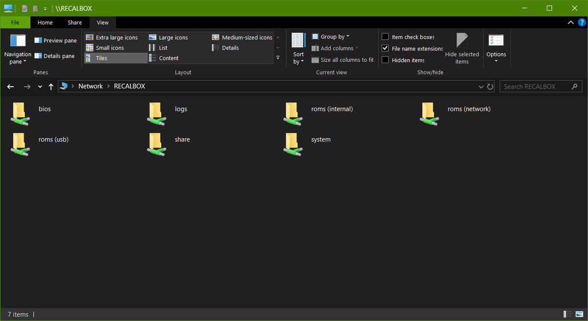

You can connect remotely to Recalbox in three helpful ways once you have a network connection:
  • Shared folder access
  • The Recalbox web manager
  • Login via ssh
Access the web manager from your computer by browsing to http://recalbox (or whatever name you have used as the hostname). From there you can see the installed emulators and games, monitor your Raspberry Pi and make settings changes.

After you have located the BIOS files you need, transfer them to your Raspberry Pi. If you're using Windows, open File Explorer and type \\RECALBOX in the address bar, or you can use the IP address. You'll need to log in with the username root and the password recalboxroot.
On a Linux machine, mount the BIOS folder with:
  • mkdir ~/recalboxbios
  • sudo mount -t cifs //recalbox/bios ~/recalboxbios
  • When asked for the root password, use: recalboxroot
  • You can also open the file manager and type smb://RECALBOX/bios in the address bar. You can log in as an anonymous user without a username or password.
The 'bios' folder has a separate folder for each machine you want to emulate. Just put the additional BIOS files into the right folder.

From the Main Menu (accessed by 'R3 [Main]'), go down to Sound Settings
Press ‘A [Select]’ to open the sound settings menu:
Move down to Output Device, and press ‘A [Select]’.
Scroll to Digital Output (S/PDIF) - Picade USB AUDIO and select it with ‘A [Select]’.
Return to the Recalbox platform page using ‘B [Back]’.
You should now be able to enjoy music and sounds from the speakers of your Picade Max.

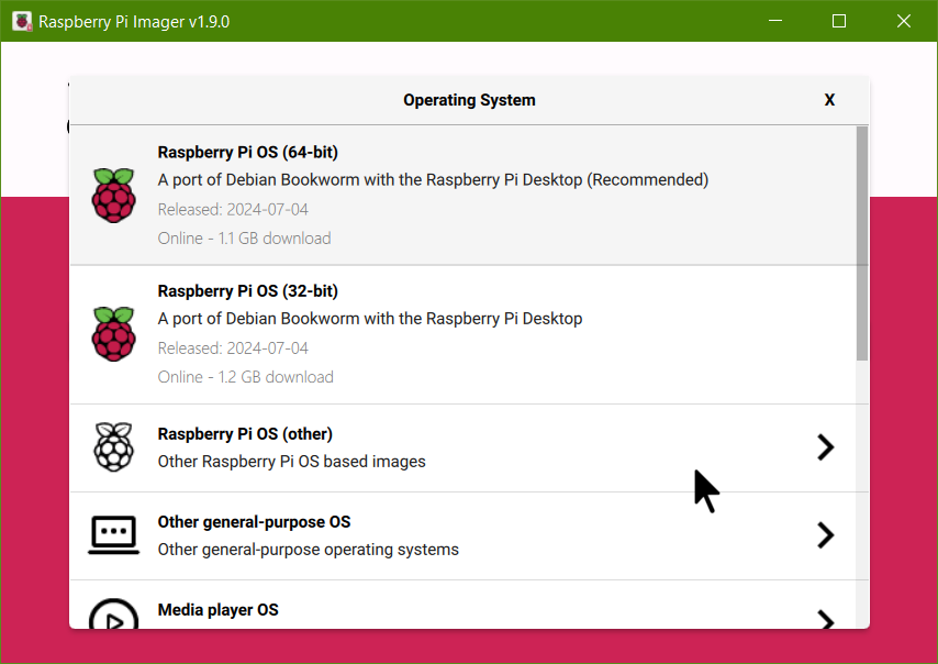

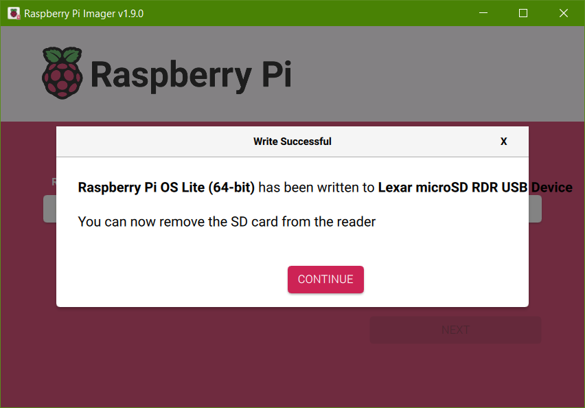

You're going to start with a basic Raspberry Pi OS image, so fire up Raspberry Pi Imager. We'll be using the Lite version as we're planning on connecting to our Pi 'headlessly' from another computer, but if you'd like to have access to the Raspberry Pi graphical interface you can use the Full/Desktop version instead.
Click on Choose Device and pick Raspberry Pi 5.

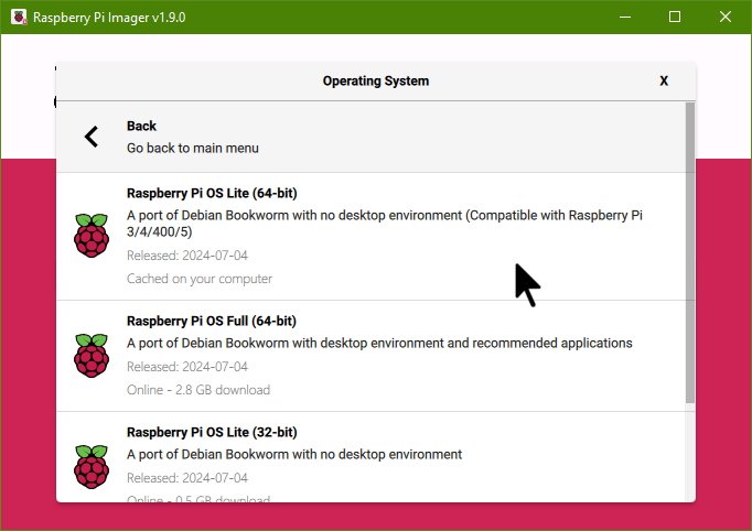

Click on Raspberry Pi OS (Other):

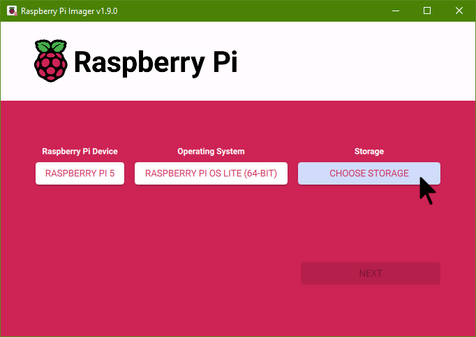

Select Raspberry Pi OS Lite (64-bit):

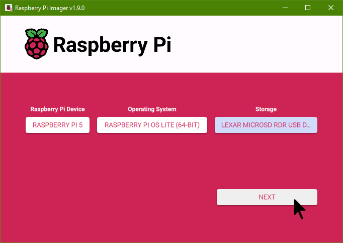

On the next screen, click on Choose Storage:
Select your SD card:
Select Next to start writing the OS to the SD card:

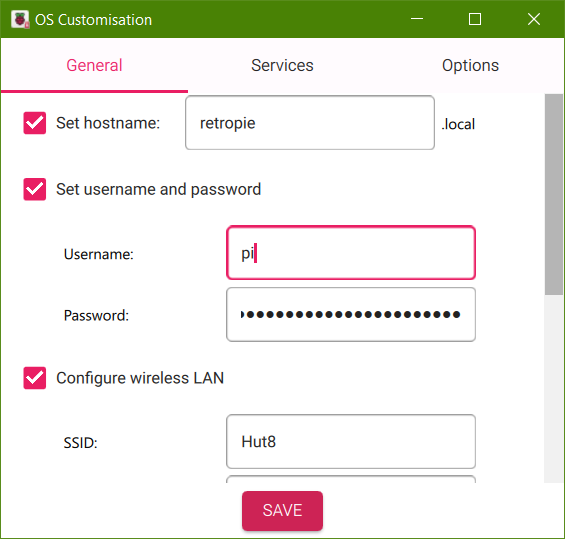

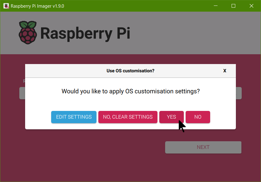

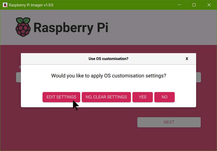

But before you start, you need to set up the operating system so you can log in from another computer using SSH. Click on Edit Settings:
In the General Tab, change the device name to RetroPie, update the password to something new, and set up your Wi-Fi connection.
In the Services section, turn on SSH so you can log in from another location and transfer files using SFTP. Then, click Save.

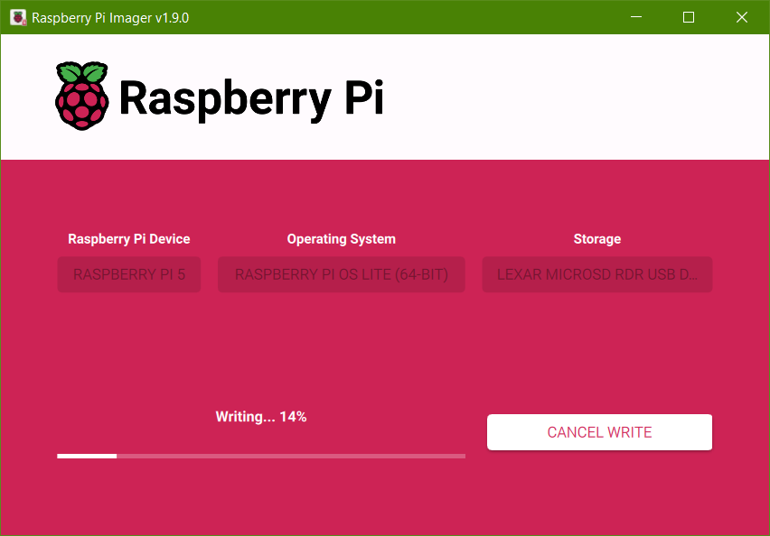

Then click on Yes. Raspberry Pi OS Lite will be written to the SD card:
Confirm it is okay to overwrite your SD card:
And wait for the OS to be written:
After it's finished writing, you can safely remove the SD card and insert it into your Raspberry Pi in the Picade Max.
