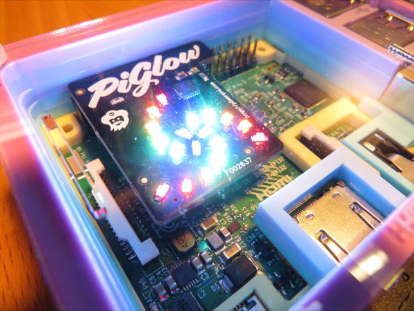

The PiGlow only uses a few pins, so it's important to make sure that they're connected correctly. The "P" on the PiGlow goes in the corner of the Pi 2 or 3 to the top left if you put the pins at the top. On a Pi Zero it's the same, turn your Pi so the pins are going across the top, then the "P" on the PiGlow goes top left.
How to connect the PiGlow

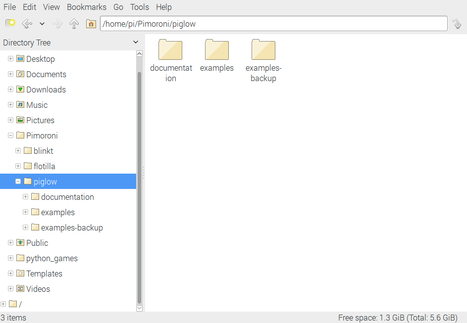

You can navigate through the directories on your computer using the terminal if you're happy with that or, if you're used to graphical methods, you can look in the file system for the Pimoroni folder, and inside it should be another labelled piglow. Inside there is an examples folder, in which you will find cycle.py.
Graphical screen grab
Terminal screen grab
Here are screen grabs of both methods. You only need to do it one way. In the terminal, when you're in the examples folder, you can type:
