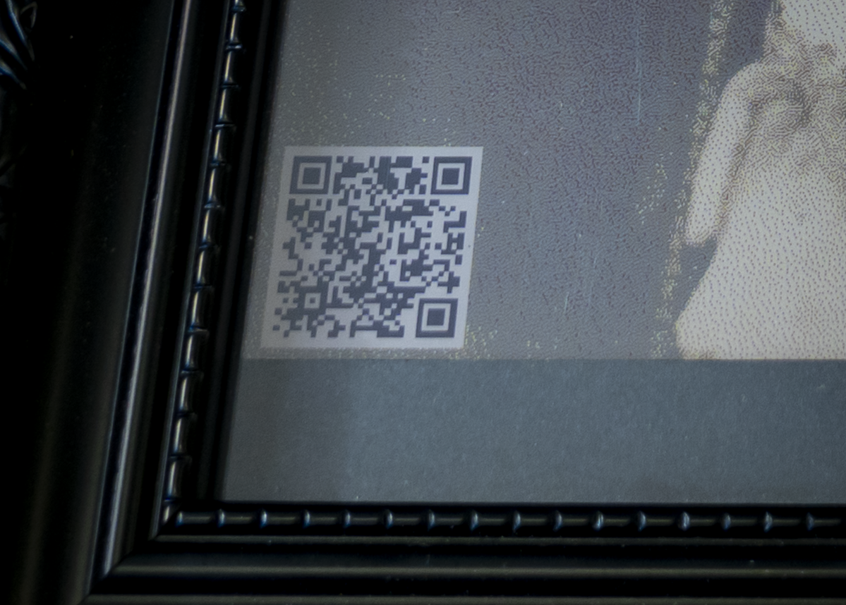

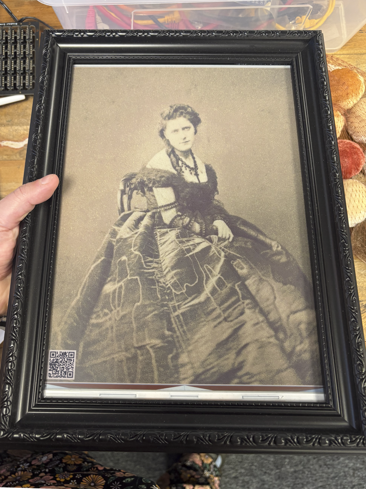

Adding a QR code
But who are these spooky faces in their incredible hats? If we add a scannable QR code in the corner linking to each portrait's page on the V&A Collections website, guests can discover who they are, when it was taken, what it's made from, and all the good stuff.

Set SHOW_QR_CODE = False if you want to turn off the QR codes and enjoy the portraits without such modern contrivances.
Close up of the Inky Impression showing the QR code

def add_qr_code(image, url, size=120):
    """Generate a QR code and overlay it in the bottom-right corner."""
    if not url:
        return image
    # Generate QR code
    qr = qrcode.QRCode(version=1, box_size=2, border=2)
    qr.add_data(url)
    qr.make(fit=True)
    qr_img = qr.make_image(fill_color="black", back_color="white")
    # Resize QR code to fit nicely on the image
    qr_img = qr_img.resize((size, size))
    # Paste in bottom-right corner
    x_offset = image.width - size - 30
    y_offset = image.height - size - 20
    image.paste(qr_img, (x_offset, y_offset))

# Add QR code linking to the V&A Collections page (after rotation)
if SHOW_QR_CODE:
    va_url = get_va_url(record)
    if va_url:
        image = add_qr_code(image, va_url)
        print(f"View more info: {va_url}")

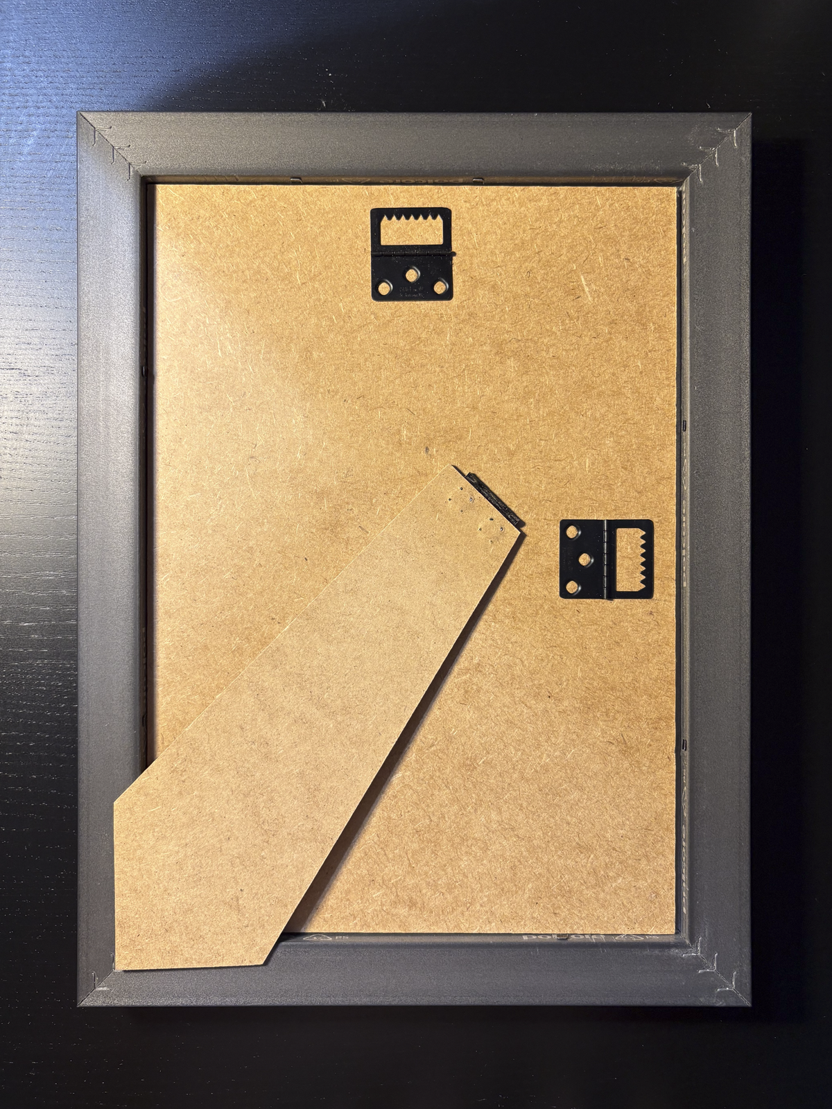

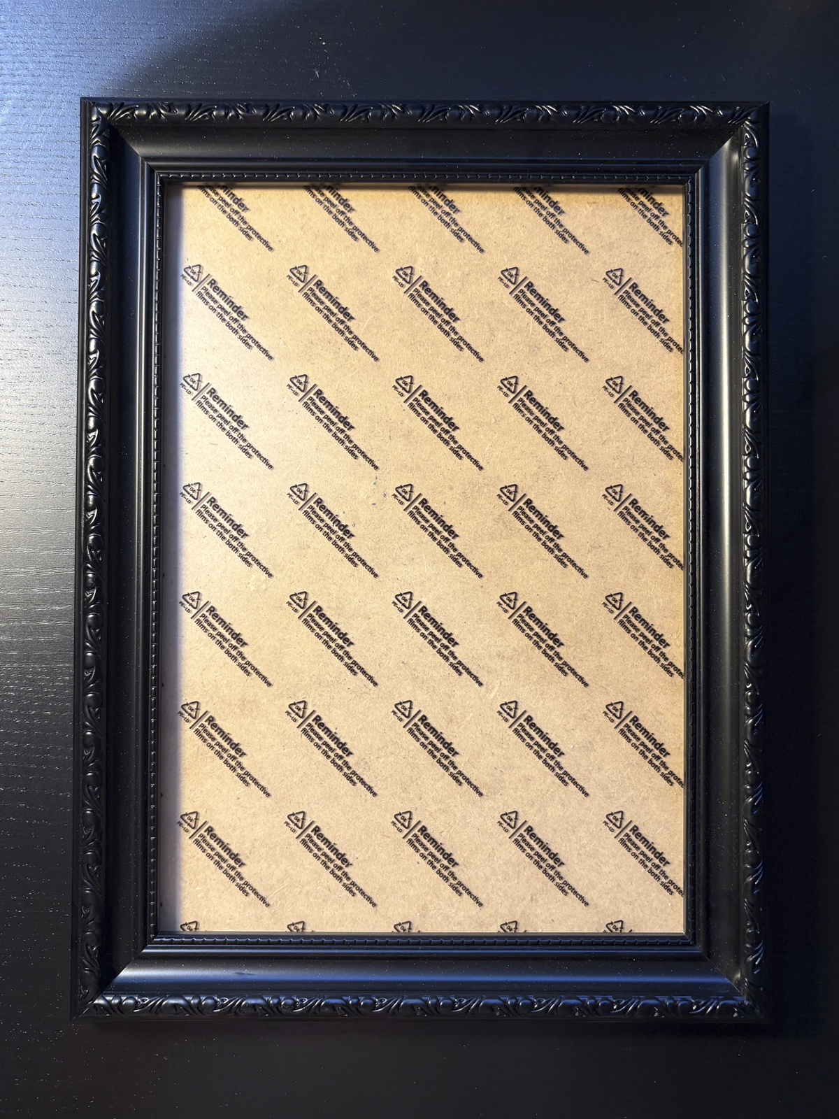

Now all that's left to do is to make it gallery ready! We used this A4 frame.
The photo frame front
It came with an acrylic front and a wooden back. We didn't end up using the back for this project.
The photo frame back
The Impression fit inside the frame nicely without us having to make any modifications.

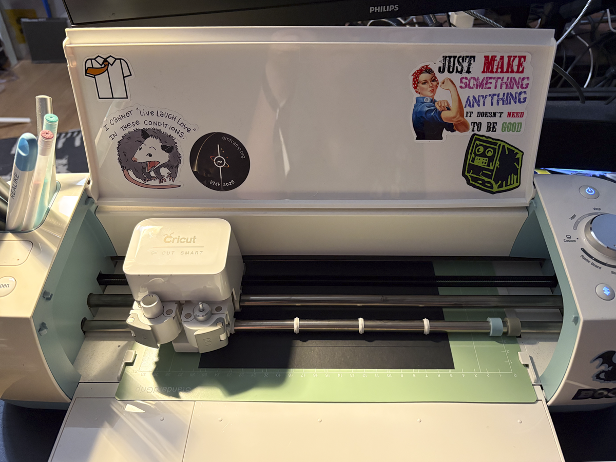

Cricut cutting machine cutting a bezel from black card

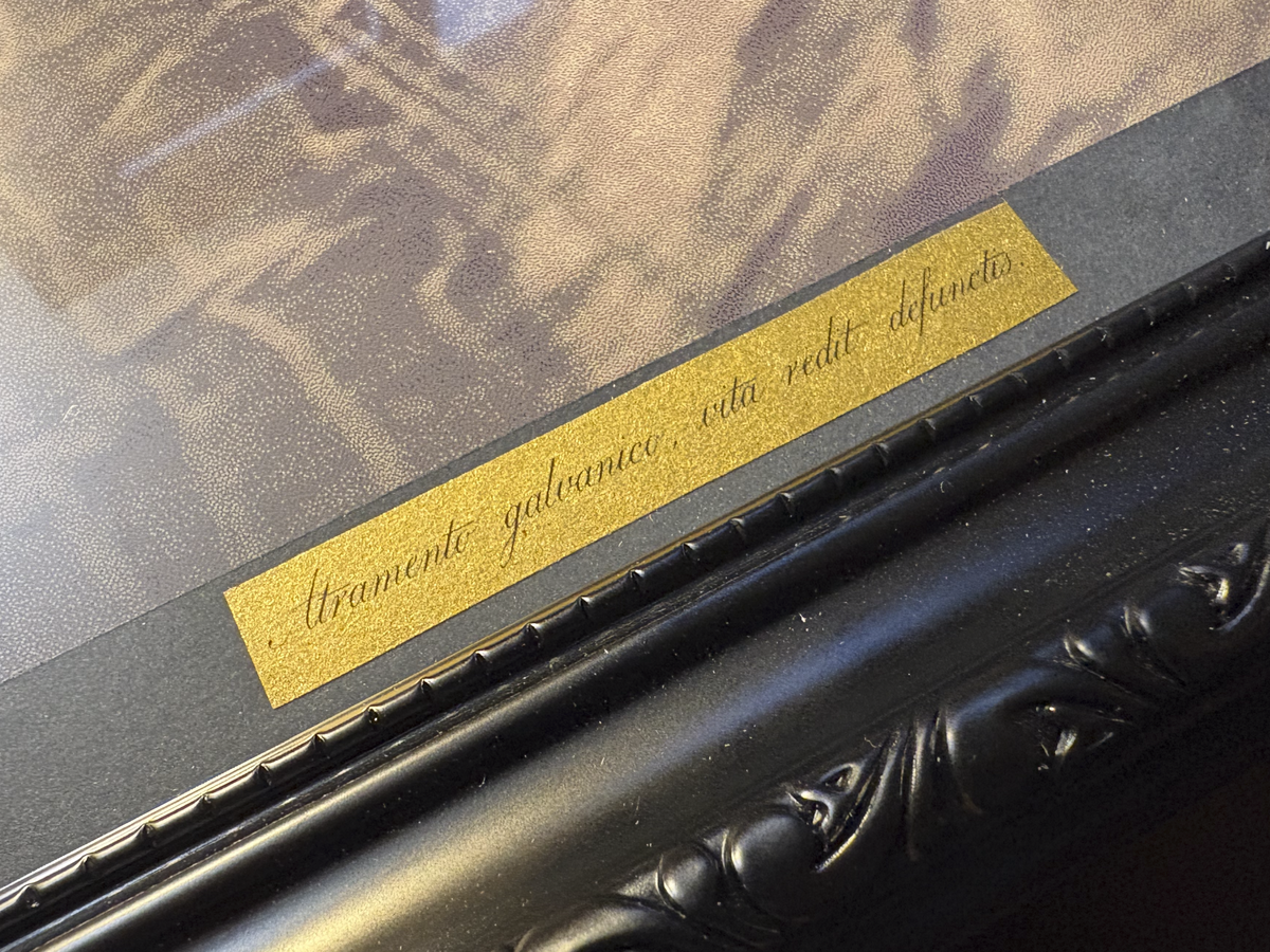

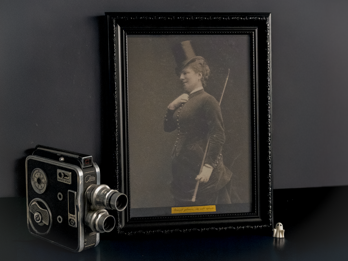

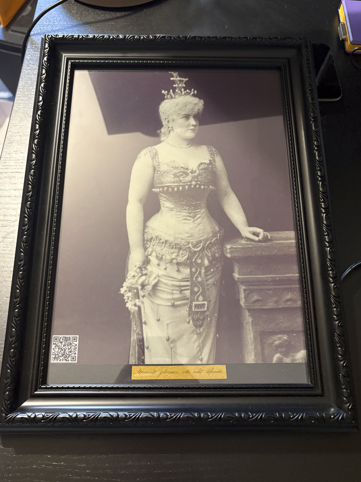

We also got a bit carried away and made a 'brass plaque' by laser printing on gold paper using a suitable font. The motto reads Atramento galvanico, vita redit defunctis - "by galvanic ink, life returns to the deceased".
'Brass plaque' showing the motto

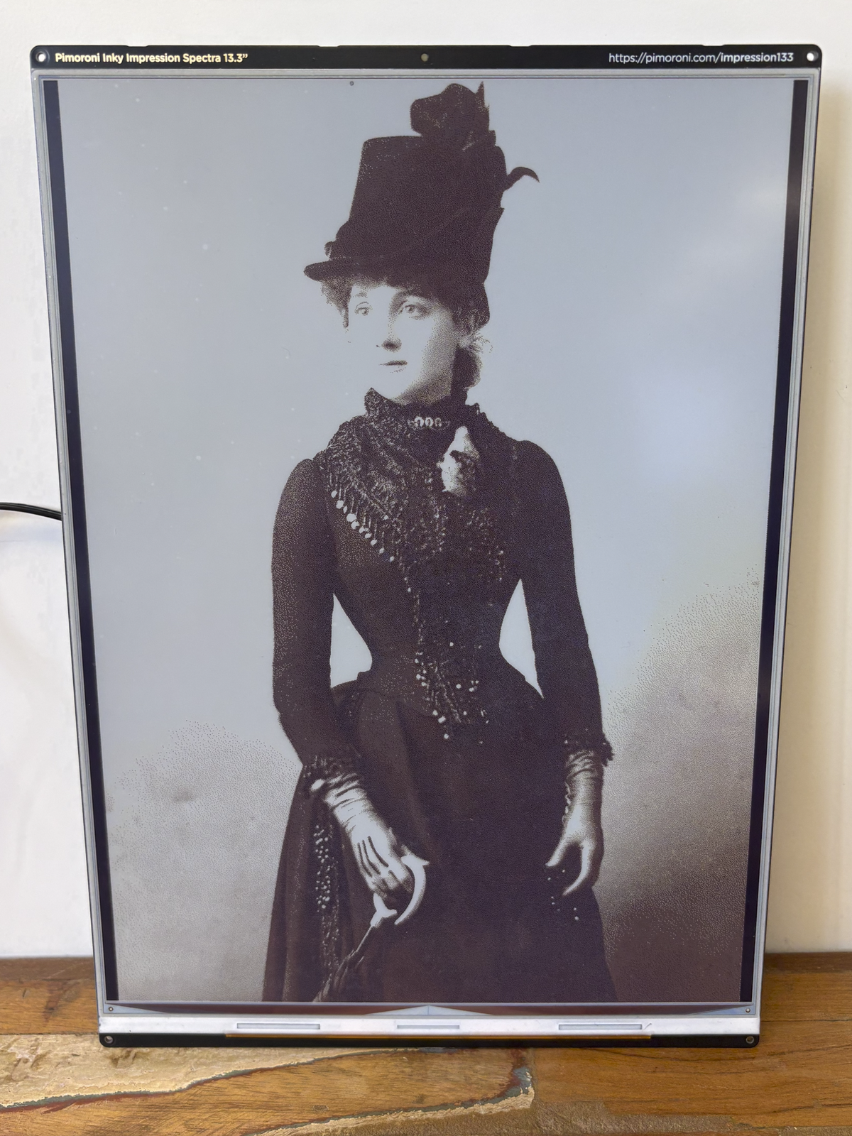

With the bezel in place, our frame is looking good!

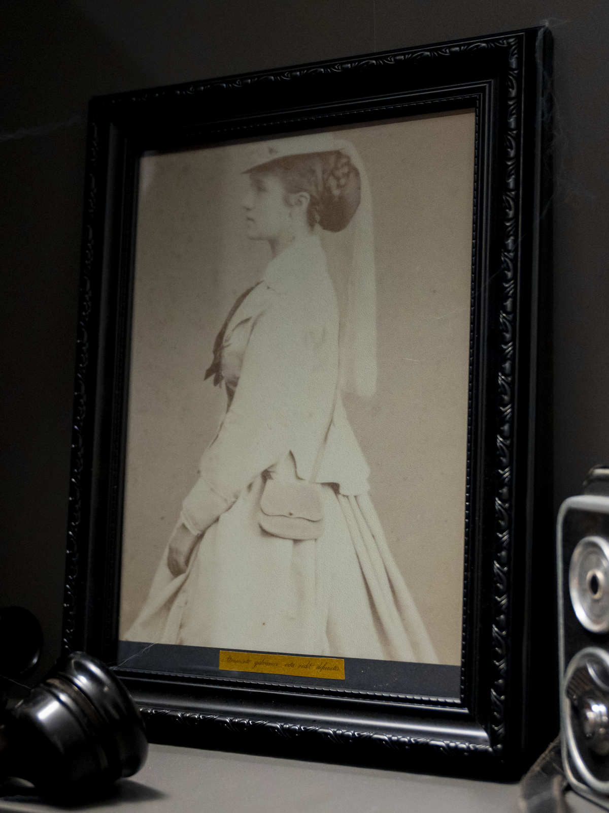

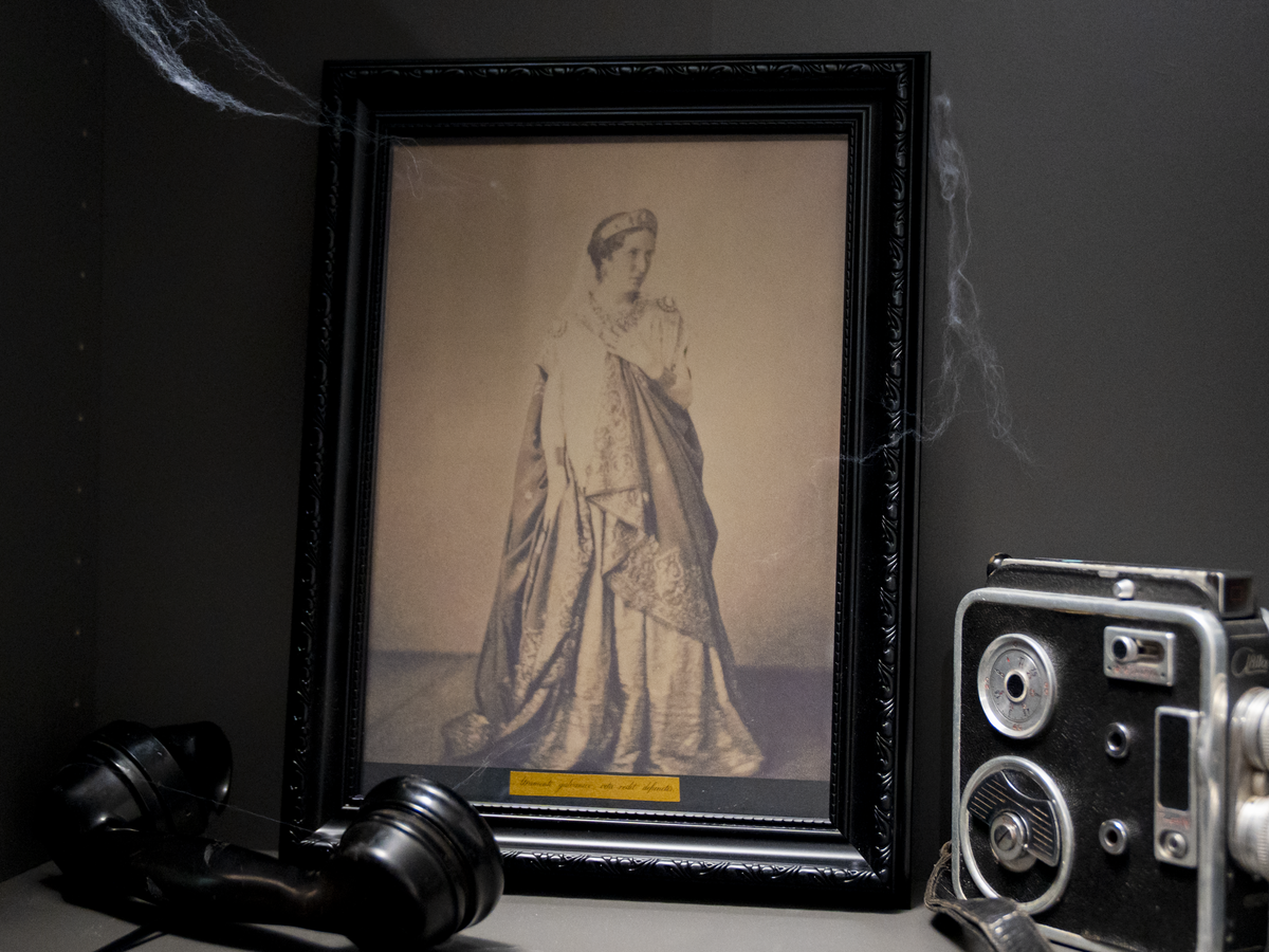

Victorian lady dressed like a cake, displayed on Inky Impression, in a frame

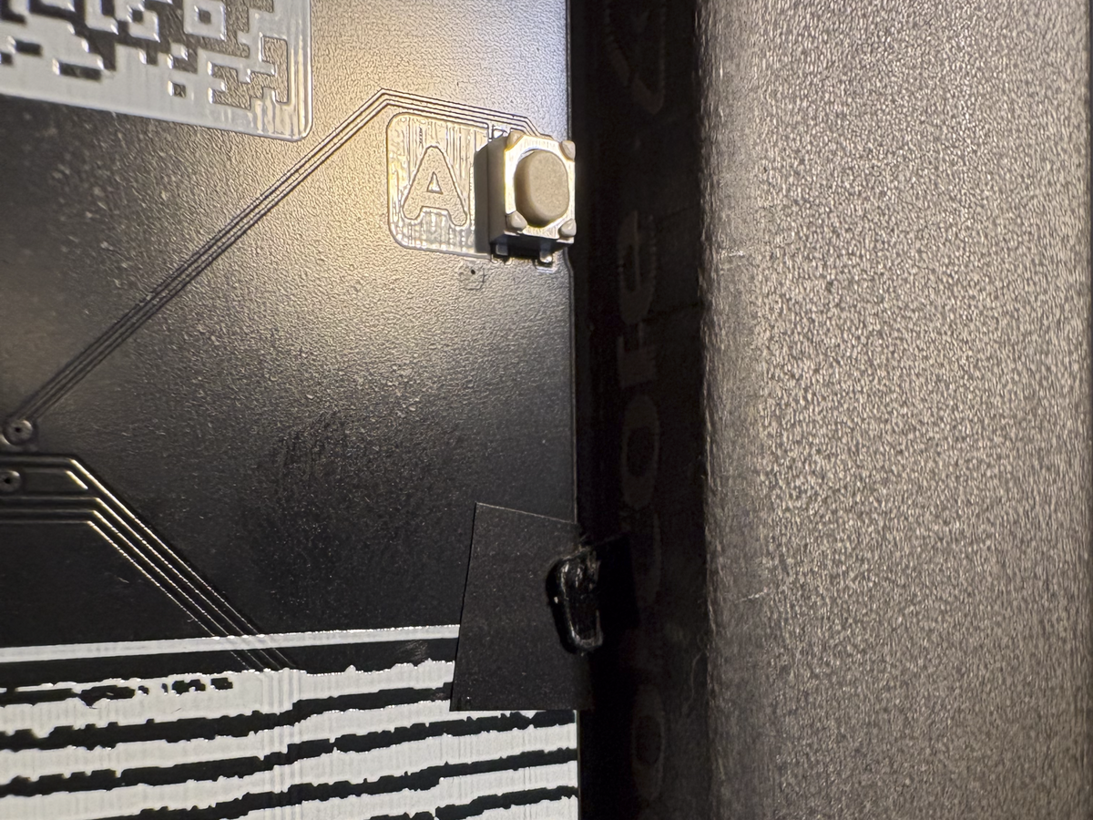

Next we need to find a way of making sure the Inky stays securely anchored into the frame. To do this, we just bent back the metal tabs on the frame intended to hold the back in place. To stop them from damaging the Inky PCB, we stuck little squares of electrical tape to the board under each tab.
Starting to bend back the tabs Electrical tape under the metal tabs
With the tabs folded back, everything is held in place nicely.
Stern Victorian lady with a fan displayed on Inky Impression, in a frame

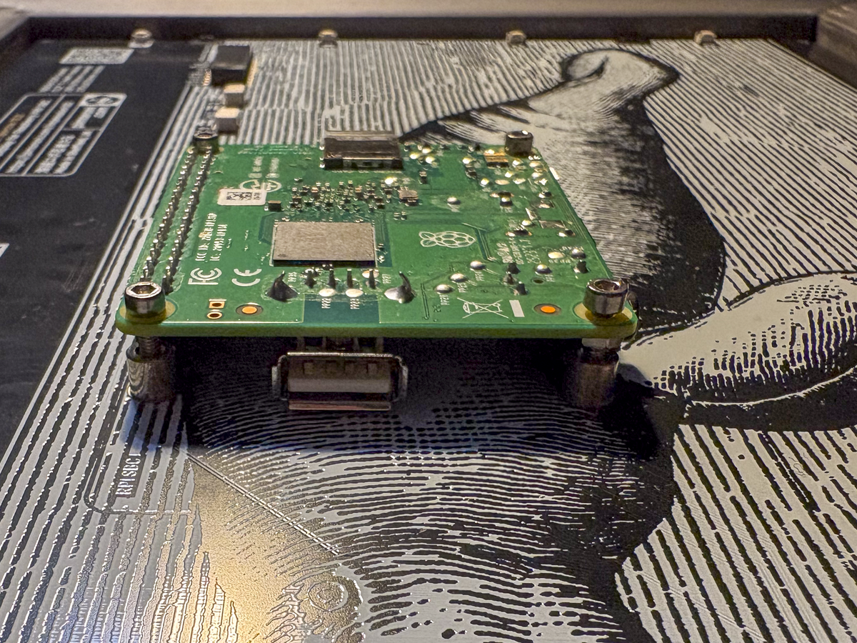

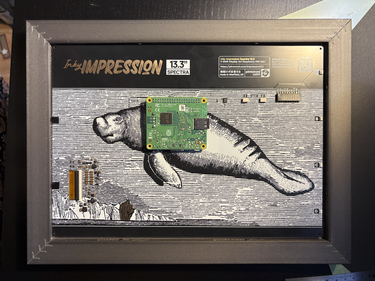

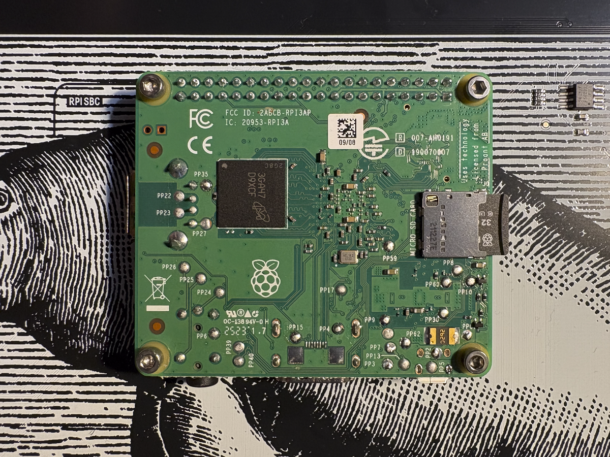

Plugging the Pi directly into the Inky display keeps things low profile, but that does mean that you can't use the standoffs, screws and booster header that come with the display. We instead used some M2.5 10mm hex screws to fix it in place, and some M2.5 nuts to work as spacers on the bottom edge.
Pi plugged into Inky Impression and secured with hex screws Pi plugged into Inky Impression and secured with hex screws, from the side

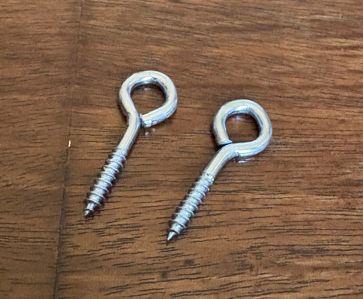

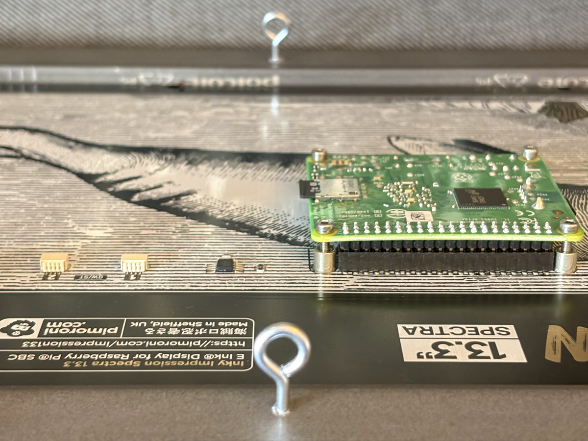

Not having a back on the frame means that the Pi is somewhat exposed, and we were concerned about the edge of the Pi (and the edge of the delicate SD card) being the part that comes into contact with the wall once it's hung up. To mitigate this we screwed 30mm ring hooks into the back of the frame - these should protrude far enough to be the point of contact against the wall, rather than the Pi or SD card.
30mm ring hooks Ring hooks screwed into the frame
If you wanted to give the back of the Pi some extra protection, you could tape a bit of cardboard or similar to it.

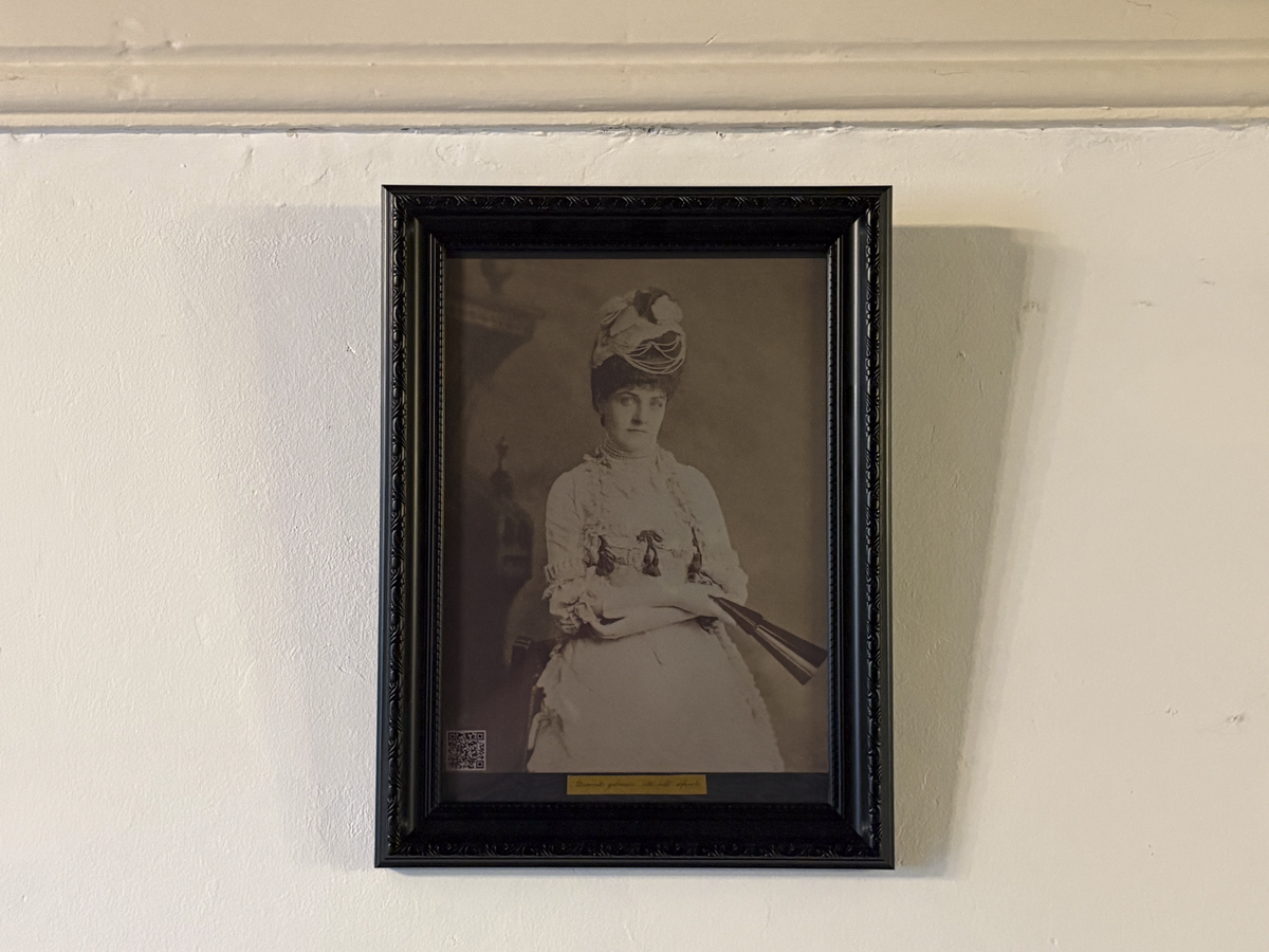

Finally we just need to attach a wire to the hooks, and we're ready to hang it up in our spooky house!
Spooky frame hung up in Hel's spooky house
