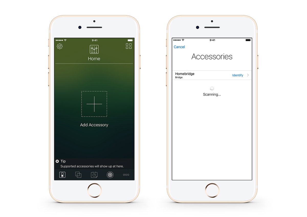

Setting up homebridge and homebridge-better-http-rgb
The next step is to set up homebridge and homebridge-better-http-rgb on our machine running the Mote API, to complete the circle. homebridge and the homebridge-better-http-rgb plugin provide the means to add Mote as a Homekit device that can be controlled through an app like Hesperus, and send commands to our API and hence to the Mote strips.
The following instructions assume that you're using a Raspberry Pi 3 running the latest version of Raspbian Jessie although, with some modifications, you should be able to run everything on a Mac, a Windows PC, or another Linux machine.
The version of Node.js bundled with Raspbian is a little out of date, so we'll install the latest version before we start to install homebridge, etc.
Open a terminal, and type the following to upgrade to the latest and greatest version of Node.js:
sudo apt-get update
sudo apt-get upgrade
curl -sL https://deb.nodesource.com/setup_6.x | sudo -E bash -
sudo apt-get install -y nodejs npm
Before we install homebridge, we'll also need to install a couple of dependencies. Type the following to install them:
sudo apt-get install libavahi-compat-libdnssd-dev
Now, we can install homebridge itself, as well as the homebridge-better-http-rgb plugin:
sudo npm install -g --unsafe-perm homebridge
sudo npm install -g --unsafe-perm homebridge-better-http-rgb
Now that everything is installed, we have to do a couple more things to configure homebridge correctly. homebridge is configured through a .json file that must be put into the /home/pi/.homebridge/ directory. We'll create that directory now:
mkdir /home/pi/.homebridge
Here's what our config file looks like:
    "bridge": {
        "name": "Homebridge",
        "username": "CC:22:3D:E3:CE:32",
        "port": 51826,
        "pin": "031-45-155"
    "description": "Homebridge",
    "accessories": [
            "accessory": "HTTP-RGB",
            "name": "Mote",
            "service": "Light",
            "switch": {
                "status": "http://127.0.0.1:5000/mote/api/v1.0/status",
                "powerOn": "http://127.0.0.1:5000/mote/api/v1.0/on",
                "powerOff": "http://127.0.0.1:5000/mote/api/v1.0/off"
            "brightness": {
                "status": "http://127.0.0.1:5000/mote/api/v1.0/brightness",
                "url": "http://127.0.0.1:5000/mote/api/v1.0/brightness/%s"
            "color": {
                "status": "http://127.0.0.1:5000/mote/api/v1.0/set",
                "url": "http://127.0.0.1:5000/mote/api/v1.0/set/%s",
                "brightness": true
    "platforms": []
Copy and paste that, and save it as config.json in the /home/pi/.homebridge/ directory that we just created.
You can change the bridge name and description to whatever you'd like, as well as the accessory name that we've called "Mote". The username, port and pin are all boilerplate values and can be left as they are.
If, at a later date, you wanted to add other accessories using other homebridge plugins, then you'd add them as new accessories in the accessories list.
Now that everything's set up, we'll start the Mote API first and then homebridge.
Assuming your Mote API is called mote_api.py and is in /home/pi/, type the following to start it:
python /home/pi/mote_api.py
You'll see a few lines telling you the status of the Flask app, including the IP address and port on which it is running.
Now, open another terminal tab or window (leaving the Mote API one open), and type homebridge to start homebridge.
You'll see a few lines confirming that the Mote accessory has been loaded successfully and a code that you can enter when configuring your Homekit app on your iPhone. There's no need to write this code down, as it's the same as the one that we configured ourselves in our config file earlier.
Now that the Mote API and homebridge are running, we'll install and configure the Hesperus app on our iPhone and link it up to our Mote accessory.

Once you've done that, you'll be taken to the home page for your Home space. This is where all of the accessories that you add to that space will appear. If you decided that you wanted to get more specific, you could have separate spaces for different rooms in your house like "Living room", "Bedroom", etc. Spaces are accessed by tapping on the icon with four small squares, just below the battery status icon.
Tap the large "+" in the centre to add a new accessory. It'll scan to look for connected accessories and, assuming that the Mote API and homebridge are running, it should find the "Homebridge" bridge. Click on "Identify" to complete the setup of the Mote accessory.
Adding an accessory
It'll display a warning telling you that "This accessory is not certified and may not work reliably with Homekit". Just tap "Add Anyway".
You'll then see a screen that will allow you to use the camera to scan the PIN code displayed in the terminal window running homebridge (you may need to grant the app access to use your camera). In our experience, the camera detection of this code was a bit iffy, so you may need to click "Enter code manually" and then key in the PIN code.

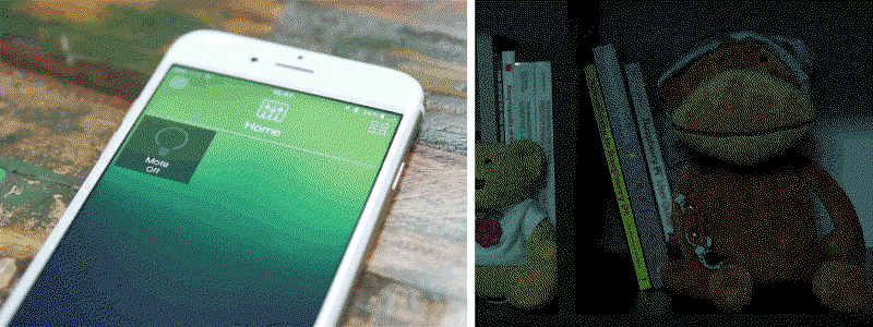

Try clicking on it. The Mote strips should come on!
If you're using an iPhone 6 or later, you can force tap on the Mote icon to pop open a more detailed set of controls to let you change the colour and brightness of Mote.

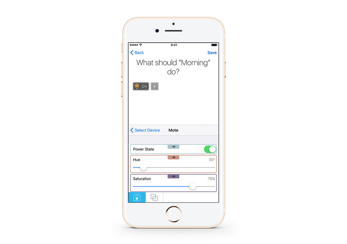

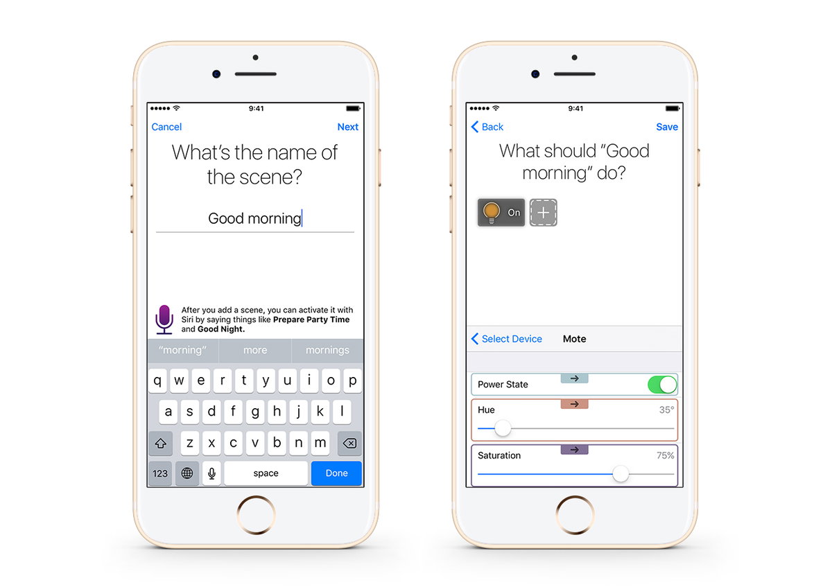

Tap on the second from left icon on the bottom bar of Hesperus (the two overlapping squares) to access the "Scenes" page. Then tap on the "+" in the top right hand corner to add a new scene.
Call it "Good morning", and tap on the "+" to add the Mote device. Make sure to toggle the power on and select the hue, saturation and brightness that you want, then tap "Save" to save your scene.
Creating a scene

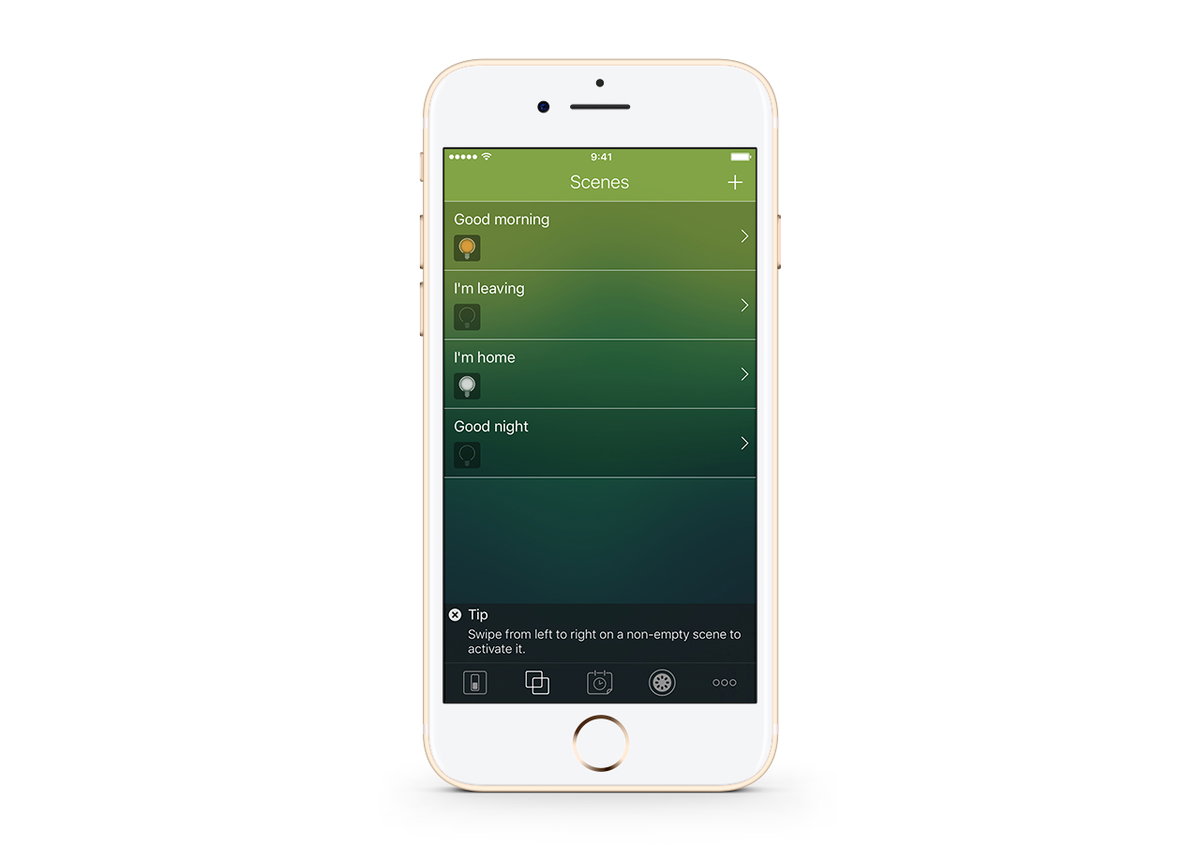

Now that you've added your scene, you can even trigger it through Siri by using its name: "Hey, Siri. Good morning."
I've added several more scenes called "I'm leaving", "I'm home", and "Good night", that all can trigger actions direct from Siri.
Scenes

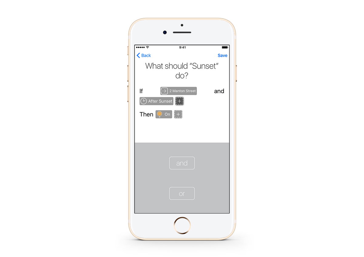

Finally, we can create actions that trigger automatically given certain conditions. For instance, we can create a "Lights On" action that will trigger if we're at home and it's after sunset.
The "Actions" page is the second icon from the right on the bottom bar (the one that looks a bit like an orange sliced through the middle). If you grant access to location data in Settings > Privacy > Location Services > Hesperus, then you can trigger actions when you are within or outside a location.
Then add a resulting action.
Triggered actions
You can also add additional conditions with and or or Booleans, such as before or after a given time, or before or after sunrise or sunset.
Conditions for triggered actions
