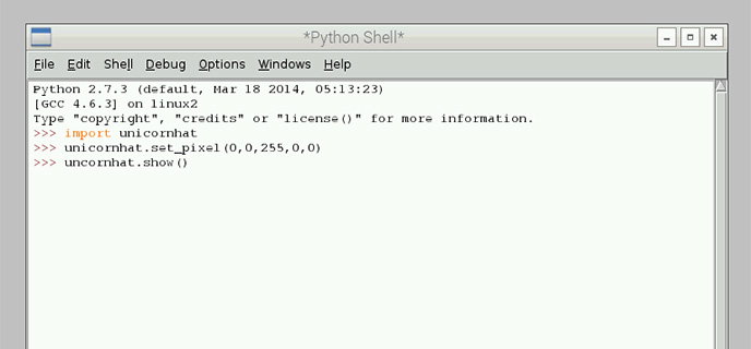

Lighting some Pixels
First you need to import the Unicorn HAT library, do this by adding the line:
import unicornhat
Then you can set one or more pixels to colours of your choice:
unicornhat.set_pixel(0,0,255,0,0)
The parameters in set_pixel are X position, Y position, Red Amount, Blue Amount and Green Amount. The X and Y positions are numbers between 0 and 7 which indicate one of the 8 rows/columns of Unicorn HAT.
The colour amounts are values between 0 and 255 which indicate how much of that colour should be displayed on that pixel. You can mix colours, for example 255 red and 255 blue = purple.
This should set the top left pixel to Red, but it won't show up yet. To make Unicorn HAT display your changes, you must always call:
unicornhat.show()
