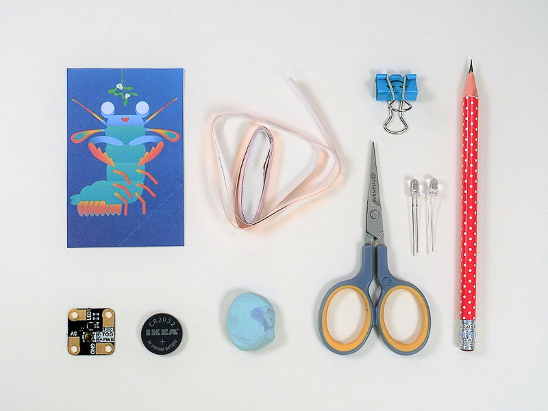

First, check that you have all of the parts you need.

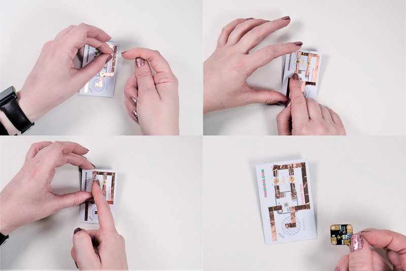

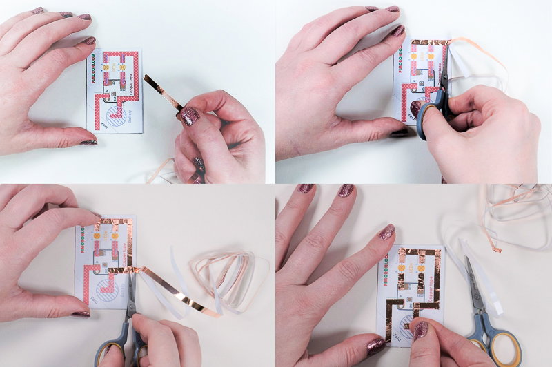

We'll start with the copper tape and the card base. Peel off a little bit of the backing on the tape, and press the end down on one of the red lines. As you press it down along the lines, peel back more of the backing as you go. This makes sure that the tape doesn't curl up and stick to itself!
Start taping
start taping
At each corner, you can bend the tape (messy) or you can tear it off and start a new piece. If you tear it, make sure that you overlap the tape so that the electricity can flow through it smoothly.

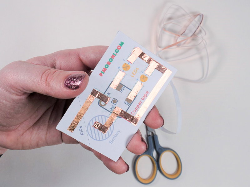

Once you have taped all of the red parts, check it against the photo below to make sure you've covered all the parts you need to. If you can still see any red markings, add more copper tape, because we're going to need all the ends to make contact with the other parts of the circuit. It's a good idea to rub down any joins with the back of your nail, or something flat if you don't want to use your nails!
check the first stage and rub down corners

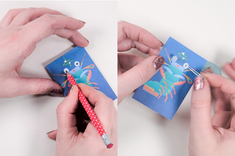

Turn the card over and look for the eyes - this is where we're going to put the lights. You need a pencil and some Blu Tack. Put the Blu Tack behind the critter's eyes, and use the pencil to poke a little hole in the middle of each eye. The wires on the LED are going to go through these holes, so it doesn't need to be too big.
hole poking extravaganza

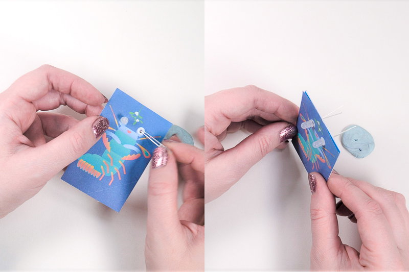

Now, poke the legs of the LED through from the critter side and turn the card back over.
thread the LED through

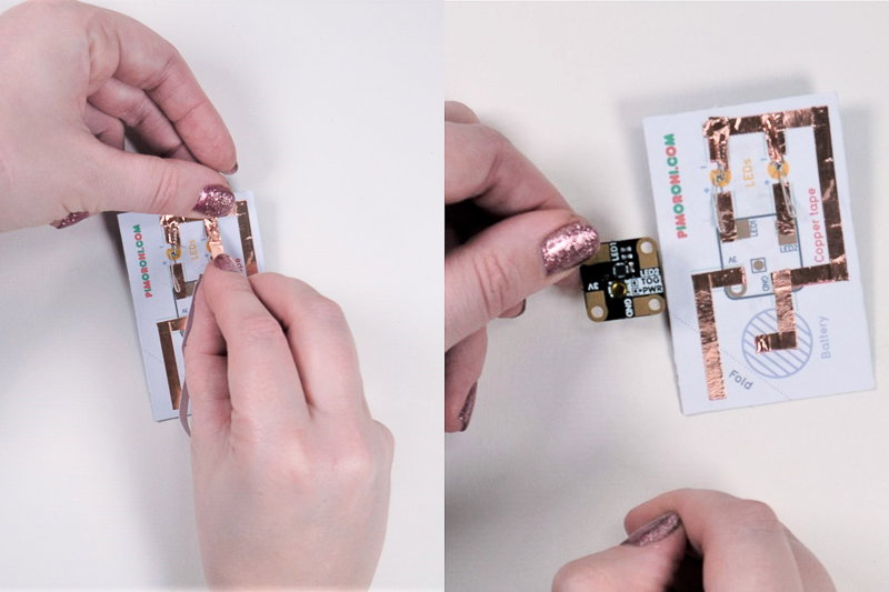

The blinky board

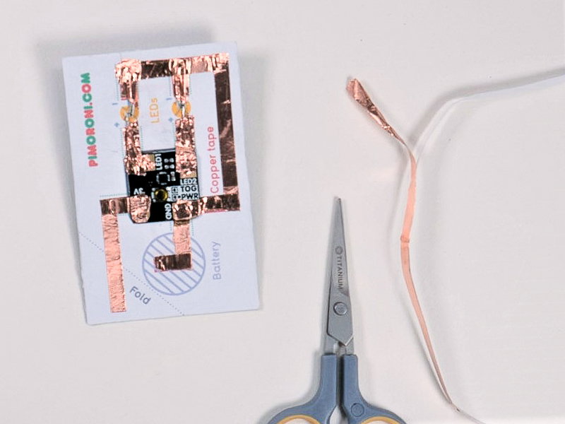

Place the blinky board down on the marking for it, making sure that the labels match. LED1 and LED2 should be at the top, with 3V and GND at the bottom. Use more copper tape over each gold contact pad on the board, making sure it joins up to the lines you made earlier. The joins from the pads labelled with LED should hold down the bottom LED legs too.
finished board and LED tape

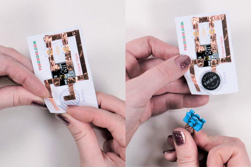

Adding the battery
Now look for the fold lines on the bottom corner. You need to fold the corner towards you. This will be the switch for the battery. Unfold it again and put the battery with the dimpled side down, and the smooth side with the + marking on the top. Fold the corner back over it, and hold it shut with the clip.
adding the battery
Pressing the little gold button in the middle of the circuit board cycles through the eight different light patterns. Each time you press it, it will change the pattern, until you get back to the start. If you press and hold the gold button, it'll put the board and LEDs to sleep. A short press will wake it back up.

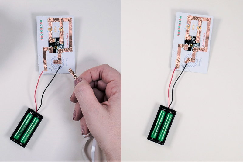

If you don't want to use a coin cell battery, you can power these with a 3V battery pack. They have two wires usually, a red (positive) and a black (negative/ground) one.
battery pack
If you tape the black wire to the strip that leads to the GND (ground) pad, and the red wire to the strip that leads to the 3V pad, you should be able to power the critter just like you can with the coin cell battery.
Make sure that you use 2x AA batteries, or 2x AAA batteries, and no more than that, or you may damage the circuit board.
