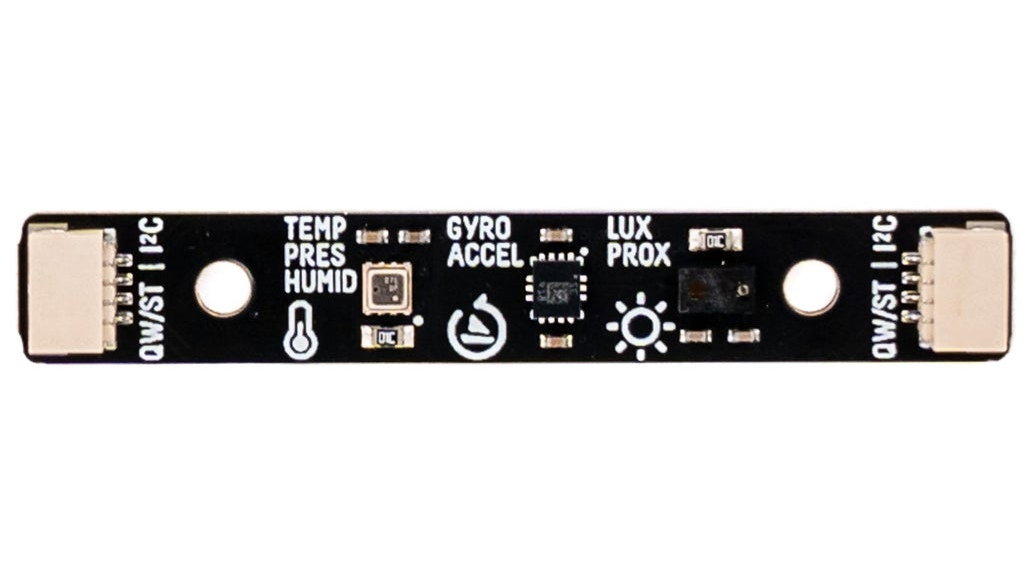

We'll be using the Multi-Sensor Stick as our sensor platform. This stick has three sensors built-in and it and uses our Qw/ST connector for solderless connectivity.
- Bosch BME280 temperature, pressure, humidity sensor.
- Lite-On LTR-559ALS-01 light and proximity sensor.
- STMicroelectronics LSM6DS3TR-C accelerometer and gyroscope.
In this guide, we will use two of the sensors, the LTR-559ALS-01 light and proximity sensor (LTR559 for short) and the LSM6DS3TR-C accelerometer and gyroscope sensor (LSM6DS3) to trigger actions.

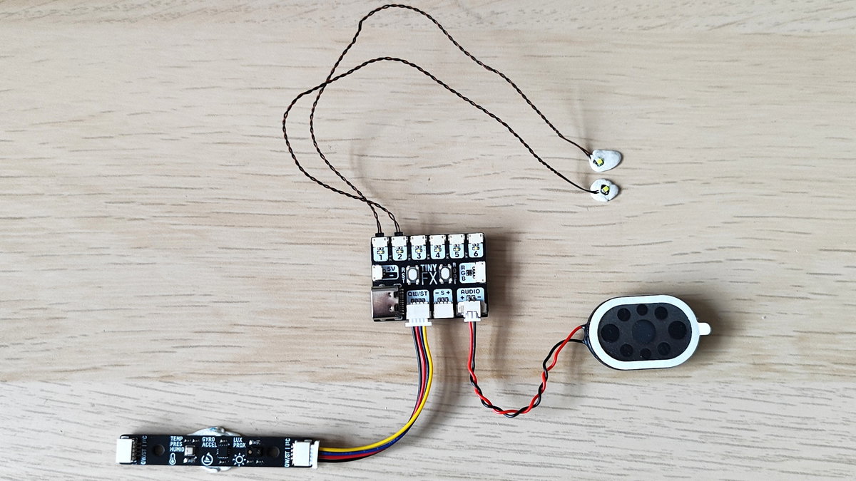

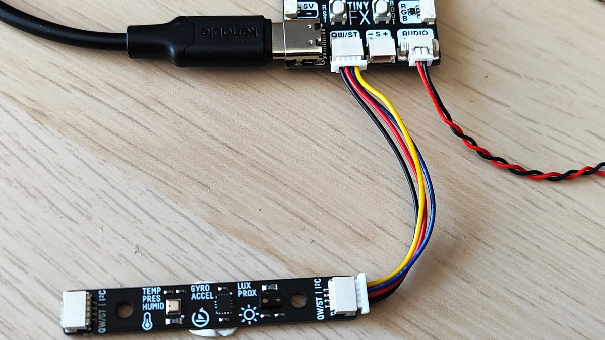

- Connect Multi-Sensor Stick to Tiny FX using the Qw/ST connector. Qw/ST connectors are designed to only go in one way.
- Connect the LED dots and speaker to the correct ports.

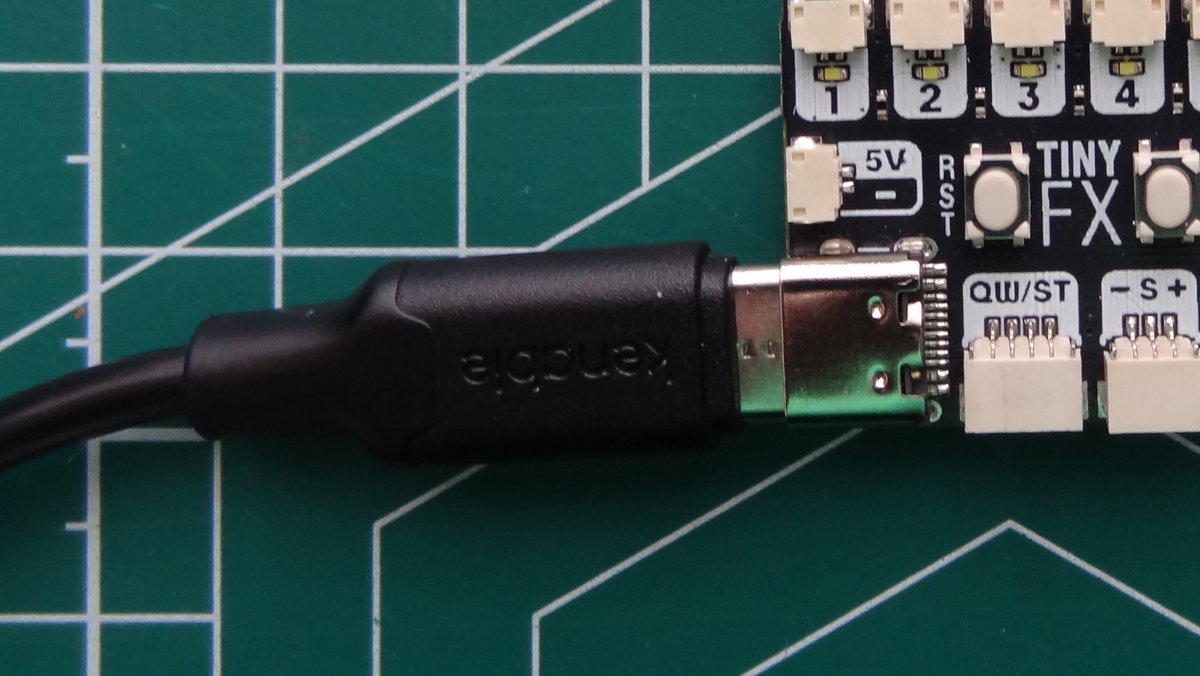

- Connect Tiny FX to your computer using a good quality USB Type C cable and open Thonny.

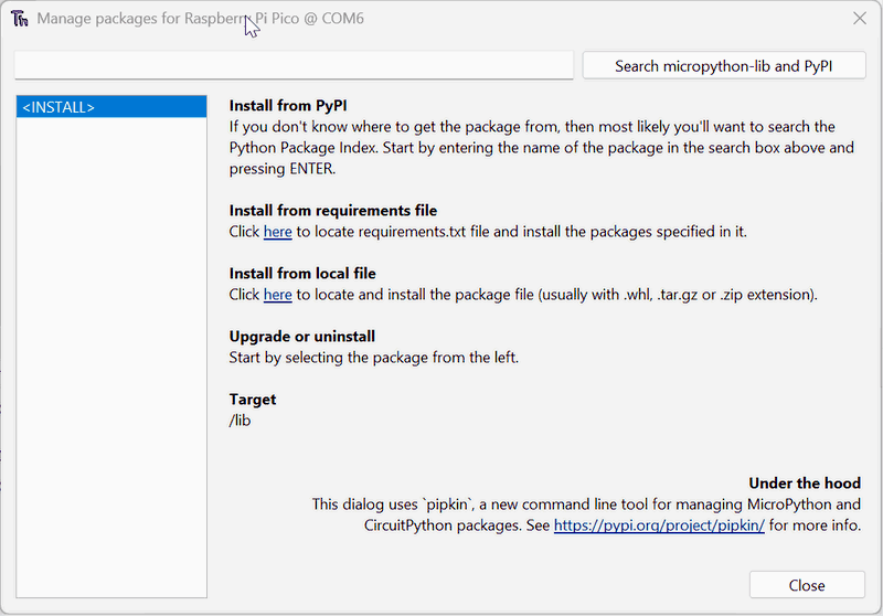

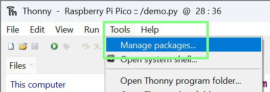

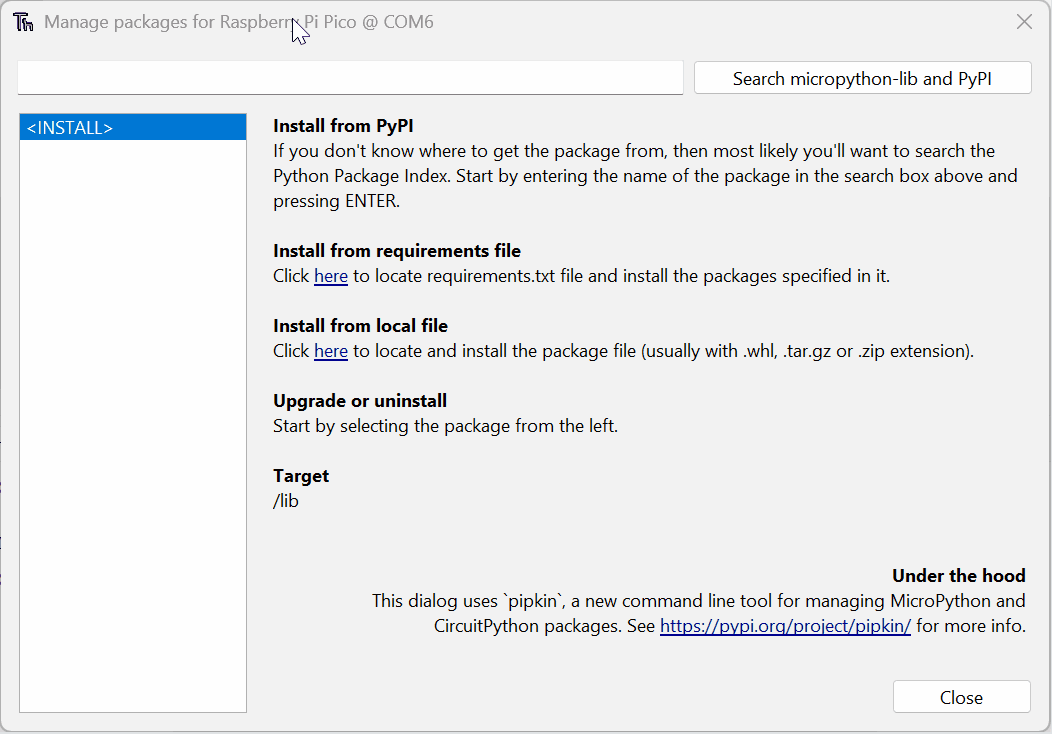

- Click on
Tools >> Manage Packages.
- Search for
lsm6ds3-micropythonand install the module. Click Close when complete. The LTR-559 driver is part of our MicroPython build, but you will need to install the LSM6DS driver yourself.

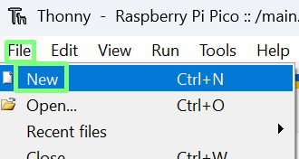

- In Thonny, click on
File >> Newto create a new blank file.

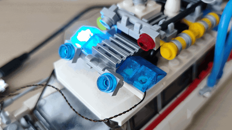

dutyto control how long the flash is on for.player.effects = [ FlashFX(speed=1.0, # Flashing "blue" light 1 flashes=1, window=0.2, phase=0.0, duty=0.5), FlashFX(speed=1.0, # Flashing "blue" light 2 flashes=1, window=0.2, phase=0.5, duty=0.5), None, None, None, None ]

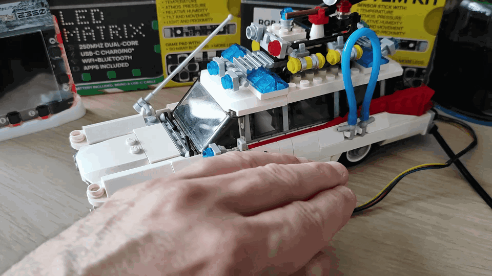

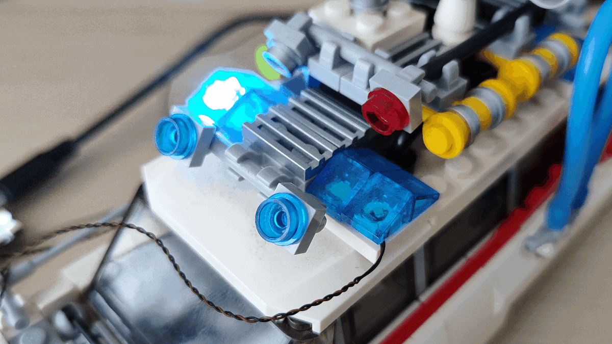

RUNto start the code. Put your hand over the LTR599 light sensor to trigger the LEDs to flash. Then, double tap the LSM6DS3 sensor to trigger the full demo. Double tapping may take a few attempts to get right. Its more. Tap. Tap. Than double clicking a mouse button.

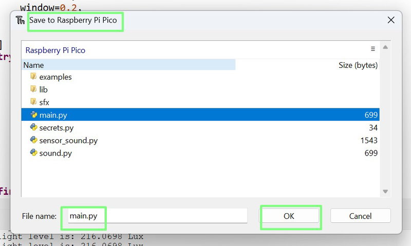

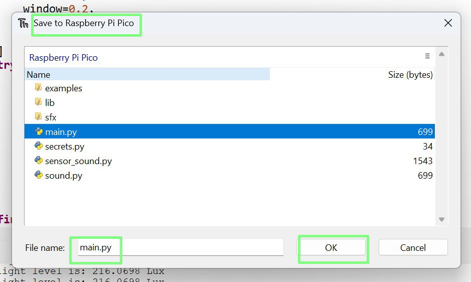

- Save the code as
main.pyto the root of Tiny FX. This will autorun the code when Tiny FX is turned on.
