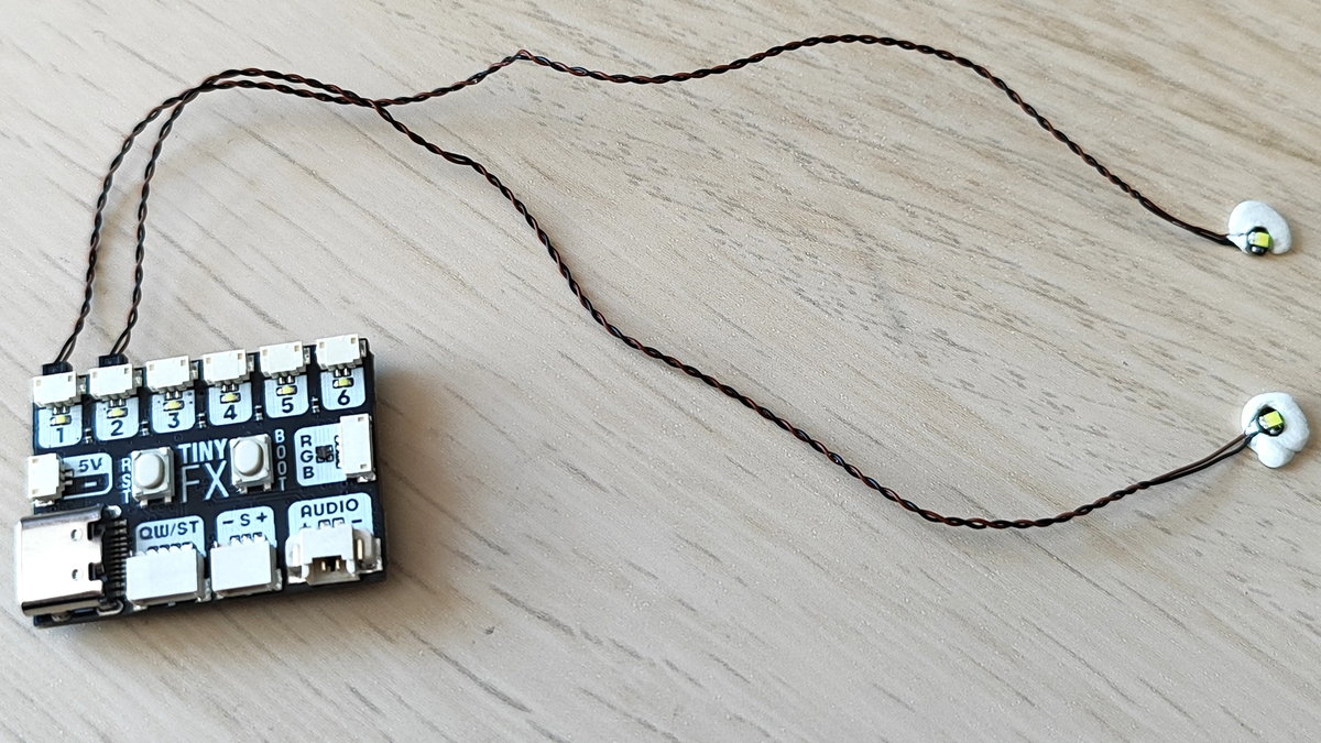

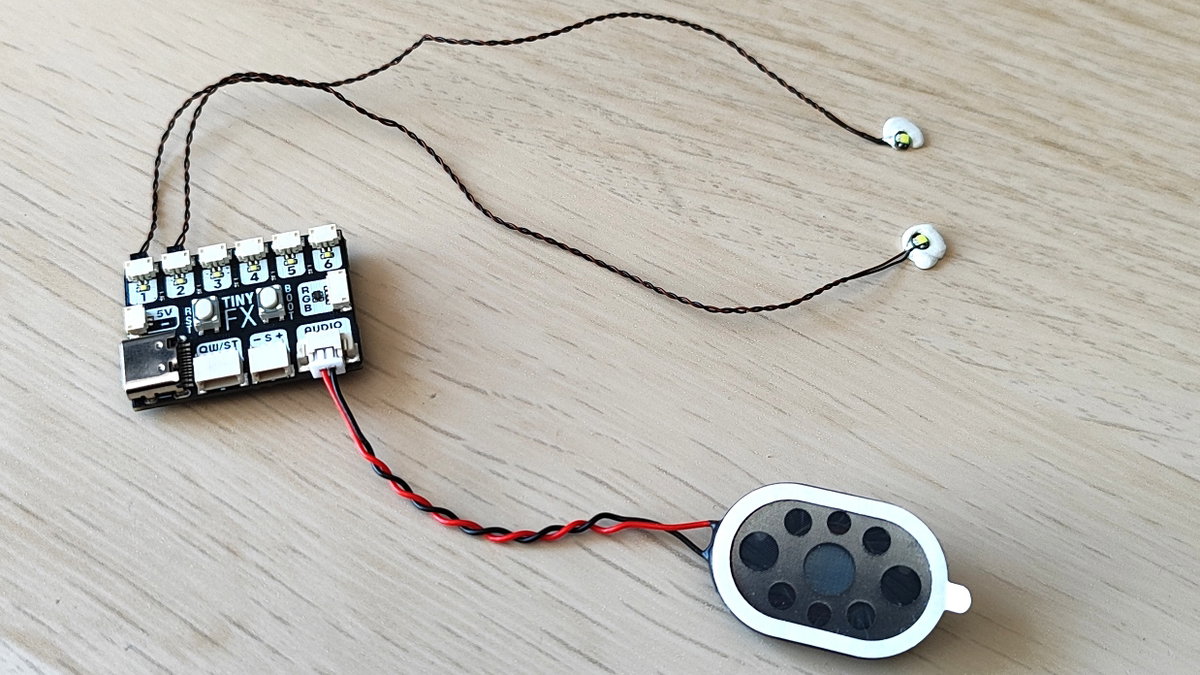

So, let's get started with the project. First, we connect the LEDs and speaker to Tiny FX.
  1. Connect the LED Dots / Strips to ports one and two of Tiny FX. LED Dots connected to Tiny FX output ports one and two
  2. Connect the speaker to the Audio port. The speaker connection will only go in one way. Typically the red wire is positive, and the black wire is negative. Speaker connected to the Audio port on Tiny FX

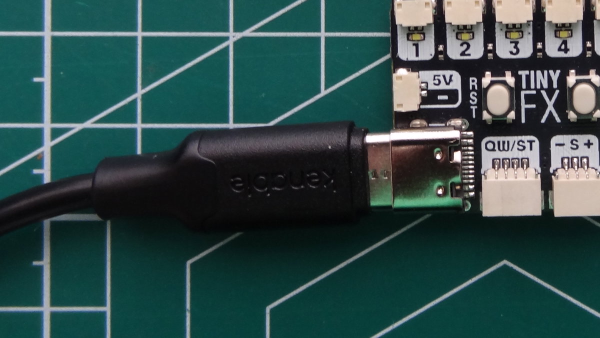

  3. Using a good quality USB Type C cable, connect Tiny FX to your computer and open Thonny. We assume that you have already gone through the steps in part one to set up Thonny. Tiny FX connected to a computer with a USB Type-C cable

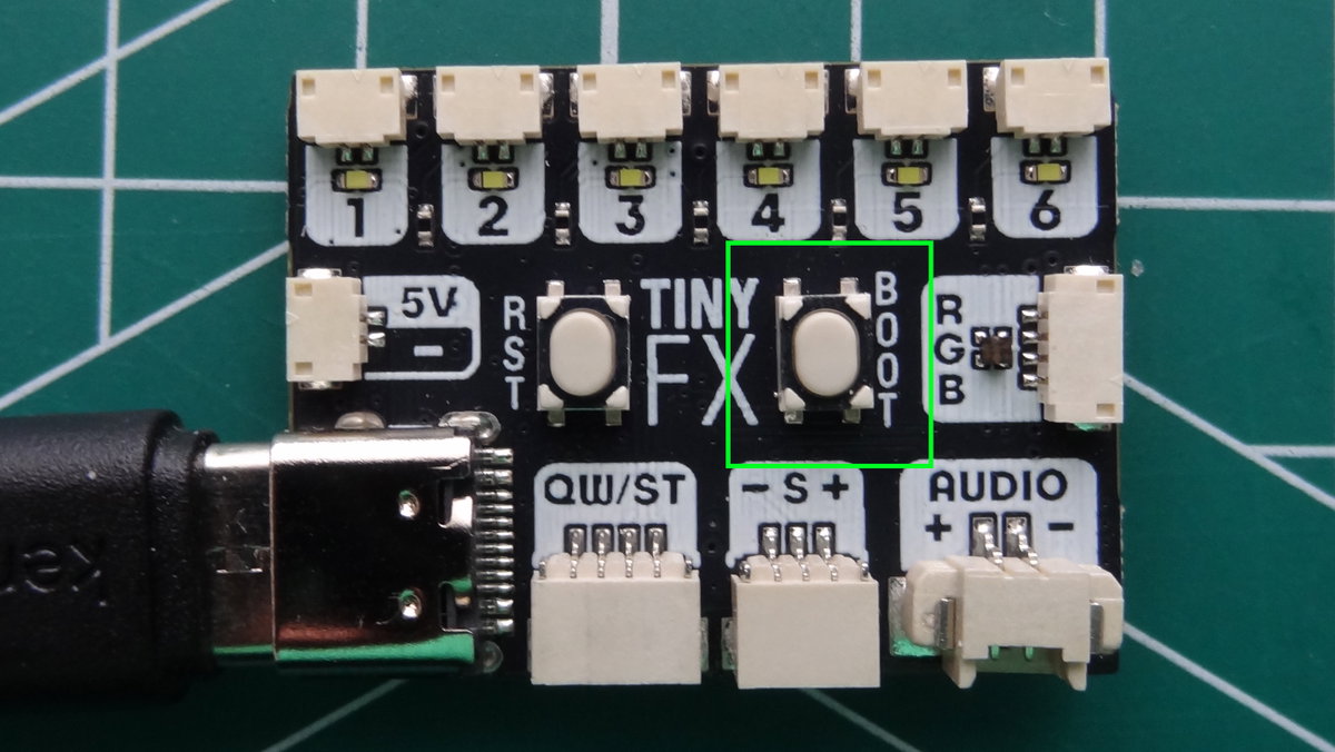

  7. Using a while not loop, check that the BOOT button has not been pressed. This will run pass which keeps Tiny FX waiting for the BOOT button to be pressed.
             while not tiny.boot_pressed():
                 pass

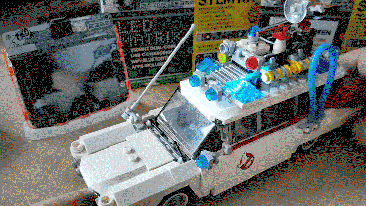

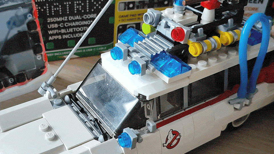

In part two we created lighting effects for two models. A Ghostbusters ECTO 1 and a Star Wars Imperial Tie Fighter. Now we will add an authentic siren for ECTO 1 using a Wave (WAV) audio file.
Tiny FX LEDs flashing in an alternating siren pattern
We'll be using LED dots for our lighting effect. The LED Dots do a great job for pin focused sections of light, but if we need a wide splash of light, then we could swap the dots for strips that will throw light around your builds as they have two LEDs per strip. We'll leave the decision up to you.
For sound, we will attach a speaker to Tiny FX and then use a MicroPython module (library of pre-written code) to play WAV files (Wave audio files, common to many operating systems.) in sync with the light effects.

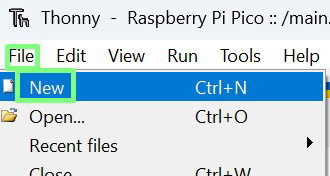

  1. In Thonny, click on File >> New to create a new blank file. Thonny's File menu with New selected

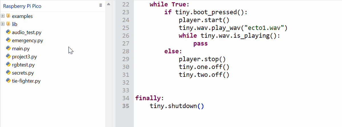

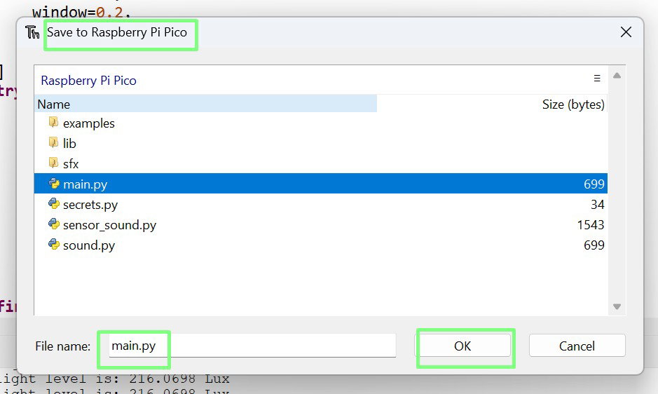

  13. Save the code to Tiny FX as main.py This will auto-start the code when Tiny FX is powered up, but remember that it will overwrite the current main.py file so backup the code if you haven't already done so. Thonny saving the Tiny FX program as main.py

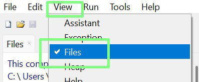

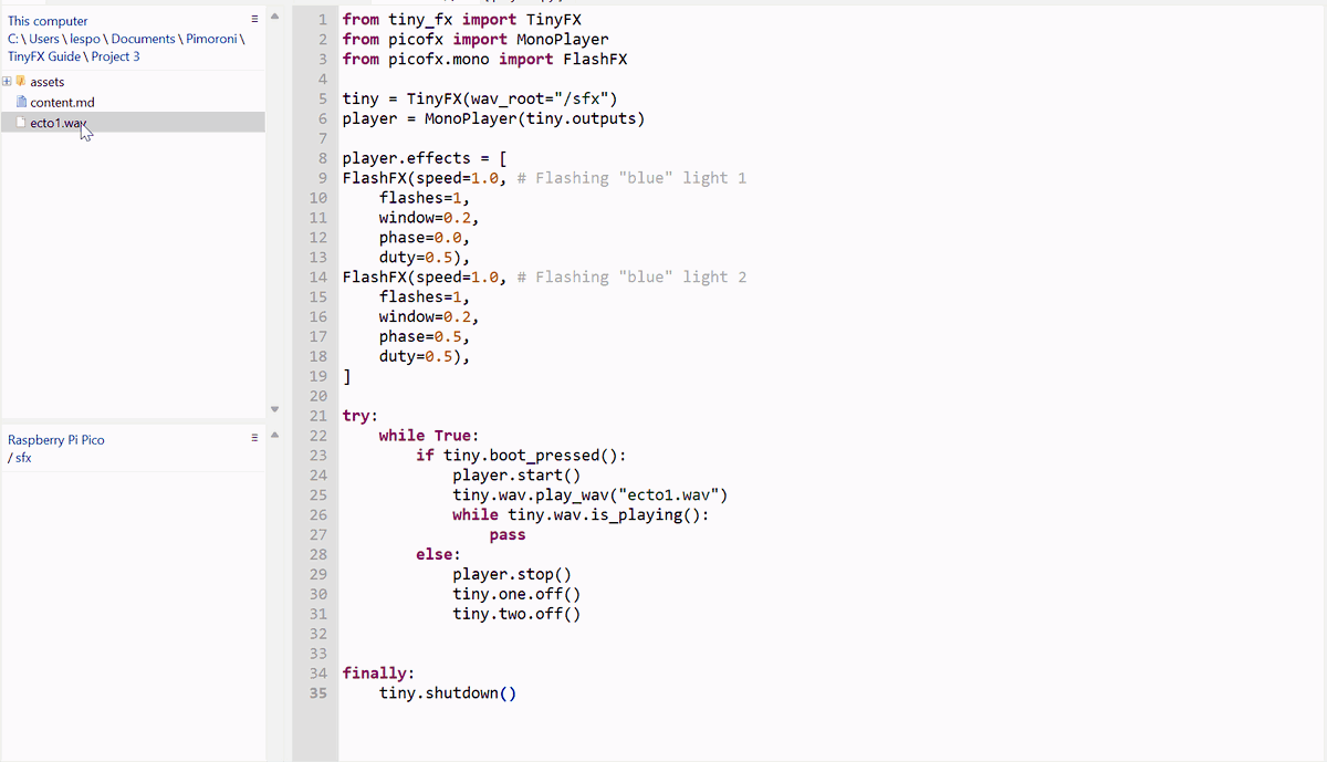

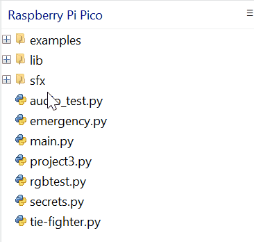

  1. In Thonny click on View >> Files and check that Files has been selected. This will open the Files pane on the left of the screen. Thonny's View menu with Files selected
  2. Under Files and in the Raspberry Pi Pico pane, right click on a blank area and select 'New Directory', then call the directory sfx. Thonny creating an sfx directory on the Tiny FX filesystem
  3. Double left click on sfx to open that directory. This will enable us to upload an audio file directly to this directory. Thonny opening the sfx directory on Tiny FX

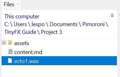

  4. Under Files and in the This computer pane, navigate to the audio file that you wish to upload to Tiny FX. Thonny's file manager showing an audio file on the computer
  5. Right click on the audio file and select upload to sfx. The file transfer will take a little time, wait until it is complete. Thonny uploading an audio file to the sfx directory

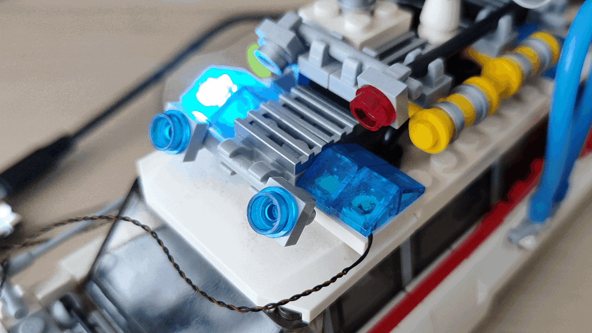

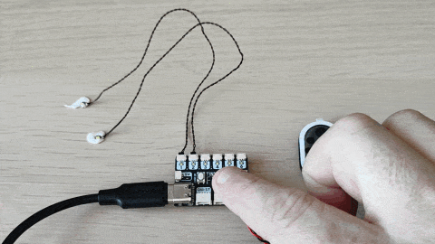

  6. Click on the green RUN button to start the code. Click on the red STOP button to stop the code at anytime. Thonny with the green Run button ready to start the code
  7. Press BOOT on Tiny FX to start the lights and sound. You should hear the siren play and the lights will flash. The audio file will auto-stop and the lights will turn off when done. Tiny FX playing the siren while its LEDs flash
