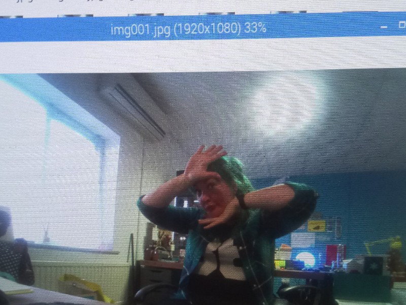

If you run this code now, while you're hooked up to a monitor, you should see a preview of your camera and it will freeze every time it takes a photo. To get out of the preview, you need to press ctrl and d.
It's a good idea to have a look and check the image is the quality you want, even if you end up with something like this.

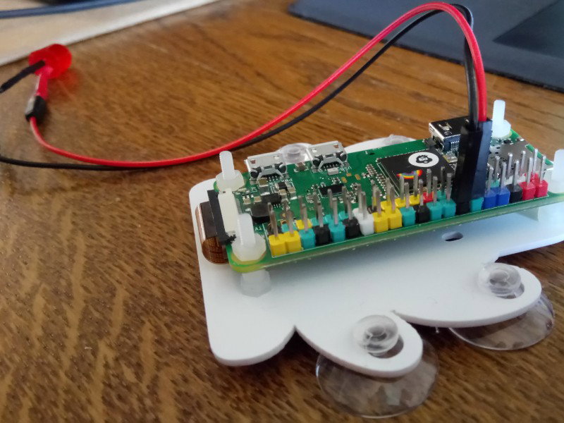

When a Pi is on and taking pictures, if you don't have a screen connected, it's difficult to tell if anything is happening. Adding an LED that blinks when it's about to take a picture is one way of showing this. We took the biggest LED we could find and hooked it up to the GPIO pins.

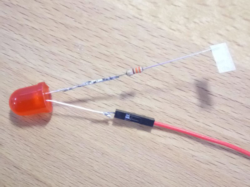

If you want to do this, you'll need to connect a 330 Ohm resistor to the short leg of the LED to stop it sucking up too much current. Join the negative (resistor) end to a ground pin, and the positive end to BCM pin 18 on your Pi.
pin 18 and ground
You can do this with a breadboard, or by soldering some jumper jerky onto the components. See the photo for our version.
