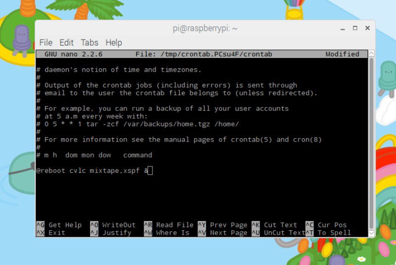

One of the easiest ways to make something happen when the Pi boots up is to put what you want to happen into crontab. Sandy has written a very good guide here, but, for ease of reference, here are the steps you need to follow.
In the terminal, type crontab -e and press enter. Choose option 2 (nano) by pressing 2 and enter.
crontab looks like this

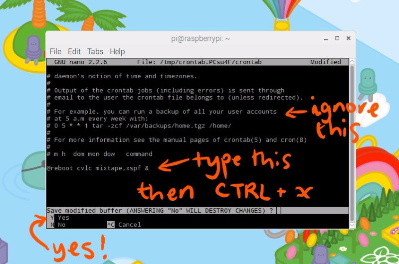

Use the arrow keys to go to the bottom of the file. On a new line, type @reboot cvlc mixtape.xspf & and then save the file by pressing ctrl and x, agreeing to all the saving stuff (y, enter).
crontab with instructions
We have to use cvlc instead of normal vlc, because otherwise it would want to pop up the graphical (GUI) version of vlc and not get started in time. It's like diet vlc!
