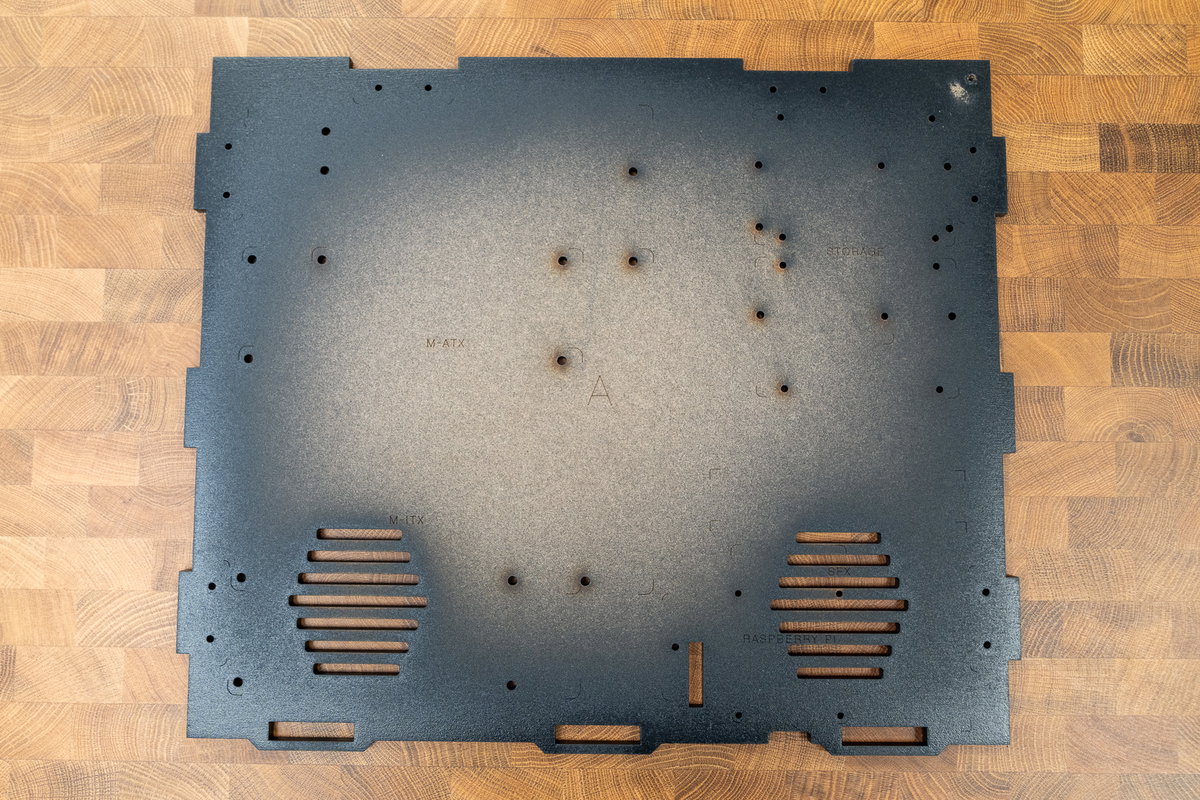

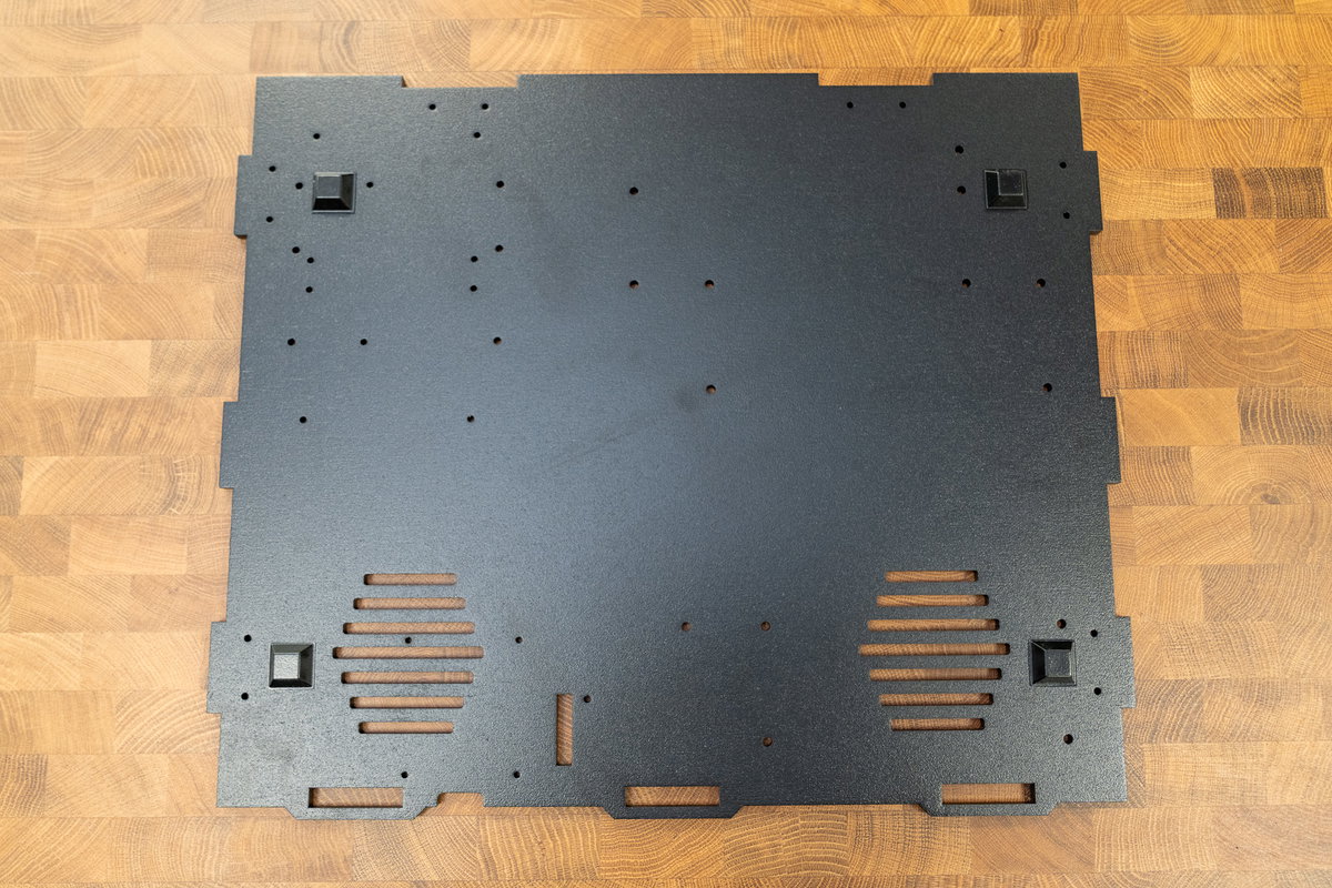

To start, you'll need to find the big black wooden panel marked A - this will become the base of your Picade.
Black wooden Picade Max base panel A

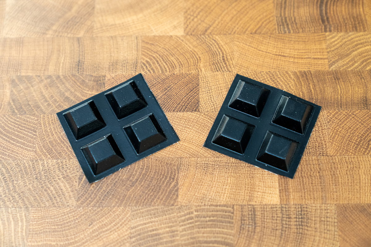

You'll also need the rubber feet. They look like this:
Rubber feet

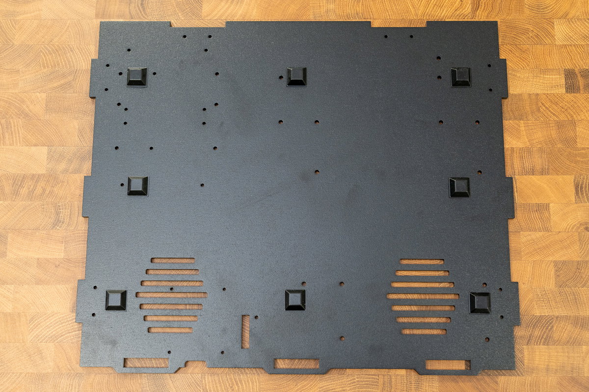

Flip panel A over so the 'good' side without the labels is facing you. Then peel the feet off their backing and stick one near each of the four corners, avoiding the mounting holes.
Picade Max panel A with feet attached to the black side
If you'd like to add more support to the middle of the cabinet or need to account for particularly uneven terrain (hi EMF) you can add more feet, we included extras.
Additional rubber feet positioned under Picade Max panel A
Now the base won't scratch your desk whilst you carry out the rest of the assembly!

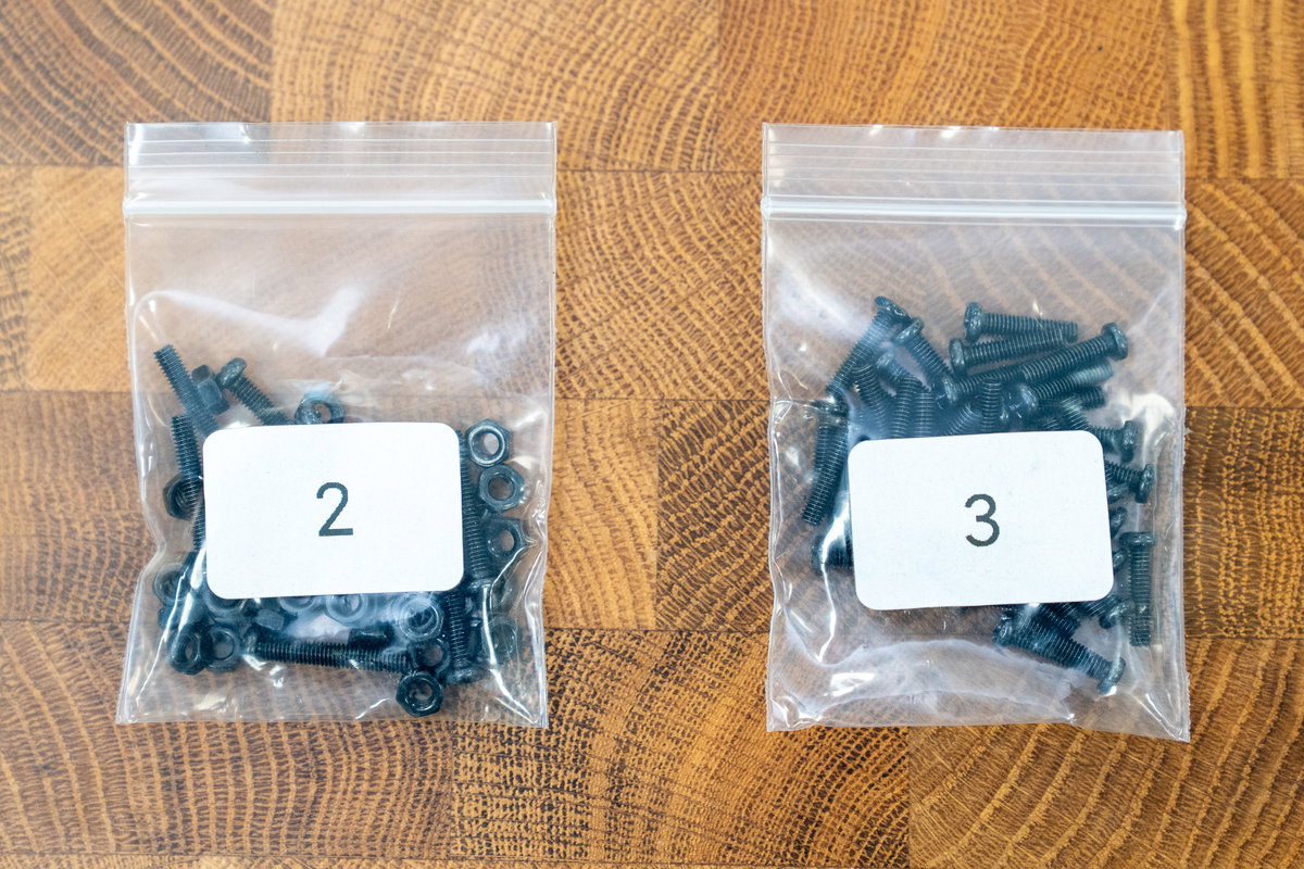

Locate the bags of M3 screws and nuts, they should look something like this.
Bags of M3 screws and nuts for the Picade Max cabinet
Note that there's two lengths of M3 screws here, 12mm and 18mm. You'll be using the shorter 12mm ones for most of the cabinet assembly, set the longer ones aside until later.

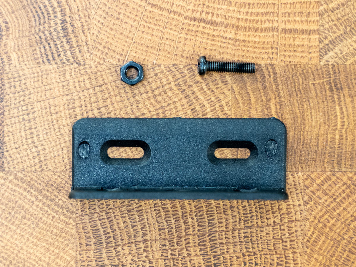

For this section, you'll need:
  • 1x L-shaped plastic bracket
  • 1x M3 12mm screw
  • 1x M3 nut
L-shaped bracket with an M3 screw and nut

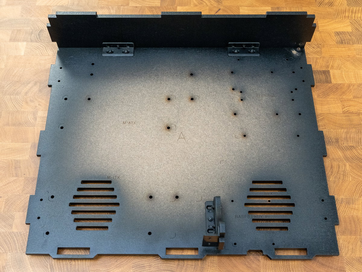

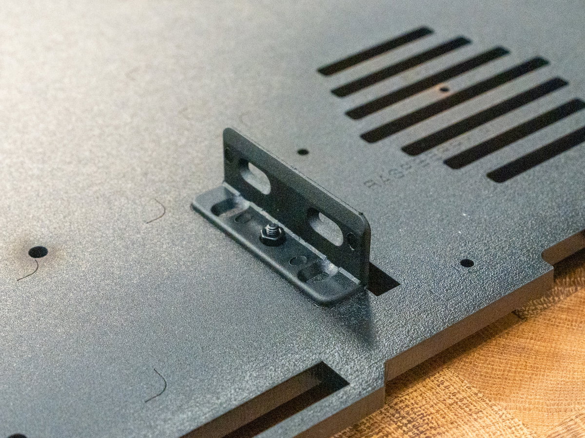

Use a M3 screw and nut through the centre hole to attach a bracket to the centre of panel A. Note that the single holes in the plastic brackets are quite a tight fit, this may require a bit of determined rotation with your driver.
L-shaped bracket attached to the centre of panel A

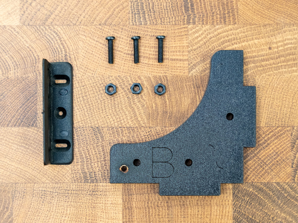

Next you'll need:
  • Wooden panel B
  • 3x M3 12mm screw
  • 3x M3 nut
Panel B, an L-shaped bracket, and M3 fixings

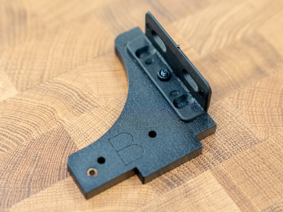

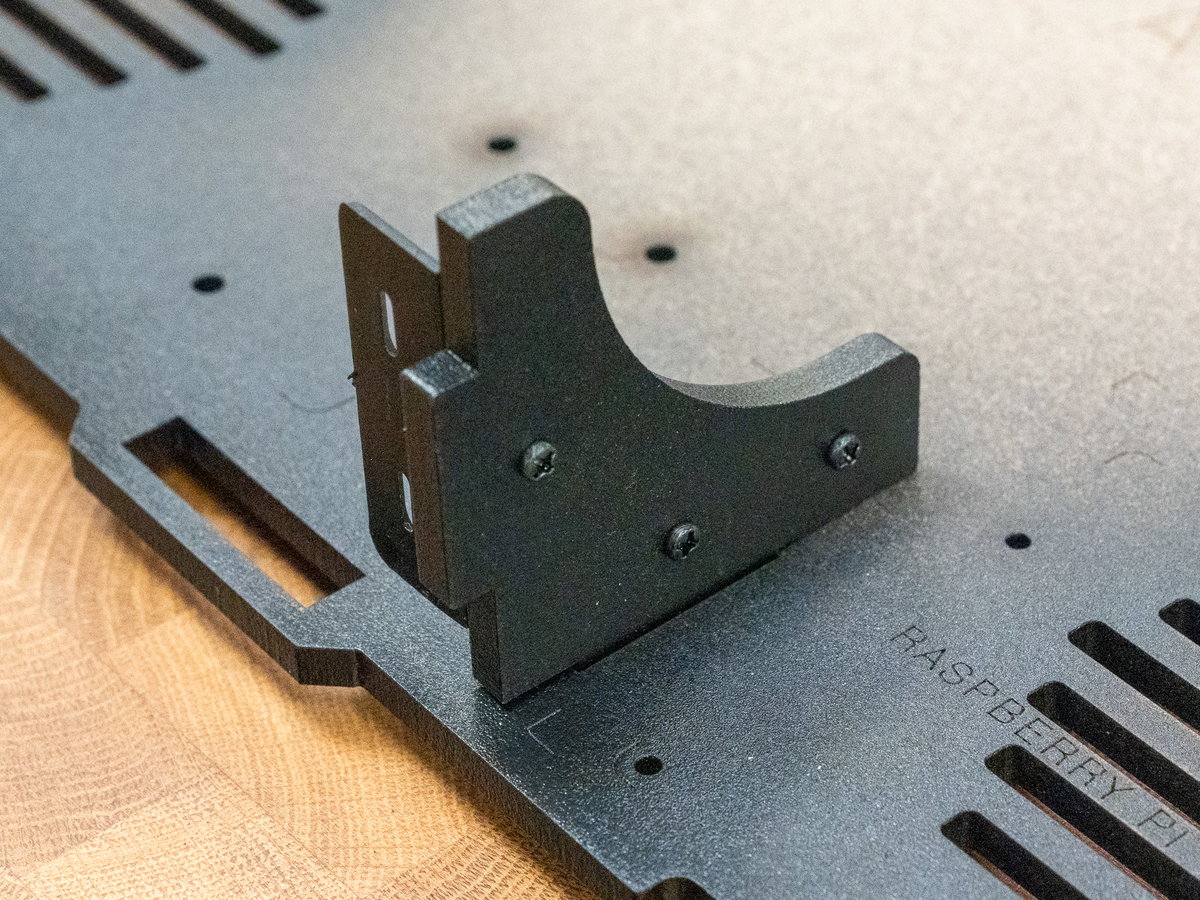

Attach a bracket to it (again using the centre hole).
L-shaped bracket attached to panel B

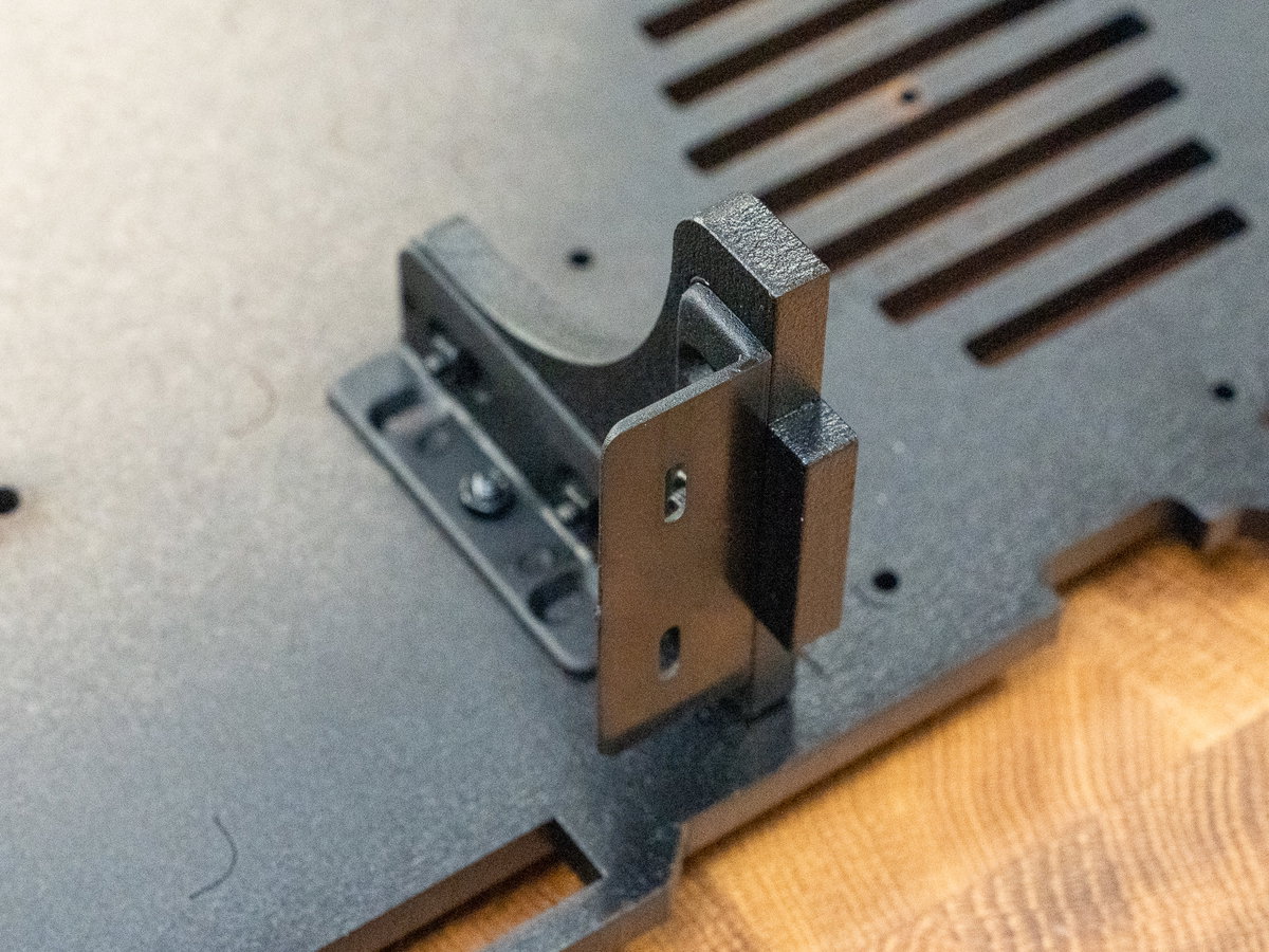

Use two more screws and nuts to secure panel B to panel A, using the two remaining holes in the first bracket.
Panels A and B joined with an L-shaped bracket
Here's what it looks like from the other side.

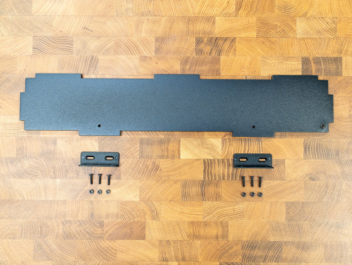

Next we'll be attaching panel C to the other long edge of panel A - this will become the front edge of your cabinet. For this part you'll need:
  • Wooden panel C
  • 2x L-shaped plastic bracket
  • 6x M3 12mm screw
  • 6x M3 nut

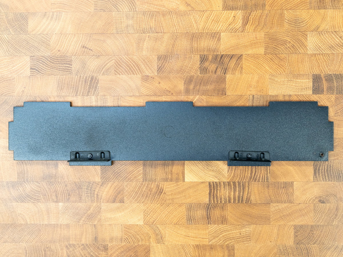

Panel C with two L-shaped brackets and M3 fixings

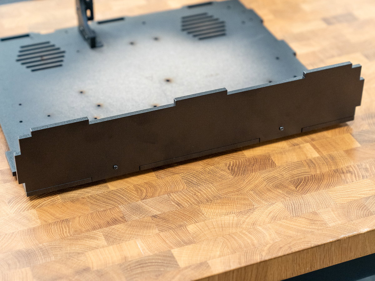

First attach the brackets to panel C, using the central holes:
Two L-shaped brackets attached to panel C
Then use the remaining holes to attach panel C to panel A. You should now have something like this:
Panel C joined to panel A with brackets
Here it is viewed from the front.
Front view of panels A and C joined together

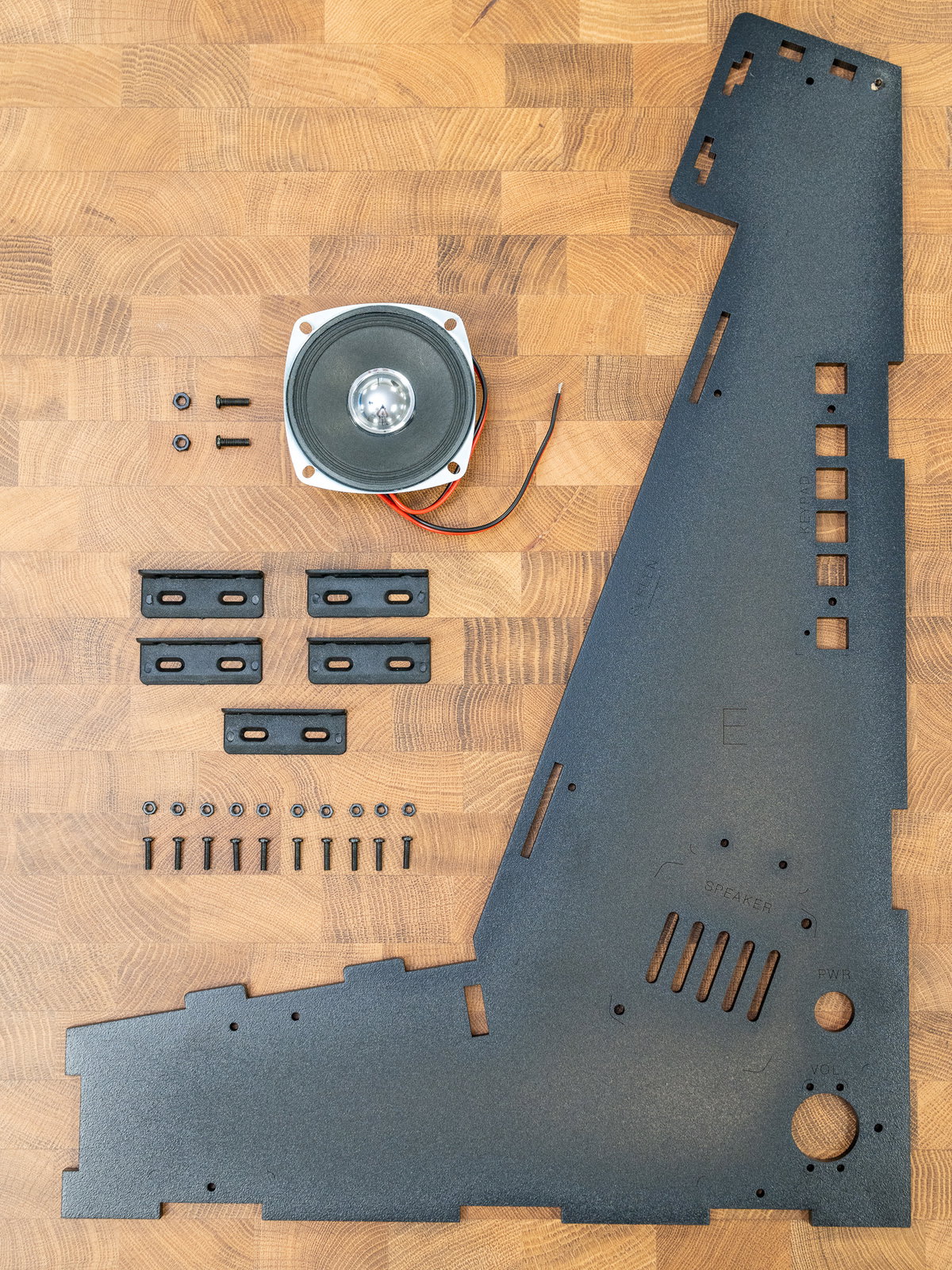

Attaching side panel D (and speaker)

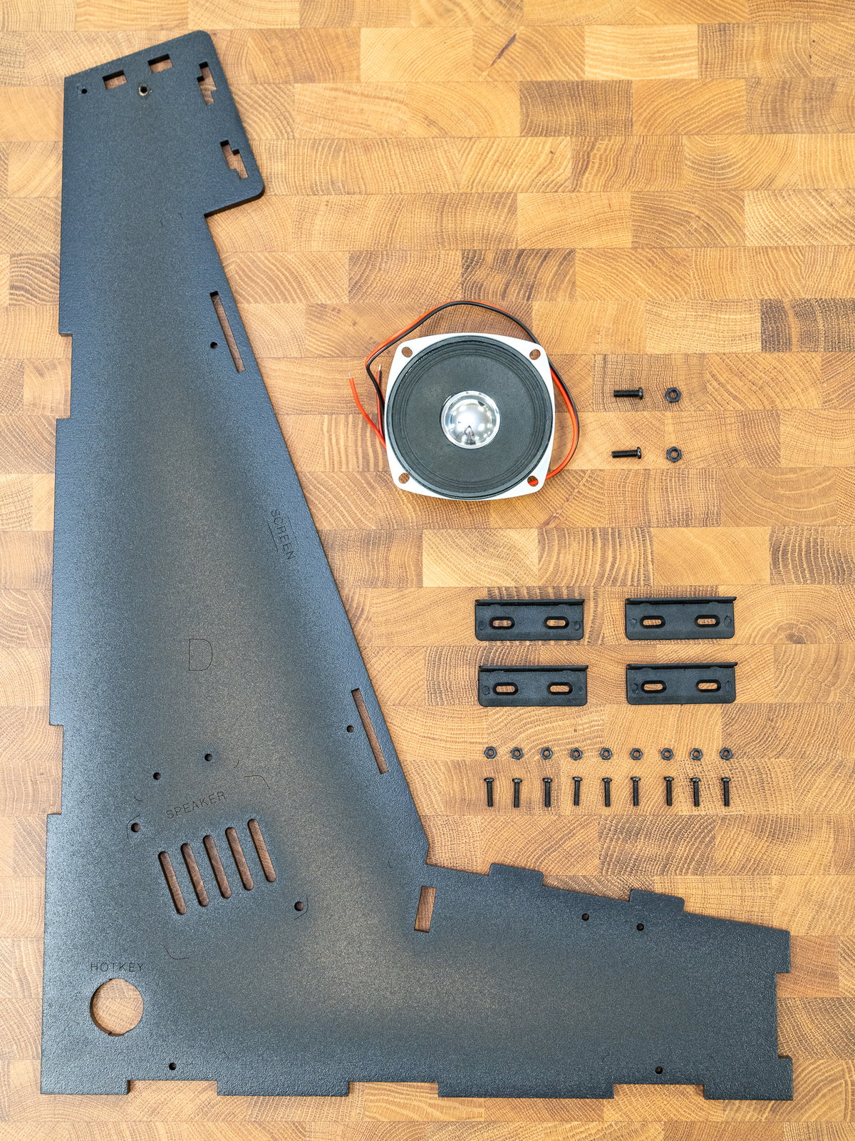

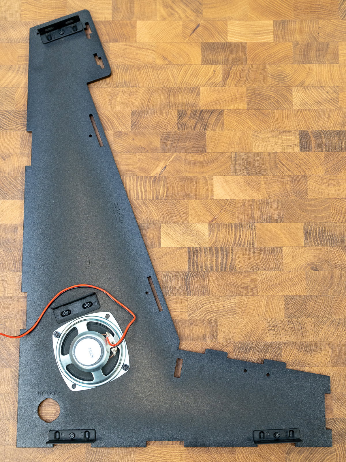

Now we'll be adding panel D (that's the right side panel, if you're looking at Picade Max from the front). For this part you'll need:
  • Wooden panel D
  • 4x L-shaped plastic bracket
  • 1x speaker
  • 9x M3 12mm screw
  • 9x M3 nut
  • 2x M4 screws
  • 2x M4 nuts
Panel D with brackets and speaker fixings ready for assembly

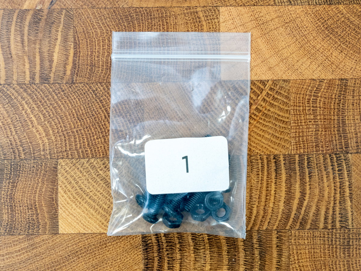

(all the chunky M4 nuts and bolts should be in bag 1).
M4 nuts and bolts from bag 1

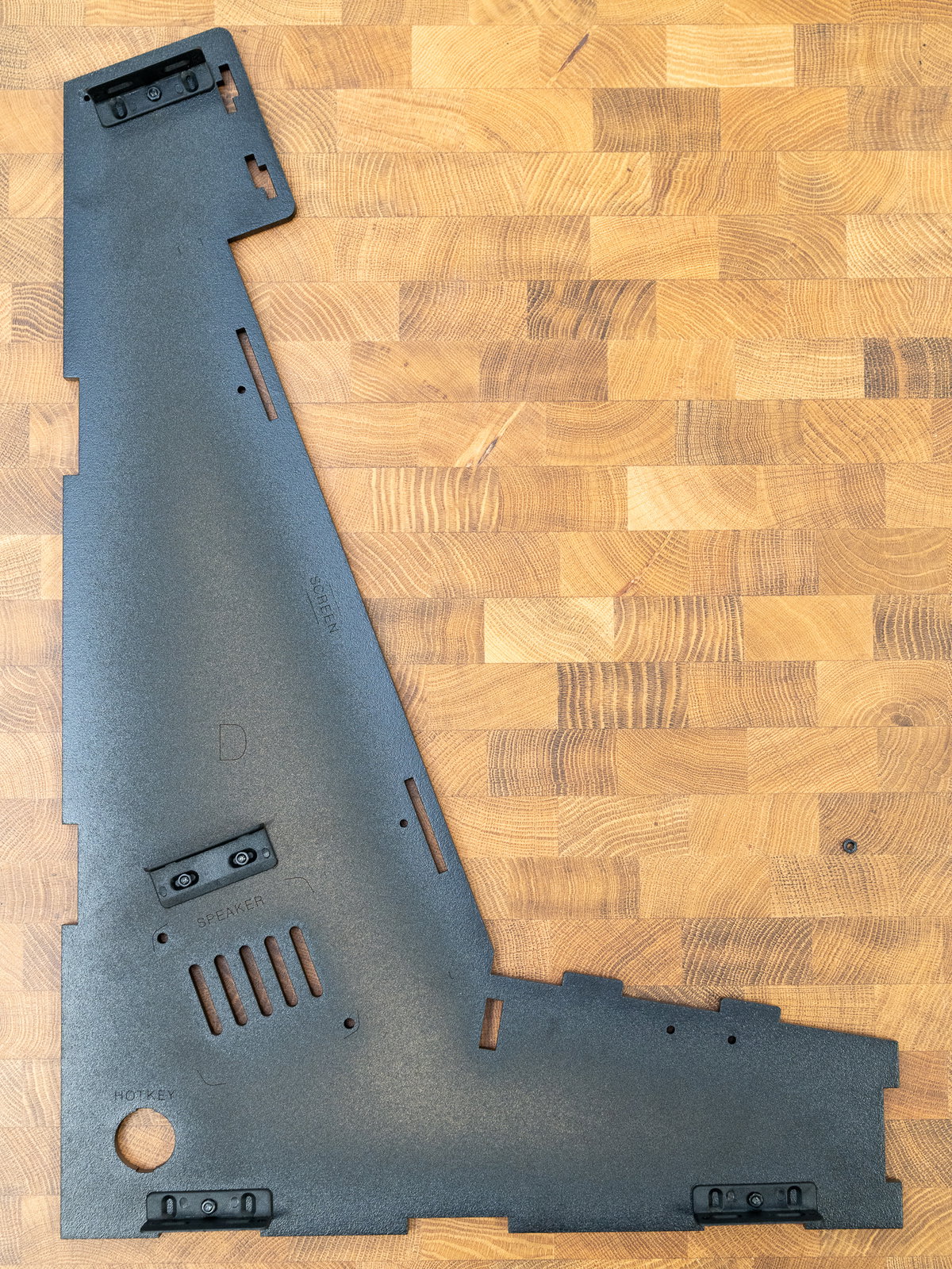

First add four brackets to panel D. Note that with the middle bracket, we're attaching the side of the brackets with two holes first.
Four L-shaped brackets attached to panel D

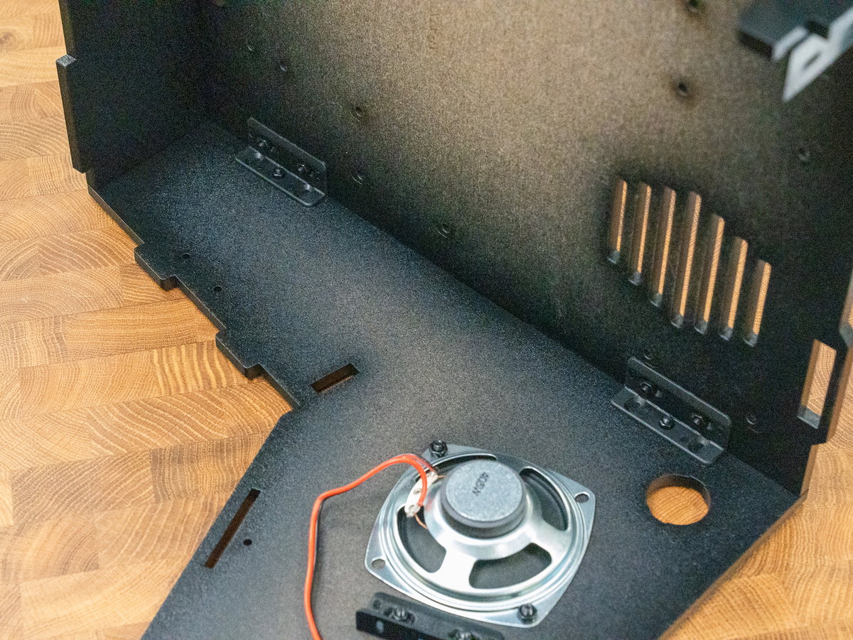

Next bolt the speaker over the grille using the M4 nuts and screws, you only need to put bolts through two of the four mounting holes on the speaker. We'd suggest orienting the side where the wires attach towards the front of the cabinet for tidiness of wiring.
Speaker mounted over the grille on panel D

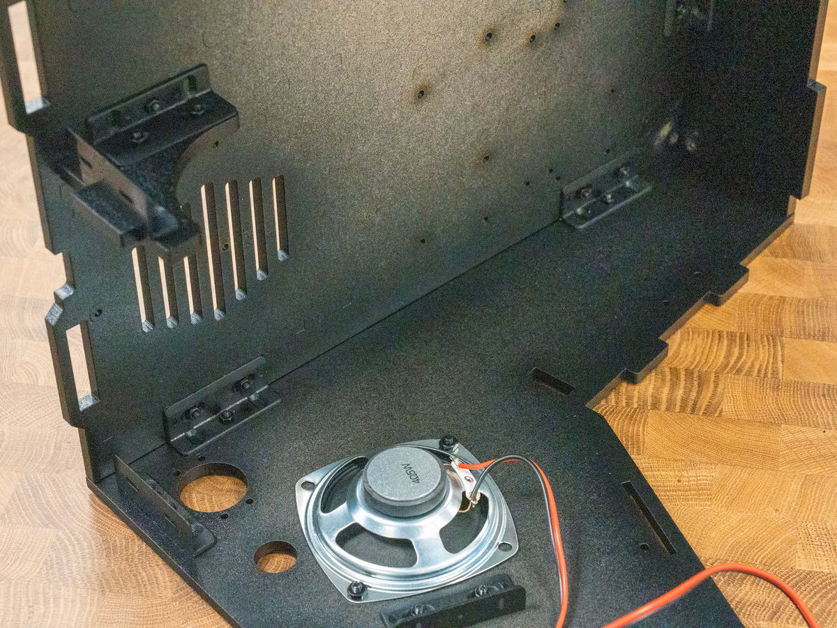

Use M3 nuts and screws to attach side panel D to the rest of your cabinet assembly. The wooden tabs should slot together at the front corner to keep everything nice and square.
Panel D with speaker attached to the Picade Max cabinet

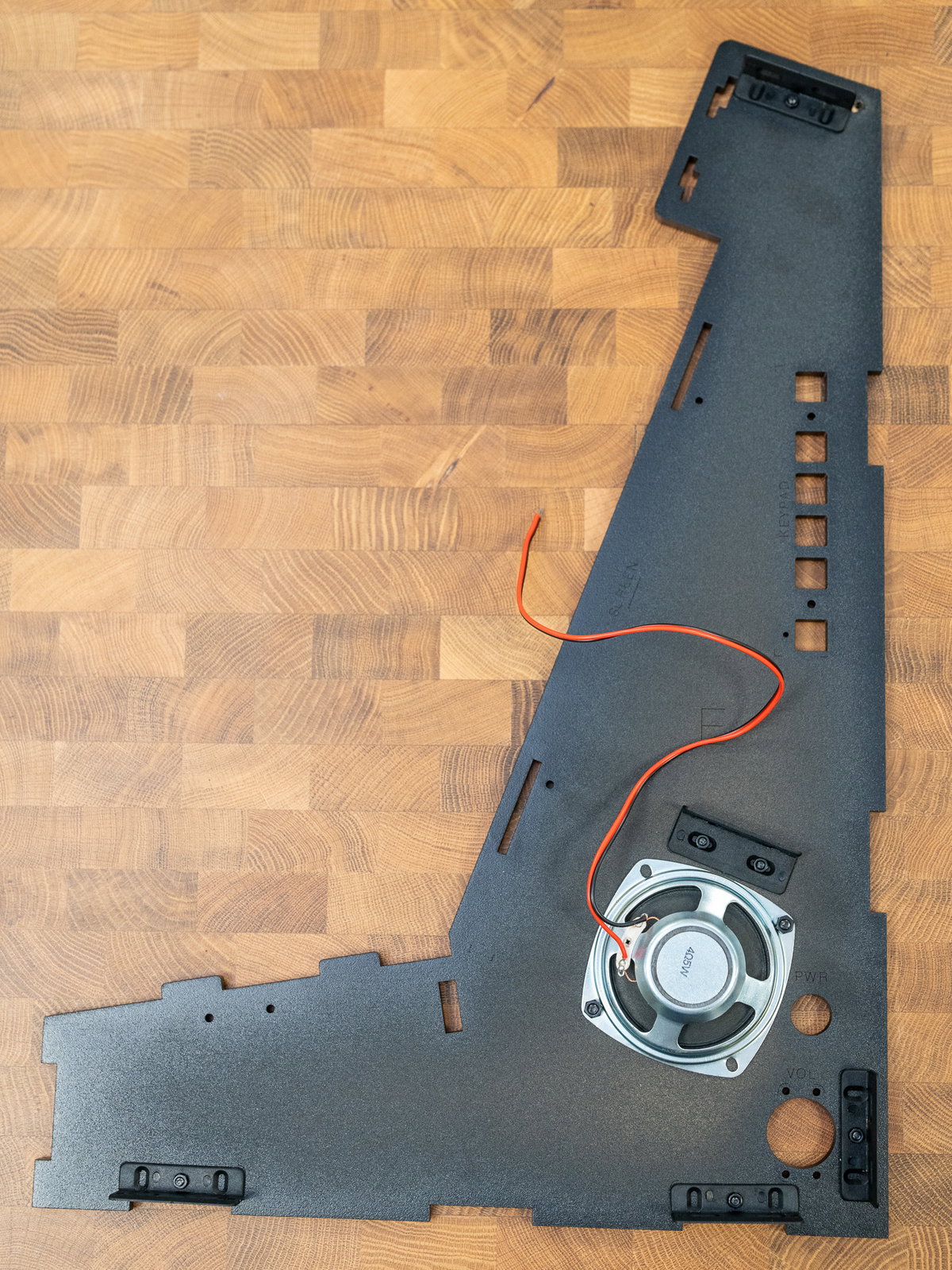

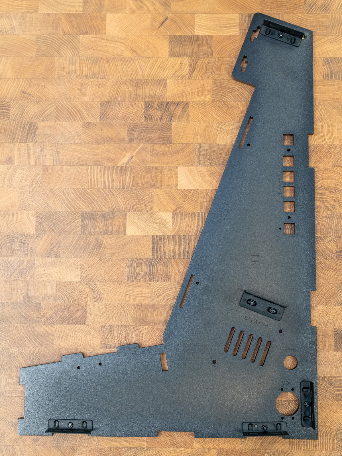

Next we'll be assembling the other side panel! You'll need:
  • Wooden panel E
  • 5x L-shaped plastic bracket
  • 1x speaker
  • 10x M3 12mm screw
  • 10x M3 nut
  • 2x M4 screws
  • 2x M4 nuts
Panel E, brackets, speaker, and fixings ready for assembly
Attach 5 brackets to the inside of panel E as shown.
Five L-shaped brackets attached to the inside of panel E
Then attach the speaker over the grille using the M4 nuts and screws, as we did with the other side panel.
Speaker mounted over the grille on panel E
